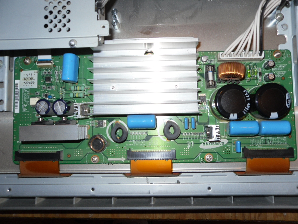

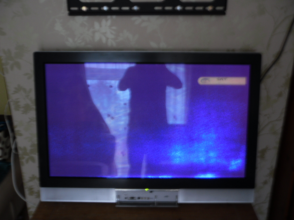

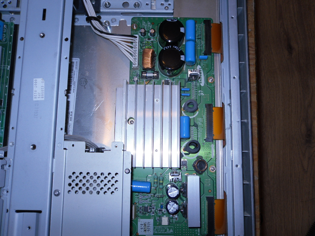

    Hi im hoping someone can help me sort a fault on a JVC PD-42DX6BJ plasma the picture has gone dark with what looks like a sparkly affect in certain patches, looking closer it looks like the pixels are normal in the patches, the picture can still be seen it just looks washed out like looking through a fog, it started a few months ago and cleared after half hour or so, then it seemed to have cured itself and has been fine, now its back and permanent, ive had various advice saying the X sus or Y sus boards or someone said buffers which i take it is either of two on the bottom or the Y sus upper and lower ones ?
    i'd be greatfull if it could be narrowed down a bit.
    I've got the back off now and cant see any bulging caps

    That sounds like a bad Z-sustain.
    Pictures help us help you. In this case, one of the back of the TV to start, and a second of the Z-Sustain - right side as viewed from the back.
    For best results, pictures should be well lit and in focus, at least 1000 x 1000 pixels, but not over 200 pixels due to site limitations. Attach them using 'Manage Attachments' - below the text entry area.

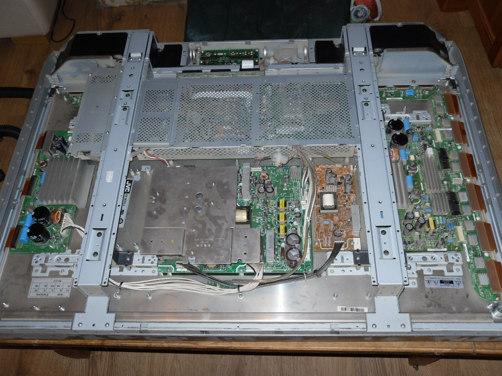

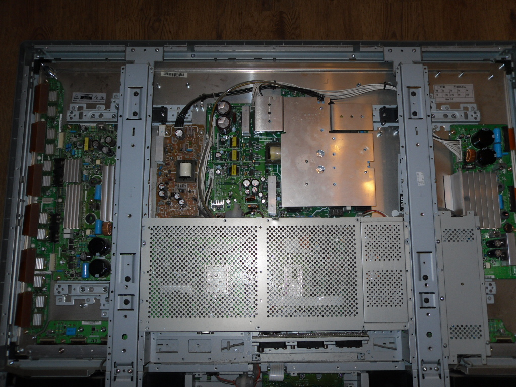

        Awww, crud!!! I thought you had a set with the LG Electronics bad hybrid problem. Instead, you have a set with the Samsung 42" HD V4 panel. The LG was best solved by replacing the Z-Sustain.
        I'm well out of my comfort zone on this. This panel is notorious for blowing the Y-main (AKA Y-Sustain) and Y-Buffers in a cascading failure. The cost of replacing all three is in the order of $200, which is makes the repair uneconomical. On the other hand, if my diagnosis is correct, the X-Main is available for $25 and up on eBay.
        Philips used the same panel in a few of their TVs. The service manual has suggestions on troubleshooting this problem. It's available here.

            Board came today, fitted it and still the same, i tried to get a decent pic but they dont show up well, this is one of a blue screen.
            I will have to try and get hold of a Y sus and buffers i guess ?
            Will i have to adjust the main board when i fit that ? i have the service manual.

              Before spending any more money, check the voltages out of the power supply, in particular those voltages going to the Y and X main boards. This is NOT the typical Y main / Y buffer failure.
