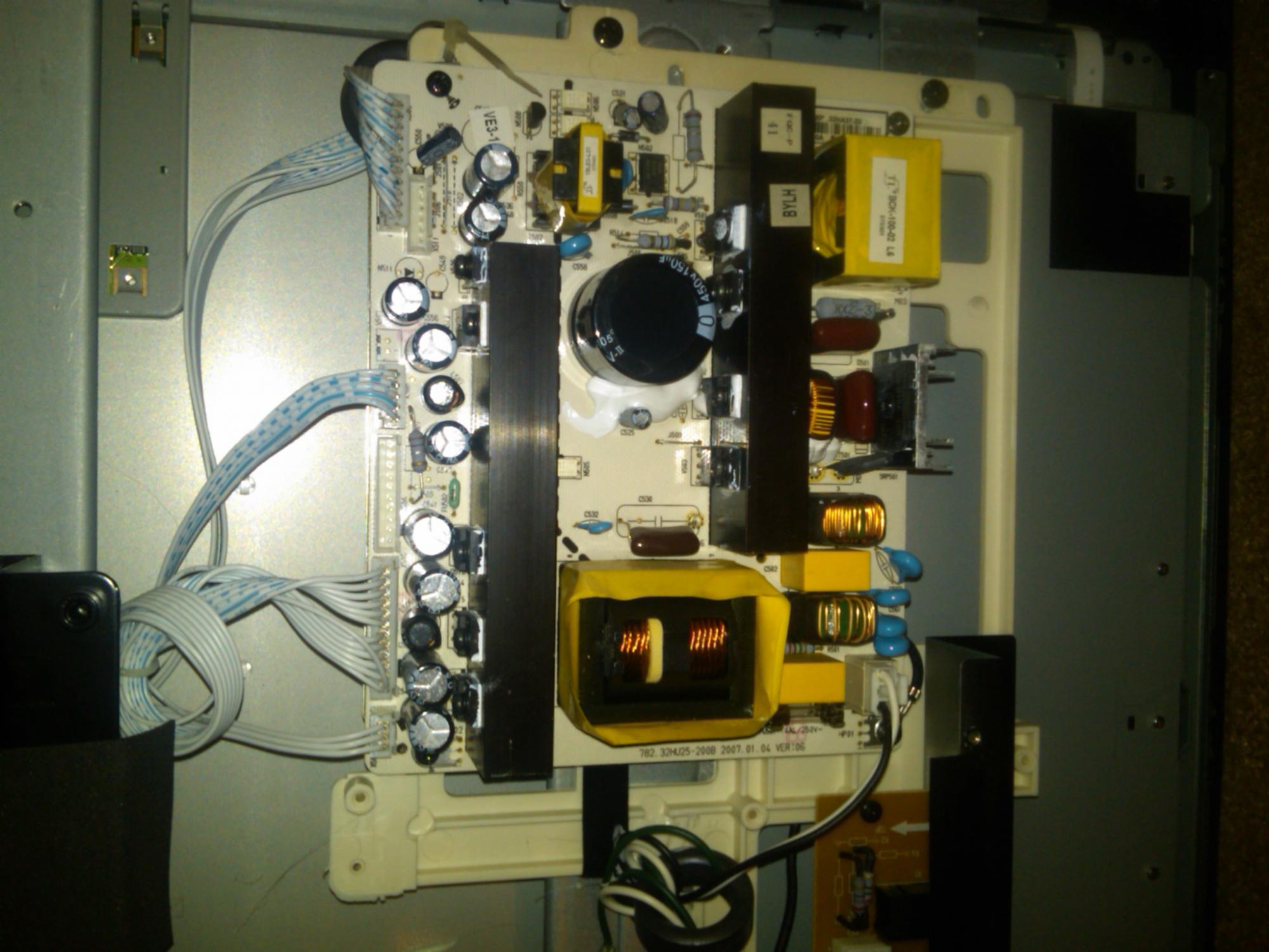

    I recently dug out an Insignia 32" LCD that I have yet to be able to fix. I'd like to use it in my bedroom.

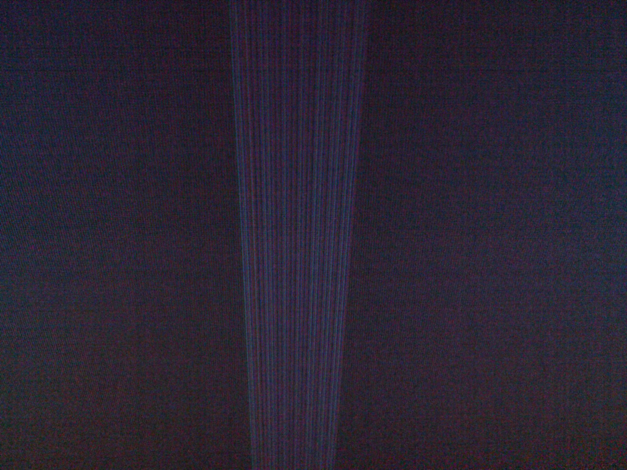

    Here's what happens when you plug it in. Upon pressing the power button, the LED lights up green. The backlight comes on to a completely black display, with a couple of faint vertical lines.
    After about 5 seconds, the colored vertical lines appear, and sometimes shift horizontally a few pixels, or change color. The timing seems to be consistent with a "No Signal" box showing up.
    Further, invoking the menu or changing input sources via the side panel buttons causes some changes in the colored lines.
    Also of note, the Power Supply board has no noticeable bulged caps. They are almost all "JH" brand. However, the board emits a high pitched, slightly varied squeal when powered on. When the TV is powered off, the squeal gets higher, drops down, and comes back up, in a repeating cycle. (Think of a racecar engine revving and shifting.) It sounds like it is coming from the large 450V cap, but I cannot tell for sure. Again, no capacitors appear bulged.
    I have done as much research as I can find, and I am not sure if I should suspect the power supply or the TCON board first. I am inclined to believe that the functionality of the side panel buttons indicates an operational logic board, but of course I cannot say with 100% certainty.

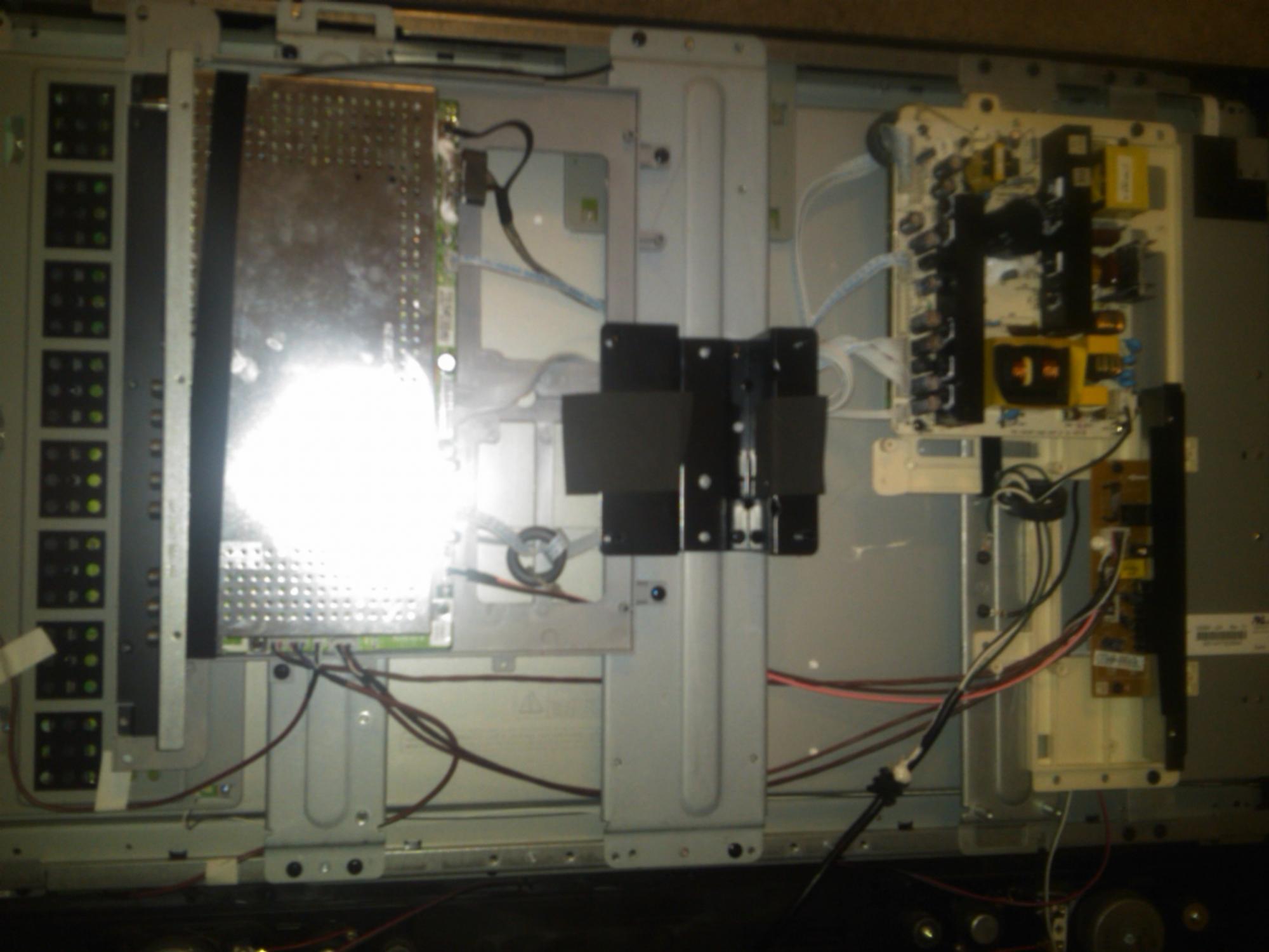

      Okay, sorry it took a while, but here are the pics. Just moved and don't have my digital camera unpacked (or located), so I did the best I could with my cell phone. The first picture is looking at the whole TV from the back, the second is the PS, and the third is an example of the lines that appear on the screen when you press a menu button.
      The lines aren't "dead pixel" lines - they move slightly and change color when a different menu button is pressed.

        I had fixed a few NS-LCD32/37 TVs. All of them are bad main unit. I prefer bad main unit. By the way, I only replace main unit. Now I still have some broken boards in home. 32 and 37 share the same board.

            your pictures are not clear, but looks like same. the main unit is mounted on the white plastic shelf. but this main unit is expensive and hard to get it.

                    TVs of this size usually have a dual power supply. The standby supply is on whenever the power cord is plugged in; the main supply is switched on by the main board. Thus, you must have the main board hooked up to get meaningful results.

                      Okay i purchased a DMM and attempted to test the voltages on the power supply. The multimeter came with no instructions or explanations what so ever, and although I have used one before, I haven't used anything with this many functions.
                      With the tv powered off, there were no significant voltages. I got readings of like, .4.
                      With the TV powered ON, i touched one probe to a GND point, and the TV instantly shut off. So, apparently I am doing something wrong =\. I can post some pictures in a little bit.

                          Spent some time with the DMM and got acquainted; the 5V, 9V, 12V, and 24V lines are all +/- .5V of their rated voltage. I guess now is the time to start swapping boards, unless someone has another suggestion?

                            Can you post a picture of the Tcon board? There are usually some fuses on those boards that can be tested.

                              Alright, I will look into that. The Tcon is covered by a metal shield, which "hooks" into the frame. From the looks of it, I will need to disassemble the entire frame to get that off.

                                        Further, I removed the metal shields from the logic board - there are about 16 "Chang" capacitors and a few "JH" caps as well. None look visibly damaged. Looked for components marked with an "F" or that seemed like a fuse, but found none. I can try to post some pictures soon... Are Chang or JH caps known for failure?
