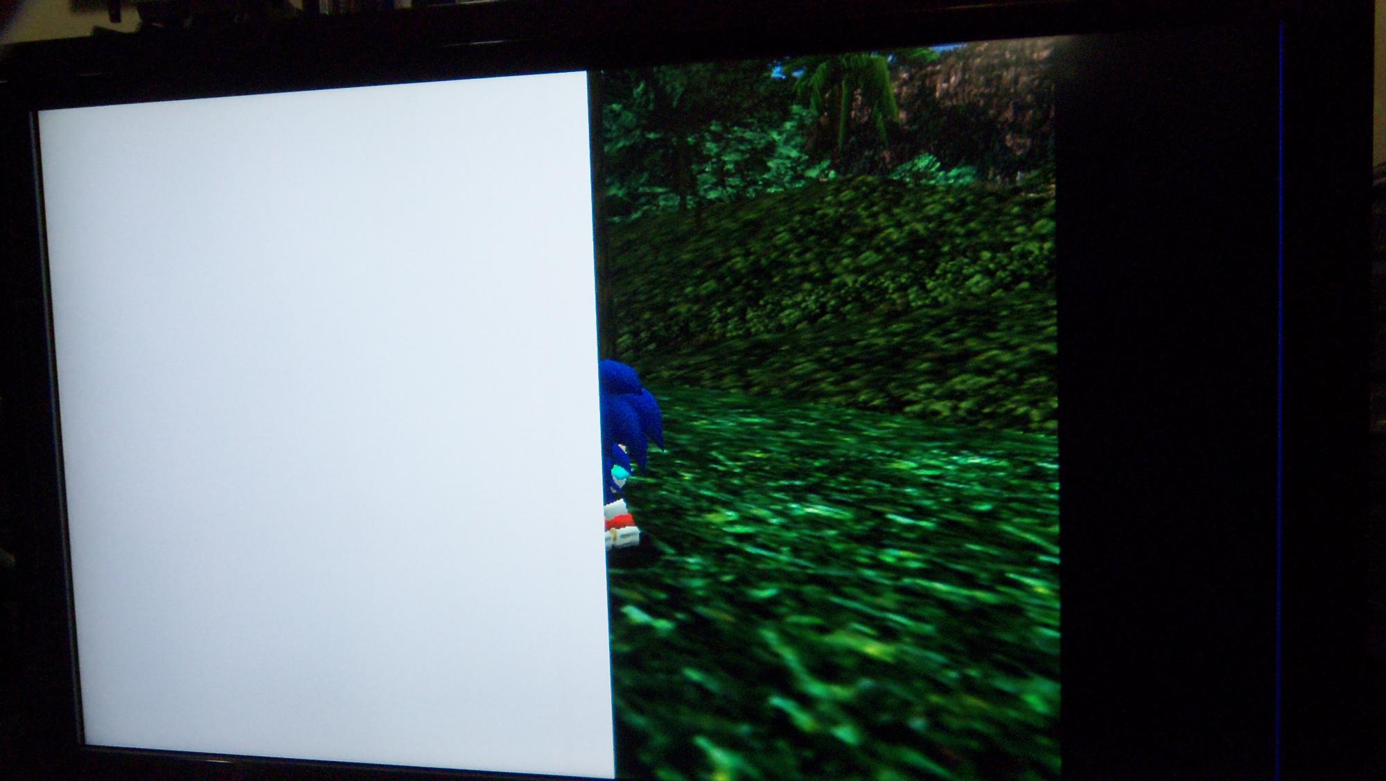

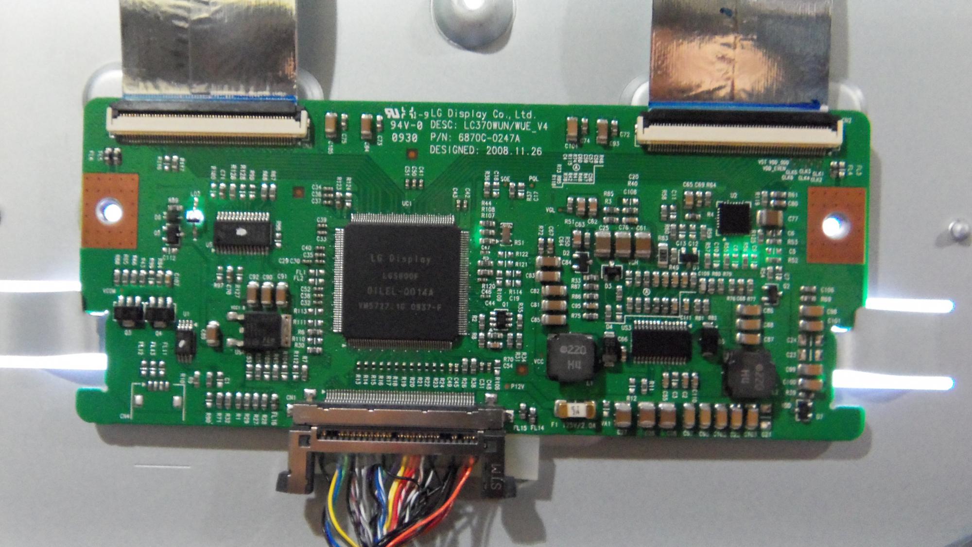

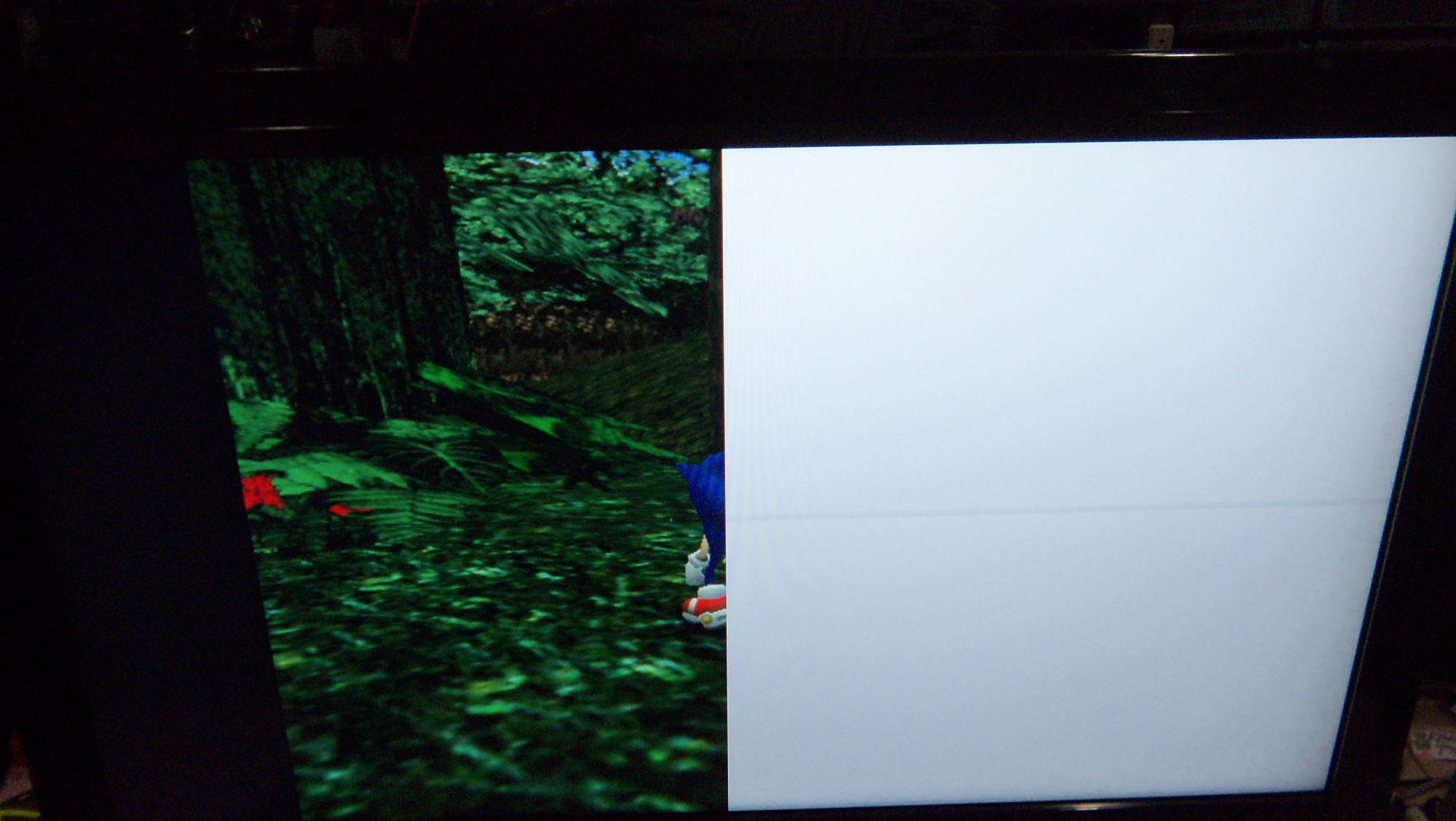

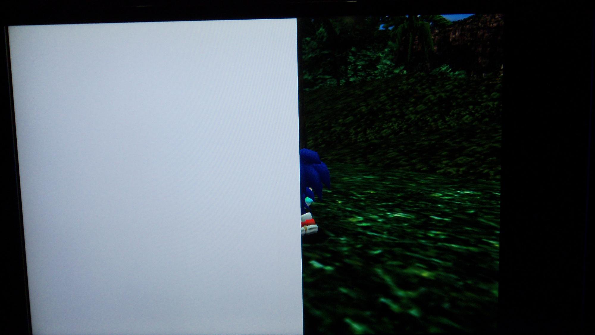

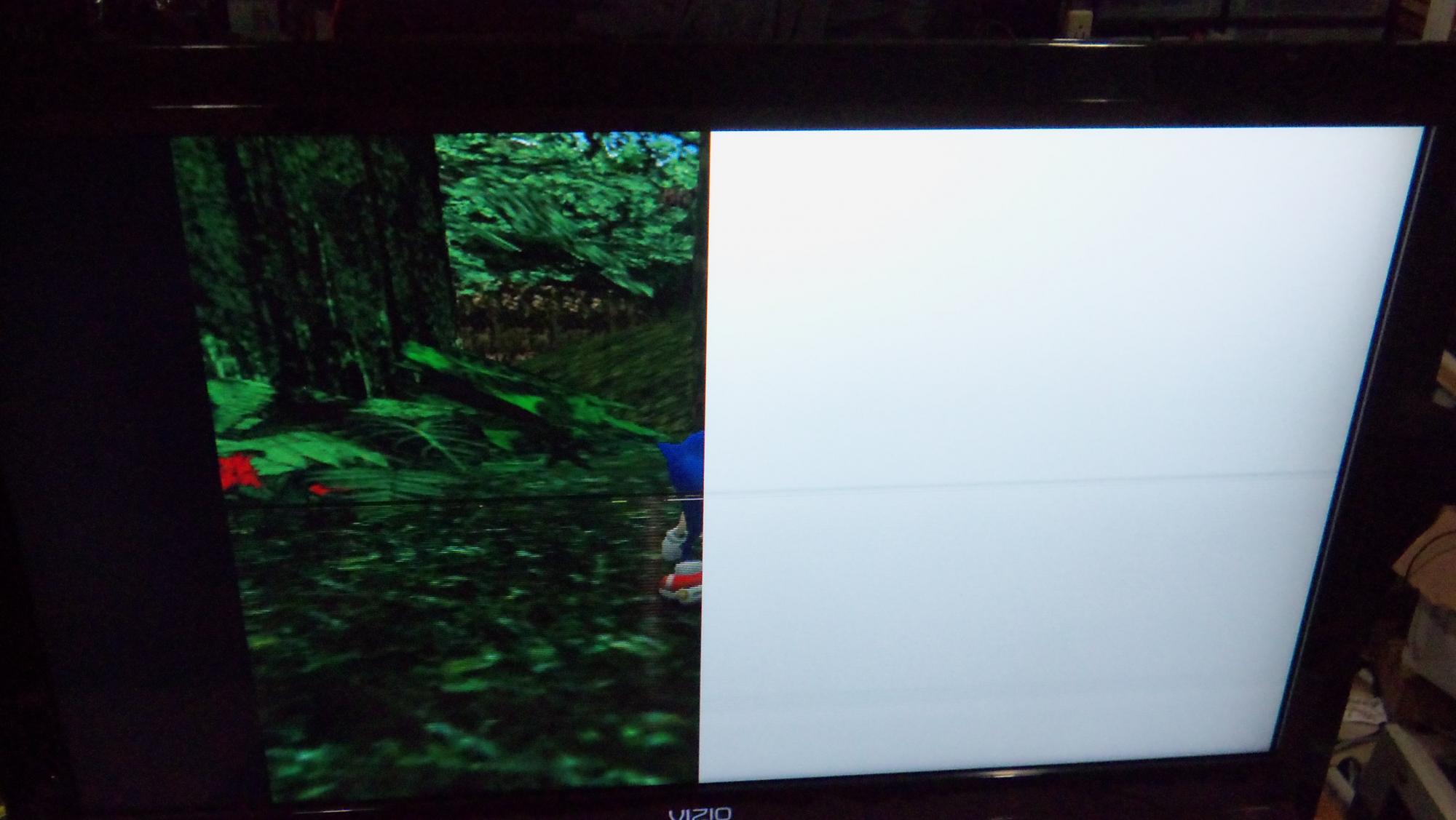

    Hey there guys! I got a Vizio VL370M LCD, the problem is that when playing video on any of the sources, the lower half of the screen freezes intermittently. It also has one solid line running vertically on the panel slightly to the left of the middle of the panel, and one more exactly on the middle going horizontally. At the intersection of these 2 lines, there are 3 pixels (arranged on the vertical line, with the middle pixel on the horizontal line) which glow red or a solid light color. Here is a video of the symptoms: http://www.youtube.com/watch?v=JnG44C0zcQU
    Now I assume this might be a Tcon problem...But Im worried it might be the panel...
    I also took pictures of what happens when I disconnect one of the T-Cons ribbon cables: But first let me explain a bit, since the pictures dont show the whole tv. (it was a bit cramped :-P) When I disconnect any of the ribbon cables exactly half of the panel (corresponding to the ribbons side) would stop working (displaying white)
    The first 2 pictures are with the right T-con's ribbon cable disconnected-The left side is perfectly fine, except for the vertical and horizontal lines (this time they're alot fainter on the blank white side with the horizontal line being completely white but still visible).
    The second set is with the left disconnected-The whole panel (including the blank white side) shows symptoms that are shown in the youtube video, with only the right have having video

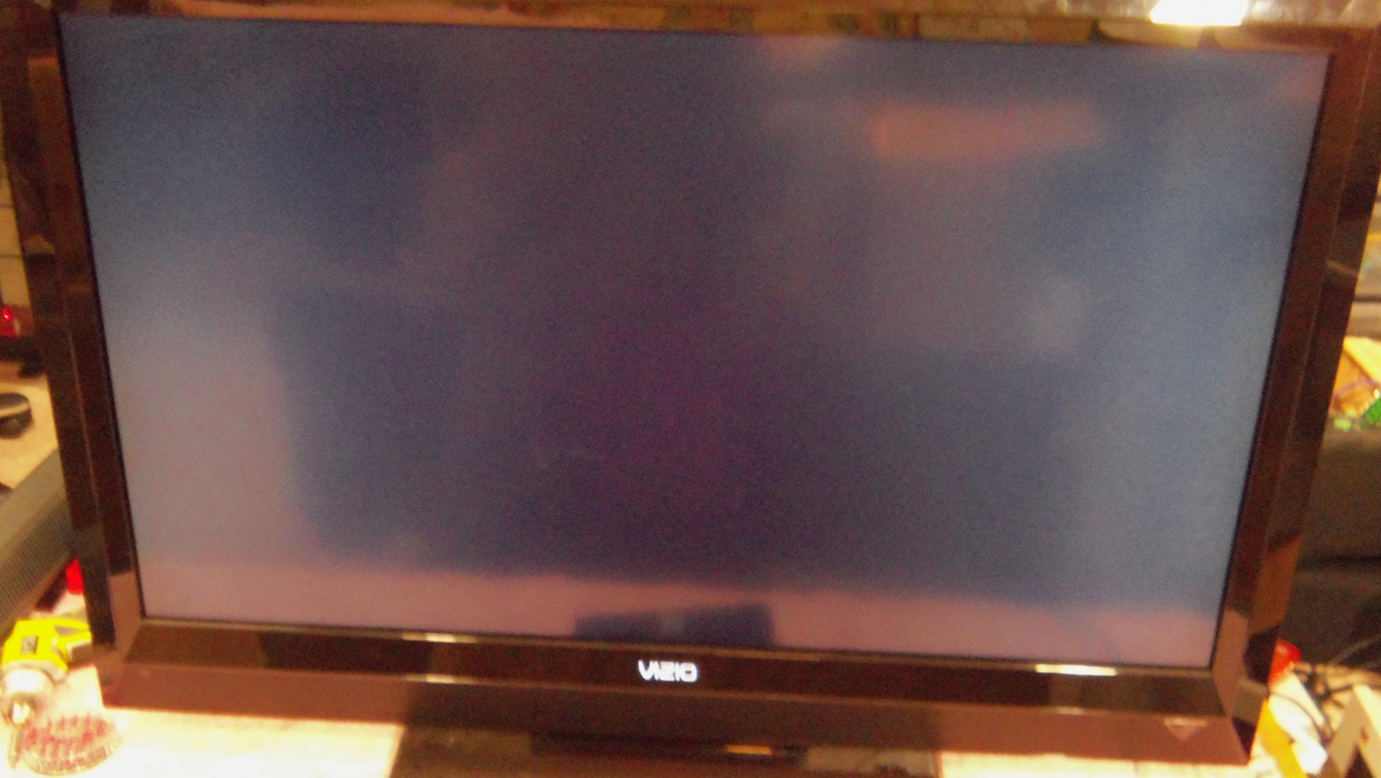

    The third is with the whole Tcon disconnected from the mainboard. The backlight works, and I dont see any dead pixels or anything.

        Ok I got it working, I had to do them individually....Weird...Oh well. Here they are. The last picture diddn't work, so there is no picture of the rear arrangement.
        The rest are pictures of the back of the TV's arrangement.
        I could really value this communities input :-) Thanks!

          The picture going white is to be expected when one of the driver cables is disconnected. That's not a sign of a faulty panel or T-con.
          The T-con is often the cheapest board to replace, so it may be worth trying it.
          Both of the connectors probably provide a small amount of power to the LCD, possibly explaining why when both are disconnected the screen goes black. Though I'm not 100% sure.

            The fact that the screen goes white isn't the problem that I'm having. Its the lower horizontal section of the screen freezing like in the video I posted in the first post.
            I took pictures of what happens when you disconnect the tcon for reference, maybe it will help in diagnosis.
