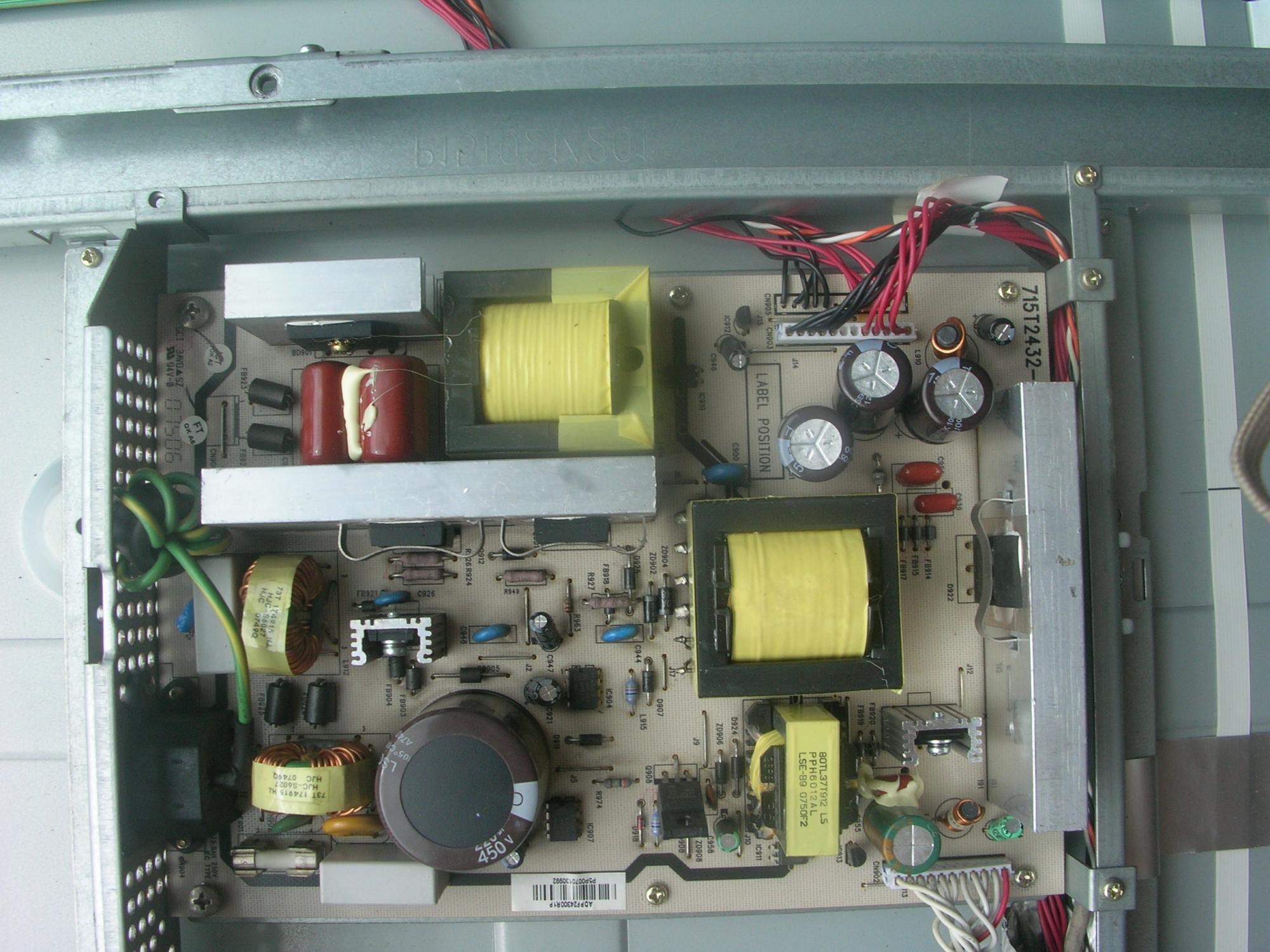

      Re: Philips 42PFL7482 power suply problem
      I checked the voltage out puts on the suply and there only seems to be voltage on the 12v output.nothing out of the 24v or the pin thats saids standby. I did this check with the board removed from the TV.
      I have attached a PDF of the supply i got from this site if this helps
      • PlainBill
        • Feb 2009
        • 7034
        Thanks for the PDF. That makes this easier. Also, thanks for providing details on the testing methodology you used.
        This is a variation on the supply that is in most TVs. The 12V supply is the standby supply, and is on at all times. I'm guessing that the main board uses either a linear regulator or a bucking regulator to drop it to 3.3 volts. IC907 is the SMPS controller for that supply.
        The main supply is controlled by the Standby input. If I'm reading the schematic correctly, when standby is pulled high (typically 3.3 volts), power is fed to both IC902 (pfc controller) and IC904 (Main SMPS controller).
        A 10K resistor from the 12V out to the Standby input should turn on the main supply.
          After connecting a 10K resistor between the 12v and standby . I got between 23.5v to 24v( Fluctuating) on the 24v outputs.
          So i will have to investigate more as it seems the power supply is working now.

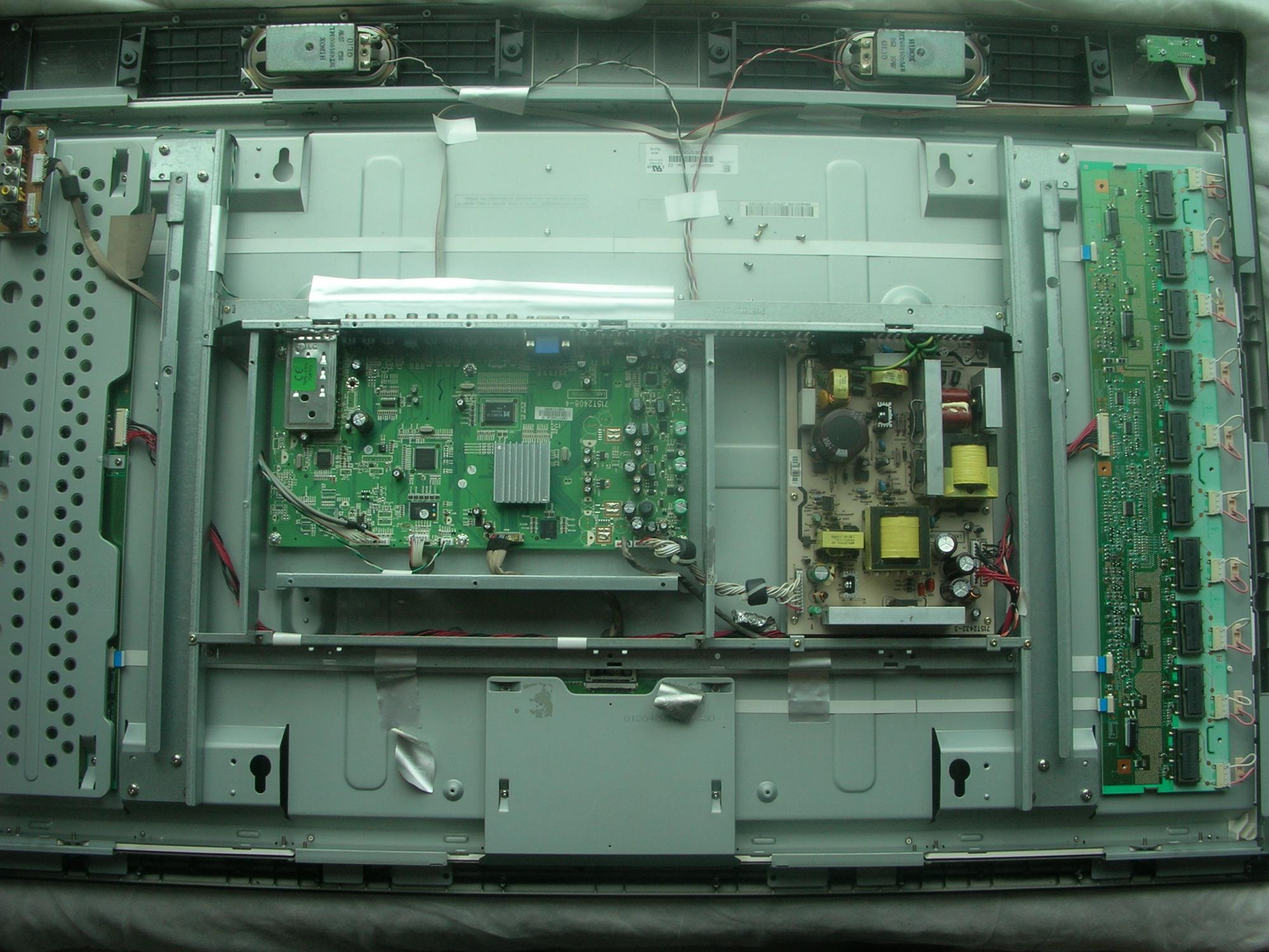

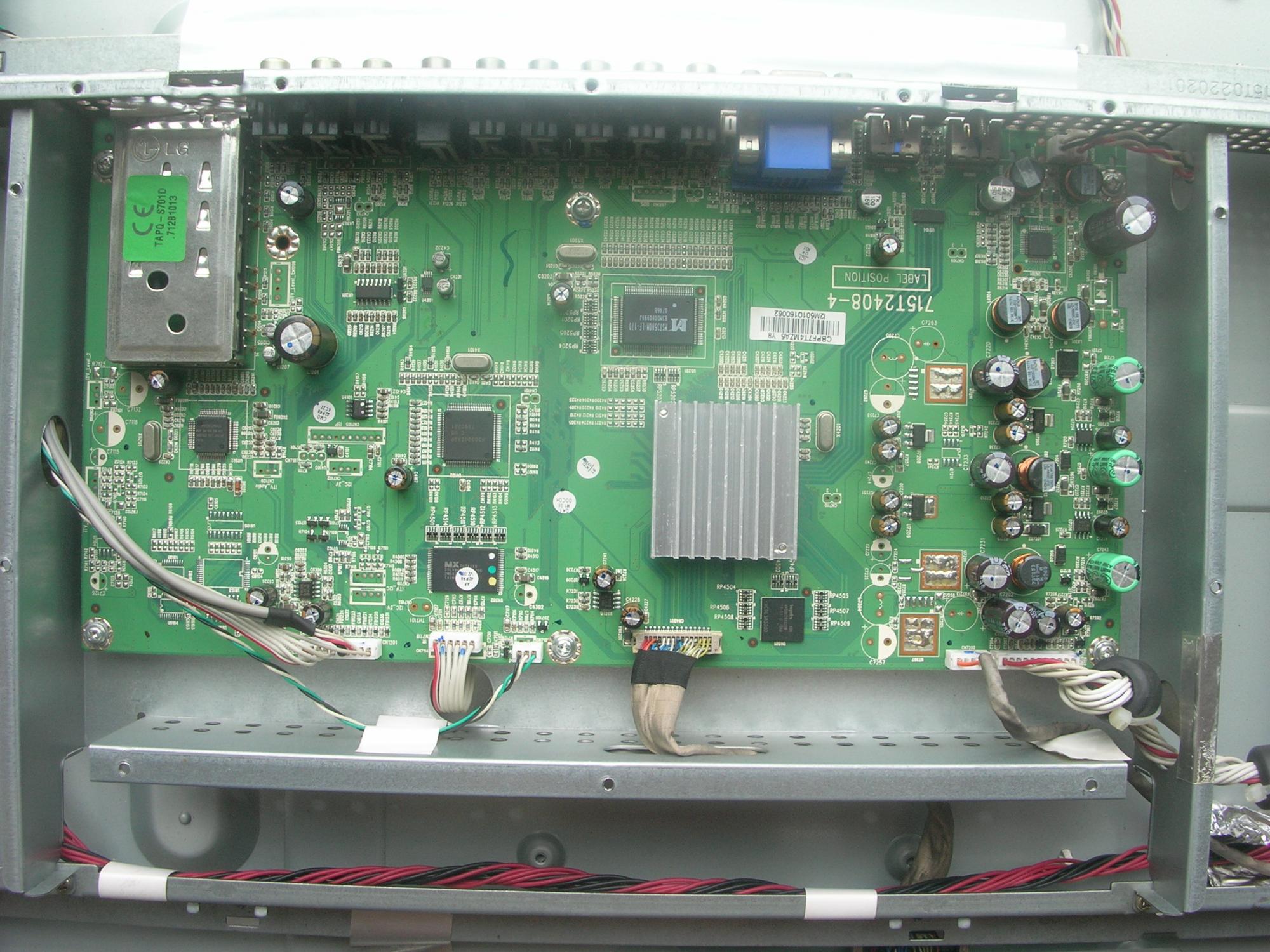

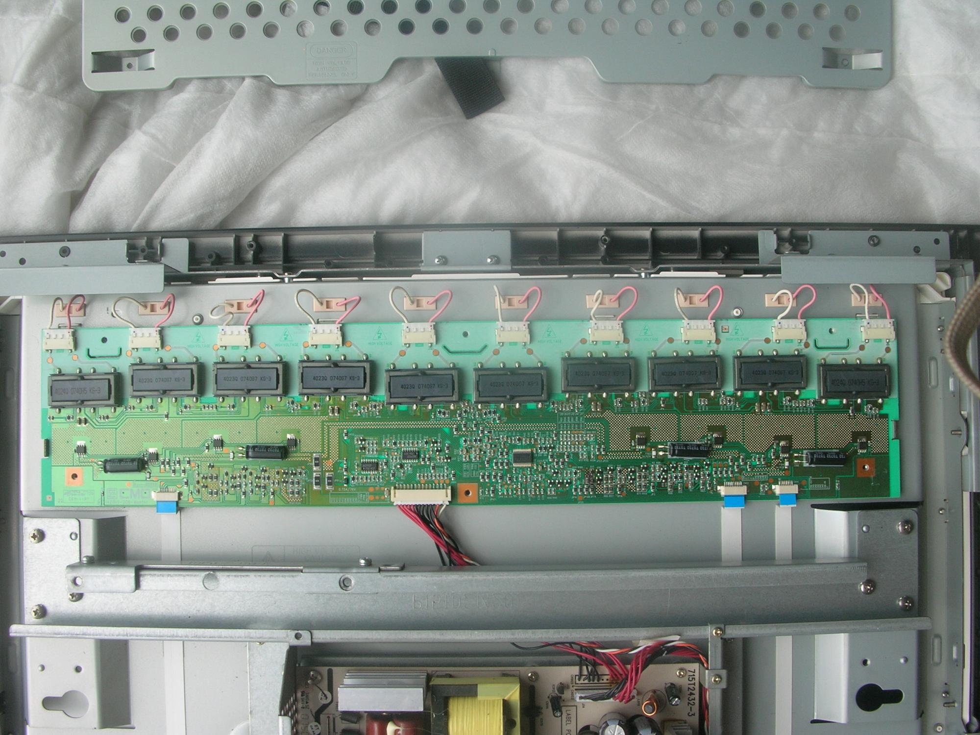

                      • soundfinch
                        • Sep 2011
                        • 8
                        Here are the Picture of the inside of the TV.
                        As you might noticed due to one of the connectors being burnt i connected the wires straight to the board of the power suply. I also replace 3 caps on the power suply

                        • PlainBill
                          • Feb 2009
                          • 7034
                          First problem. Check on the opposite side of the TV, I suspect you have another inverter over there.
                          Second (possible) problem. When testing it is a very good idea to fasten each board in place with at least two screws to ensure you have a good ground.
                          Third problem, while the pictures are excellent for an over-all view, the @$$$#^#!! inverter is too long to see anything useful. If these suggestions don't help, three pictures of each inverter may be necessary.
                          Check for fuses on both the master (shown) and slave inverters. The component identifier should start with an F (F01, for example). The small white object to the left of the power and control connector may be a fuse; the three larger black objects further left may be fuses.
                          Check the voltages on the inputs to master and slave; also check the control lines. I note there appears to be a label indicating the functions of the pins.
