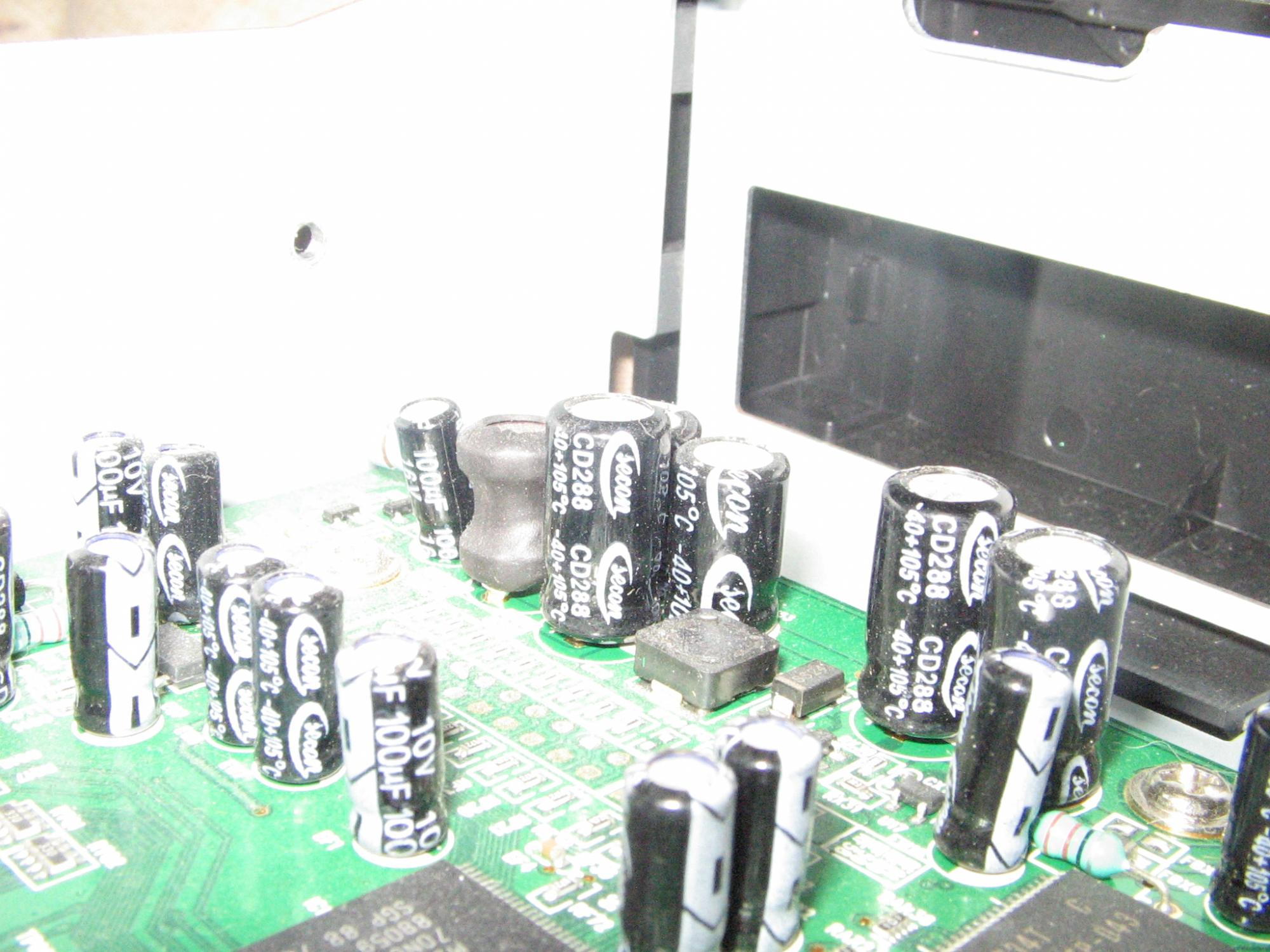

    ... more bad capacitors?? What is this I don't even....

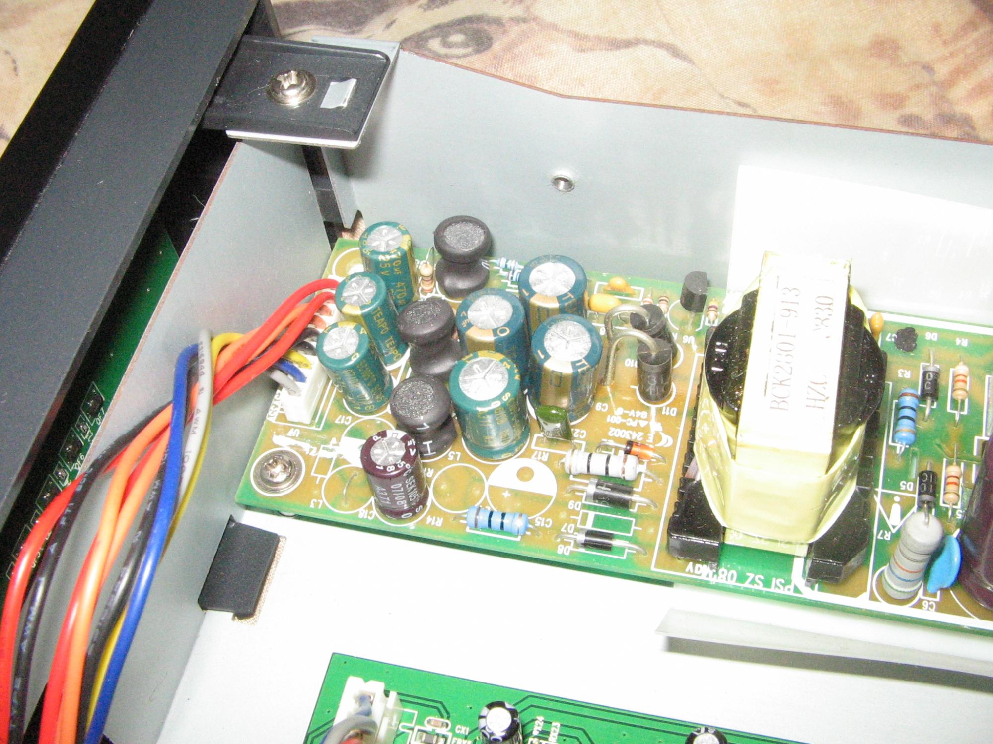

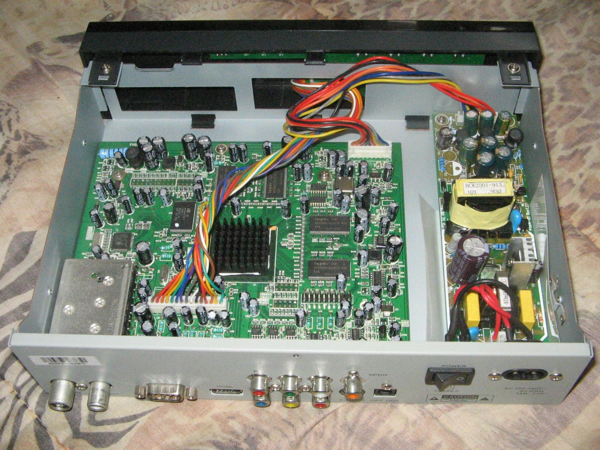

    Going to try repairing a Draco HDTV 6300 DVB-T digital tuner.
    Symptom: Power on, antenna\tuning(?) LED comes on, nothing else happens.
    PSU is full of Teapo (2 of them bloaters)
    Logic board is full of .. well, that's the thing!
    The outer sleeve says "Secon" (See photos) but after looking at some of the more bloated ones, something 'funny' in the way the tops looked was evident.
    What are they hiding???
    This looks like a second sleeve...
    I cut the outer sleeve off one of the capacitors. Underneath, the first sleeve is much the same as the second, but instead of "Secon" logo - it says "P H"
    Good old http://capacitor.web.fc2.com/ gets a hit on the 'P H' - WuXi Puhe Electronic Co.,LTD - http://www.puhe.cn/
    Site doesn't work anymore, but that's what Web Archive is for, which gets us: http://web.archive.org/web/200607172...puhe.cn/23.htm (which sadly, doesn't get us much)
    But all this is rather unimportant.
    The main focus is that we have a crapcap, resleeved as another crapcap.
    Folks, I think the crapcap industry just had itself a brain aneurysm

      Pulled all 9 of the 1000uF 10v Secons from the main board, all measured around 5 Ohm for ESR (even the non-bloated)
      Datasheet doesn't list ESR but it says "Lower impedance" (assuming it's even the right one) so I'm thinking a Low ESR replacement would be OK?

              Put some Panasonic FC on the logic board, still doesn't work. Surprise, surprise! Unless anyone has some clever ideas I give up.
