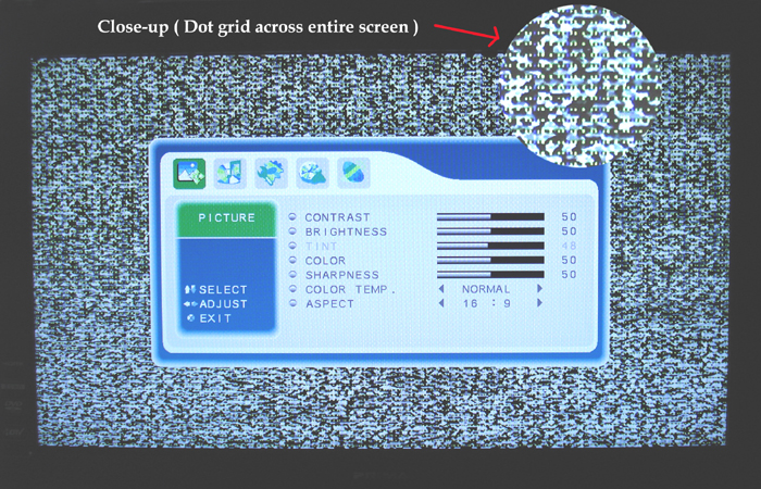

    I have a prima 26" lcd tv with a grid of dots across its entire screen which makes it unusable.
    The menus come up on top as they should but the grid appears in every mode of use. Loosening and shifting the t-con to panel board ribbon cable shows a white screen or a vertical striped multi-colored screen depending on it's position.
    The back light and the sound works. I need help solving this problem, please.

    Is the grid of pixels constant, does it move over time, between inputs or after turning on or off?
    Are the pixels embedded onto the source video or do they just replace it?
    Loosening the T-Con connector and seeing vertical lines is to be expected. I don't think the T-Con is bad.

      The grid is constant running horizontally ....green dotted lines about 1/4" apart over whole screen and appear in every mode except when on the component selecting screen. As soon as it's getting input from a device or in tv air mode the grid is on top of the image.

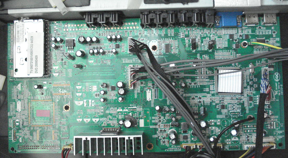

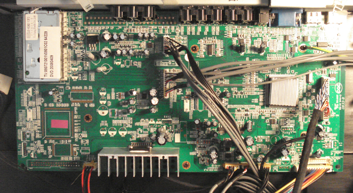

        I need a bigger picture of the main board, some of them are quite small.
        Also, have you checked power supply output voltages? It's unlikely to be the cause, but it will eliminate the power supply being at fault.

          The OSD seems OK; it looks like a processing problem (bad memory, maybe?)

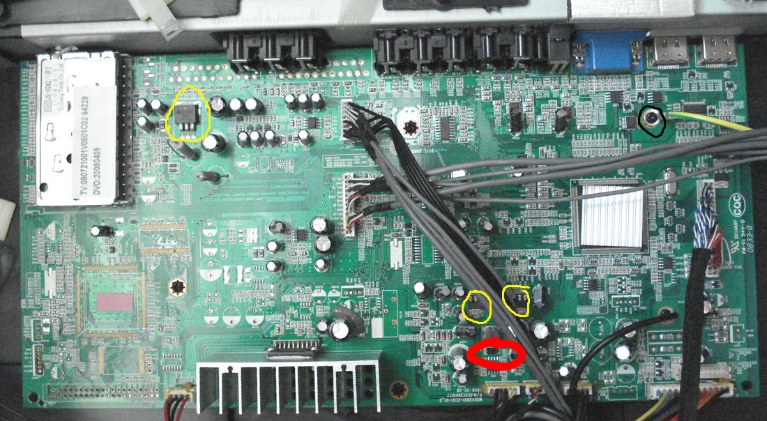

            Here's a larger pic of the main board. I could use some advise in checking the output voltages on the powersupply (How and where) I have a multimeter. thanks............Ray

              It is extremely unlikely the problem is with the power supply; it is almost certainly on the main board.

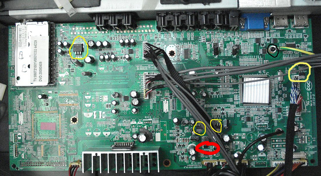

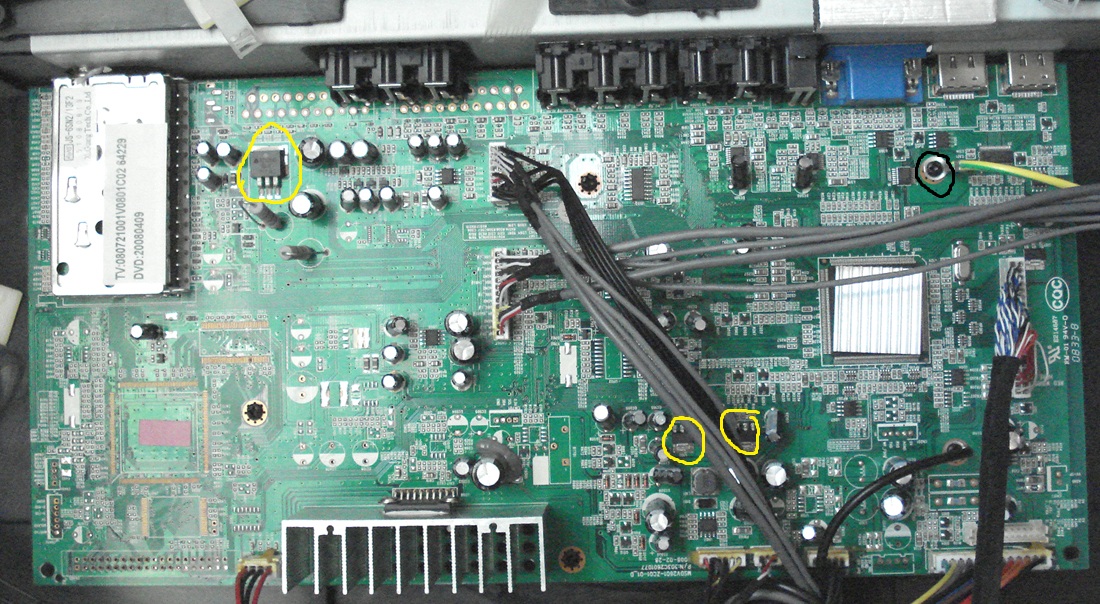

              I've circled 3 LDO regulators in yellow. What are the part numbers of these? If there are any more similar parts, what are those part numbers?
              Testing is easy. With the tab to the top, the pins are numbered 1, 2, 3 left to right. The tab is identical to pin 2, so it is not necessary to measure it.
              I've circled a yellow / green wire and mounting screw in black. Use that for the negative lead. With the TV power on, measure the voltage on the three pins of each Ic, and report them and the part numbers.

                Also, check this diode too. It's unlikely to be the problem, as you are getting something on the display, but it will help eliminate faults. There is a vague possibility that a lack of good supply voltage provided by the switcher would lead to a poor picture.
                To check the diode: Set your multimeter to diode test. Place red on one end, black on other. Record reading. Reverse leads. Record reading. You should get something like "1 ." or "OL" for one measurement (which is good) and a value from 200 - 800 for the other.

                  Readings for the ICs and a diode marked in picture
                  Big IC top-left is 3.93, 5.17, 8.41 (AZ1084s -ADJE1 711J62)
                  Two ICs lower r-center are both 0, 3.28, 4.97 (AMS1117 3.3 0817)
                  Right side IC .26. 1.50, 3.24 (AMS1117 0815)
                  Diode circled in red 1, 331
                    All of those regulators are good.

                        Only the one which has already been mentioned. The problem is clearly occurring on the main board. It is probably a failure in one of the ICs. Determining which one and replacing it is going to be very difficult. At this point my suggestion is to replace the main board.

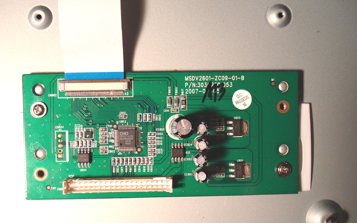

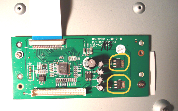

                          Could there be a problem with these two ICs on the T-con board ?
                          Upper one is AMS1117 0815 .............Reads 1.24, 2.49, 4.59
                          Lower one is AMS1117 3.3 0817 ........Reads 0, 3.31, 4.94
                            As OSD is correct it is unlikely to be the problem.
                            Upper one is adjustable and is the 2.5V reg.
                            Lower one is fixed and gives 3.3V.
                              Re: Prima (lv-2628p) Dotted grid accross screen
                              In other words the T-con board doesnt know what its displaying input wise / or OSD. So it wouldnt display 1 input wrong and the OSD correct. The main board is the only part that handles inputs and the OSD seperately / differently.

                                One other point - sometimes there will be LDO regulators on the back side of the main board. Those should be checked, too. If you do not find any bad regulators there, you really are reduced to replacing the main board.
