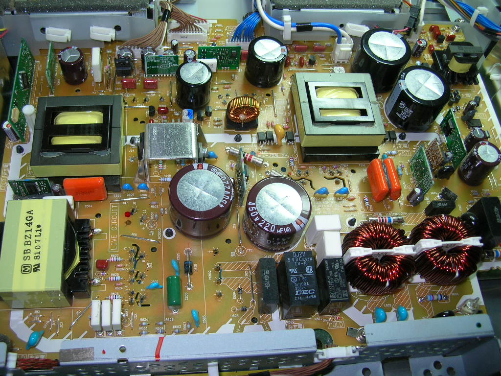

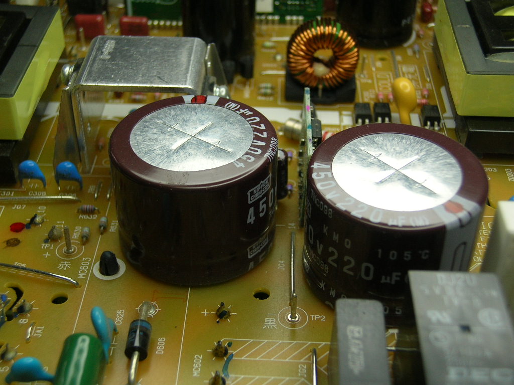

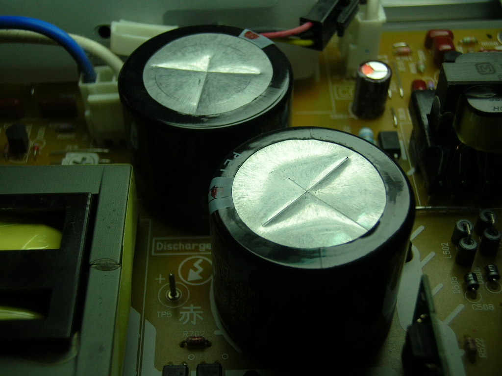

    I have a TH-42PZ85U that has the 10 blink red light symptom and in checking for bad caps I find two large 820 uf 250 volt caps that have very slightly bulging tops, and two other large ones that are not absolutely flat. However, when viewed from the side, none appear to be bulged up, but rather it is as though when they were made the vent creases are pressed down into the cap with the result that the surface seems depressed at the lines and thus seems a bit bowed around the lines. I will try to send photos which I hope are clear enough for someone to comment on. This unit began to fail and unplugging it would reset things and it would then power up, but finally it became unresponsive and tries to fire, clicks and goes to red blinking light mode.

    Panasonic plasmas rarely have capacitor problems and the caps in your pictures are fine. The 10 blink code could mean that any of a handful of boards could be bad. I have seen 10 blinks code on this generation of Panasonic very often lately. Some have been power supply issues, some have been A Board, K board, S board, G board, GH board, and/or GS board. If the TV blinks as soon as it is plugged in without the power button being pressed then it is a problem on the 15V standby line either on the P board or further on down the line on the A board or a board plugged in to the A board. If the TV blinks after you press the power button then it is a problem on the P15V line either on the P board or one of the other boards mentioned. It could also be a problem on the 3.3V, 5V, or 9V lines on the A board or one of the other boards plugged in to the A board. There are some training manuals on Scribd that may help but it is a very involved process and could take a couple hours or more to pin down the problem. Also, it is very general as it tries to cover every 11th Generation Panasonic and not just the 42". So while the procedure may apply to one model it may not apply to all models because the larger sets often times have extra boards the 42" may not have. Service manuals can be found through Elektrotanya but they are honestly not very helpful until you need the schematics.
