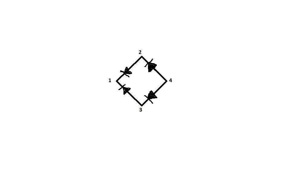

    So although the - and ac (~) leads give diode readings when the leads are aranged either way , the bridge rec is still fine? Is this because while still on the board you just look for different diode / voltage readings when you reverse the leads?
    like 1-2 was reading .562
    and 2-1 was reading .575
    That is acceptable when its still on the board?
    And the - and + pins being continous / closed while its still on the board?
    Additionally what should be my next step be to test this board?

      I've attached a drawing of a diode bridge. A good bridge rectifier out of circuit would show about a .5 to .7 volt diode drop from 2-1 and 3-1. (1 negative and 2 and 3 positive). It would show the same drop from 4-2 and 4-3. (4 positive and 2 and 3 negative). It should show a roughly 1 - 1.4 volt (2 diodes) drop from 4-1. All other readings would show open because the diode was reverse biased. HOWEVER, if 1 and 4 are shorted, things get messy, you won't get open readings, but you will still get the forward diode drops.
      What is inexplicable about this is there are only two things that can cause a short - the large cap or the FET.
      As for what to do, remove them and test. Also, look for some additional components that may be shorting the output of the diode bridge.

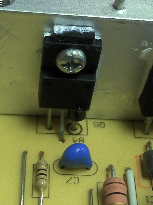

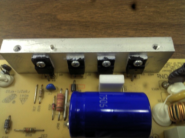

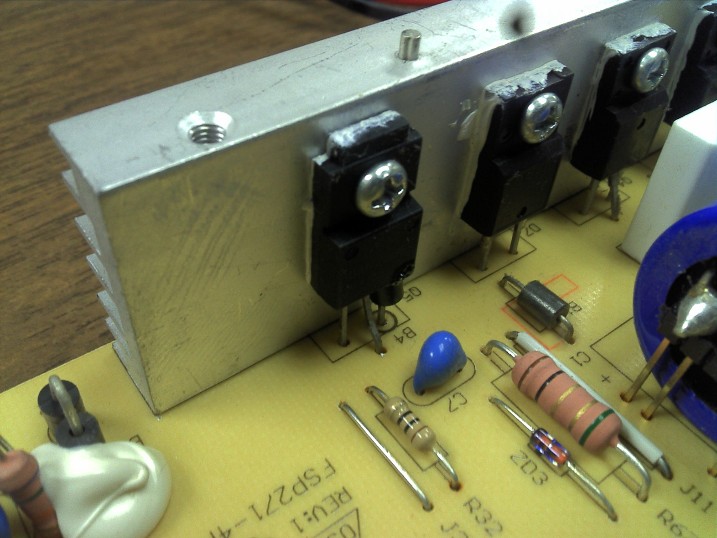

        I actually in the mean time tested the other FET's that are mounted on the aluminum heatsinks.
        There are 4 items mounted on the heatsink with the "melting" FET.
        From right to left when looking at the top of the board the first 2 are transistors and appear like they might be broke because of the readings i got.
        Then there is a diode, and finally the "melting" FET that i gave you readings on earlier.
        The furthest right fet has 0 resistance on all 3 leads in all combinations and orders, I cant imagine there would be any use for a part that just connects all 3 leads lol.
        The next fet over had some similarly odd readings, but not in every order.
        And thanks for all your help so far, ill probably pull some of these transistors off shortly to test them unless you think thats a bad idea.
        Attached is 2 pics of the "melted" FET the melted part is on the bottom right, and then a pic of all 4 FETs in a row on the heatsink.

          Part of the mystery has been solved. I was loosing sight of the overall supply. This supply has a PFC front end, which complicates the picture significantly.
          While the pictures are pretty good, they don't show quite enough detail. There are two heat sinks on the hot side of the power supply. The one with the diode bridge has two transistors that drive the main SMPS transformer. The other one is more interesting. There are two three-legged components (transistors?) that appear to be associated with the PFC front end, a diode, and the 'melted FET'. What are the component identifiers on these, and (more important), the part numbers?

            First aluminum heatsink:
            BD1) (bridge rec) pec 704v RU(logo), KBU 8J, - ~ ~ +
            Q2) S (sylized for brand logo), K3569, 7:E
            Q1) same as Q2
            Second aluminum heatsink:
            Q3) f(sylized like fisher scientific's f) M H10, F0PF, 13NF0C
            Q4) same as q3
            D7) STTH8L0bFP, GK1AN VU, CHN 719, ST (logo)
            Q5) (brand logo) H , 04N70BF, 7 1509(1)< melted fet so hard to read last #
            Q3 and Q4 are the ones i suspected of possibly being bad
            Q3 has all 3 pins reading 0 ohms / continuous / 0 voltage diode reading
            Q4 has 3-2 2-3 reading 0 ohms / continuous / 0 voltage diode reading
            pins being numbered from left to right when your looking at the markings.
            So am i right to assume this short must be occuring in the primary side of the powers supply, because anything occuring after the transformers would not be able to blow the AC fuse?
            Hope your having a good weekend

              Q5 is easy - it's an AP04N70BF-A power FET
              Q3 and Q4 sound like either Fairchild of Fujitsu part numbers, but I haven't been able to get hits on the numbers you gave.
              Right, the short is occurring on the primary side of the transformers.

                    If you look, there is a black line that runs across the board, and two transformers straddle this line. The smaller of those two is part of the standby SMPS; the larger is part of the main SMPS. The third 'transformer' is part of the PFC circuit.
                    The failures puzzle me. I can see the pair of FETS shorting if one fails - they are in a totem pole configuration. I don't understand the FET for the standby SMPS shorting as a victim of the others shorting, or causing the others to short.

                                        Well i took off Q3 (QPF13N50C) and the board isnt shorted once it is removed, and the now removed FET tested bad like expected.
                                        So i guess i will order FQPF13N50CF-ND from digikey, Is that the same part as what i removed? even though it has extra letters at the end.
                                        Yes
                                        Originally posted by cashkennedy View Post
                                        Should i replace both while im at it?
                                        Definitely.
                                        Are FET's very heat sensitive, and so should i solder them in quickly / with as little heat as possible?,
                                        They are not terribly heat sensitive, but if you spend so much time soldering it in the heat sink gets hot, there is a problem.
