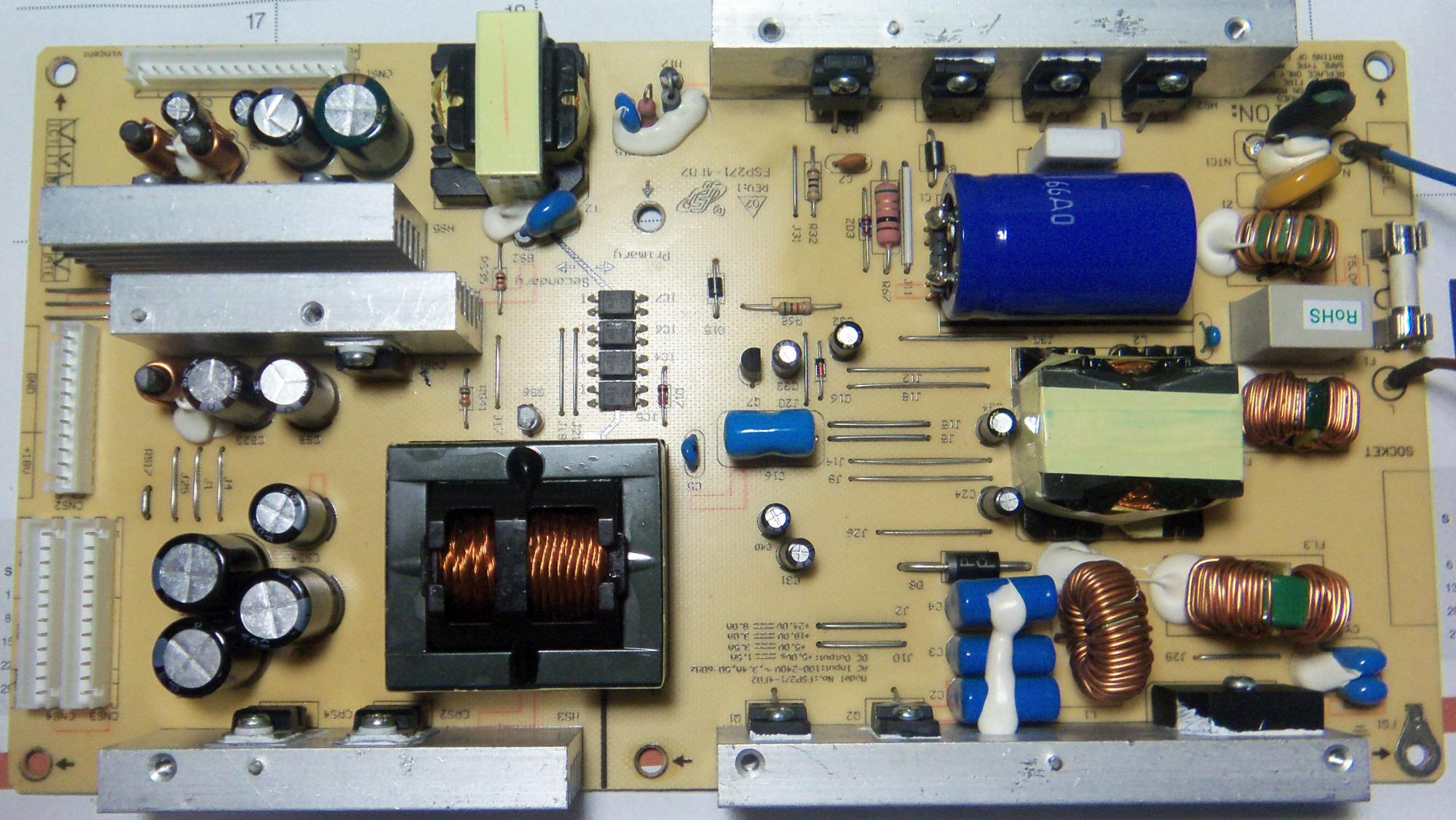

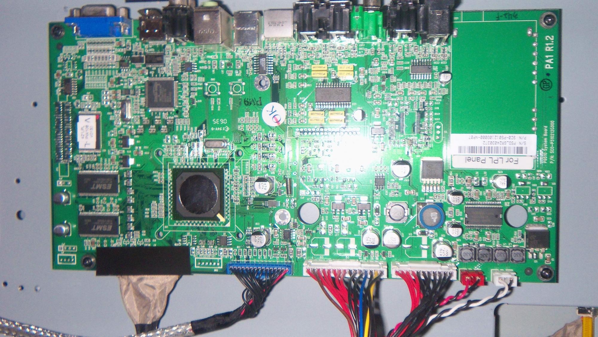

    So it goes like this, I have an Olevia 342-B11 42" LCD which I got from someone a while ago, Apparently what happened was that their power went out, and then when the power came back, they turned the TV on, or something along those lines, but heard a loud pop, and after that it wouldnt turn on at all. No standby, no lights, no nothing. Well I got it from them, I opened it up, and examined the power board. One of the MOSFETs had its middle leg blown off (It literally looked melted off) While the right leg was just a bit scorched, but when I desoldered it, it fell off. The left leg is OK, You can actually see it in the picture, I put it next to its replacement, which is the exact same model #04N70BF (which was really hard to find, but I got lucky on ebay). Right infront of the mosfet was a 100pF 1kv capacitor, which I think might have had the explosive charred soot on it from the mosfet, but I wasnt sure, so I replaced it too. But I replaced it with a ceramic one with the same parameters.... I dont know If I should have found an identical blue one that all the other ones on the board are.
    The Power Board Model is FSP271-4F02
    But either way. I thought that would have fixed the problem. But it still wouldn't turn on. The only voltages I get range from 58.1-59.7 all across the Primary area of the power board. None of the voltage gets through to the secondary part. The secondary is completely voltageless (if thats a word :-P)

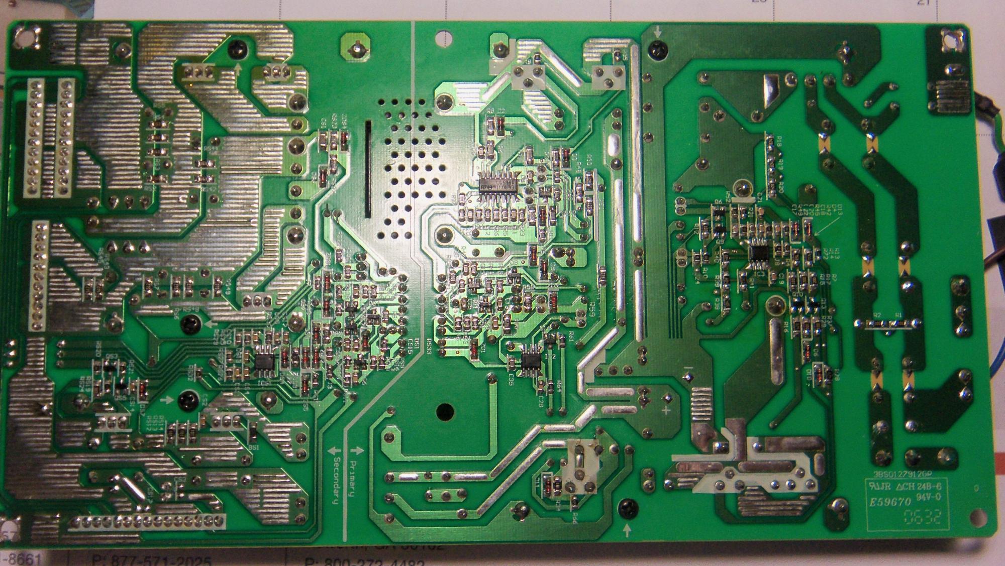

    I get readings of 58.1-59.7 at all the leads of IC 4 5 6 and 7 on the primary side, but 0 on secondary side.
    I get 59.4 on the blue capacitor BS2 on the primary, but none on the other side.
    On the small transformer I get 62.2 on each lead on the primary, but nothing on the other side.
    On the larger one, there is no voltage on either lead in either side.
    Now obviously this PSU still has the crappy CapXCon capacitors on it...Which I should replace, But I dont think they're a problem at this moment
    So well...I dont know whats wrong with it....Maybe you guys can help?
    Let me know if you need anymore information, I posted the pictured of both sides of the PSU, the control board and the replaced Capacitor and fet in its proper place.
    I shopped around, the cheapest replacement is $65 with free shipping.
    Thanks for the input in advance!

    This is a standard design for a TV power supply. There is a standby supply, on whenever AC power is applied to the board, a main supply that is controlled by the main board, and a PFC front end. The voltage you reported is very unusual, hopefully this is due to a technician error. The pictures are very helpful.
    1. What is the voltage across the legs of the large cap (C1)? This should be 1.4 x your line voltage - about 165 volts in the US and Canada
    2. What is the part number for IC2?

        The voltage across C1 seems a little low. What is the AC voltage on the input to the power supply?
        Googling 230D6 leads to NCP1230D65R2, a standby SMPS controller. Is pin 4 of IC2 connected to the negative lead of the large cap? And is pin 5 linked to the FET that blew?

            122 VAC should give about 169 VDC across the large cap. I don't think we are dealing with technician error here, and the discrepancy may be significant. I'd try measuring the AC voltage at the center pins of the bridge rectifier. Also, what brand of DMM do you have?
            You are probably checking for connectivity wrong. It's not a direct connection - there are often several components involved to shape and limit the drive pulse.
            However, at least superficially the IC does seem to match a NCP1230D65R2. My tentative working theory is that IC2 got zapped when the FET shorted, so let's try some more measurements. What are the voltages on the other pins of IC2?
            Something else you should consider. A quick check did not find any source for the NCP1230D65R2. While both DigiKey and Mouser list it, it's not in stock, the minimum order is 2500, and Mouser indicates no lead free version is available. A number of sites in China indicate they have them, but that is not necessarily a reliable indication.
            Whoops!!! Correction - Google is your friend. There is an eBay seller who has them, and they are in the US. Strange that searching on eBay directly doesn't find the auction.

                Wow!!! Quite a few points to cover.
                When dealing with a SMPS, you must be aware of the difference between the hot side and the cold side of the board. In simplest terms, the ground point for everything between the bridge rectifier and the SMPS transformer is at an elevated AC potential with respect to earth ground. All measurements on the SMPS controller must either pin 4 of IC2 or the negative lead of the large cap.
                Something very strange is going on with eBay; I'm not sure if it is at my end, eBay, or related to the phase of the moon. Auction 200372683818 is for one 230D6 IC, which the seller also lists as a NCP1230D60. Perhaps you can compare the picture in the auction to the IC you have.

                    The key here is pin 6 - Vcc. Vcc is generated internally, drawing power from pin 8. At this point I'd say it's time to replace IC2.

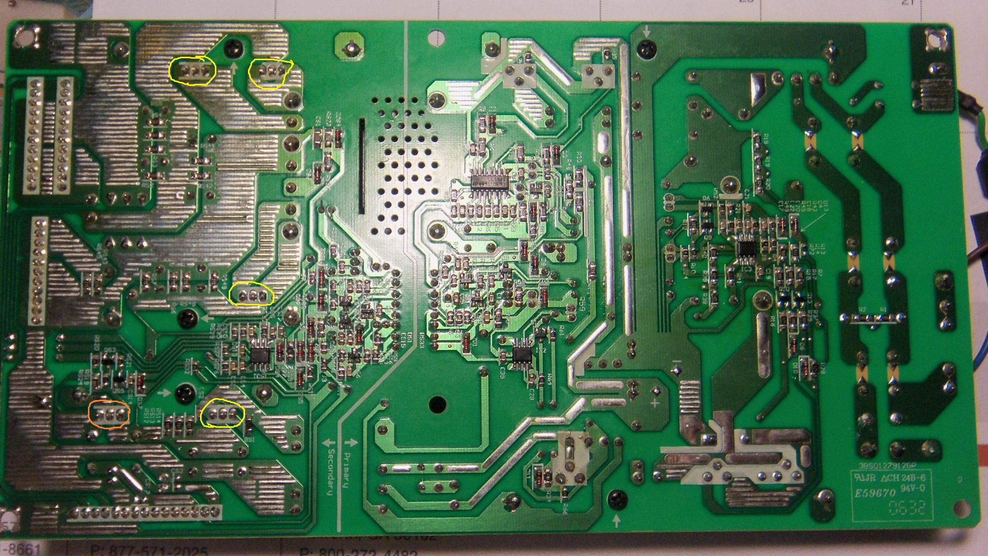

                        You'll have to look at the datasheet to be sure. Make sure it's the same package. Pinout is important!!
                        I would carefully check the components between pin 5 of the SMPS controller and the gate of the FET. Also, check to make sure the output diodes aren't shorted.

                            "The only silly question is the one that isn't asked". OK, that's not true. Art Linkletter asked his wife "Are you sure you want to go through with this?" as she was going to the delivery room. THAT was a stupid question.
                            The items circled in yellow are the diodes on the secondary. I think the one circled in orange is a voltage regulator. Check the diodes by checking for shorts from the center pin to the other two pins.

                              I checked the diodes, I think theyre ok....I think....
                              But either way thanks for your help. I will order the IC and will keep you posted. I will update this once it comes in.

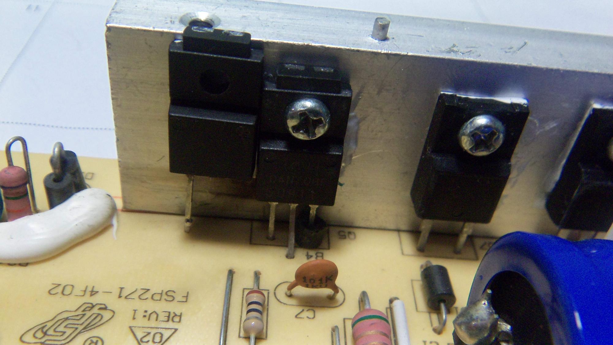

                                    When i earlier asked about testing the transistors i meant the MOSFETs. After finding this article i reinspected my MOSFET's and the same one that the OP had problems with has a little bit of melting on the circled pin on the board that has the extra diode on the lead.
                                    Now i dont want to just replace that if anything else is bad so i did all the other measurements you requested.
                                    For the bridge rec (which i assume is the 4 pin item also thermal pasted to the aluminum heatsinks) the markings are pec (brand) 704v RU (symbol) then over pin 1 and 2 is KBU and over pins 3 and 4 is 8J . Additionally Pin 1 is marked ( - ) , pin 2 is marked ( ~ ), pin 3 is marked ( ~ ), and pin 4 is marked ( + ).
                                    For the 200 resistance measurement across each pin i get the following
                                    this is while im testing it in circuit / still on the board
                                    ~ means i get a instaneous resistance reading but it goes away

                                    For the MOSFET that is labeled Q5 and is the same one as the other guy replaced.
                                    resistance readings (still on board/ in circuit)
                                    x means there was no instant resistance it just was too high resistance to read/ or not continuous.
                                    positive lead on pin
                                    ``1```2```3
                                    1 --- `x` `x`
                                    2 `~` --- `~`
                                    3 `~` `~` ---
                                    ^neg lead on pin
                                    For the diode measurement (also still on the board / in circuit)
                                    ``1 ```2 ``` 3
                                    1 `--- `x` `~`
                                    2 .451 --- `x`
                                    3 .814 `x` ---
                                    ^neg lead on pin
                                    (Obviously I havent unsoldered anything but I can do so if necessary, not sure if that affects readings on these parts.)

                                      Re: Olevia 342-B11 PSU problem, No voltage in secondary PSU
                                      And now i know why no one uses tables on this forum! lol hopefully you can read them now that i added ` for spaces ... just ignore all the apostrophes
                                      Fixed so far 12 lcd's , 1 plasmas, 5 monitors, 0 dlp's (plan to keep the dlps at 0). and 3 atx power supplies, and 2 motherboards.
                                        The diode bridge appears to be good, but something is shorted on the main output.
