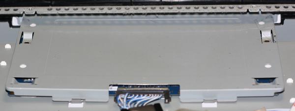

      thanks for the reply PlainBill, i'll reply to items 3-5
      3 - right, i'm not seeing any light/leakage at all around the panel. on or off it looks the same even in a room with all the lights out.
      4 - i do see the image when i shine a flashlight against the screen

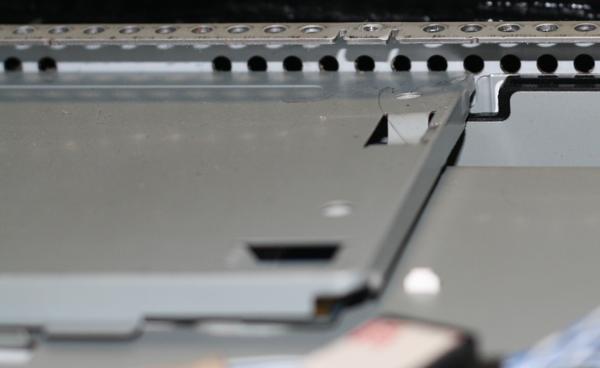

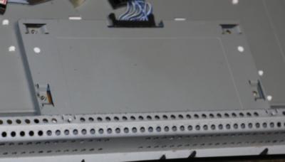

      5 - i can see that pics of the tcon cover would be helpful, but i'm not sure if pics of the board or other things can help - please let me know. so here are some pics around the cover.
      from the top, showing 4 screws removed, and nothing else seeming to hold the cover in place from above
      from bottom
      zoom of top corner
      if it seems the inverter is the issue, are there additional tests i can try to see if its something i might fix, or? i have a multimeter, but i might have a friend with a fluke to lend. thanks again.

        Re: samsung lnt3232hx - black screen, audio ok
        DON'T WORRY ABOUT THE TCON!!! It's not the cause of your problem. Put the screws back in and forget you ever worried about it.
        Remember, I don't have your TV, the same model TV, or even a picture of the back of a TV like yours. If you want me to help you, I will need a picture of the back of the TV, and another of the inverter. Make them both at least 1000 x 1000 pixels so I can see as much detail as possible.

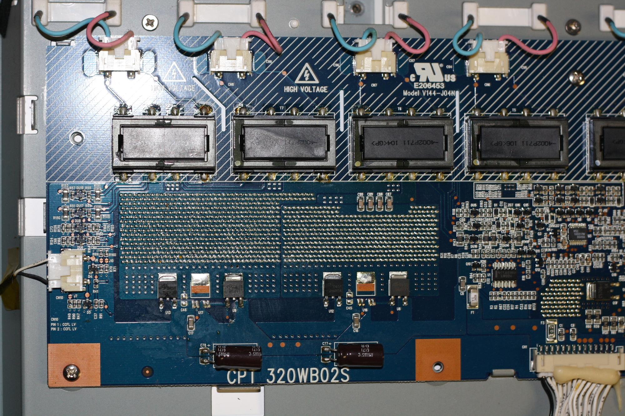

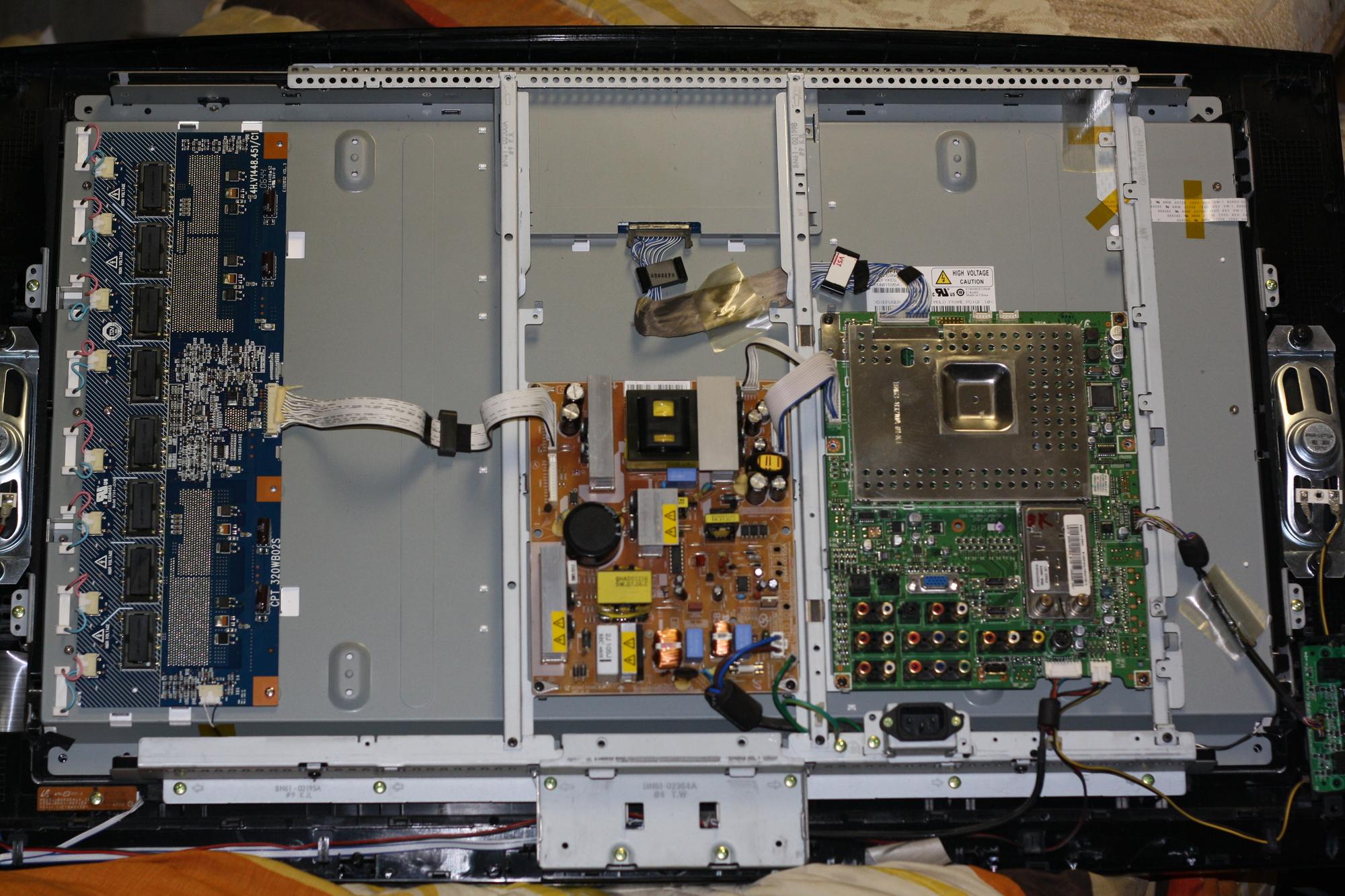

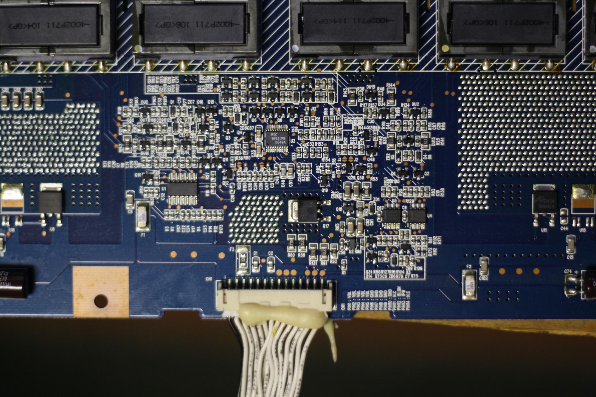

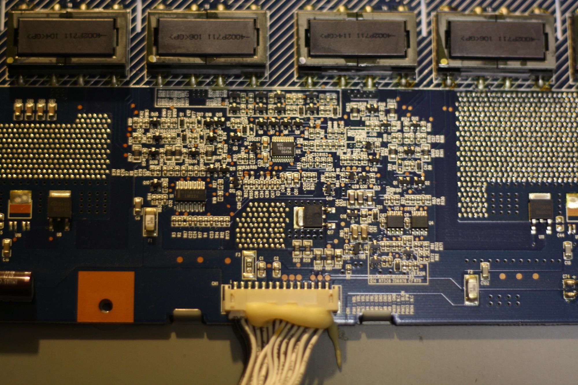

          ok here is the back full view
          the left side of inverter
          center
          right
          i found f1, f2 & f3 towards the center, which i would guess are fuses. 1 & 2 check out with 1 ohm resistance, while 3 ( D ) is open/bad, or i'm not getting good contact from the top or sides.
          if some detail, better focus, or less glare is needed let me know, i can try again - thanks for your help
            Heck, you are doing most of the hard work!!! You have a tendency to veer off at tangents, but you have already identified the important symptoms.
            Obviously, F3 open is the problem. We don't want to simply short across it without determining WHY it is open. What IS encouraging is that F1 and F2 are the fuses for the drivers. I had expected to tell you that you would have to replace some of the power FETs. This might be much easier.
            The D on F3 seems to indicate it is a .250 Amp fuse.
            1. What is the resistance from the upper end of F3 to ground? I want to see if there is a 'hard' short on the power rail.
            2. You may have already done so, but what is the voltage on the VBL pins of the connector?
            3. If you don't find any obvious bad parts I'm going to need clearer pictures of the center section of the inverter. I can't see just how much area this fuse supplies.

              1. F3 upper/lower both test as open, no short (same as F1 & F2)
              2. not sure which are VBL pins since only 1 pin on p/s is labeled BL - here are pins (left to right in center pic) - p/s label / voltage - tested same on either end of cable
              24V--24V--24V--24V--24V--GND-GND-GND-GND-GND-NC--BL--ADIM-PWM
              24.4--24.4-24.4-24.4-24.4---0----0----0----0----0--0---5.3--2.8---0
              F1,2,3 all have 24.4v going thru them, with F3 measuring 0 at the top.

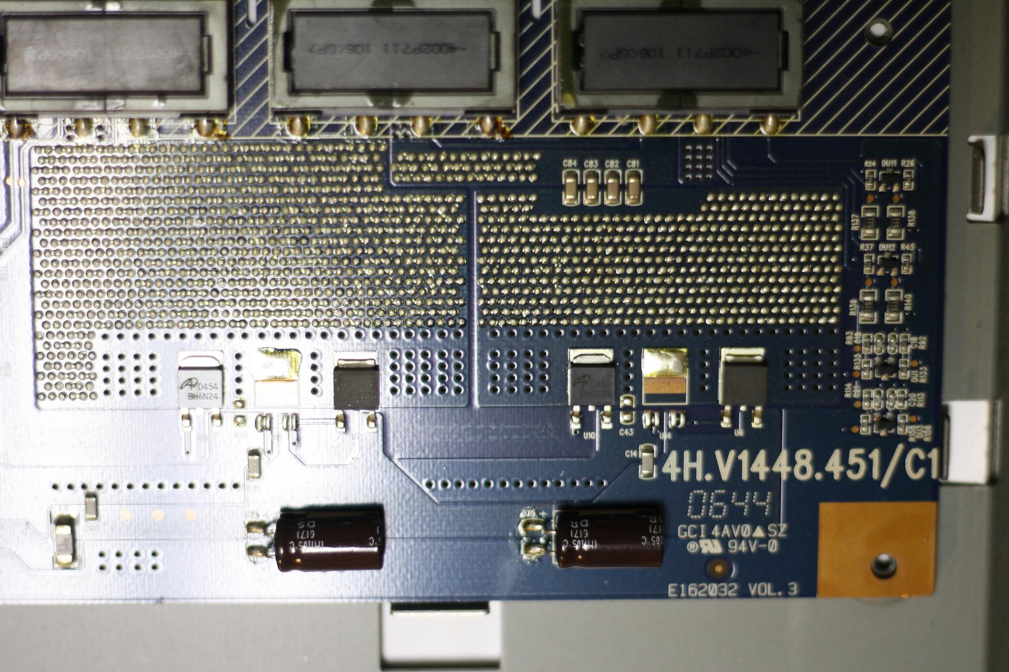

              3. here's a clearer pic of the center
              doing a check with multimeter shows F3 goes to the right - thru R131,61 & 62 (1 Ω bottom, 14 top for 131 & 61, while 62 is open on top - bad? label is 332). R60,59 measure 14 on bottom, 28 on top. then to the center pin of Q17 is 28 (label is C5076 / 5M). the only other continuity from F3 i found was the copper dot below R60 @ 1 Ω & the dot above R61 @ 14.
              is the amber (flux?) residue on some of the pins of the large sockets at the top of the board anything to worry about? or just some crispy residue left from manufacturer?
                did some more poking around - hopefully it will help.
                the top of R62 goes to the copper dot above & the bottom pin of Q17 @ 1 Ω. the top pin of Q17 goes to the top of R65,C62,C61,C67,C9 & top left pins (pin2?) of U4 & U5 @ 1 Ω. it also goes to the center pin of Q18 & bottom pin of R42 @ 1 Ω (also labeled 332, and open to the top). the top of R42 has 1 Ω to the top right pin of Q18. top left of Q18 continues thru C64,C63 & R11. let me know of any other checks i might do.
                i've doctored this foto a bit to make it more apparant that there is some darkening/burning of one side of the inverter backing. the back of the board is clean & shiny. something to worry about?
                and sorry i didnt see that 24V from p/s = VBL on inverter until now when its too late to edit my last post.

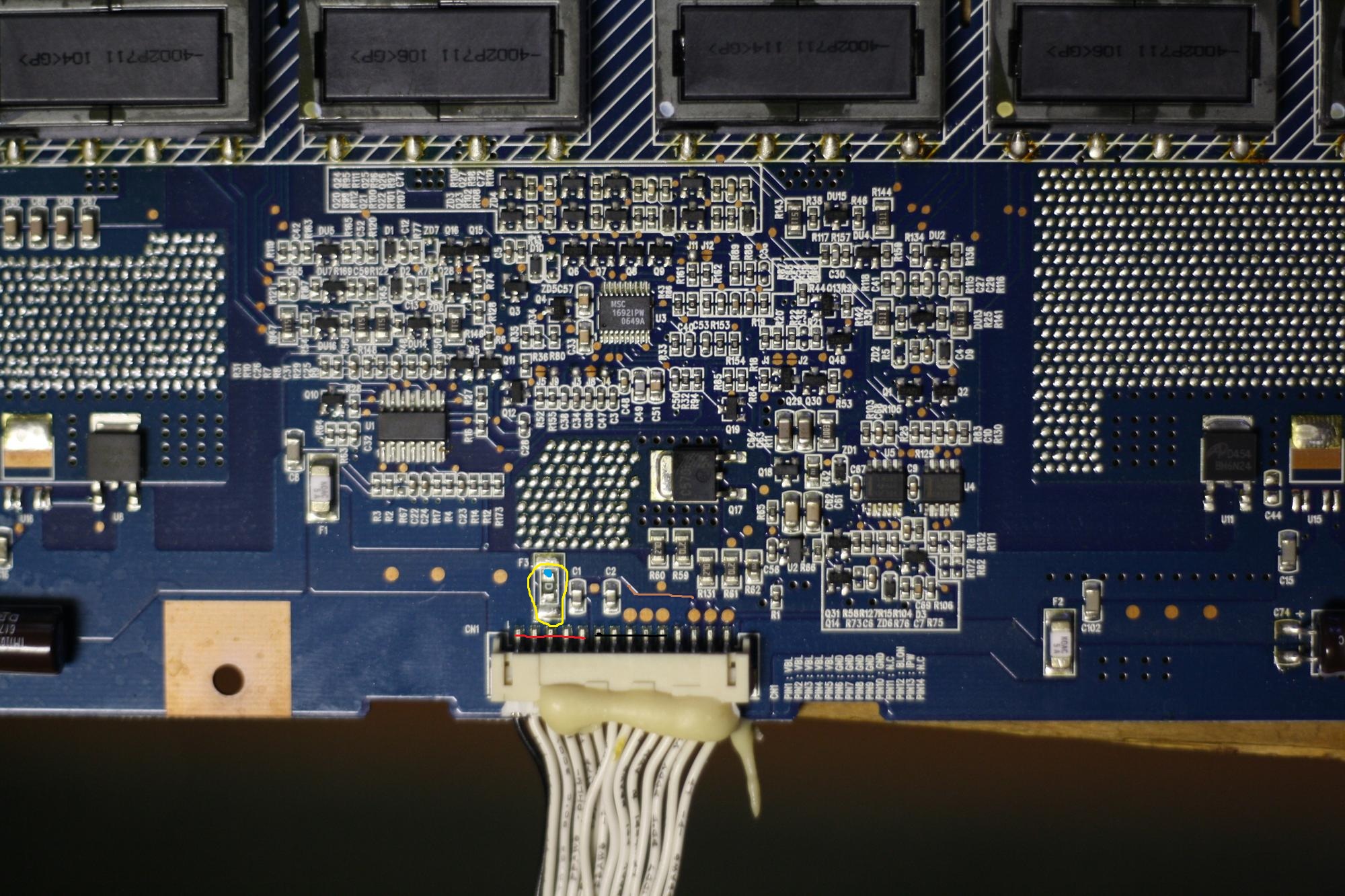

                  I've uploaded a picture with some points I would like checked.
                  1. F3 - could you either measure it or lay a ruler next to it? I want to be sure I am suggesting the correct replacement.
                  2. Note the red and black lines I have drawn on CN1. The red line indicates the pins labeled VBL, the black the pins labled Gnd. Note the table to the right of CN1
                  3. What is the resistance from the upper end of F3 (blue dot) to Gnd?
                  4. The brown line indicates the separation between the area powered through F3 and Gnd. How far does the area powered buy F3 extend?
                  5. Do you have a resistor in the 100 ohm range?
                  PlainBill
                  • gb77
                    curious
                    • Aug 2011
                    • 76
                    did u see the 2 posts above yours that describe what i found with the multimeter (no power of course)? i was editing them along the way, so we might have crossed timing a bit. should i continue to follow around (U4, U5, Q18) to see how far they go until i cant find anything more?
                    1. about 1/8x1/16" or 32x16mm
                    2. yup, i got that & all VBL = 24.4v
                    3. infinite - open
                    4. R131,61,62 bottom are the only points i found with <1Ω. then the circuit goes to R59&R60, then to Q17 where continuity to F3 ends. R1,C56,U2 etc have no continuity to F3
                    5. i have a couple that test @ 102Ω

                      Try hooking the 100 ohm resistor across F3, then measuring voltage drop across that resistor. Apply power only briefly, it could get quite hot.
                        tested twice - both times voltage only drops to 24.3 in a couple seconds while the panel lights up (hooray)
                          Great!! This appears to be a Littlefuse 466 type fuse, available from DigiKey as their number F1452CT-ND at $.83 each. They only have 14,728 on hand.

                              If you can pick up a 250 ma fuse locally, by all means do so. If you can find a picofuse, I'd be tempted to butcher it in and leave it, a purist would of course install only a .250A SMD fuse purchased from an authorized Samsung parts distributor.
                              While I might be tempted to leave the resistor in place over the weekend, I'd say go with a picofuse, a pigtail fuse, or even a .25A fuse in a holder.

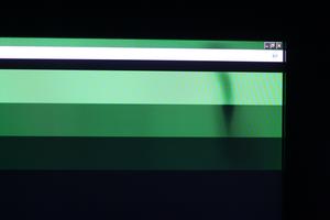

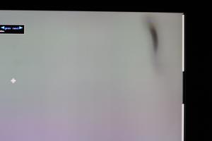

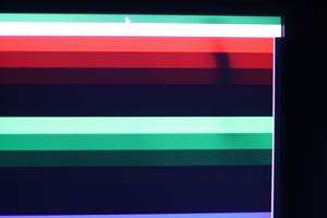

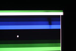

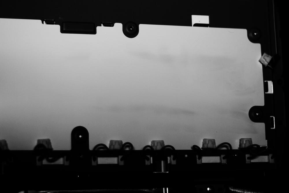

                                thanks again PlainBill - couldnt find any small fuses so i "butchered it in" - soldered a fuse holder to the ends of F3 and dangled it outside the cover - holder & 4 fuses for 2 bux! been working fine for a few hours now.
                                but ... the lcd has a shadow - not noticeable in bright/dark but at mediums..
                                is this an aging spot on a 4yr old lcd that will slowly die (i dont mind it much since its in a corner, and less than 2% of the screen), or something that can be fixed (for 3 bux maybe ;o) .. )? if fixable, should i start a new thread? thanks for any comments
                                • PlainBill
                                  • Feb 2009
                                  • 7034
                                  That is strange, it seems to be too intense to be a bruise. I'm not sure what else if could be.
