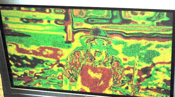

    Hi, I got my hands on this LG RT-42PX11 plasma T.V, and I would love to be able to fix it. It is just such a shame to see these things all being thrown into the landfill...
    Anyways, Picture is fine for the first couple of mins, then goes to almost a solarized picture, then to a multicoloured moving random colours. all the while flashing.(see pics) Then it will come back to a good picture for a while. It also seems that giving it an old fashioned slap on the back will get it to come good as well. Sound stays fine the whole time.
    I have read lots in here about ysus, zsus, and control board issues, but I haven't had anyone describe these symptoms.
    If anyone could point me in the right direction, that would be great. I would love it if it was something simple like a bad cap or broken solder joint. But really, what are the chances of something being easy with this kind of stuff
    Any input is greatly appreciated!

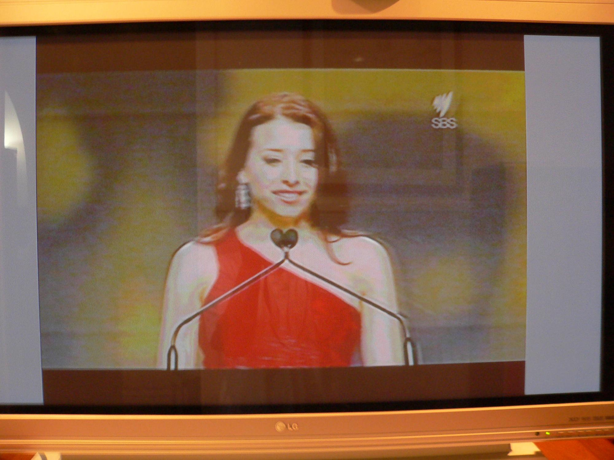

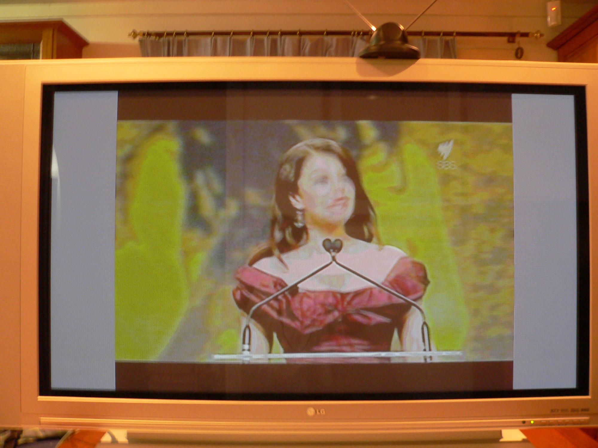

    1. Thanks for the pictures. They help a lot.
    2. If you keep slapping a TV on the back, sooner or later it will hit back - in your wallet.
    3. The second picture is pretty definitive - a Z-sustain problem. Coupled with the slap information - a bad solder joint, most likely on one of the power transistors or the power connectors.

      Awesome, thanks PlainBill, now I have an idea where to look, and I might actually be able to fix it!

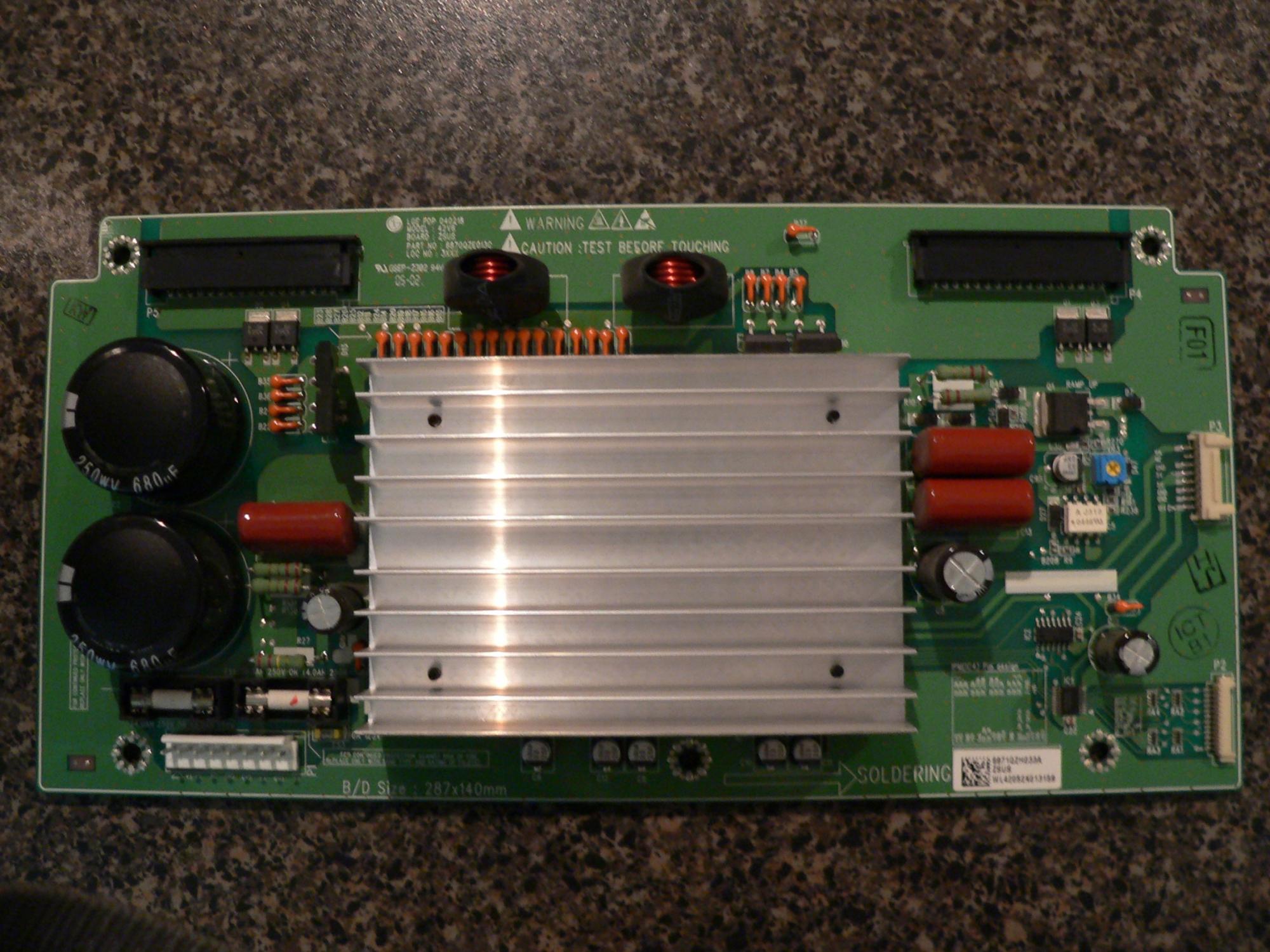

          I have checked over the whole chassis and inspected each board on both sides and all looks good physically. I cannot see any missing components, burn marks, heat effected PCB or obvious dry joints etc....
          I have noticed that the large black capacitors are rounded on top - I guess they are not meant to be like this? (see attached photo) All other caps look fine.
          Checked all the fuses and all is good except the fuse on the YSUS board has blown.
          The question is could I still get a picture with the YSUS fuse blown? - I would have thought the whole display would not be operational? Would the faulty caps cause the YSUS to blow the fuse or is the rest of the board dead as well based on the symptoms?

            I would place a bet on the Y-sustain. A failed Z-sustain usually causes either a very dim and blurry picture, or potentially no picture. If you adjust the timings incorrectly on the Y-sustain board you'll get exactly the same effect. Try tweaking the Y_setup and Y_setdn pots on the Y board. Hitting the TV is moving the pots back into position temporarily, improving the picture. But thermal expansion moves them back again.
            Whilst you do need an oscilloscope to get the timings perfect, often a bit of tweaking with a screwdriver is all that is necessary. Careful though; the sustain board deals with ~200V DC.

                Try replacing the Y-sus fuse; if it blows again, you probably have a bad Y-sus. Sometimes the fuses just blow after being used for a long time (thermal stress.)

                                  You should not get any picture if the Y-sus fuse is blown; are you sure it is?

                                        Got a chance today to get some new fuses of suitable type. Installed and powered on TV. The fuse did not blow and the picture is the same.
                                        So my theory is something is crook on one of the SUS boards (leaning towards the Y as this is where the fuse blew). When the responsible component died it took out the fuse but now that that component is dead the fuse will not blow again as this part is open circuit.
                                        Is it possible to do a component level repair on this board?
