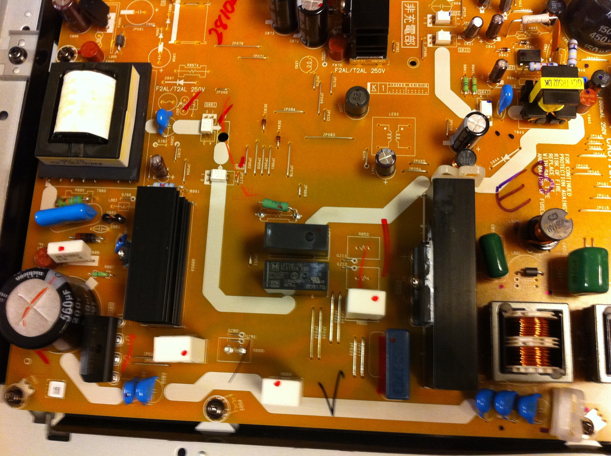

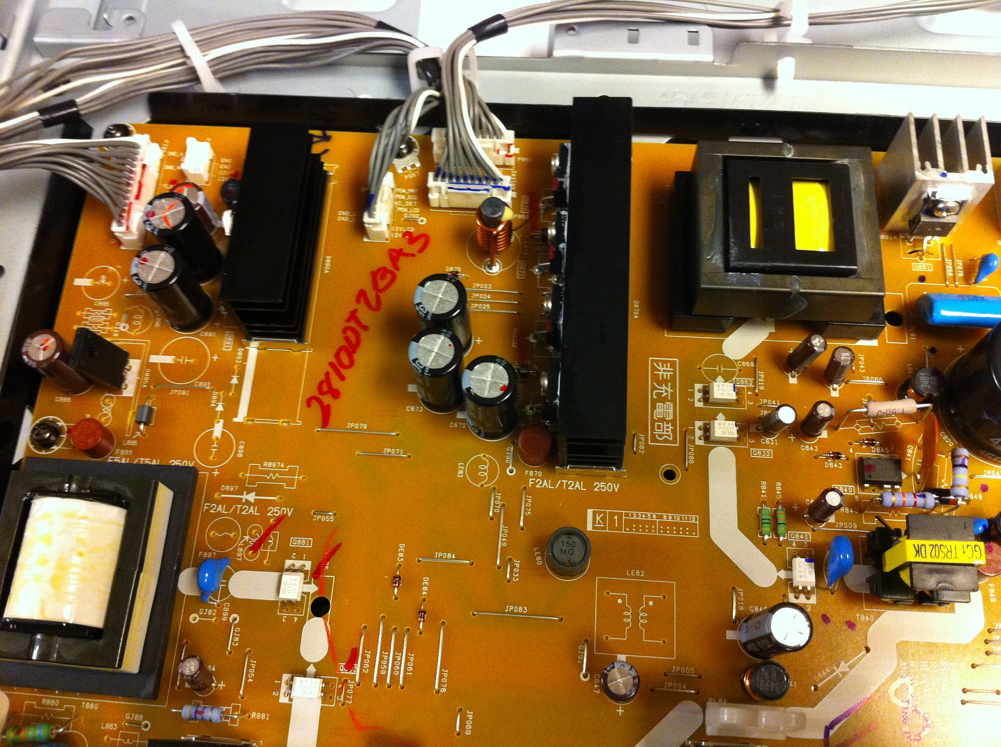

      No luck on finding a service manual. While they look complex, the power supplies are sometimes easy to troubleshoot. At this point I suggest you attach pictures of the top and bottom of the power supply using 'Manage Attachments' (below the text entry area). Sharp, well lit pictures make it easier for us to help you.

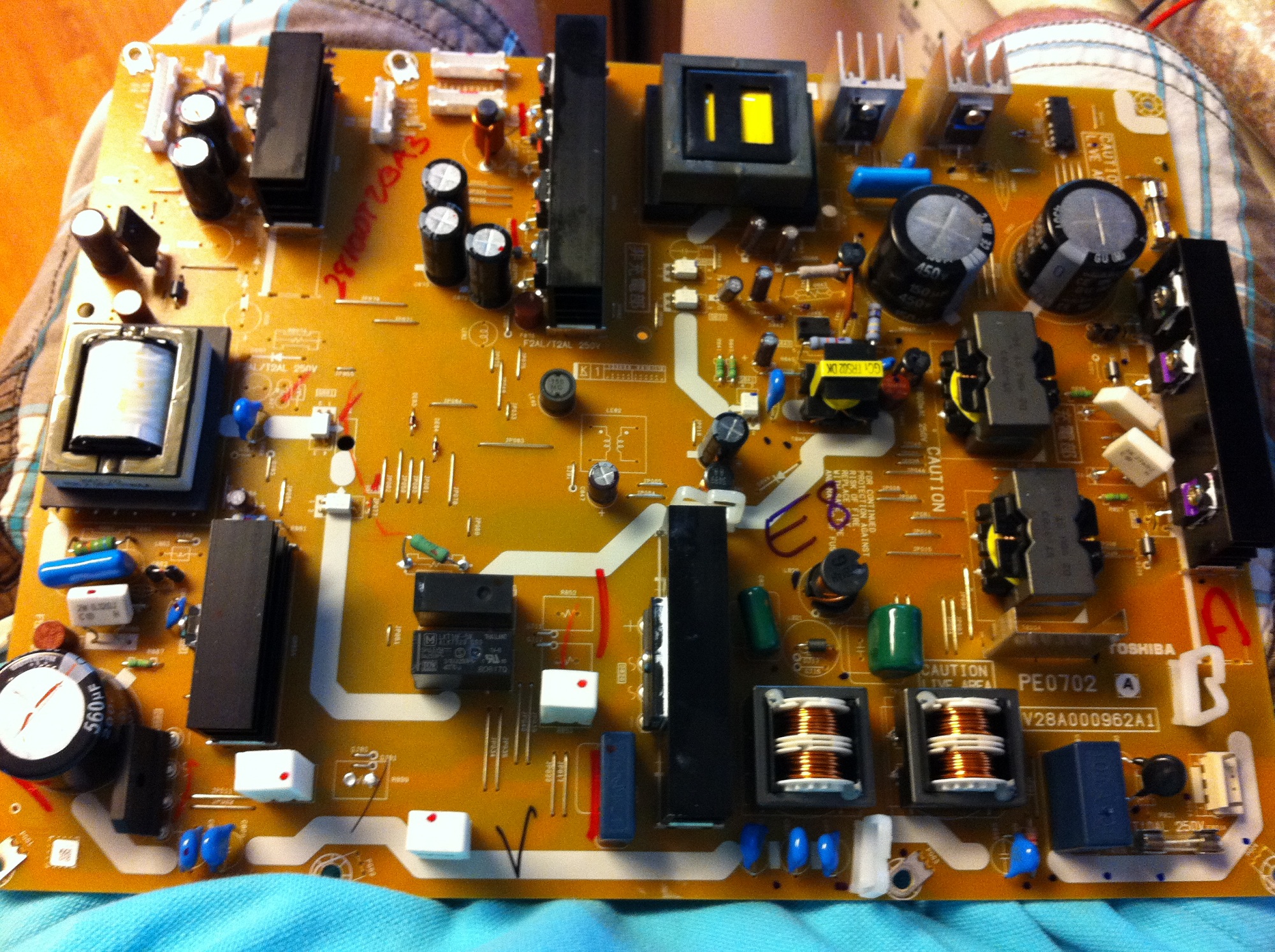

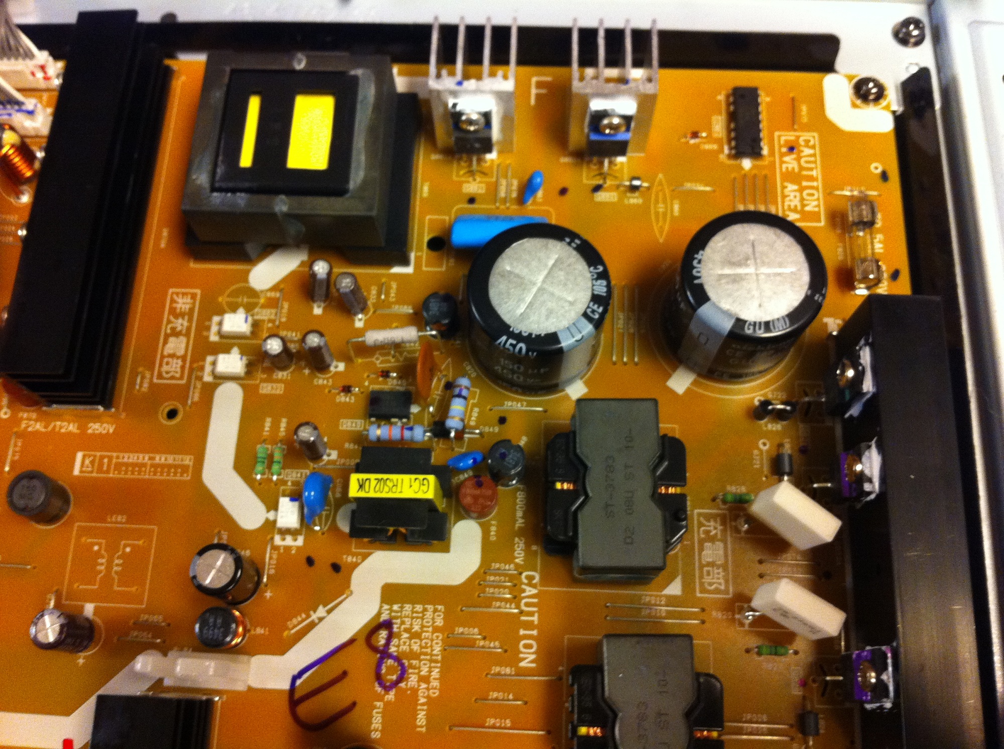

          here's a full pic of the board. It appears that i'm getting nothing on the DC side.
            Re: Toshiba 47zv650u no power at all!!

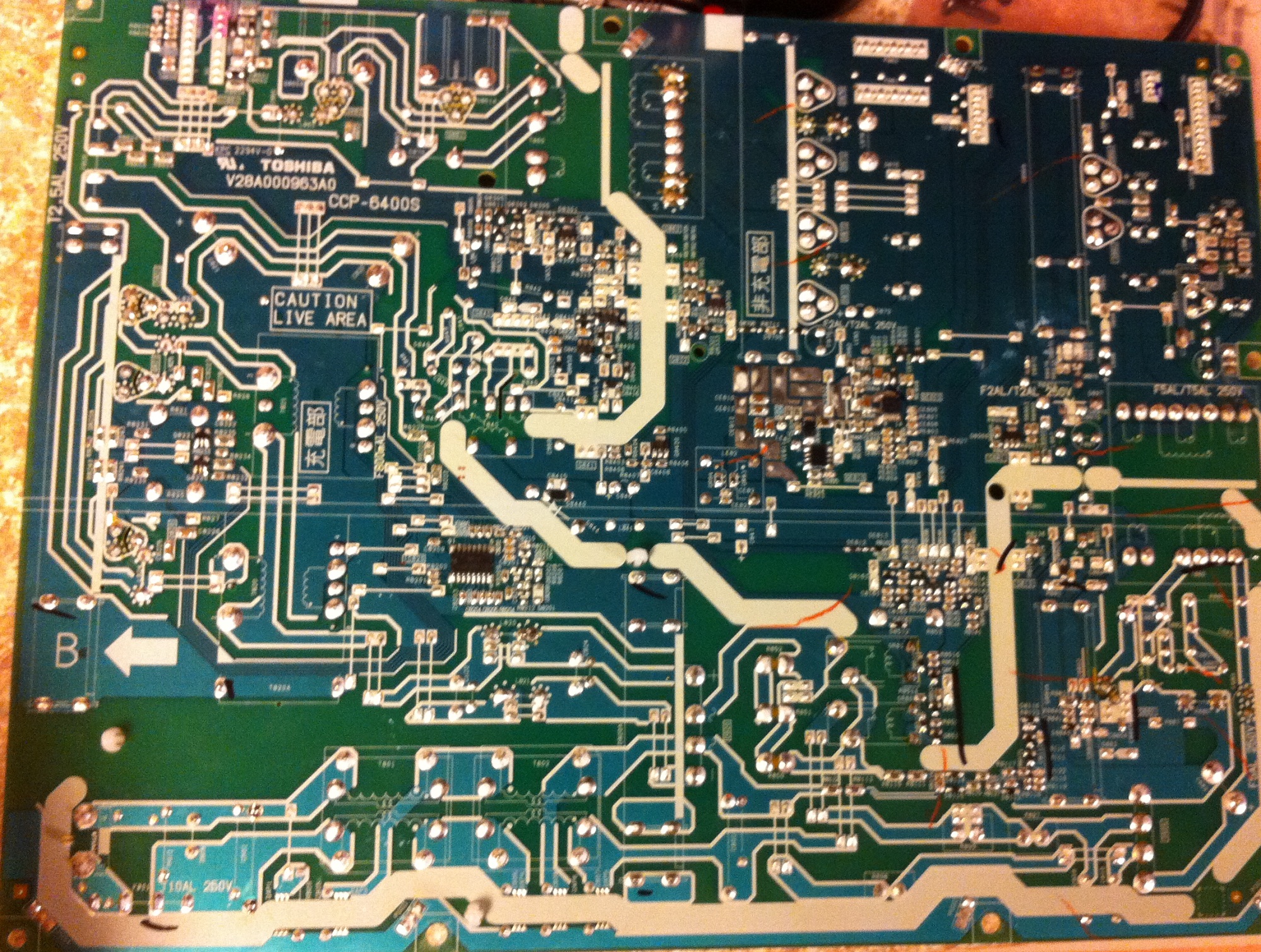

            and a shoddy pic of the back. If you want a more focused area, let me know and i'll get it.

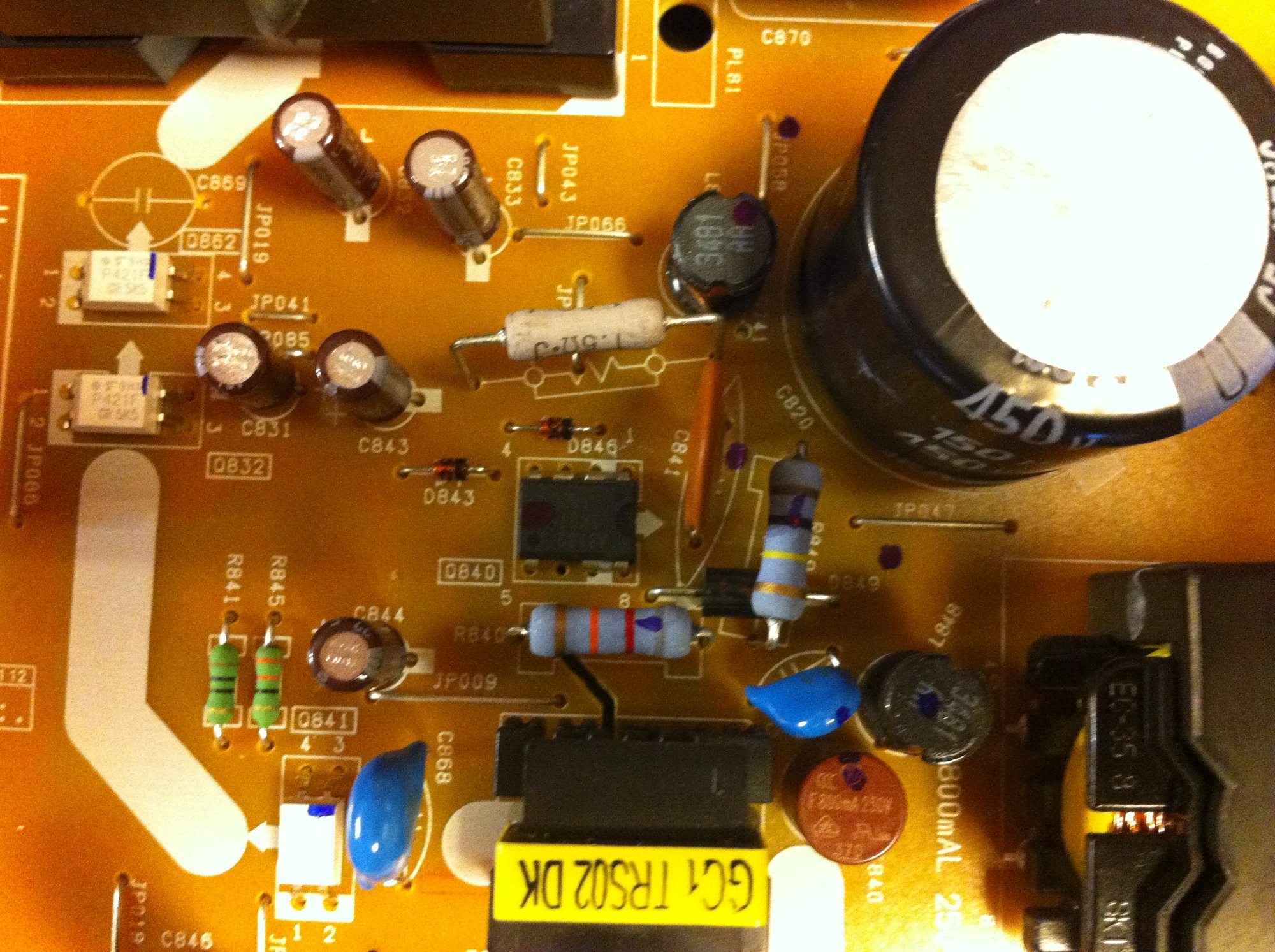

              Interesting layout. Messy, but interesting.
              Close to the center of the board is a small transformer with a yellow strip of tape across the top. GC1 TRS02 DK is printed on the tape. Just above it is a 7 pin IC labeled with Q840 outlined in white. I believe that is the standby SMPS controller. What is the part number of that IC?
              PlainBill
                A6169

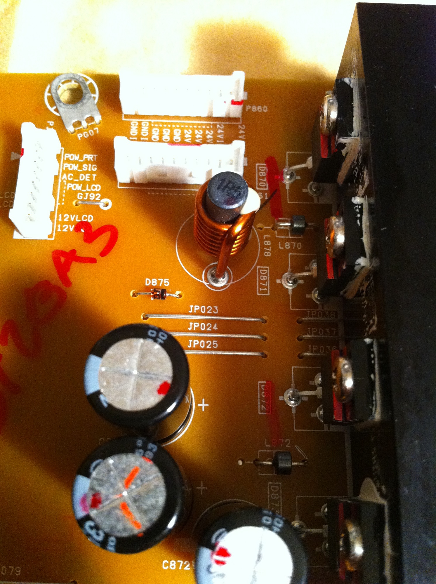

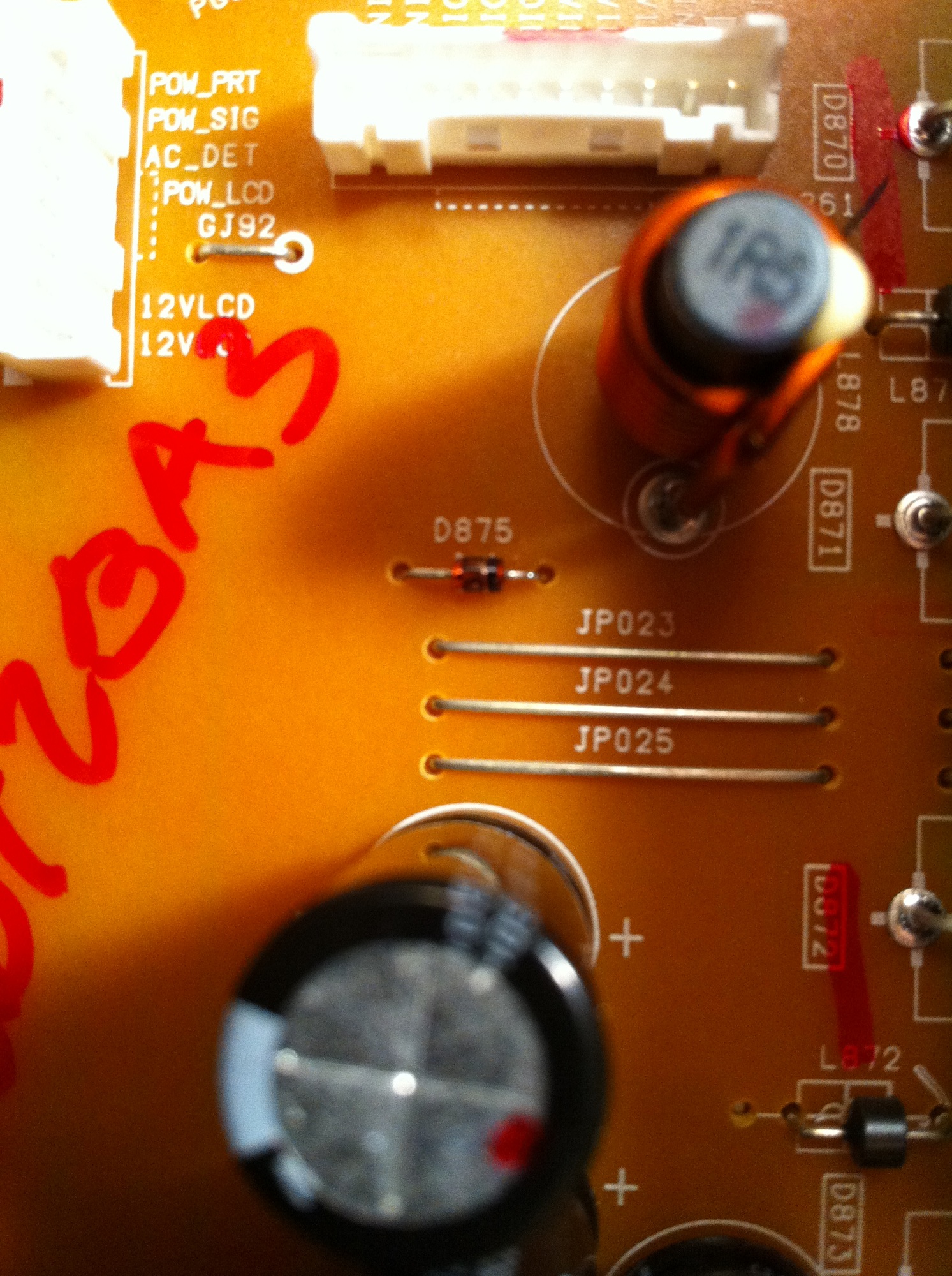

                  Got a question for you. I don't think it matters but this diode in the pics D875 checked right and i reversed the leads to see if it would read 0V and it didn't it started slowly creeping up to OL. Is this normal? Most diode's i've checked will check a small voltage one way and swap leads and it reads 0V. I removed the diode from the circuit and checked again and it read like a normal diode, low volt on one side and zip with reversed leads.
                    in ciruit there are other components(capacitor most likely) causing your odd reading.
                    as long as it checks ok out of cicuit youre good.

                      You have a winner!!! That is an STR-A6169, an integrated SMPS controller / power FET. The datasheet is here.
                      Fortunately the pins are marked on the board. Pin 3 is Ground. What are the voltages on pins 1, 2, 4, and 5? Do NOT check the voltage on pins 7 and 8.

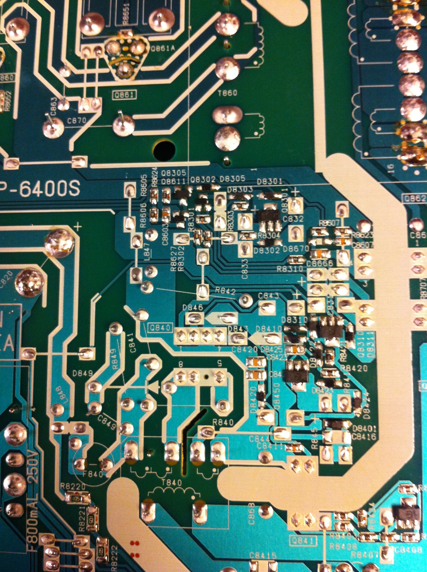

                              Well i got Ballsy and checked the 7 and 8 pins and had nothing. That chip doesn't seem to be getting anything. Shouldn't i be getting an input to one of those pins? Checked the surrounding resistors and they seemed to be ok and none are shorted. Here's a couple pics for you. Is there any way to check the IC if i pulled out of circuit?

                                The next step is to check F840. The safest approach is to measure the voltage across the large (mains filter) cap (C820), holding the black lead on the - terminal and the red lead on the +. IF you get 0 volts (as in less than .01), it is safe to measure the resistance of F840. Otherwise you can move the red probe to measure the voltage on each side of F840. Obviously, it should be the same.
                                If F840 is open, do NOT jumper it with a wire. There is a significant chance Q840 is shorted pin 8 to pin 3.
