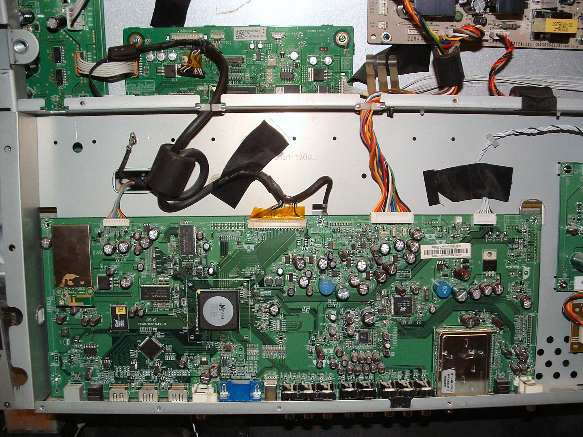

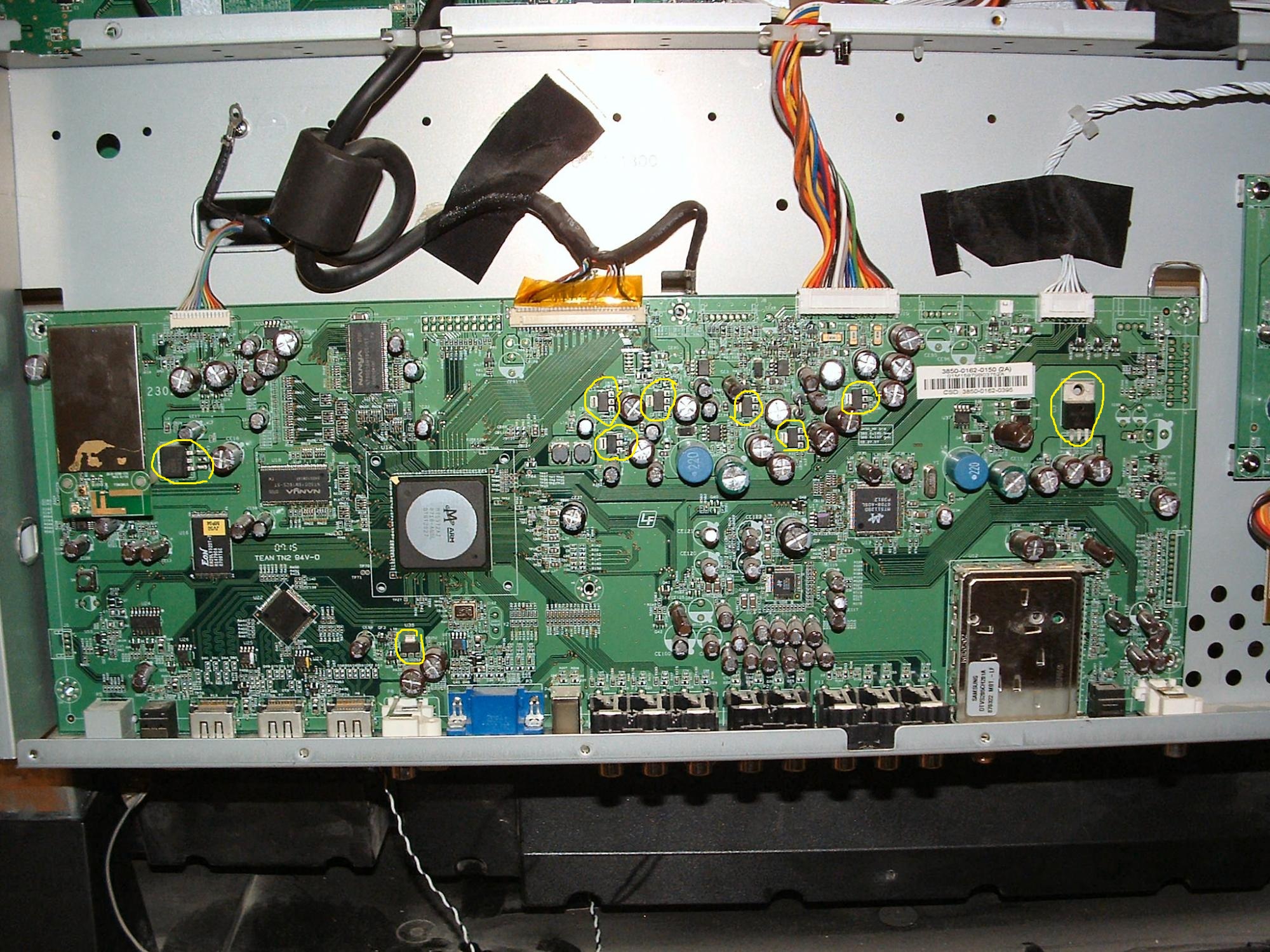

      I only saw two voltage regulators on the main board, one on the left side, near the WiFi module (an LDO) and one on the right (a standard 7805T). The 7805T checks ok with 5V, the 1084 is a bit harder to check because I believe it's output is adjustable. I get 1.3v on pin 1 (adj), 2.6v on pin 2 (Output) and 4.8V on pin 3 (Input). I have no idea what the output voltage should be, but 2.6v seems a little odd. However, I would expect the output voltage to be lower than the input voltage, which it is. Maybe I should replace it anyway, it's cheap enough.

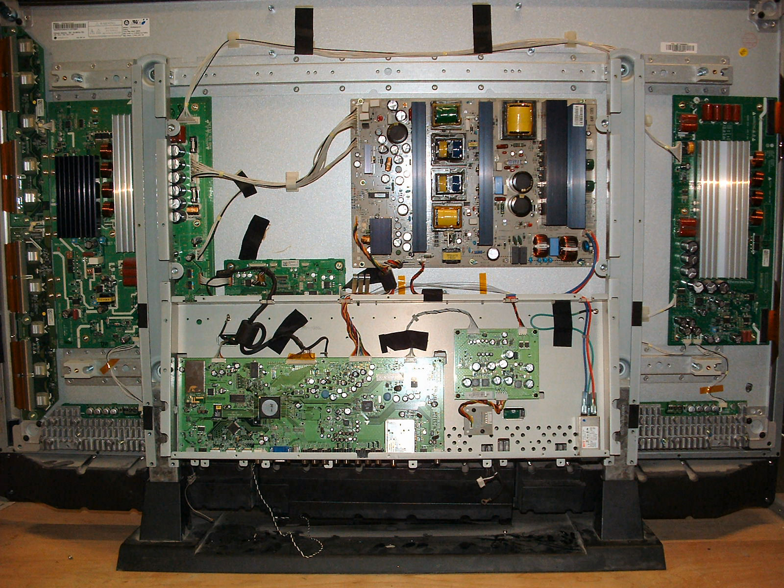

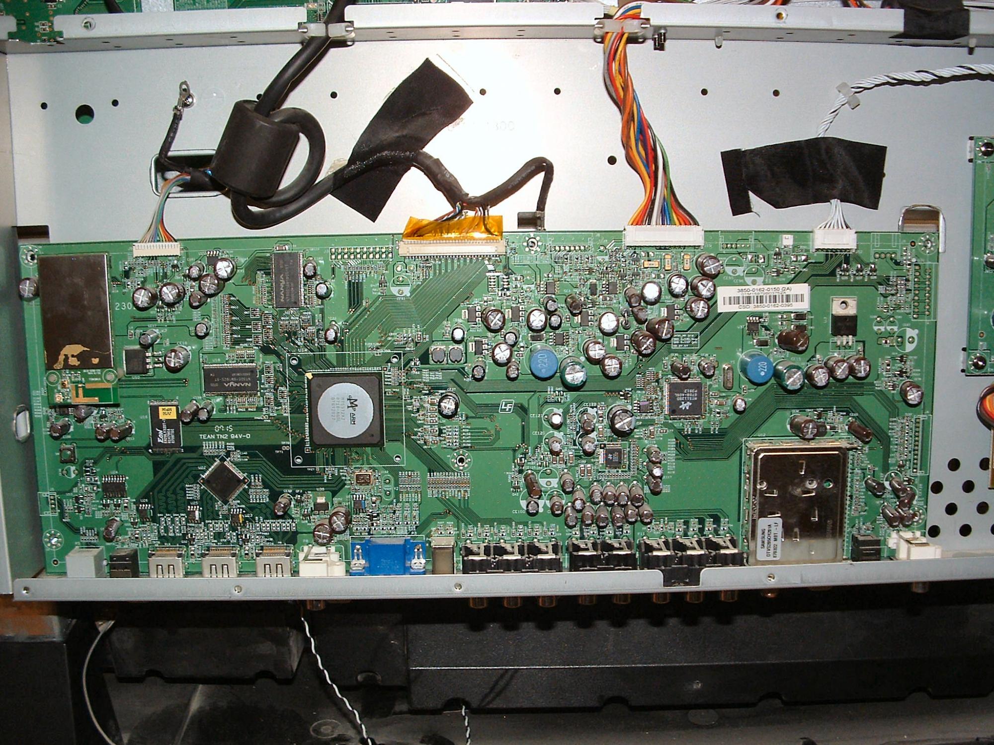

      Attached are some pictures .... an overview of the entire back of the TV, a closer view of the main board & controller, and a closeup of the main board itself.
      Thanks, Chuck
      edit: I am a little unsure if the LDO is adjustable or fixed ... it's hard to tell by the markings on the case. It is marked 1084, and 0642AL just underneath. This particular part is available in 3.3, 5 and 12v fixed as well an adjustable version. Since I don't see 3.3, 5 or 12 on it I'm assuming it is the adjustable version.

        Re: Vizio JV50P HDTV10A Plasma
        You missed a few.
        PlainBill
          Yes, I was being lazy ...
          I found a nice thread at http://www.ecoustics.com/electronics...eo/590118.html that, along with your help put me on the right track.
          After measuring voltages on the LDOs I see U33 is probably bad. It supplies 3.3v to U7 and U9, which make them appear bad too, but they are not because they do not have any source voltage and U33 does.
          The only thing I am not sure of is if the LDO is a 3.3 fixed or and adjustable regulator. The AMC1117 (or LD1117) comes in adjustable and fixed (1.5, 1.8, 2.5, 3.3 and 5.0). The only markings on the device are AMC1117 followed by F703J. I would think if it was a fixed it would show 3.3 on it somewhere. However, they are cheap enough so I will get a 3.3 and an adjustable, just to be sure.
          I hoping that replacing the regulator will fix the problem
          Thanks, Chuck

            Just be careful not to replace an adjustable with a 3.3V, the potentially higher output could fry something.

              Well, that was easy
              I was just about to order a couple of AMC1117 regulators when I decided to look at my "graveyard" of old motherboards that I keep around (I fix computers for a living). I figured in the computer world 3.3v regulators are probably pretty common. Sure enough, the first board I checked had three of those little rascals on it. So I got out my SMD rework tool and removed one of them and transplanted it to the U33 position on the Vizio's main board. I then hooked everything back up, powered it up and - it WORKS!
              In fact, it works quite well, thank you. Very nice picture for a 5 year old plasma set. It's also amazing how much hotter things get when the TV is actually displaying a picture. The power supply heat sinks and the heat sinks on the SUS boards really generate lots of heat. I don't think I will have to run my heater in the wintertime However, it may cost me more in air conditioning. The back of the TV has some cut outs where one could put a slim fan or two, and I may just do that. Heat is the enemy of everything electronic!
              Just to be sure I checked the voltage on U33 and it is a nice steady 3.29v, right where it should be.

                  Well done. Apparently that same main board made it into quite a few sets. For some reason there has been a high failure rate on that regulator. The 1117 regulators are available from several manufacturers, some are rated at .8A, others are rated for 1.0A. If I knew of any that were rated for 1.5A I would be recommending them.

                    It's very surprising these linear regulators fail. They have overcurrent protection and thermal SOA protection. Maybe when they operate on the borderline for a long time it leads to their failure.
                      PlainBill
                      When I was looking for a source for the 1117 regulator I did see at least one manufacturer that rated it as 1.5a, although I am suspect of that rating. When you check the data sheet for a 1117 it normally says 800ma. Maybe it can handle higher current depending on how it's mounted (soldered) to the pc board.
                      Considering it took 5 years for the regulator to fail I don't think it's a big risk to use the same part. Part of the problem may be that it appears the output of U33 is used as source voltage for two other regulators (U7 & U9), and that might put current drain at close to maximum. In the SOT-223 package there is nothing higher rated, but there are some in TO-220 packages that are. It would just look a little funny soldered to the PC board and would probably require a heat sink.
                      Oh, by the way the device *IS* the adjustable version, not a fixed 3.3v.

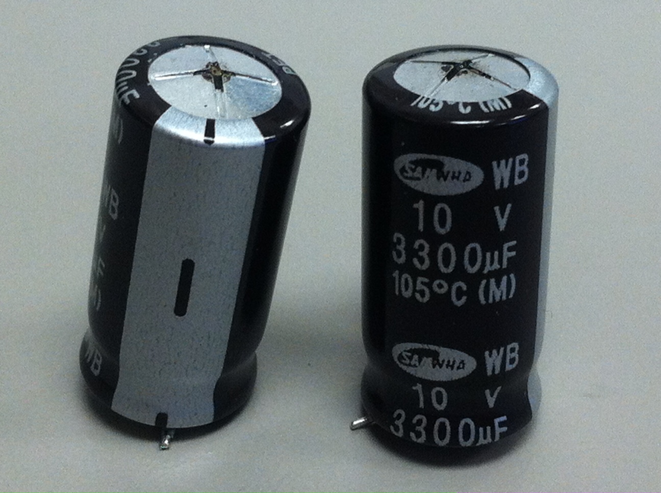

                              I just want to add some additional information on potential failures on this model of television. Several other forums have questions about how to diagnose and fix several different failures. The one I (and quite a few others) have experienced is no picture when the tv is turned on but sound is there. Some people never get the picture back, but a number of people have found that letting the set warm up for 10-30 minutes, then cycling power off and on does get their picture back. I lived with it this way for many months then decided last weekend to find and fix it. I opened it up and followed the suggestion to look for bad caps on the power supply board. I found 9 on the power supply board in the center of the set that look like the attached picture. The bulge on the end and the stained metal from a leak show that the caps are bad. I ordered 12 replacements from Digi-key for $10 + shipping, received them after 2 days, pulled the old, soldered in the new, and the TV now works like new. Be careful soldering in the aluminum electrolytic capacitors, there is a polarity to be followed. If they are put in backwards, I have been told they can pop like a firecracker. The circuit board should have a - sign on one side or a circle with a small arc missing and two dots. The - sign of the two dots should line up with the - sign on the cap or the silver strip you can see in this picture. These particular ones are 3300 micro-Farad(uF), rated to 10V, M tolerance. I spent an extra 20 cents each to get versions with 2000 hour rated lifetime instead of 1000. Good Luck!
