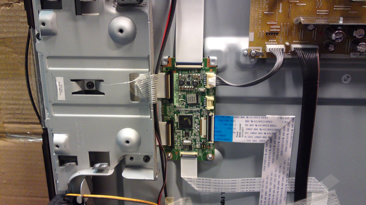

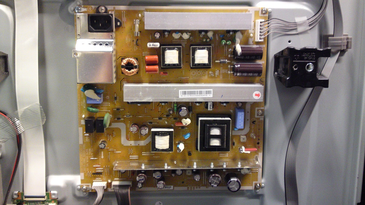

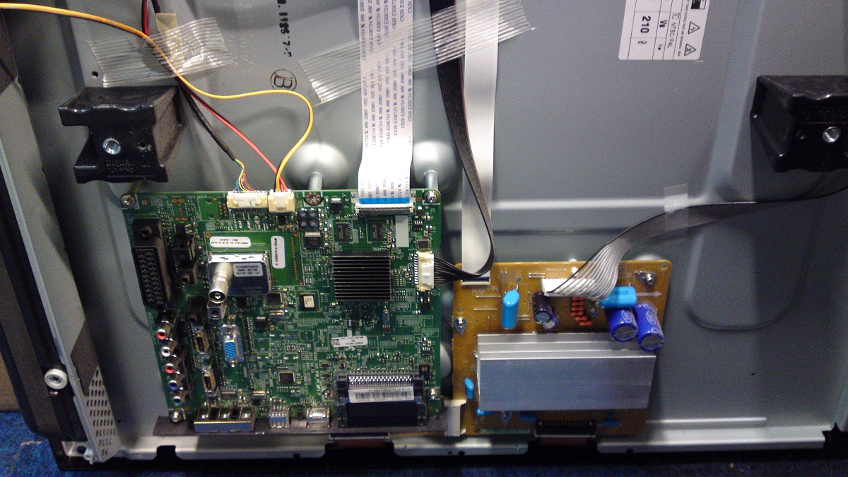

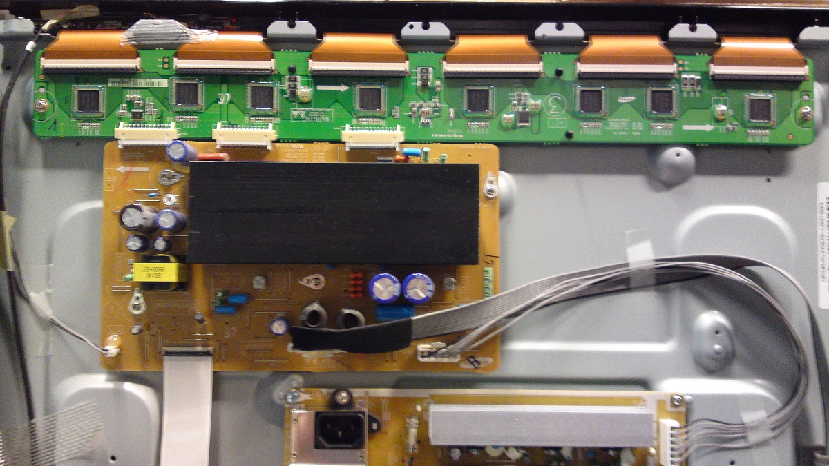

    See attached pictures of the set. The set is so new so the service manual isn't available at Elektrotanya yet.
    The pictures shows the powersupply, Y-SUS with Y-buffers, main board and Z-SUS, finally the small logic board.
    Impressive weight reduction and size of the boards, really.
    These guys knows what they're doing, (most of the time )
