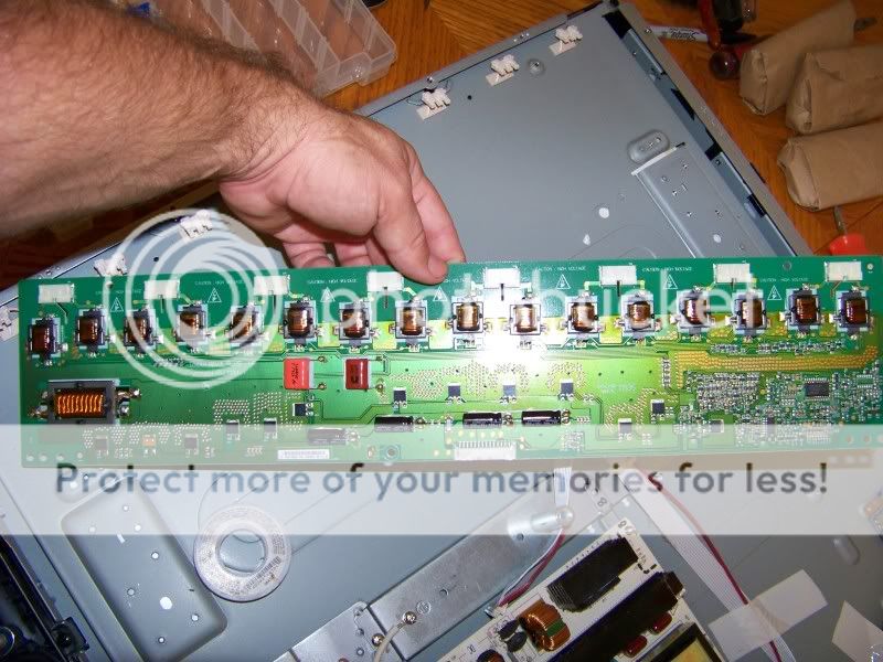

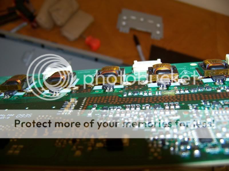

          Ok, got it tore down. Sorry no pics, I need some more lithium batteries for my digital camera.
          PSU looks good, no bulges. Have not tested output voltages since I found some obvious probs in the inverter board. Turns out one of the inductors after the transformer and before one of the ccfl bulbs had a cold joint and was arcing/heating up. That and there looks like some of the solder has melted on what looks to be two copper pads marked "CP1'. Amazingly the inverter board had Nichicon caps on it... looks like the leads were getting hot for some reason though. All the pico fuses are testing good.
          So whatcha think maybe take out the iron and reflow some joints?

            Got it working. Turns out it was a cold solder joint on the inverter board. Reflowed all of them with some fresh non-Rohs stuff plugged it in and it fired right up.

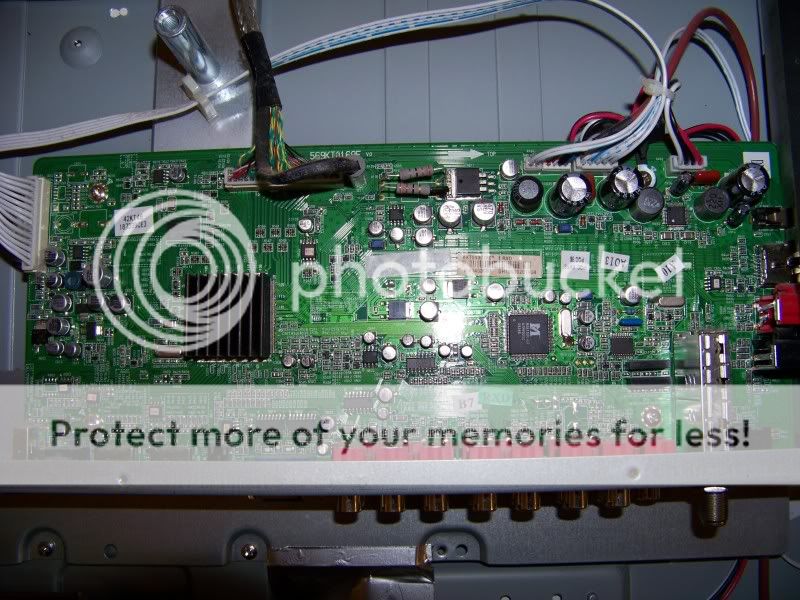

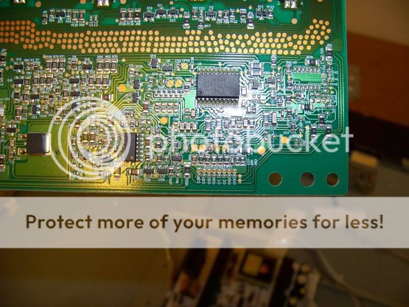

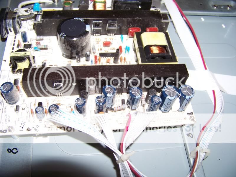

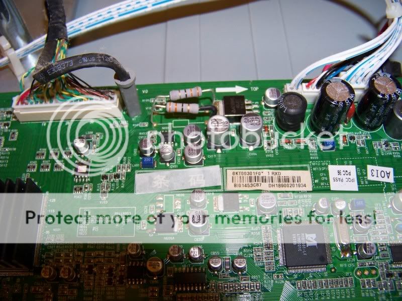

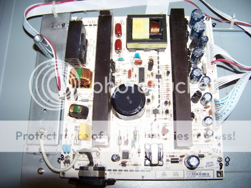

              Re: Got me a 42" Dynex DX-L42-10A dumpster diving...
              Here is be the pics. Sorry tried using the board uploader, got a token error so I just photobucket'd em.
              Its pretty easy to spot the dicked up joint, and I still have no clue what CP1 is... its next to the copper pads on the inverter board between the two SMD IC's... 3 oclock from the one on the right, and 6 oclock nearly straight down from the big IC up top. Not for sure what was supposed to be there if anything. Went ahead and desoldered it, figured I would try out the inverter board without it first, and if it didn't work, then go ahead and bridge it and see what happens. Looks like no bridging was necessary.
              All in all the reason this TV died was simple. Poor workmanship. That inverter board should have never made it past the quality control inspectors.
              Also on the I/O board there are two SMD capacitors up top near the middle that appear to be ever so slightly bulged. Not for sure if this is normal or not, but if its working, I figure I will just go ahead and leave em alone for now.
