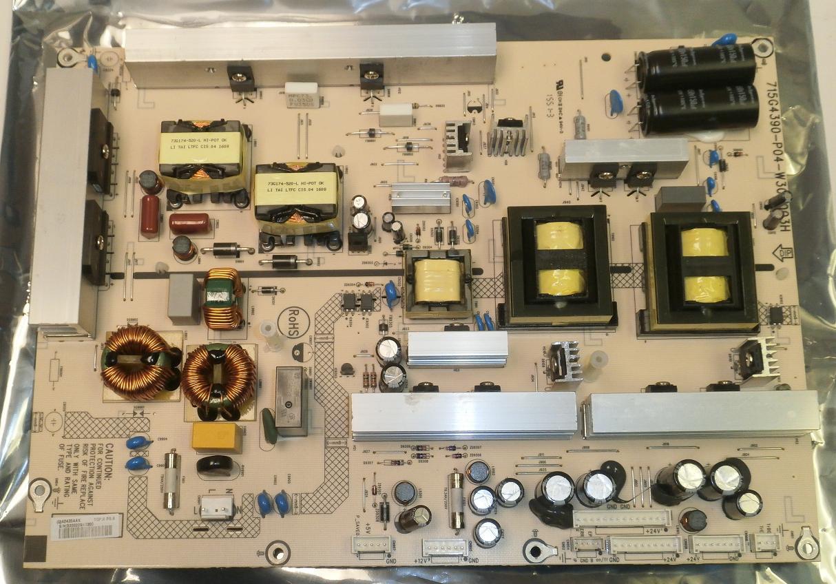

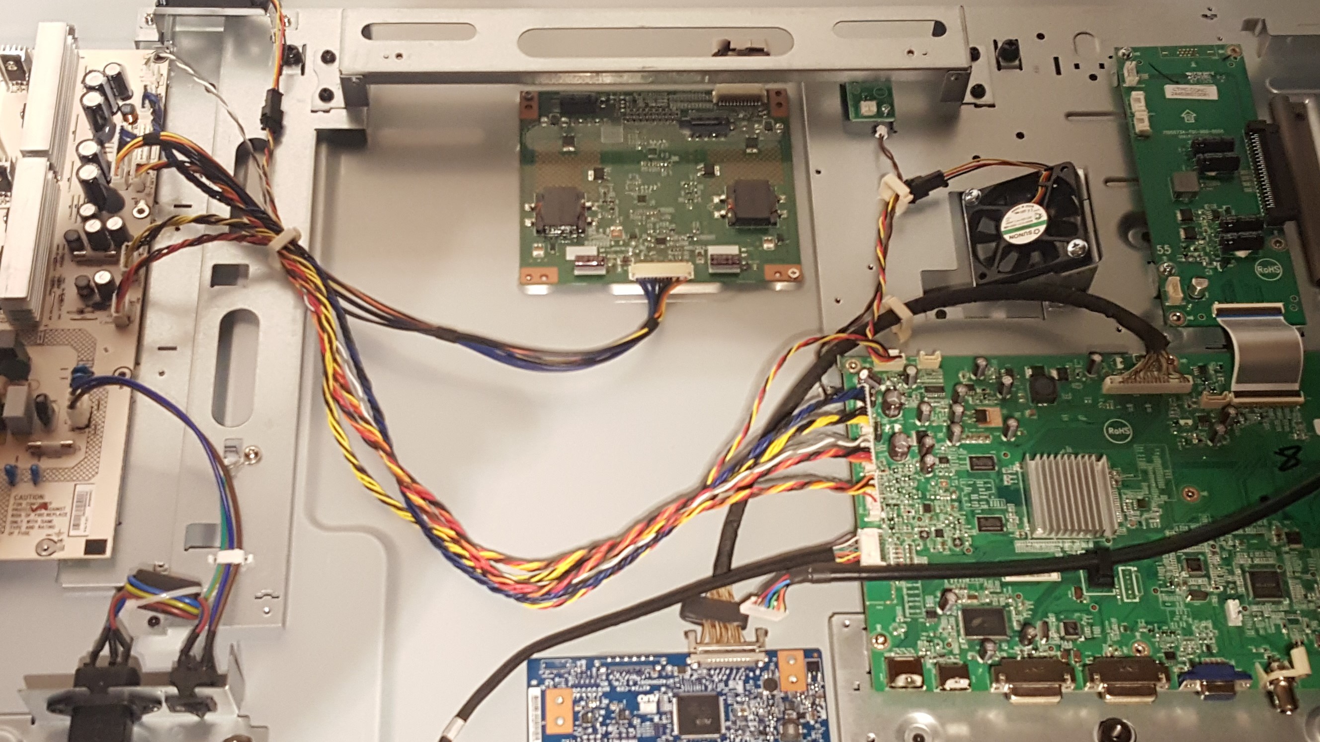

    Just collected a Nec Multisync v552 from the E-waste. well i was happy and all in heaven when i saw it!! omg is it for real? never in my lifte time i have seen that GOOD E-wast. most of it i find is just some smalls but god anyway.. but this was frickin awesome!!!
    I hope i can get some advice here Or maybe it belong at the e-waste after all.
    When power it on lcd blink and then it powering off, Nec has a diagnostic mod it goes into. 2 red flash and a solid. then repeats it.. i tried google the light code, but whit no luck..
    PSU and Inverter (i think) and a overall pictures.
    All help is met with big arms and a wide smile
    Thanks..

    Multimeter shows right volt out on all pins on psu.

      Here is where I would start I would replace all caps that are 47uf and lower and see if it will stay powered up
      You could take it little further and replace all caps that 100uf and lower and see if it makes a difference or not
      If you have not solder much take your time when taking out those small caps it is very easy to pull the small pads right off the board i done a lot of these small caps and every once in awhile I will have β€˜this happen to me

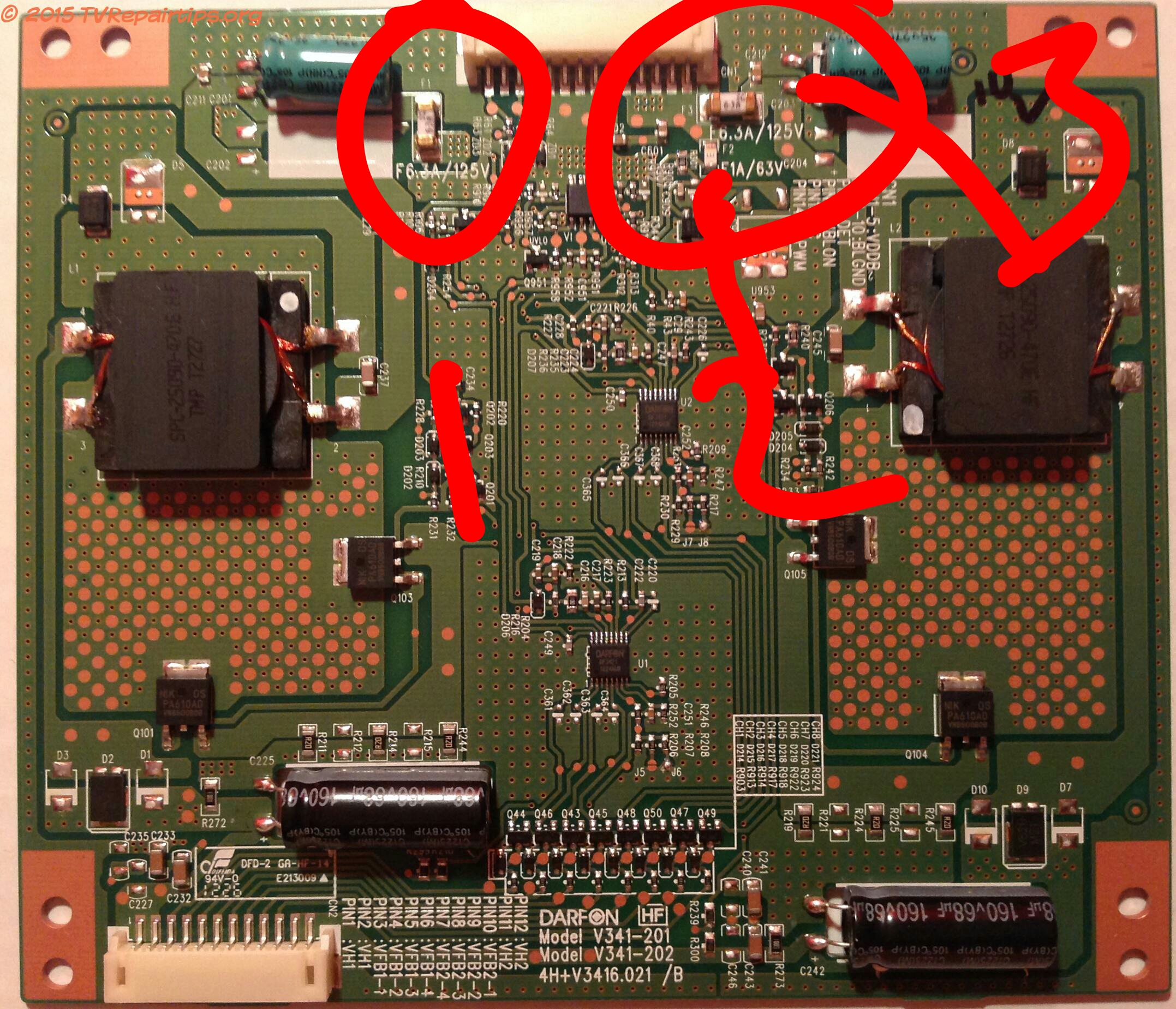

          This is a monitor right? How much inches? First of all i don't think you have to change any caps for now, the second you have to put a valid source in the monitor for ex. pc image through VGA port, then switch on monitor and see if you can see the image for a moment, if yes then shut off and test those 3 whit fuses on the 1st picture board on the top.

            well i think your right its a monitor.. 55".
            but i tryed it whit hdmi on my computer, and still the same. ill try whit vga asap
            and wich 3 whit fuses*? i only see tow. (ceramic fuse) and if i done it right they where good.. multi and continuity test?
            you meen on psu right?

              Re: NEC MultiSync V552 power on and off (E-Waste Dumpster Diving)
              AAARGH!! Sorry not "whit".. WHITE fuses... i've already pointed at the first picture board, you don't read? It's a backlight LED driver board. Are marked on pcb "Fxxx"
                here are the 3 fuses.

                    Yes, sure... use continuity without current in circuit, or voltmeter with current, (volt on both pins)..

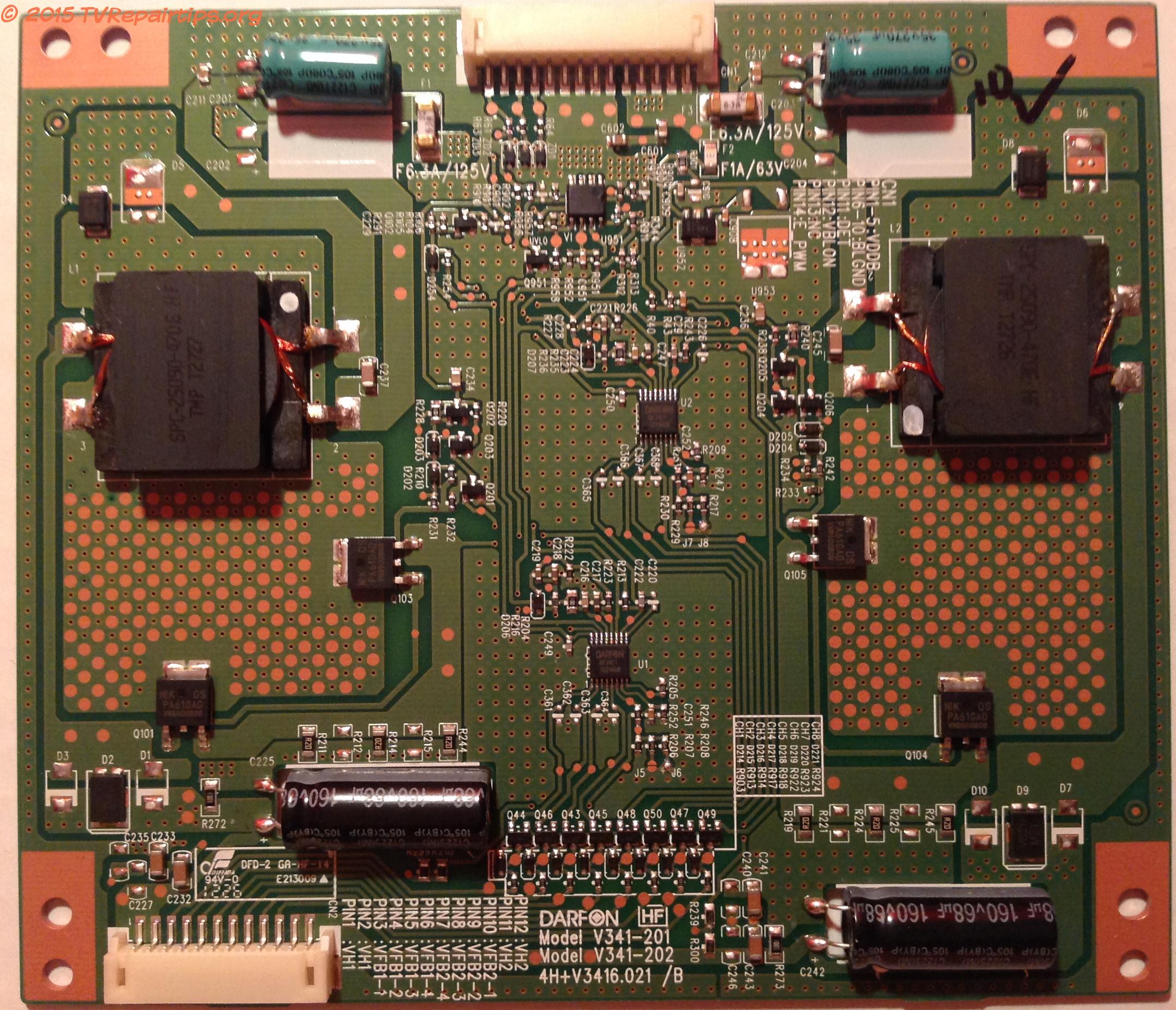

                      It's probably the backlight if it's LED backlit, looks like that's an LED driver.
                      https://www.badcaps.net/forum/attach...0&d=1511605764
                      You want to check for (I think) 24V input to that board
                      You want to check for the VH1, VH2 pins on , these are the high voltage outputs. I'd expect at least 100V. These will go to the Anodes (+) of the LED strips.
                      You want to check each of the VFB pins. Any that measure more than a few volts are likely to be at fault. These will go to the Cathodes (-) of the LED strips.
                      It's like christmas lights. If one LED goes bad the whole set dies. Bad design - but hey what can you do...
                      If you see high voltage on the outputs, but there are some VFBx-x that measure high, then you have open circuit LEDs in the panel. So you have the fun task of stripping the panel to find and replace the LEDs.
                      You might find that the driver board is dead though if the VH1,VH2 are missing or low.
                      You might find everything is ok and the main board is shutting down for some other reason.
                      If you can find the model number of the LCD panel then you will likely be able to find the pin out for that connector. Though it is probably similar to LCD CCFL backlit TVs and there is an error output pin which will indicate the fault and cause the set to shut down with the "2" code.

                                  Okay after doing some more measurements to check what @tom66 said;
                                  All of the VFBX pins (the negative side of the leds) are measuring 0.5~ish V.
                                  Except 2, VFB2-2 and VFB2-3. VFB2-2 measures 6.2V when the TV is cold and 6.3 when its gets warm. The VFB2-3 pin start around 9.1V and rises until 9.2V when the TV gets warm.
                                  At VFB2-3 = 9.23~V the backlight driver shuts down and the backlight stops working.
                                  Is this due to failing backlight LED's? Would this mean that I need to replace 2 strings?
                                  Do you think its worth it (2 strings cost approx. 10 EU)?
                                  • chagay
                                    • May 2021
                                    • 4
                                    • Netherlands
                                    I "fixed" it by connecting the VFB2-2 and VFB2-3 to VFB2-1.
                                    This way the backlight driver does not "see" the rising voltage across the led strips 2 and 3 and keeps working.
                                    Only downside is that you can now visually see that in the upper right corner the backlight is a little dimmer.
