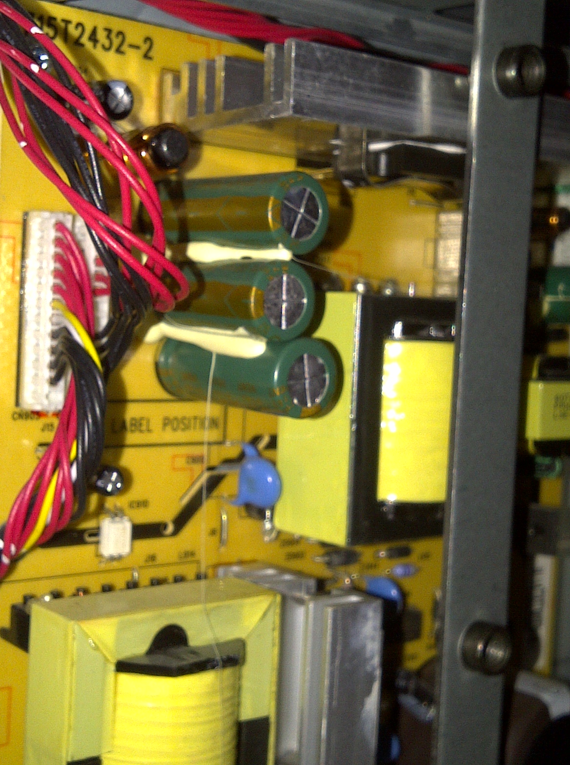

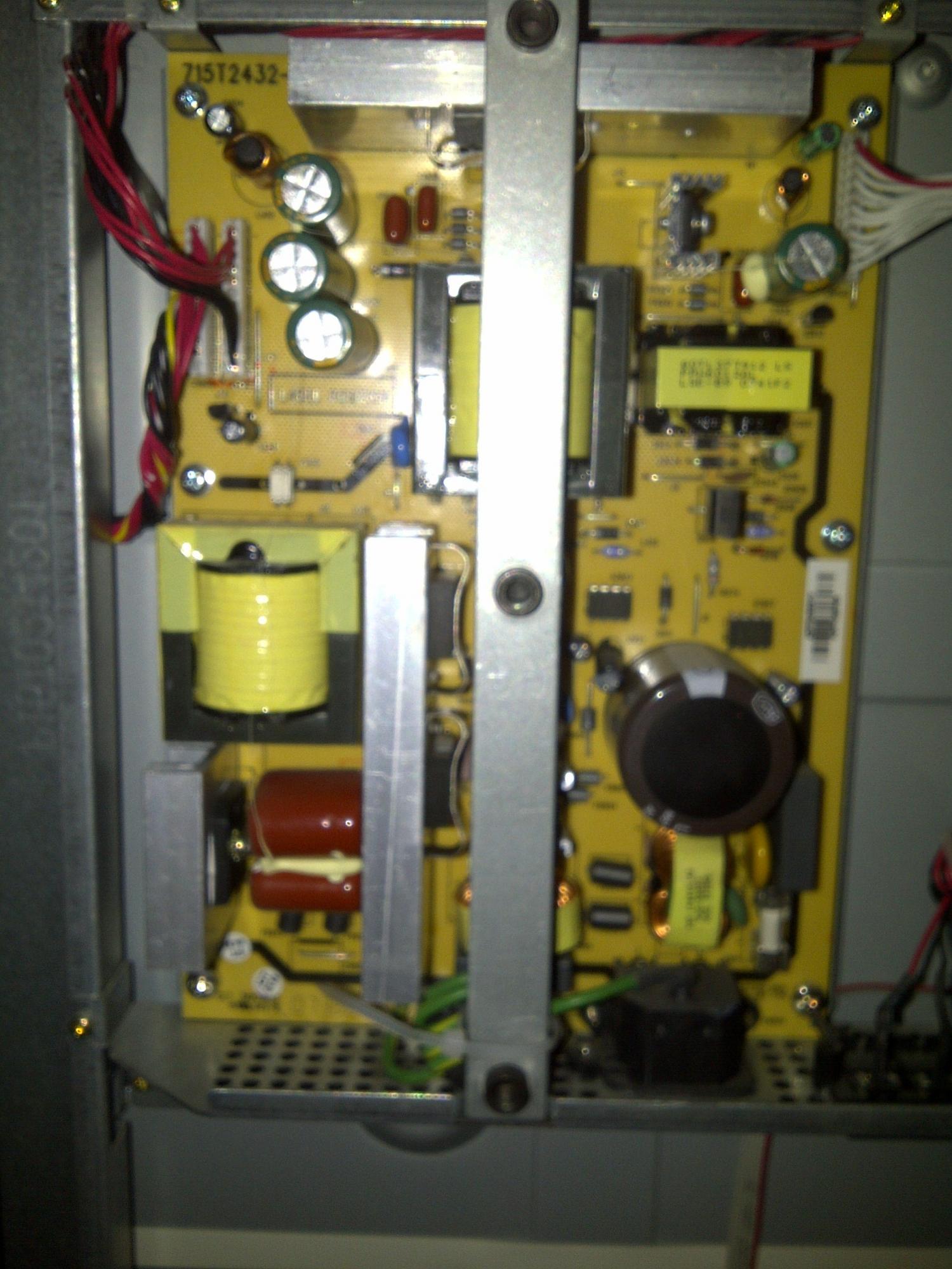

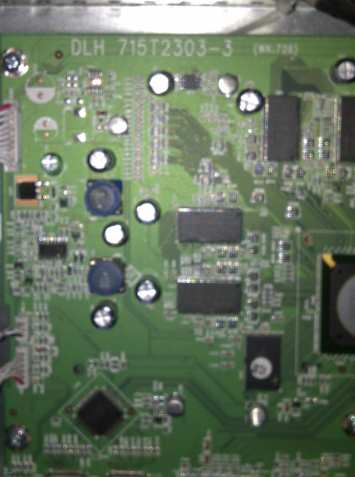

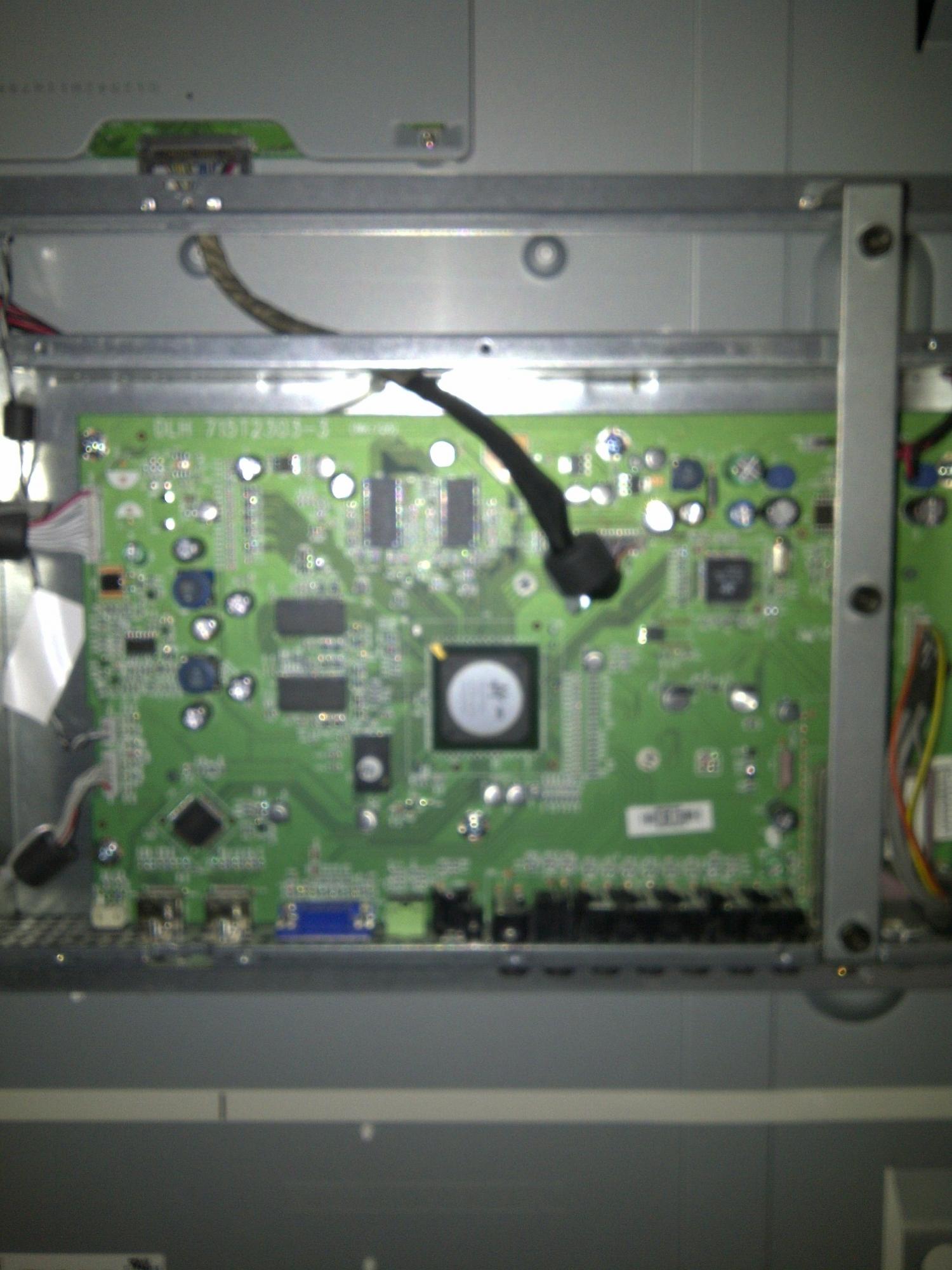

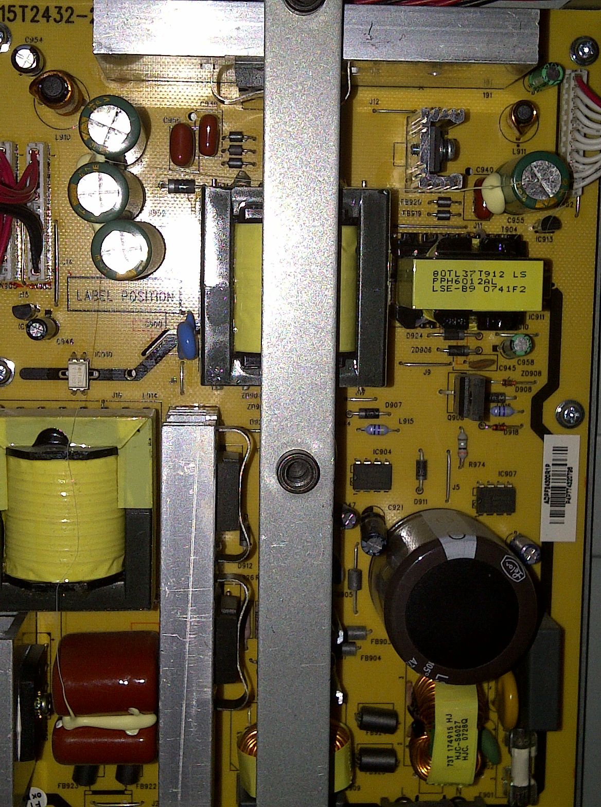

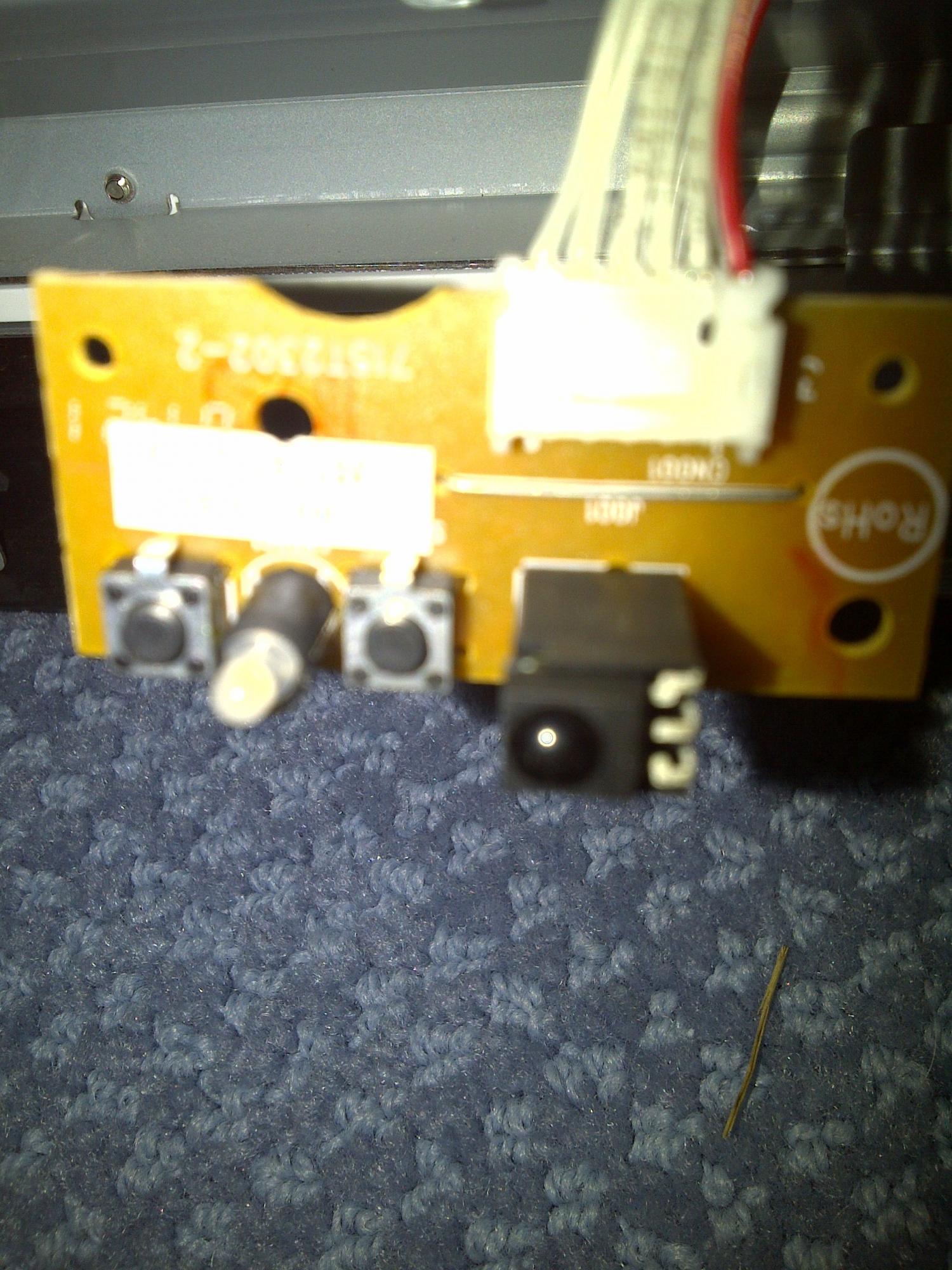

    no power at pin 3 and 4 on IR board CN001 should be about 3 volts only orange stand by light comes on. I tried to attach pictures that may help?

    Not much. Still, you get marks for not posting them inline. For future pictures us 'Manage Attachments' below the text entry area; it gives a cleaner look.
    The service manual is at Elektrotanya.
    The single most valuable picture you can include would be a sharp, focused picture of the output connector of the power supply, showing the legend on the connector. The single most valuable piece of data is the voltages on that connector.
