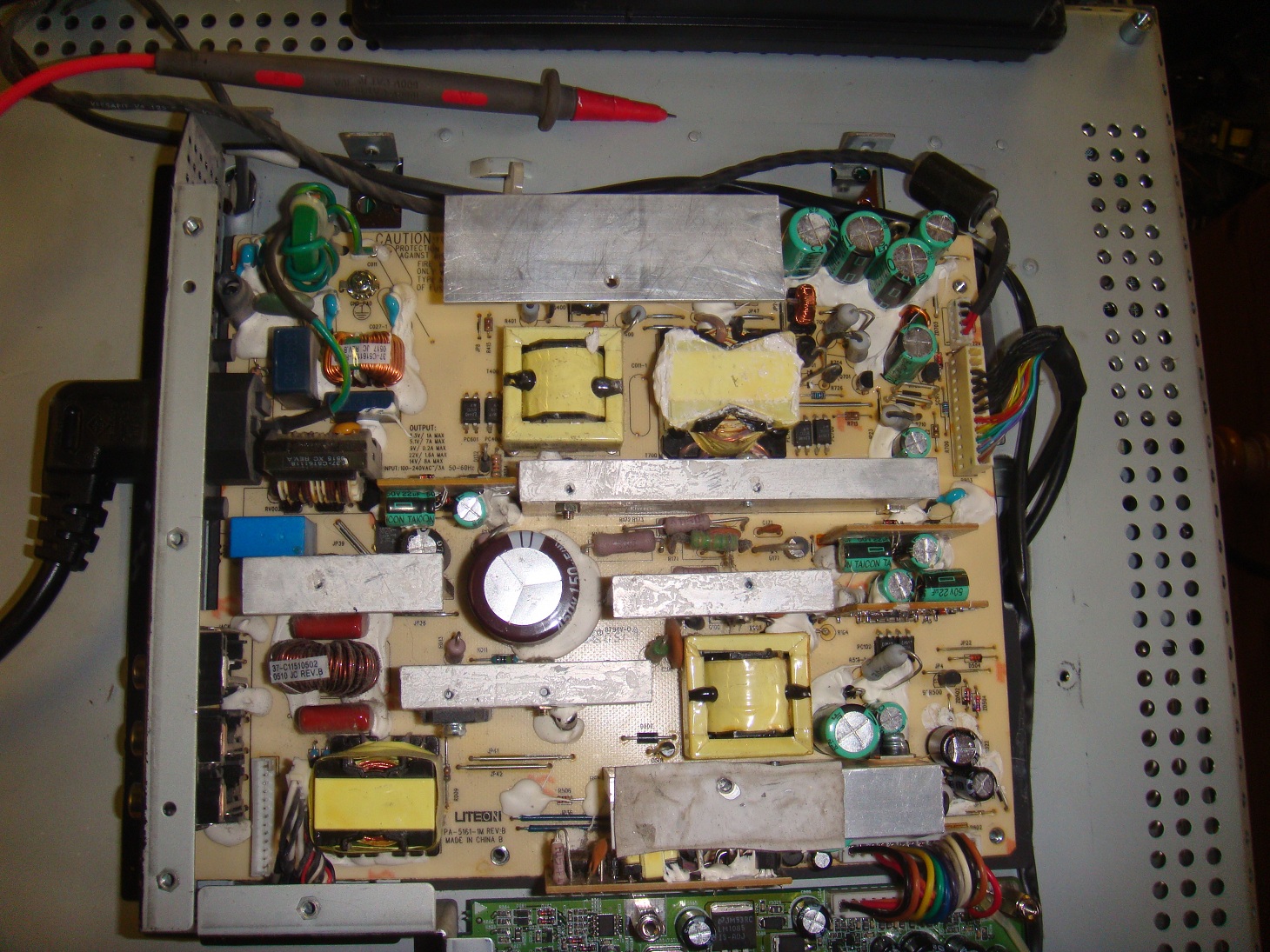

    Got given this for free, will not switch on! have read lots about these screens being dud! this one will power up sometimes and once on will stay on, but switch it off it will not come back on!
    from what I can see I think it's logic board related, the psu clicks on ok with good 5volts 3,3 power on, and 9 volts all going to the main board, when it comes on the blue led lights, when it refuses to power no led light but relay clicks on.
    Probably not going to get anywhere with this! but just thought I would ask to see if anyone here has experienced this

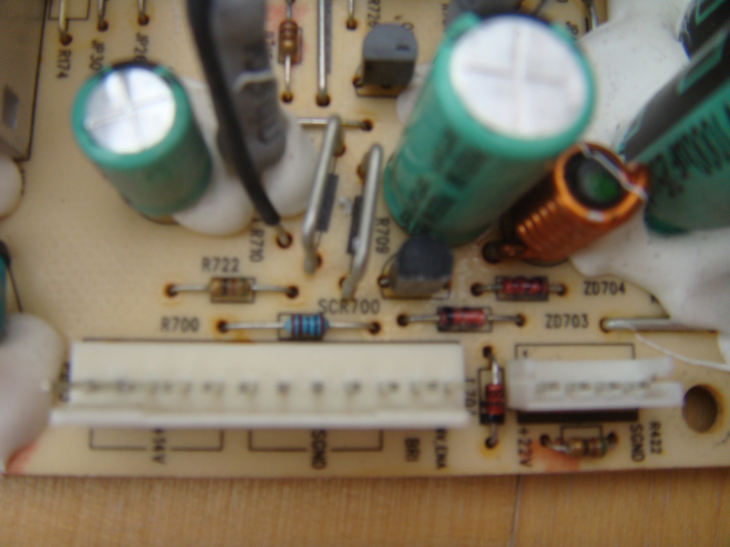

          Thanks PlainBill, one thing I have noticed, when it fails to power on ( most of the time) you are not able to switch of it's in limbo! no leds light set is dead, but when it powers on and works, it responds to power of, voltages I have found going to the mainboard are 3.3v, 5v, 9v, will look at these pins more closely and report back with pics.
          thanks Ronnie
          sigpic
          • netdent
            • May 2011
            • 208
            Re: Dell W2600 lcd TV fault

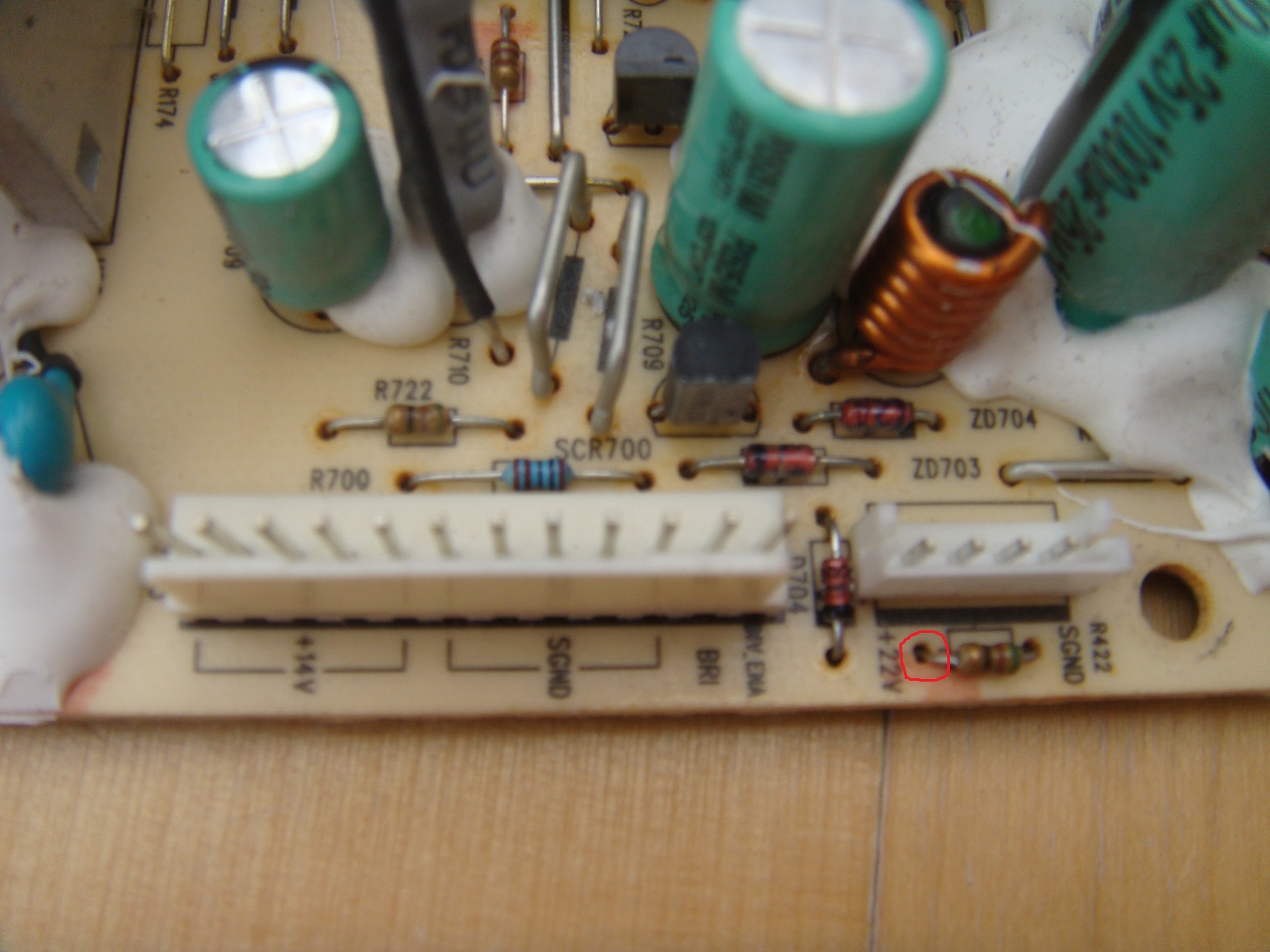

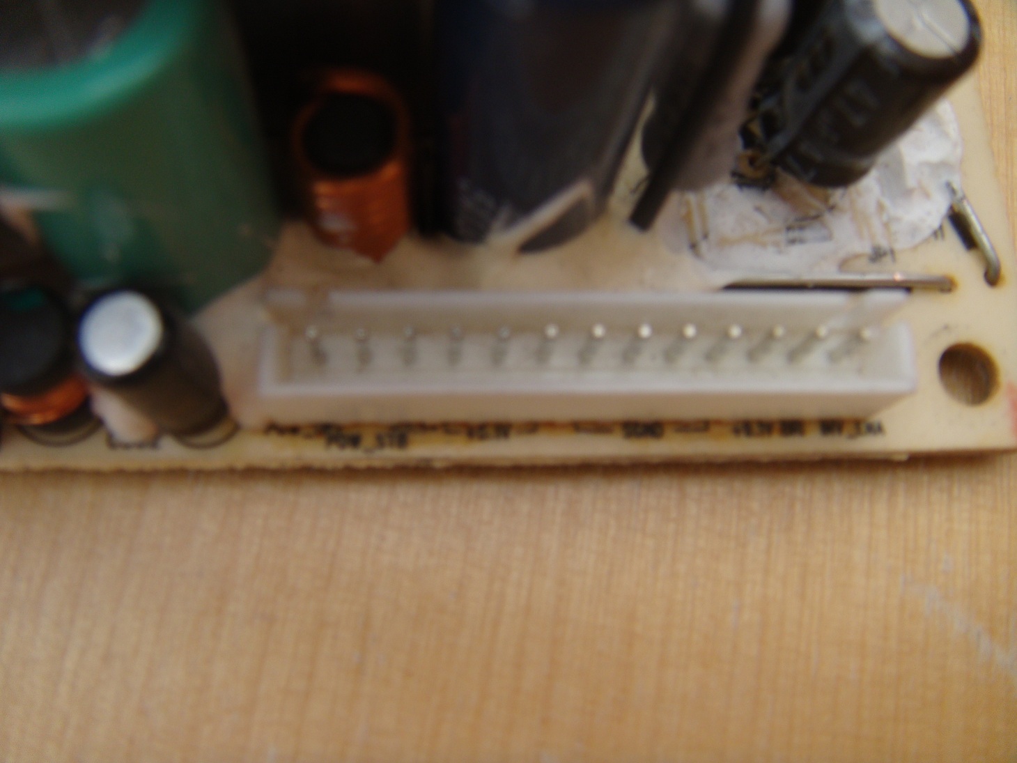

            Ok, have looked at these pins and read the symbols
            pow_off
            pow_stb
            3.3v ( OK)
            5.1v (ok)
            sgnd
            +9.1v (reads 8.98)
            BR1 orBRI? (this reads 4.4v when powered, wether it comes on or not)
            INV_ENA
            If it fails to power at switch on it will never come on even if left for hours! and any amount of tapping or poking it will not come on.
              pow_off
              pow_stb
              3.3v ( OK)
              5.1v (ok)
              sgnd
              +9.1v (reads 8.98)
              INV_ENA
              thanks Ronnie

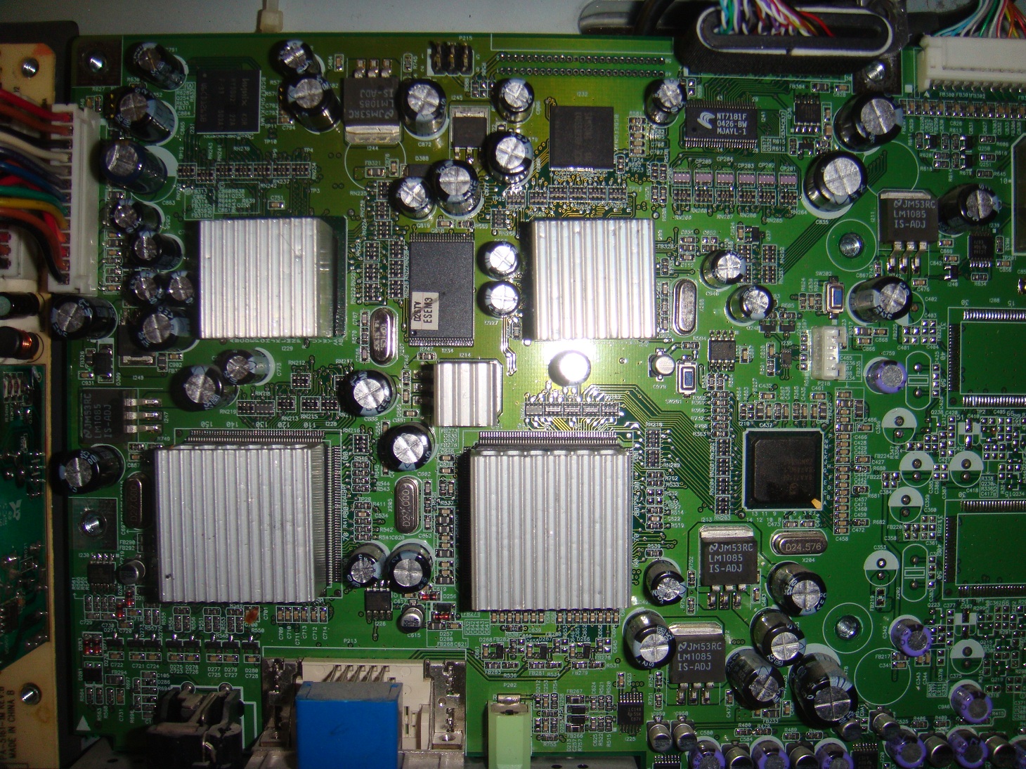

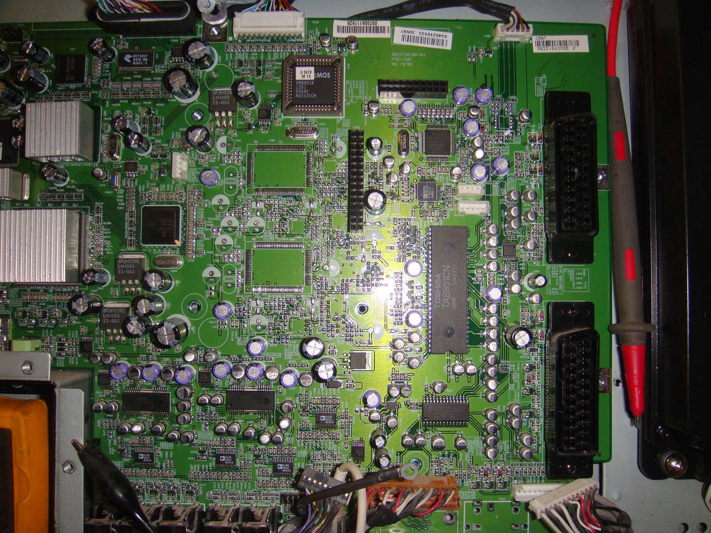

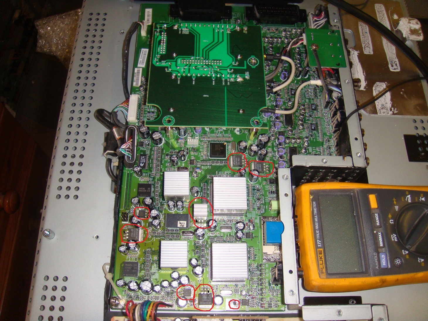

              That is not uncommon. There are several processors on the board. They are expected to start up in a precise sequence. If one fails to start the others may hang.
              I've identified several voltage regulators and possible regulators. I've circled them in red. I've also marked pin 1 with a black dot on some of them, the same pin is pin 1 on the rest. Pins are numbered 1 2 3 from left to right, the tab is usually connected to pin 2. I've also circled one mounting stud in red; use that as the ground point. There are several pieces of information I would like from you.
              1. The complete part number.
              2. The voltage on pin 1, pin2, and pin 3 when the set is operating.
              3. The voltage on pin 1, pin2, and pin 3 when the set is not operating.

                Thanks PlainBill your your input it is much apreciated, just to clarify which was wrong earlier! the pin marked BR1 or BRI shows almost zero volts when tv powers properly, when it hangs it shows 4.5volts, will come back shortly with those pin behaviours you asked for,

                • netdent
                  • May 2011
                  • 208
                  Ok, of those 3 pins, only pin 2 changes to almost zero volts, pow_stb, I think there is about 8 regulators on the board, they read about 3 to 5 volts (most of them) on pin 3, have posted some more pics showing the board number, the psu is a liteon DA-5161-1M, hope this is enough info PlainBill, I changed one cap near the power connector as I thought 9volts was a bit low, this never changed thing! but worth a shot Ithink
                  thanks Ronnie
                  sorry forgot to state the pins
                  pow_off 3.285v
                  pow_stb 3.306v (when tv hangs 0.345)
                  3.3v 3.333v

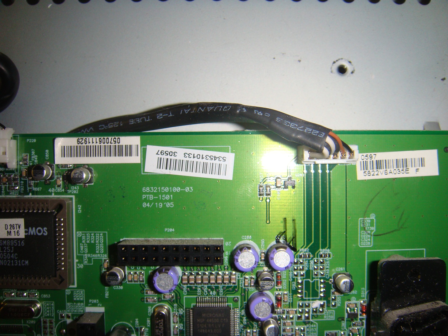

                      Ok retired caps, thanks for the response, maybe I got confused with what I was being asked by PlainBill
                      I'm not sure what voltages I should be getting on these regulators, so I just checked to see if there was any activity on the pins.
                      as for the part numbers I thought it was for the main board (picture taken) if wrong please advise.
                      the pin voltages, PlainBill only asked for the 3 pins which I did, that plug has 13 pins, some voltages are duplicated i.e there are 3 pins that are +5v etc

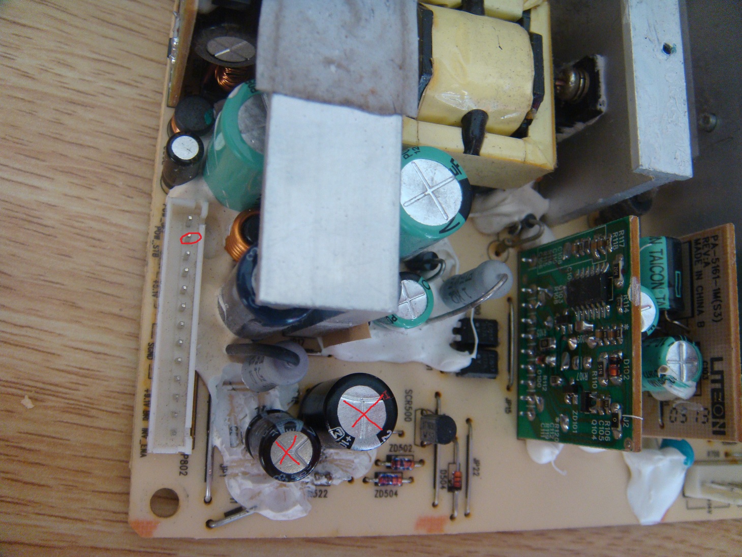

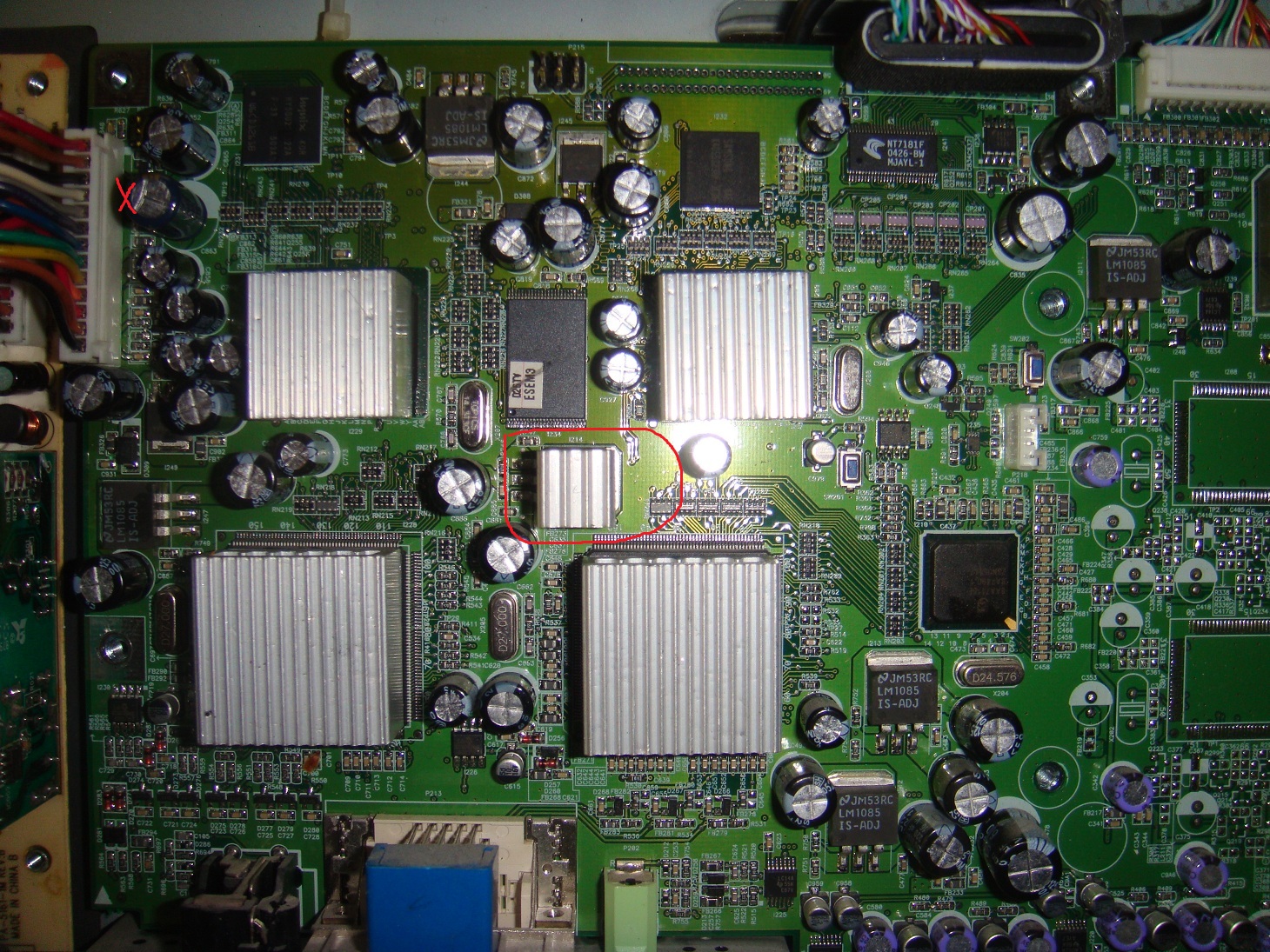

                        Please note also the red circled heatsink has a regulator below it, cap marked x has been replaced
                        thanks Ronnie

                          Ok I think I have grasped this, sorry for bein dumb
                          I measured 6 devices inc the one under heatsink, these are all LM1085
                          Starting just under the power plug on the left and working clockwise
                          location pin1 pin 2 pin 3
                          1247 .584v 1.838v 3.339
                          1244 .590 1.844 3.315
                          1214 2.098 3.344 5.085 (centre under heatsink)
                          1211 2.086 3.330 5.058
                          1213 .578 1.621 3.336
                          1212 2.092 3.339 5.095
                          the above were with the tv on properly
                          when the tv hangs I noted no big change I.E no drops in voltages maybe slight increase in all pins, there are some smaller sized regulators dotted about, I should probably check those too, but getting late for today
                          thanks Ronnie

                            Yes, checking the smaller regulators would be helpful.

                              Ok PlainBill will do that in the morning, I thought the pins 1,2 and 3 were on the power plug! got the wrong end of the stick sorry!

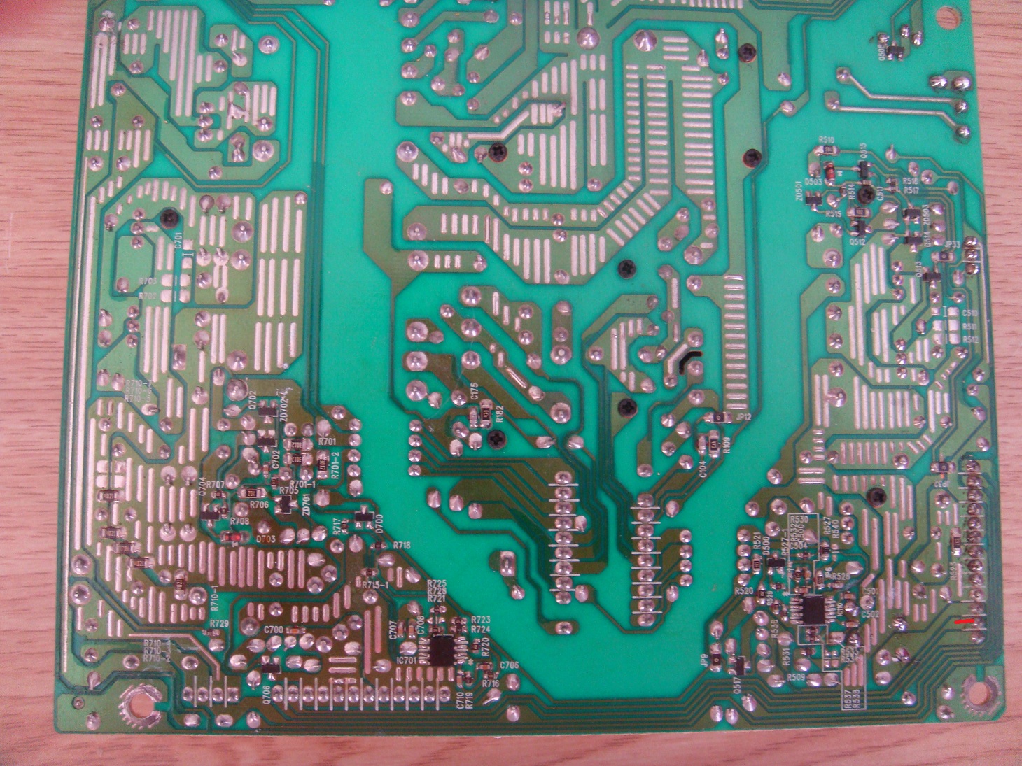

                                    Ok Plainbill, thanks again, I hope we are getting there, be nice to get this working properly

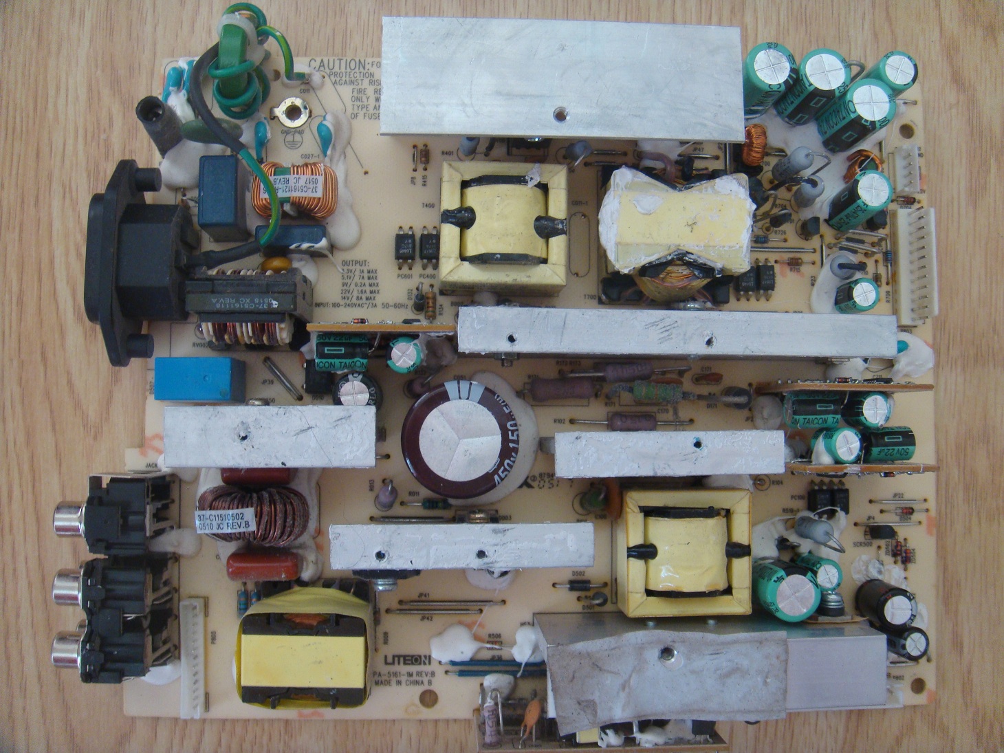

                                    yes pin 2 pow_stb when tv runs is 3.306v, when tv hangs .045 this time, pin marked in the pictures, also 2 caps marked that I changed
                                    thanks Ronnie

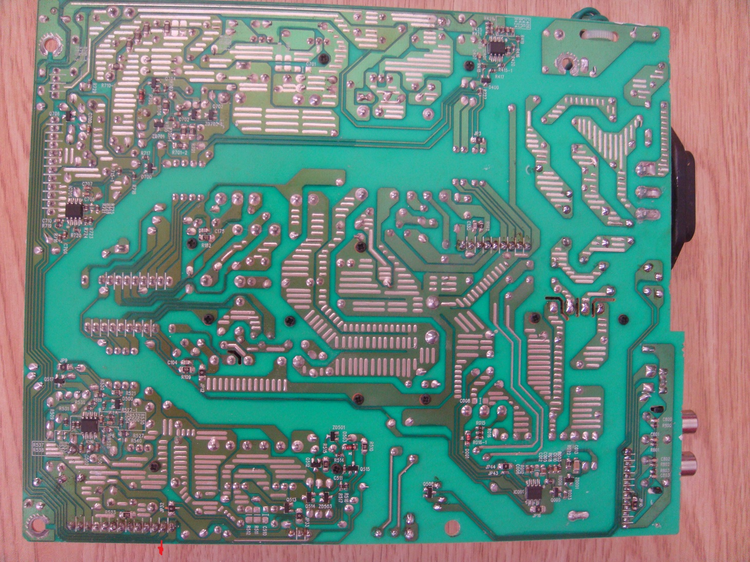

                                    P.S in picture 3 I put the red line on wrong pin, sorry, should be other end of socket

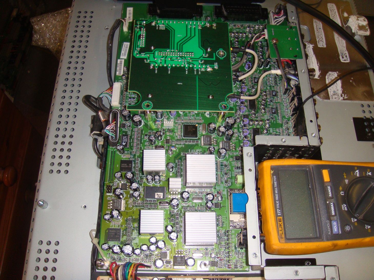

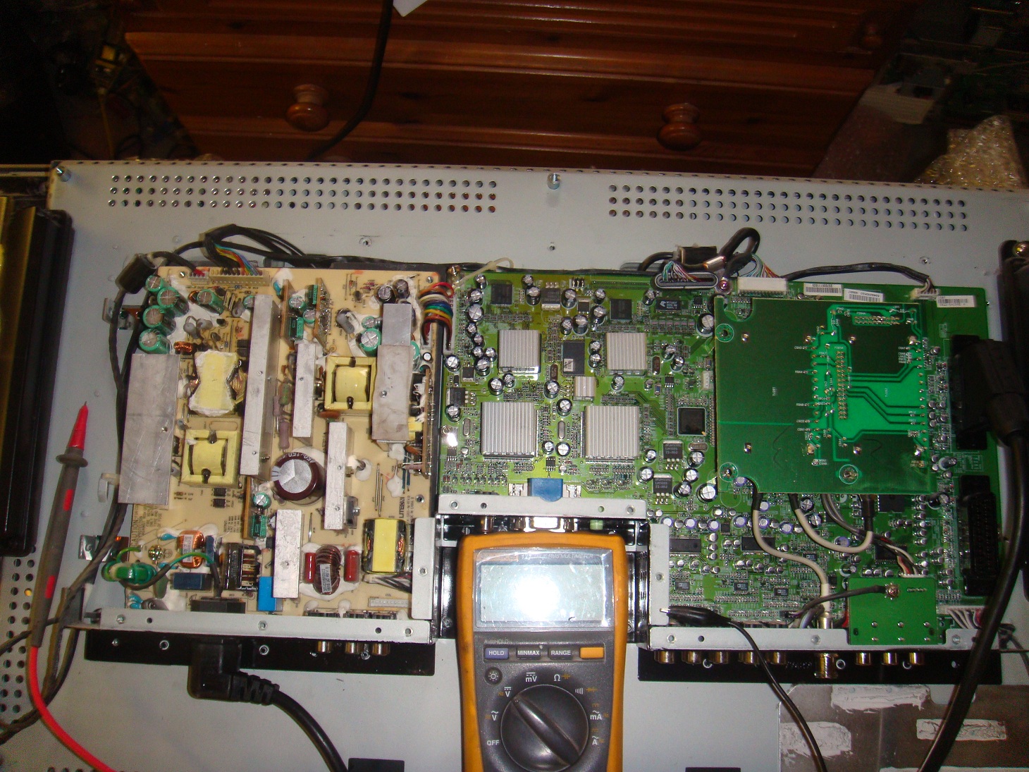

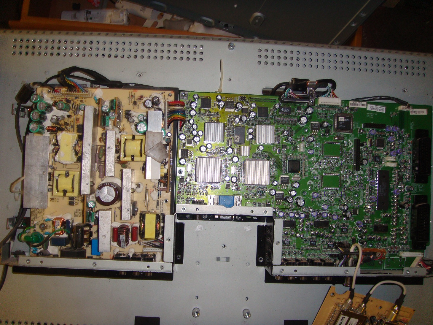

                                      Thanks for that additional bit of information. I was questioning my eyesight AND sanity. This is not the standby power output; it's some sort of status or control line.
                                      Here's what I would like from you.
                                      1. An over-all picture of the back of the TV with all boards in place and all cables next to their connectors, if not connected. I want to see what goes where.
                                      2. A picture of each connector on the power supply showing the legend for that connector.
                                      3. pow_stb appears to be connected to Q706. What are the letters on that transistor?
                                        Hi PlainBill no pwr_stb is not connected to that transistor, the trace goes off the other side to R422 marked in the 3rd picture . I hope these pictures are good enough for you to see
