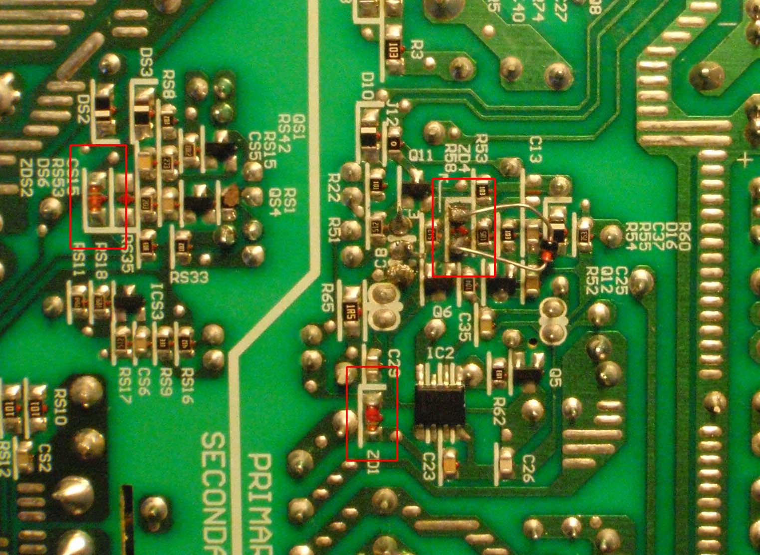

    view sonic 3260w
    need the part number for q7 on the power suppy board fsp22-3f01
  • daimoku
    • Feb 2011
    • 85
    Re: view sonic 3260w
    "a major issue with these supplies is q7, a small surface mount npn transistor. When this puppy goes bad, the supply pulsates, meaning your +5v line may run from 4.0-5.9 and it oscillates back and forth. It also causes I believe c36 to fail as well. Replace this transistor, I use any reasonable npn transistor and u should be fine."
    • chetreynolds
      chet
      • Aug 2010
      • 77
      Thanks I have subed a 2n222a and still have 5v . I also removed the zener d4 for testing and may have reinstalled it in reverse . After 75 years you start to do things like this can you give me the correct orintation of the diode ?
      • daimoku
        • Feb 2011
        • 85
        On most boards, manufacturers denote the orientation using a line (or stripe) on the PCB to indicate the cathode side should be oriented towards that stripe.
        • daimoku
          • Feb 2011
          • 85
          I just got a Viewsonic N3250W the other day someone decided to repair themselves (see the attached image). The power supply is a updated version of the fsp212-3f01, the fsp212-3f02.
          Anyhow, notice the stripes which indicate the orientation.
          • chetreynolds
            chet
            • Aug 2010
            • 77
            Thanks I had it installed right . I noticed how you subsited the diode good idea when you cant find an smd .
