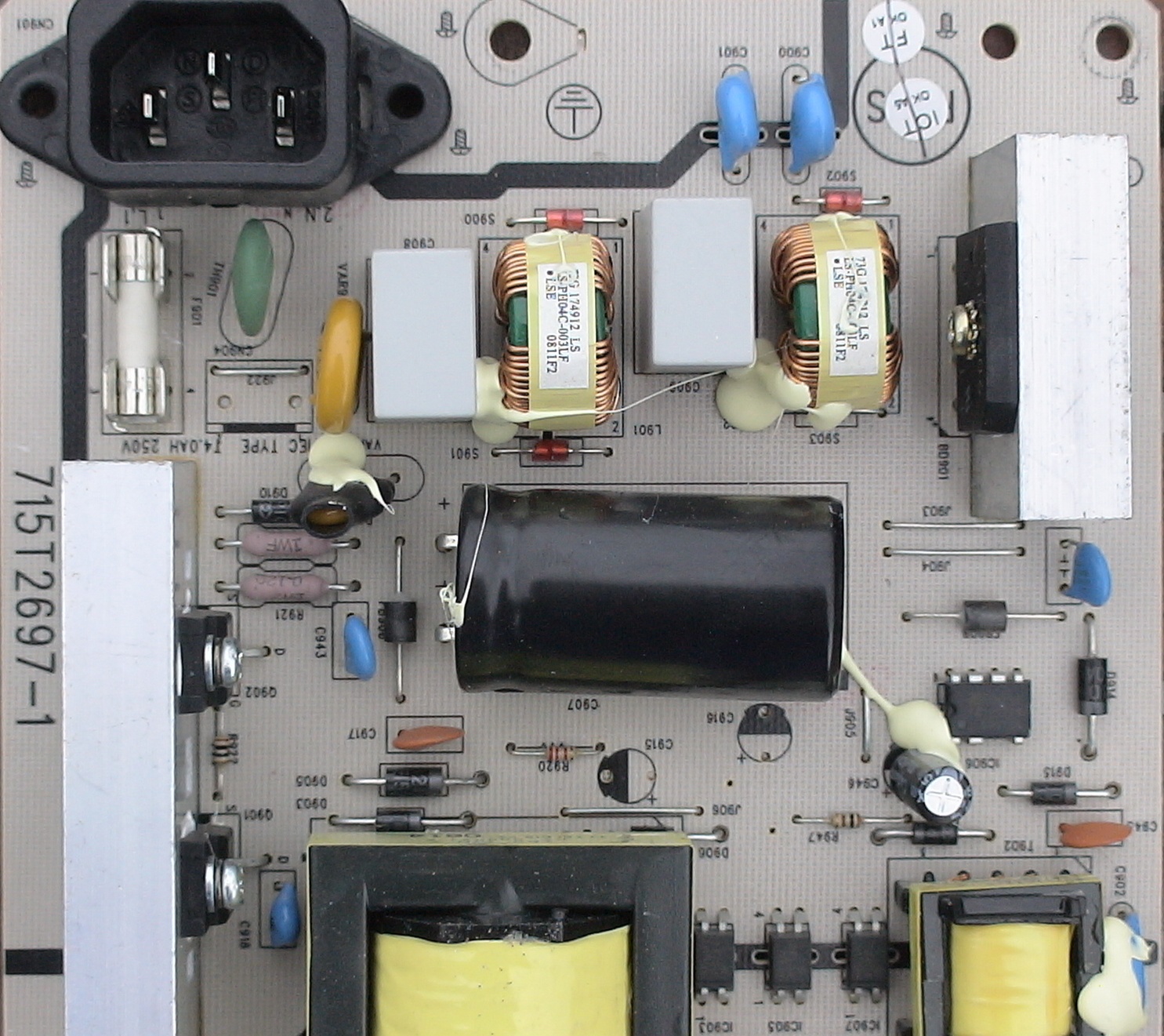

        And THAT seems to indicate you have a bad power supply!!! We're going to need a picture of the top, and another of the bottom, if you would.

          Re: Philips 32PFL3403d/27 LCD NO POWER
          I have some and I will try to get better ones too.
          • PlainBill
            • Feb 2009
            • 7034
            That would be a big help.
            PlainBill

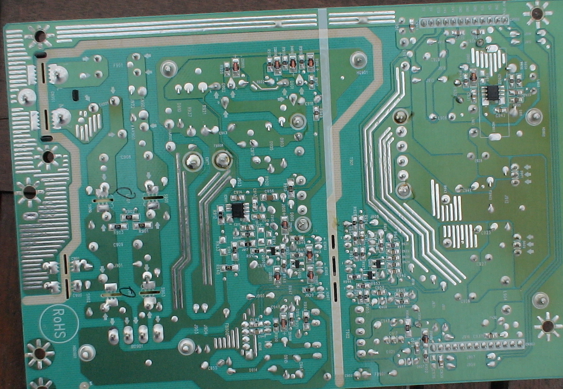

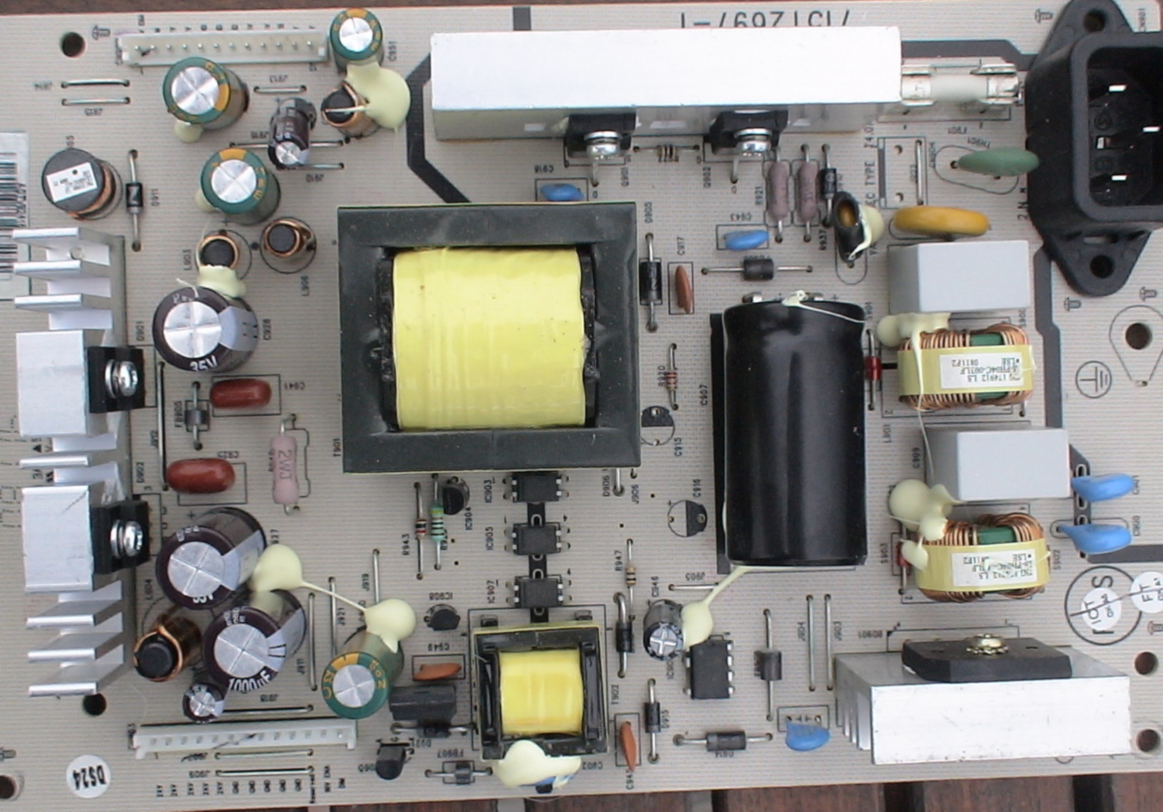

              Here are some better pictures to work with, let me know if these will do.
              • PlainBill
                • Feb 2009
                • 7034
                The contrast on the back side is pretty poor; unfortunately I'm not enough of a photographer to have a clue as to how to improve it. I wouldn't worry about it at this time.
                Still, I was able to do a little tracing. IC901, the 7 pin IC, is the main SMPS controller. What is the part number on that?
                PlainBill

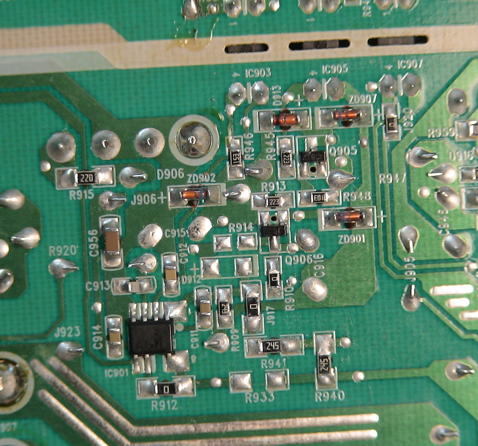

                                With the 3v supply hooked up, I read 5.9V across pins 4 and 6. Then for the optoisolators, read from left to right in the pic being IC903, IC905 and IC907, circled in orange, and NO 3v hooked up, I get 0.4v, 10.3v and 1.1. Then connecting the 3v power supply, I get 8.1, 0.3, 1.1.
                                  Great picture!!
                                  OK, it is obvious IC907 is related to the standby supply, while IC903 and IC905 are related to the main supply. I'll have to consult the datasheet to figure out which is which. Tomorrow.
                                  PlainBill
                                  • Mach1
                                    • Jul 2011
                                    • 34
                                    #37
                                    I guess I'm understanding my handicam a bit more to get a beter close-up, that and I played with the lighting.
                                      I did see some power supply boards for this TV on the net for sale, do you think they are as bad as this one? I was looking to satisfy my curiosity. One was for $60 some odd bucks and the other was for $200 something and I don't want to dump that kind of cash into this thing.. I guess if we can't get this thing to go, I'm dumping it and will NEVER EVER buy a philips made TV.
                                      There is nothing wrong with Philips TVs. They aren't the top of the line, but at least documentation is available for them, unlike the Vizios and the private label junk coming out of China.
                                      IC903 provides feedback for the SMPS controller, so IC905 is handling the On/Off control.
                                      This is going to take a while.
                                      Step 1: Check the resistance from J923 to pin 3 of IC905.
                                      Step 2: To be determined. I'm having problems tracing a link from Pin 6 of IC901 to pin 4 of IC905.
                                      PlainBill
