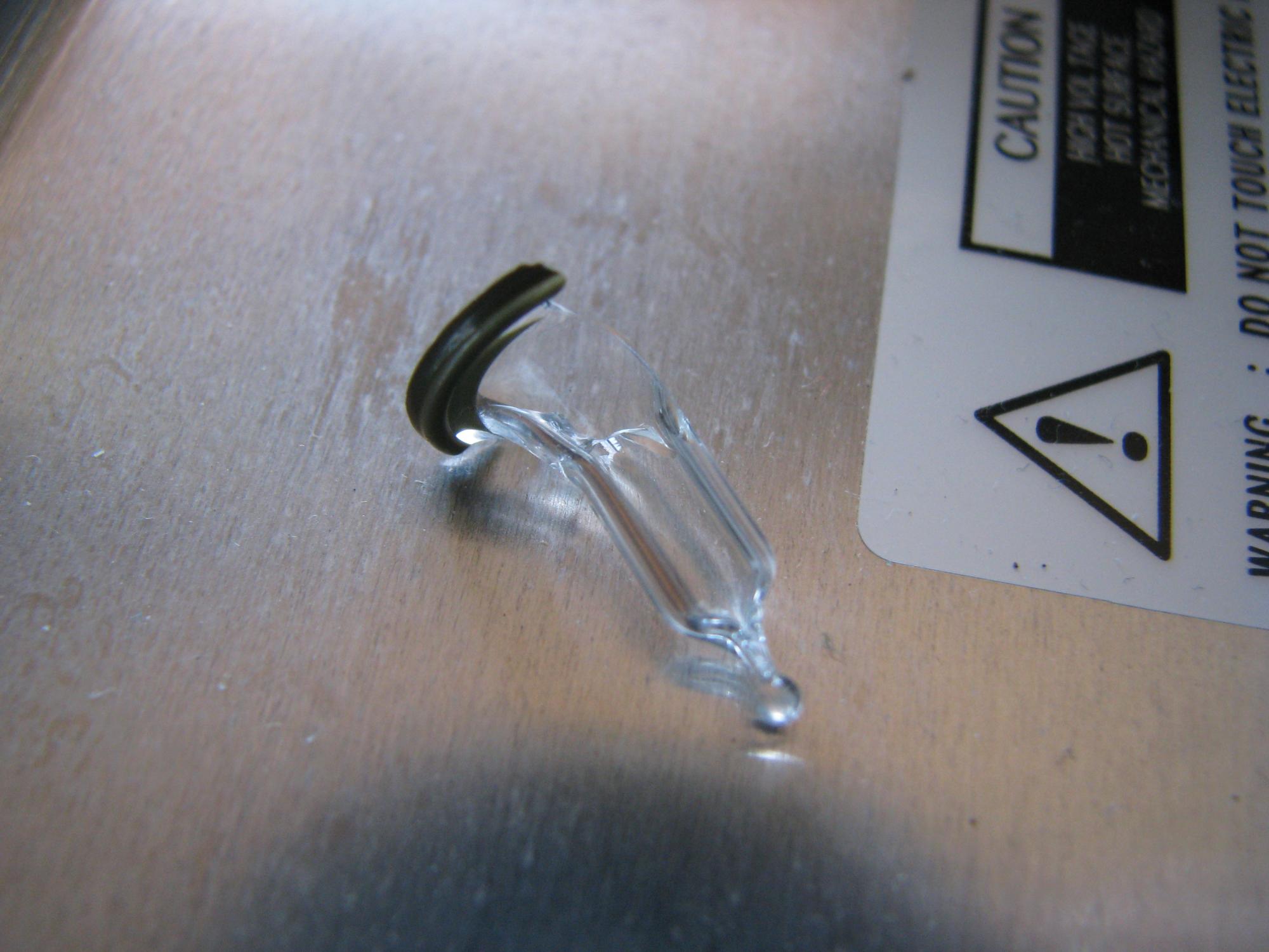

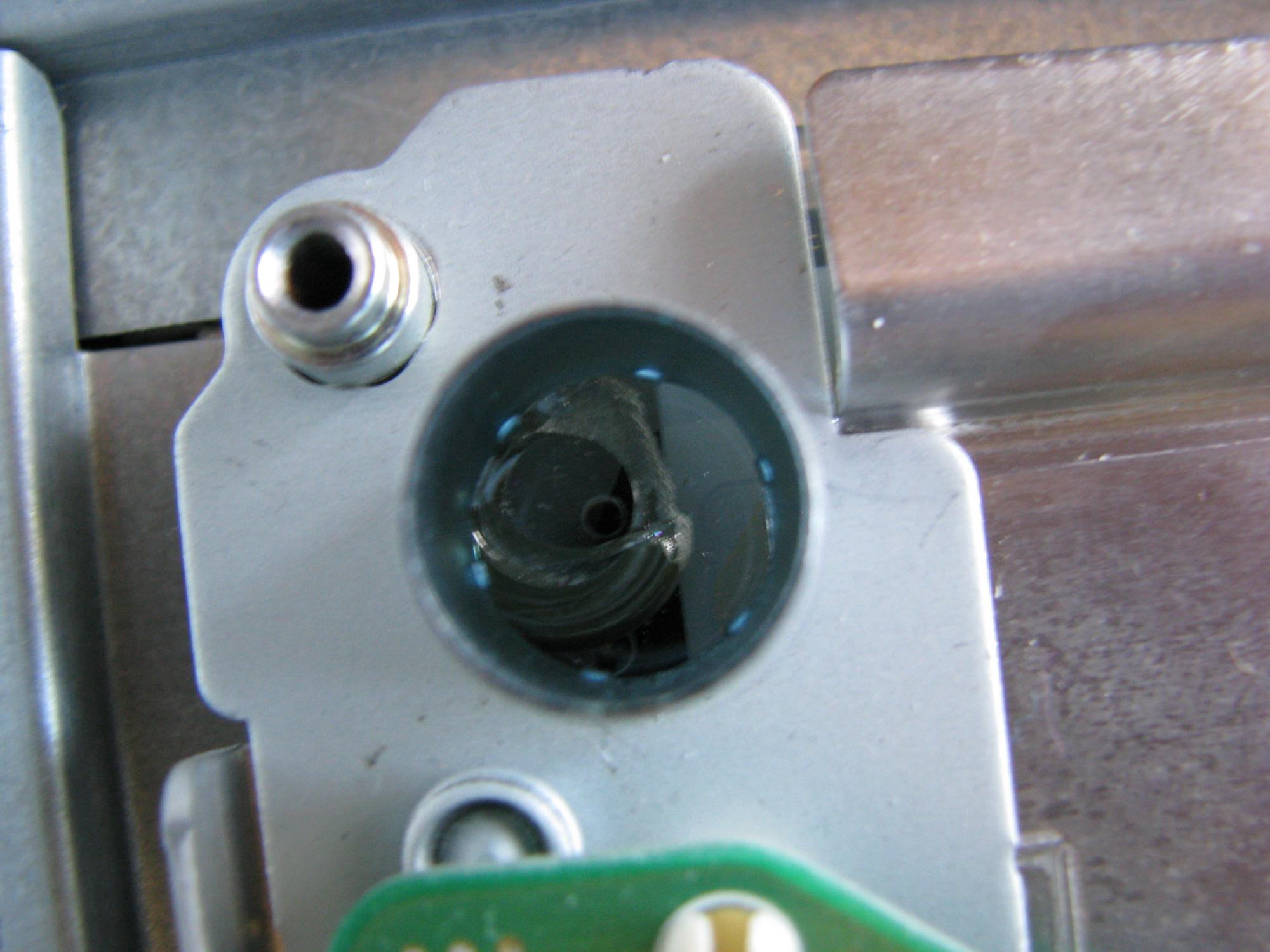

                ...Ok, I think I found the problem...
                Up near the top left corner of the panel (looking from the rear) there is a small, metal, open-ended tube, which had a piece of broken glass inside it. The glass piece had a circular bottom and a top which looks like a mini christmas tree light bulb. It looks like the metal tube put stress on the glass piece (which appears to have at one time been attached directly to the plasma panel) and broke it off. The broken part was just sitting in the tube, I had to pull it out.
                Anyone know what this is and what its purpose is? I have no idea, but if it was attached directly to the panel I'm losing hope that it's something I can fix...

                  That is the evacuation tube for the panel. The TV is junk unless you can find a good panel (or another TV using the same panel).

                    or glass blow another evacuation stem on it, and pump down the panel, and pump it back full of gas. (good luck on that). Assuming there are NO other cracks ANYWHERE else.
