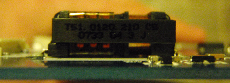

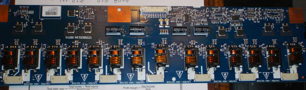

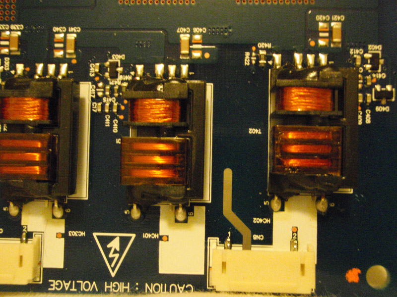

    Found 5+ transformers on the inverter with shorted primaries. I'm amazed the backlight would even fire up. The board is VIT68001.94 Rev. 0 or there's a small sticker that also says CPT 320WF01SC. Pics attached.
    My question is: How do I order the proper replacement transformers?
    I see a plethora of options on digi-key. I know that they're power transformers, but I don't know where to go from there.
    I see T51.0120.210 C5 on the side of each transformer, but that doesn't bring up any datasheets/info/results. Thank you!

    I'd be really surprised to see 5 shorted primaries. Those have a very low resistance. The usual problem is the secondary on one of the transformers will short.
    However, assuming you are correct, the cheapest I have seen one of these transformers was about $12.00. Someone on eBay has a complete inverter for under $35 with free shipping.

      errr sorry you're correct. Just went back and checked - 5 out of 14 have faults in the secondary windings. Looks like I'll be purchasing that inverter from ebay.

          Now, the issue was that the tv would shut down, but it could be immediately turned back on. Found shorted secondary transformer windings (thank Bill) on the inverter and replaced the inverter (PN in earlier post).
