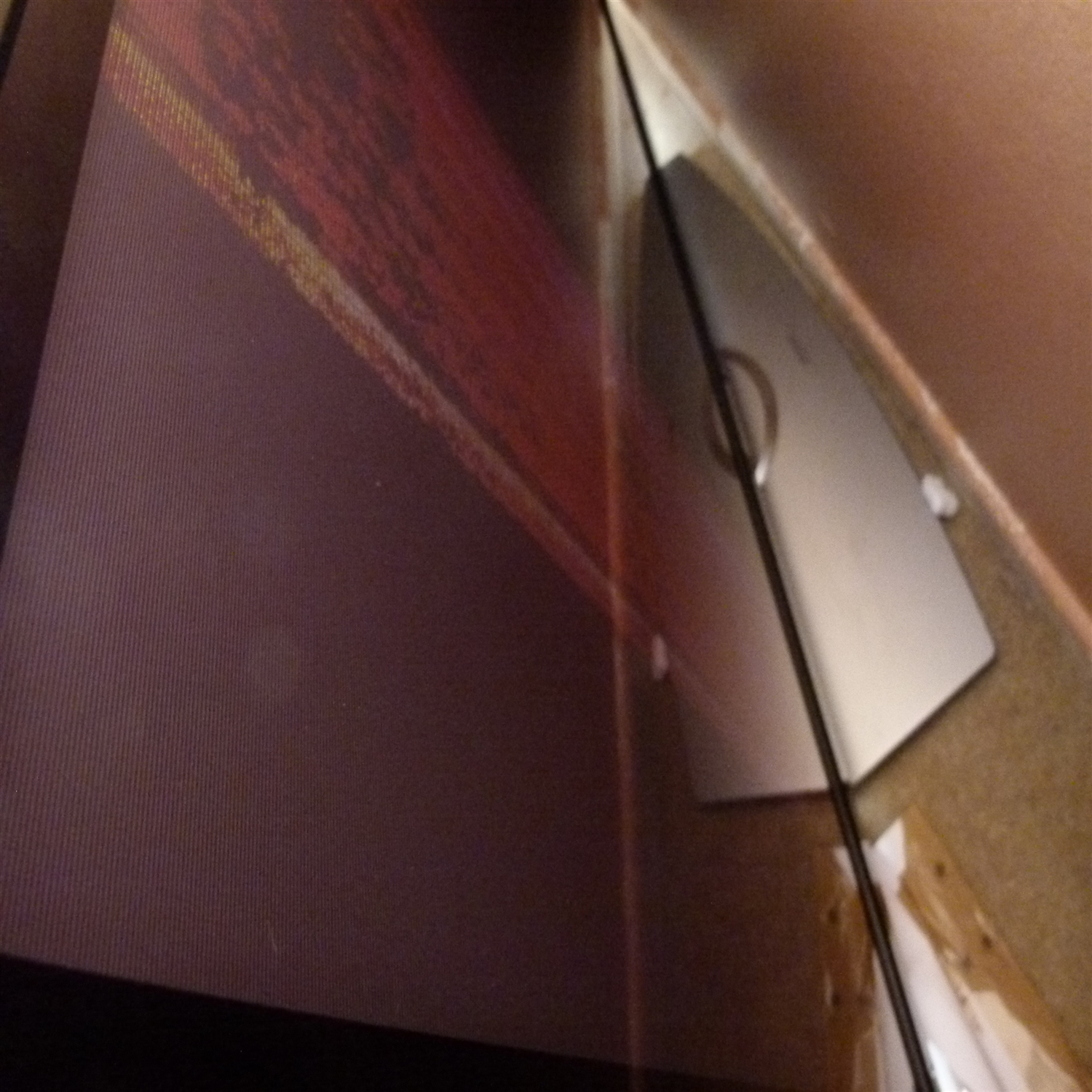

        Unplugged a cable going from the Ysus directly to the Zsus board. This has resulted in getting red lines/sections across the TV. The lines appear in four segments, one on the left, one in the middle, one small thin one next to it, and then there's nothing on the right hand side of the screen. Then it resets. Sound still works.
        according to the manual this indictates a faulty Zsus?

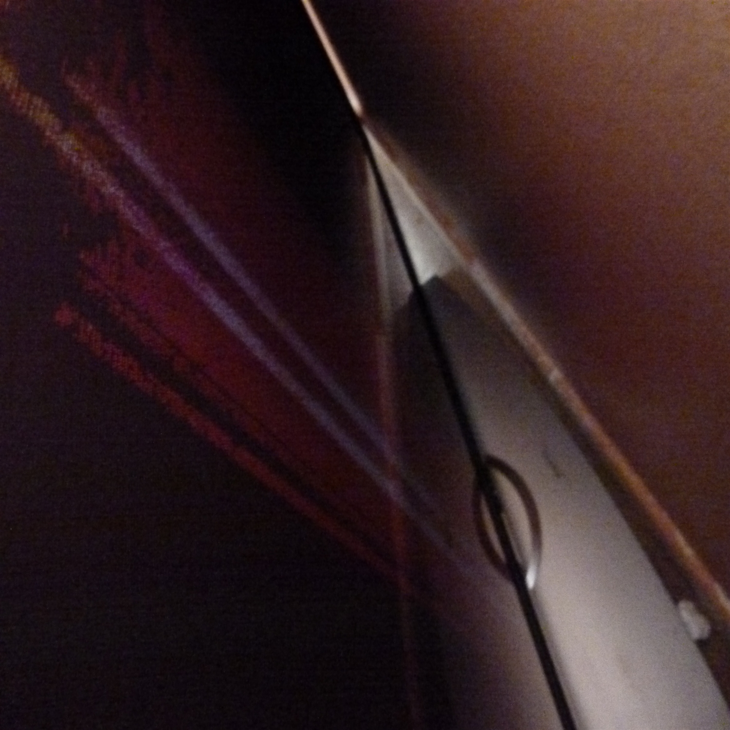

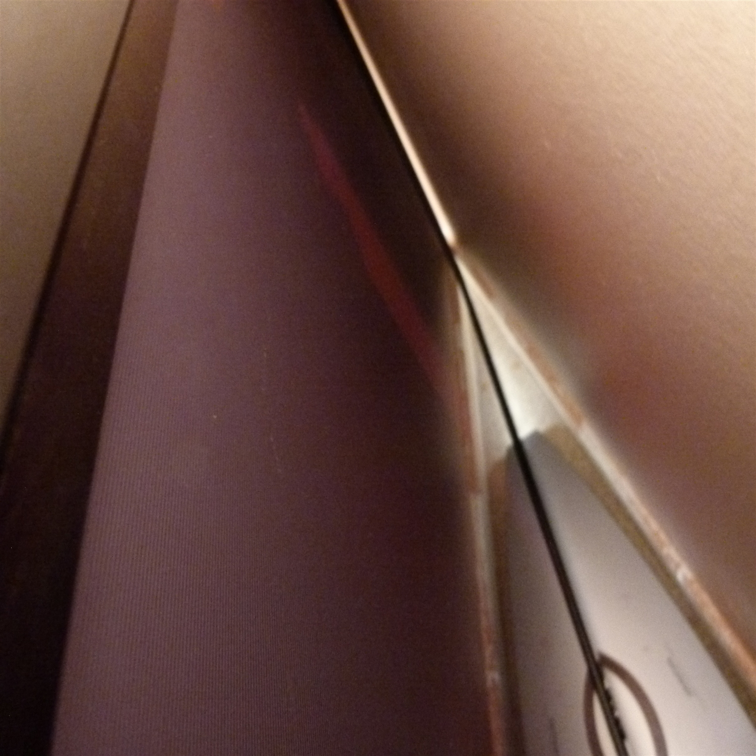

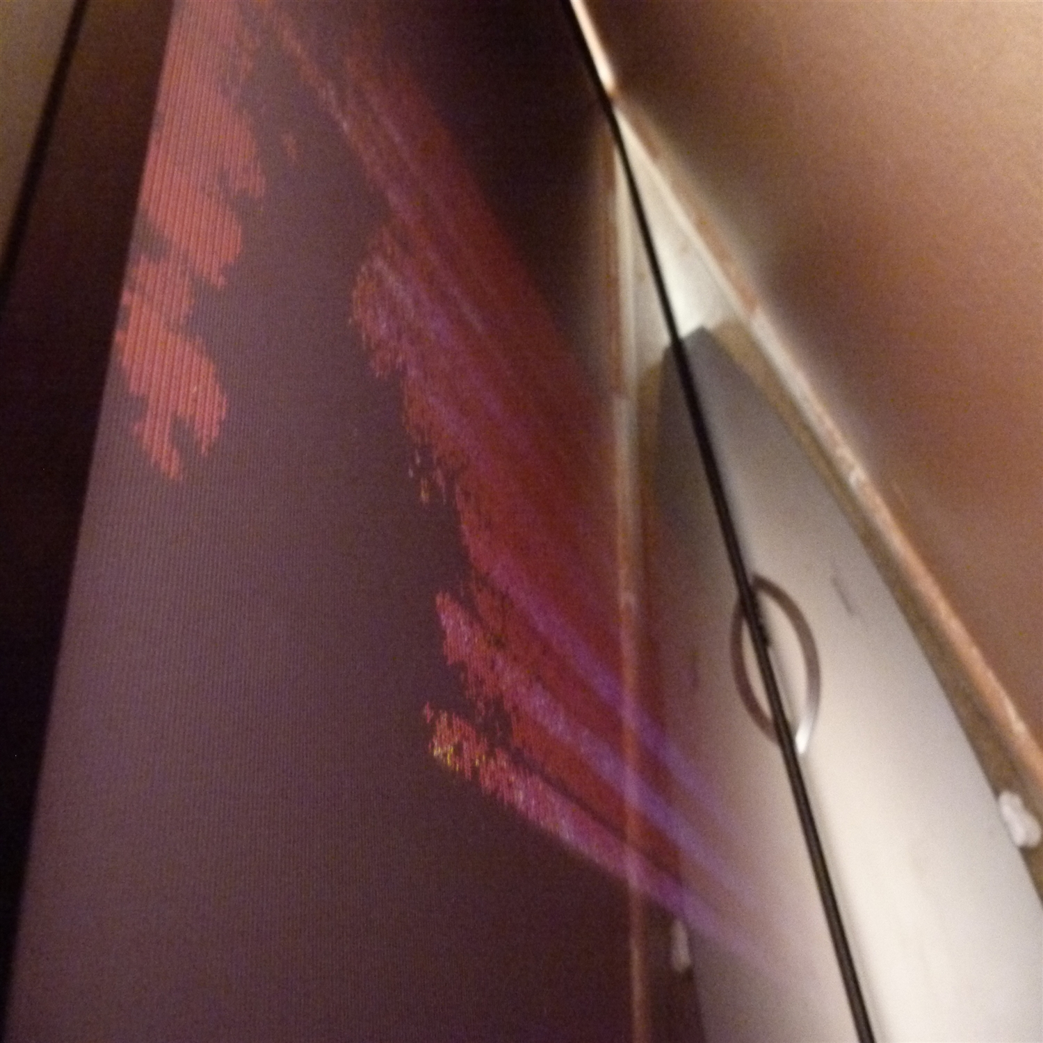

          Well I put this away for ages, and then came back to it as I had nothing better to do today. Carrying on from the above situation, I removed all cables from the X-sus board and switched it on. This resulted in the above result but a bit more mixed; ie more colours, some lines stayed on the screen whilst others continued the loop. But still nothing on the right section of the screen. I think one of the buffer boards which controls the right section is bust?

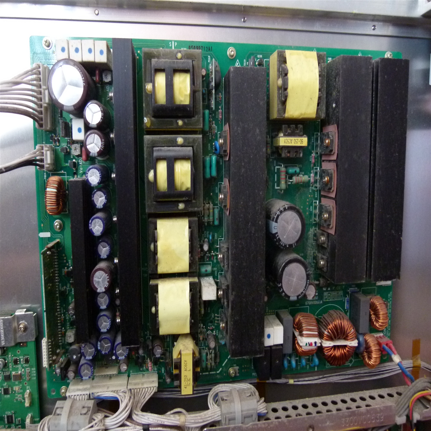

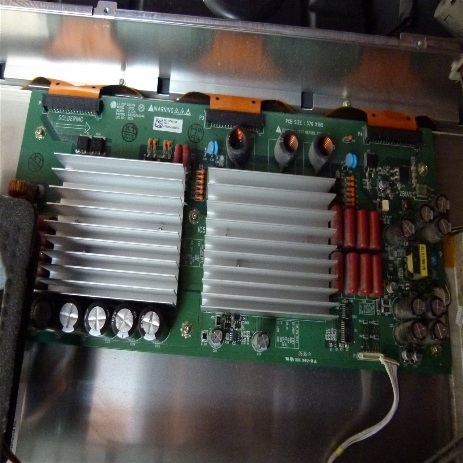

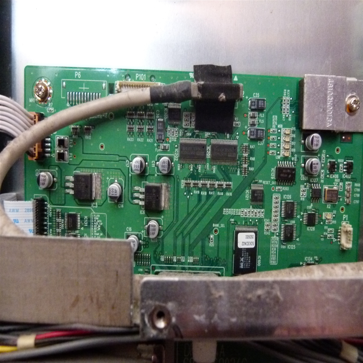

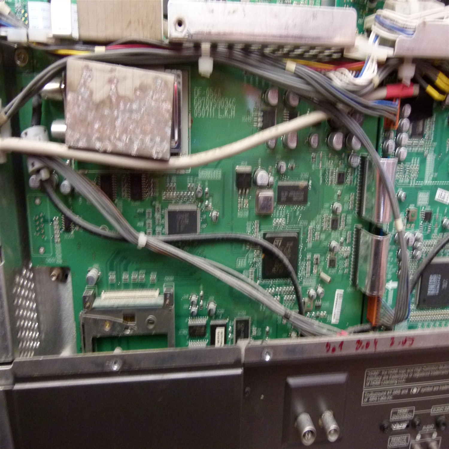

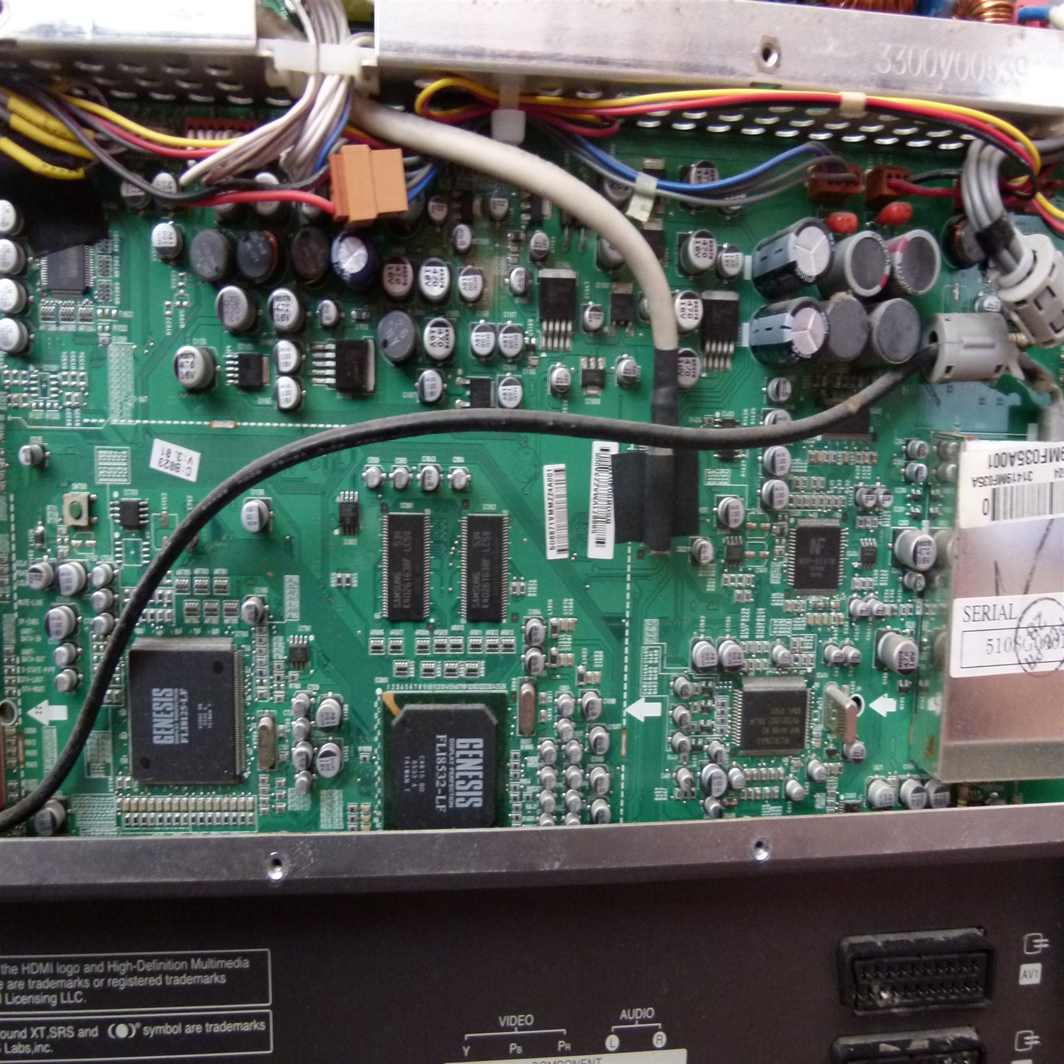

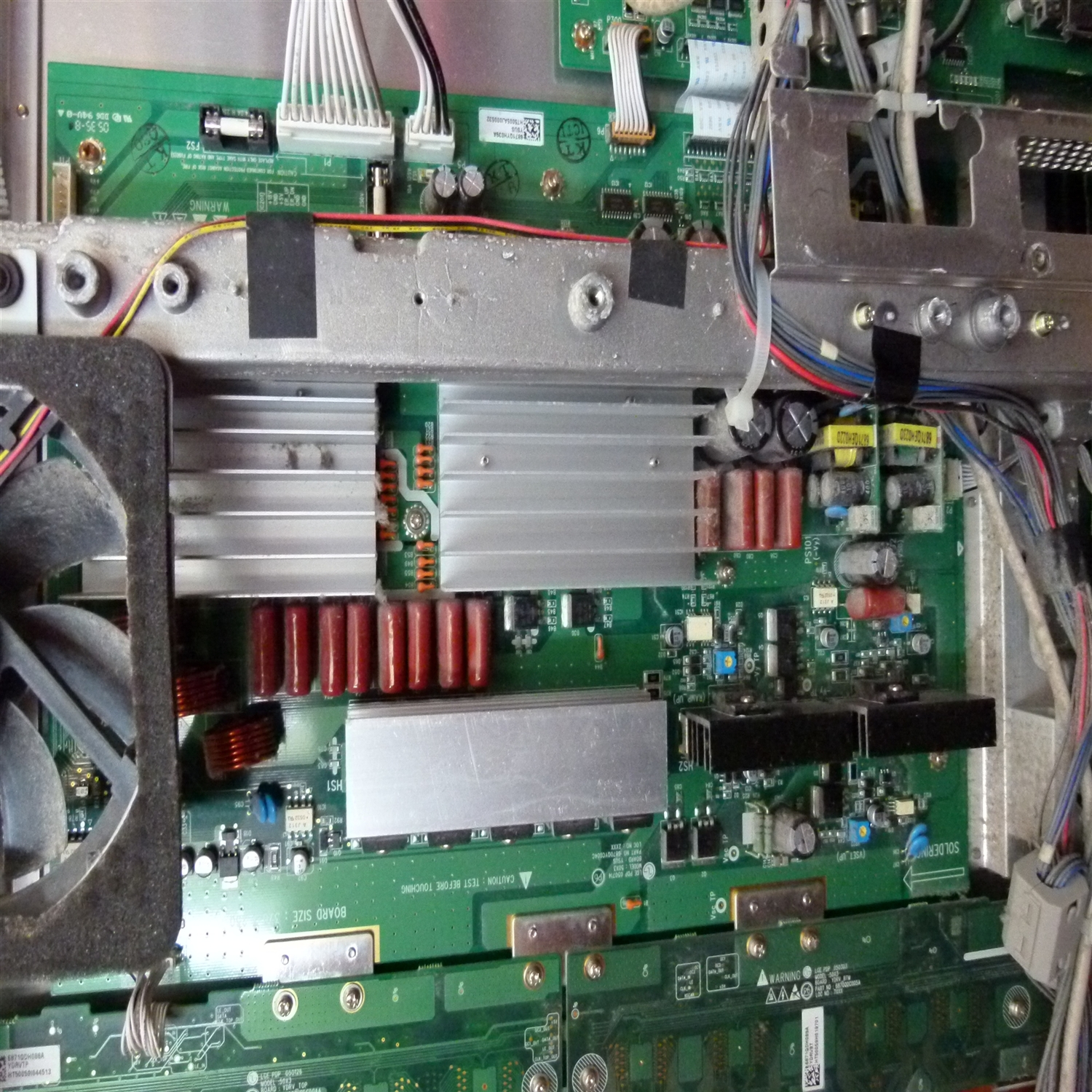

            Here are pictures at 1500x1500. The pictures of the screen show the result of having the X-sus unplugged completely. Having it plugged in results in a completely blank screen. Did I do the right thing ordering the X-sus?

              Got the x sus and fitted it today. Noticed 2 components are missing from it but I'm not sure what they're called. This is a revision B and mine's an A, might be why they're not there?
              Anyway, put it all in and turned on. Smell of burning. Shut it all off and rechecked all connections, powered it up and it goes into protect mode. Red, yellow, green, click, red. Unplugged X sus and it powers up fine. Plugged X sus back in and unplugged Y sus and it powers up fine.
              Before when I would unplug the X sus, I'd get red lines across the TV. Now I don't.
              Bad power supply? Shorted buffers? Bad mainboard..?
              Edit
              Just plugged everything back together, turned it on, and the lower IPM on the x sus went PING and now just clicks constantly. Guess that just blew up. Any ideas?
