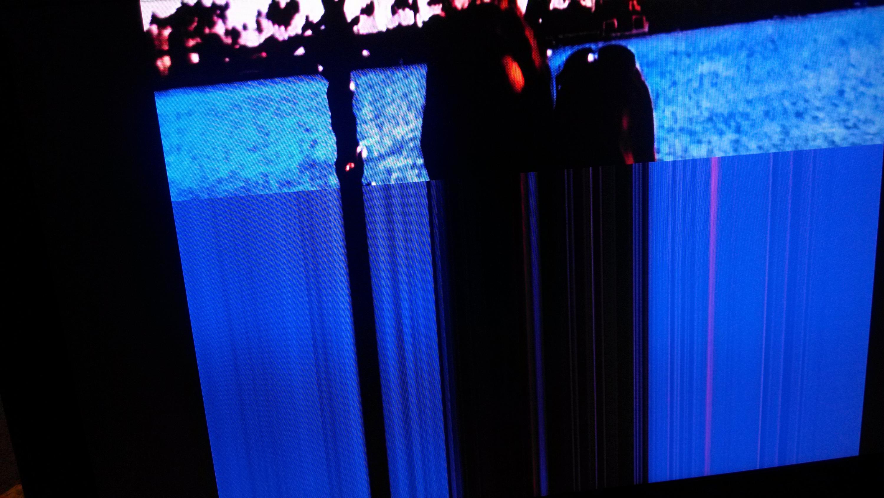

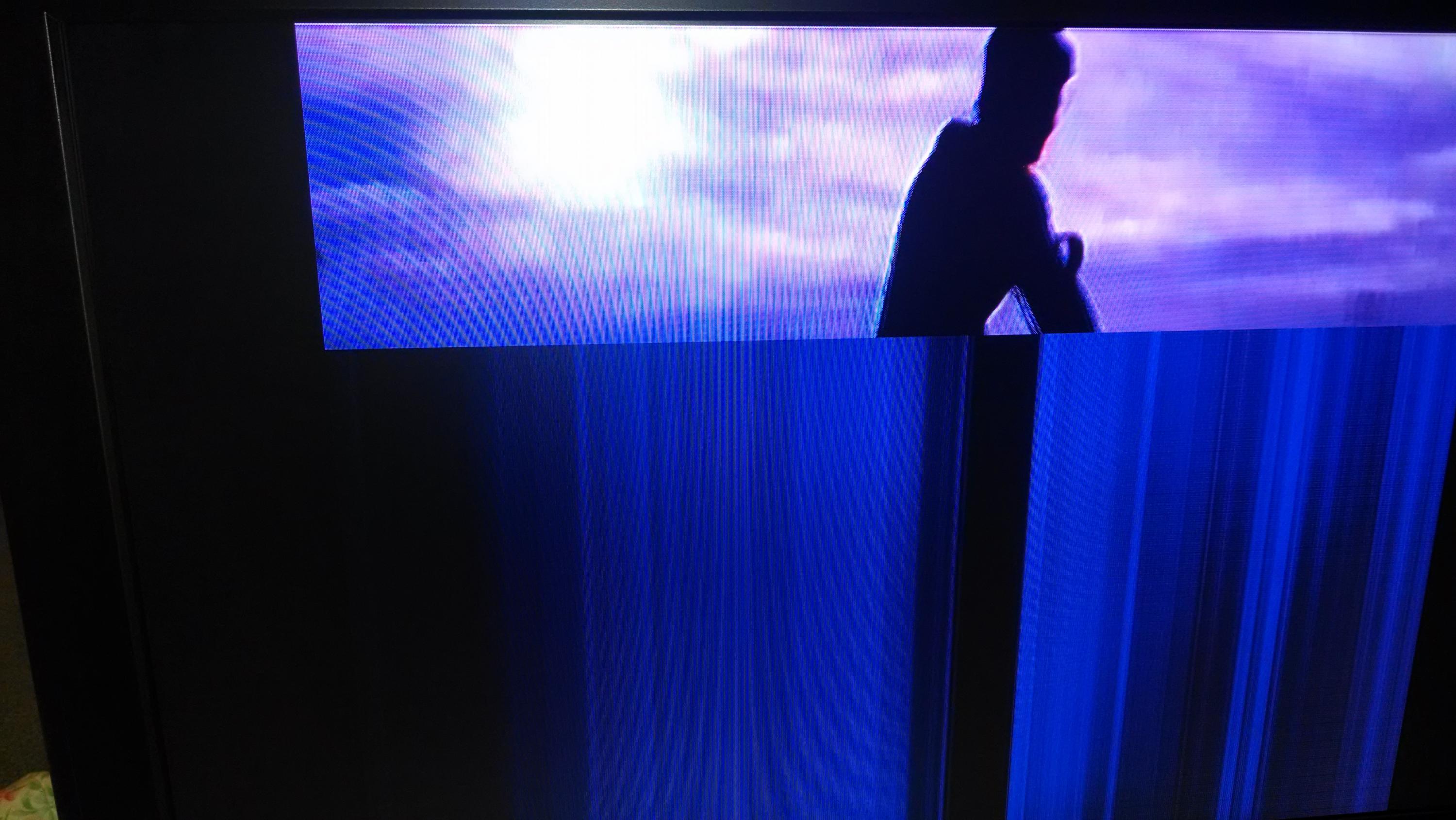

          I am pretty sure this is not a power problem but I have a Dynex DX-LCD32-09 tv that all of the sudden started with some serious display issues. The top third or quarter of the screen has (I think) reversed color in the image and the bottom 2/3-3/4 has vertical stripes.
          I have looked through the forums and although there is not a specific reference to this model, it looks like similar display issues may be associated with the T-com board. Does that sound accurate to you? I have attached a couple of pictures.
          Although I have replaced the color wheel and light bulbs in our DLP TV, I have not worked on the LCD's. Is replacing the T-Com board something feasible for me to do? and are these parts readily available at a cost that makes this even worth doing? The manufacture date is 2008. I have serial number and lot number if that is helpful.

            Try flexing the screen/frame to so if the symptom will change.
