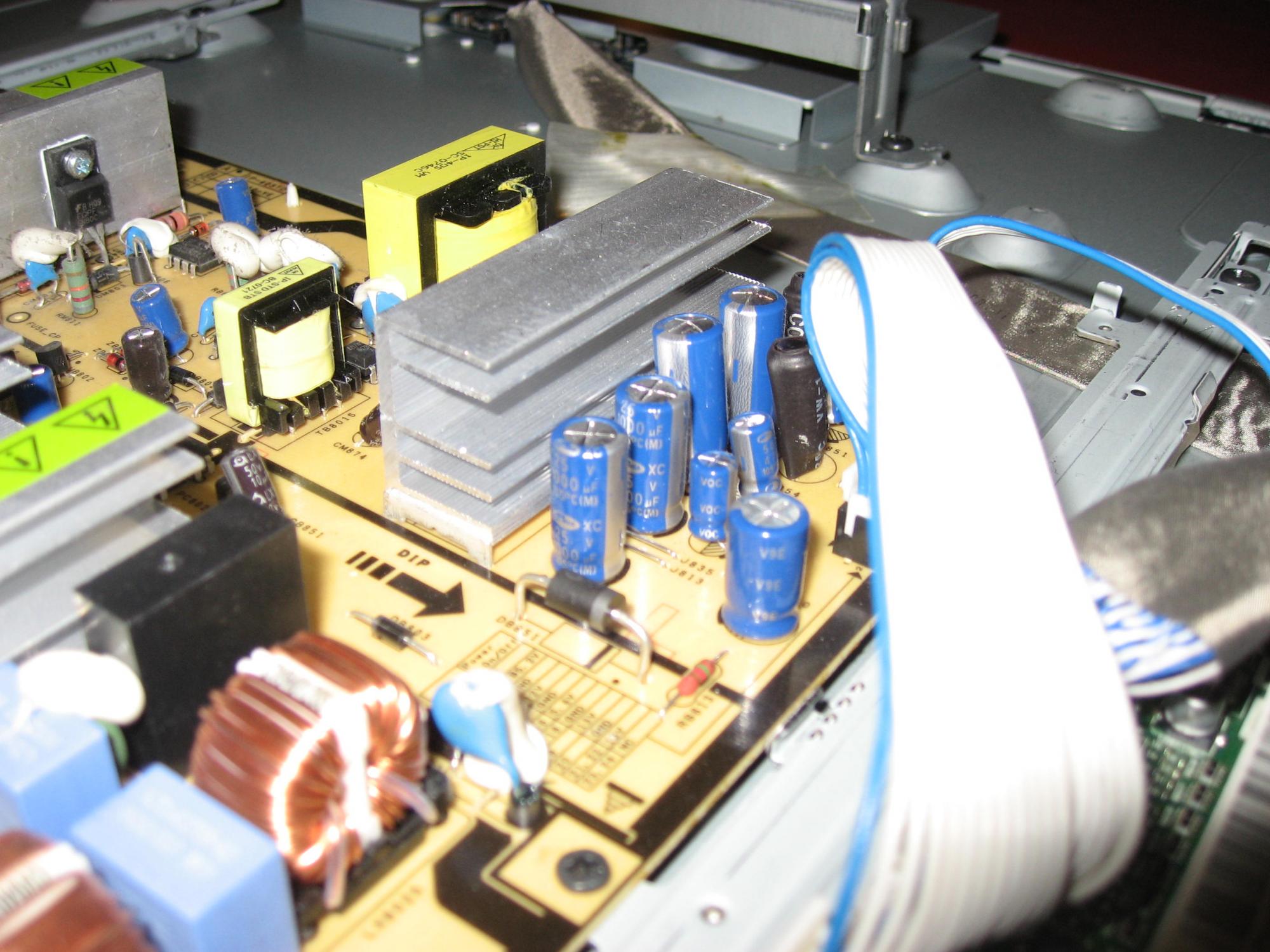

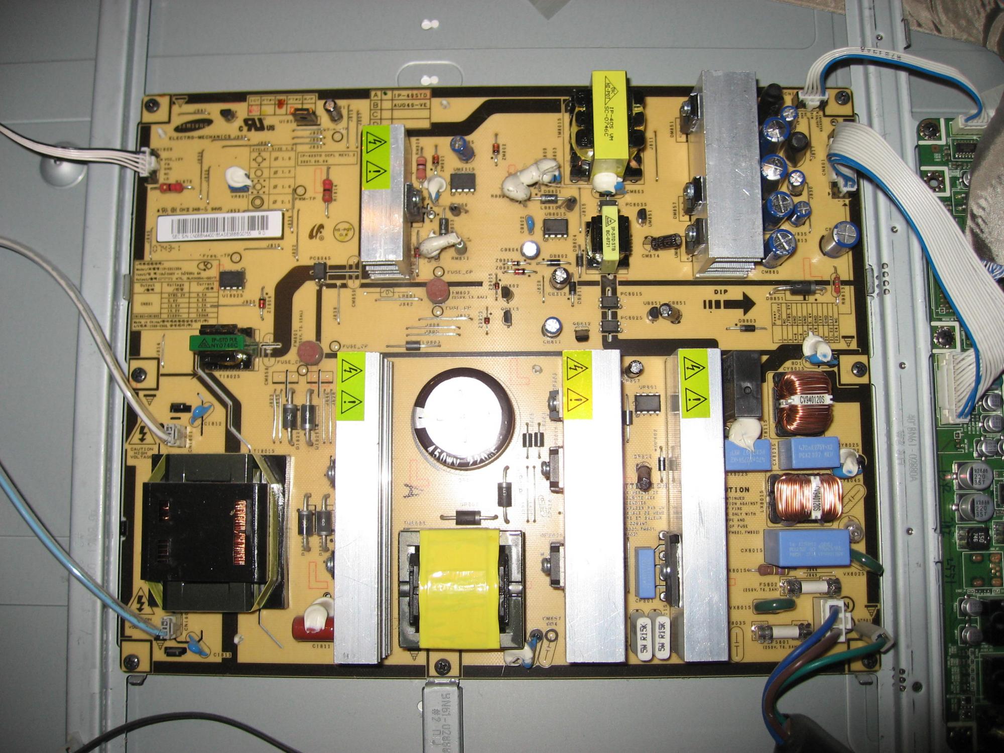

    I have an almost 3 year old Samsung TV that has just started having troubles turning itself on. Unfortunately it's an imported model, so it's not covered by the 3 year Samsung warranty.
    Since I haven't done this before, I'm wondering about caps. I've been browsing this forum for a few days and I've seen Panasonic's capacitors being recommended.
    The TV have two capacitors that look inflated, and they're rated 2200μF 10V 105C. Would any of these be good replacements?
    http://uk.farnell.com/panasonic/eca1...0uf/dp/1848535
    http://uk.farnell.com/panasonic/eeuf...0uf/dp/1800626
    From what I see these two have vast differences in life time expectancy, but also AC ripple current. Is this something I need to worry about?
    I'd very much appreciate any help!
    P.S. Below are two pictures of my power board.

    here we go again... Samwha XC series
    samsung just doesn't wanna learn
    i'd replace all those light-blue Samwha caps (including the tiny ones) with equally rated Pannys. FR/FC/FM series (maybe even FL?)
    your second link points to Panasonic FR, which is OK for this purpose, but the first link is Panasonic NHG, which is a general purpose 105°C cap... not low-ESR -> not suitable for switchmode powersupplies like this one

        the problem with those Samwha's is that there no datasheet on the web for the XC series. so looking up their ESR to find matching new caps isn't really possible.
        but you should be fine with panny FR/FC/FM and FL series caps as replacements for the bigger ones.
        Replacing only the obvious bulging caps is a bad idea, because the others are most likely not far behind. Also.. you're in there anyways.. much better to replace all of them now than having to open this TV up again in a couple months or so because the other Samwha's failed

          1) Agreed. If you look at the area, there is a massive heatsink that holds 3 transistors. There is a lot of heat in that area. Capacitors die from age, heat, and shoddy build quality. Capacitors DO NOT have to be visibly bloated in order to bad. They can be out of tolerance uF (a 1000uF measures 20uF) and/or have high ESR (ohm). A multimeter will be insufficient to test for ESR. For that you need an ESR tester which costs between $50 and $300.
          2) Practice your soldering on old boards. If you have a friend that is good at soldering, get him/her to do it.
