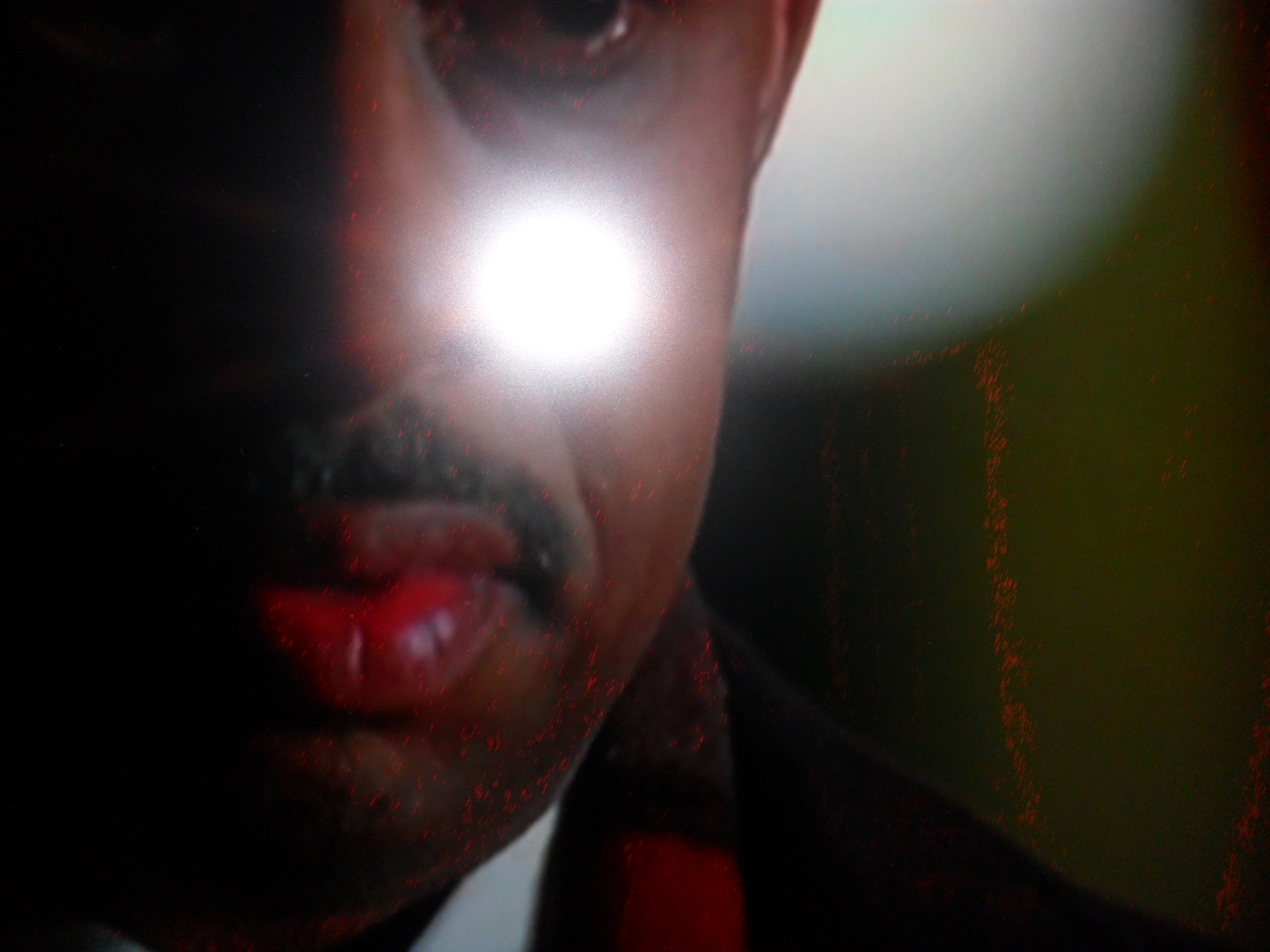

hello guy having issues with one of My LCD TV's ....newbie with the LCD tv repair ...where do I start with this i wonder if it is the controller card or main board issue? having red moving pixelation...=(
Vizio VS420LF1A

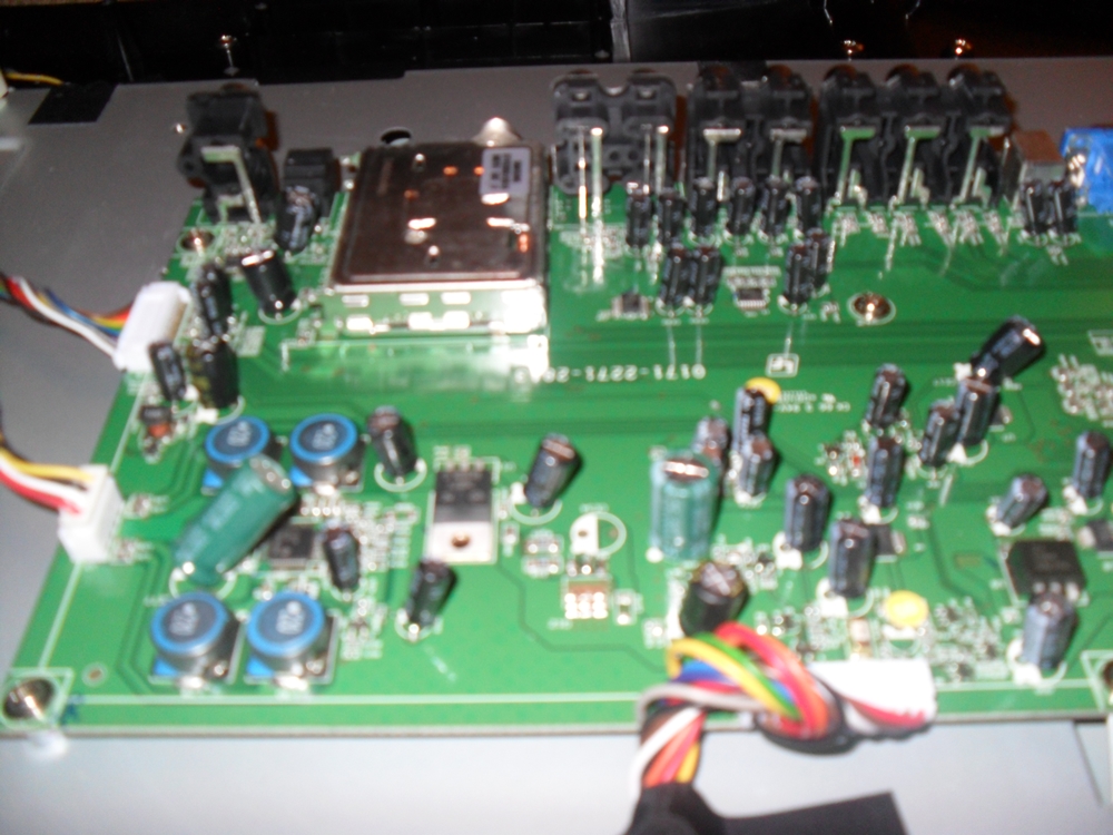

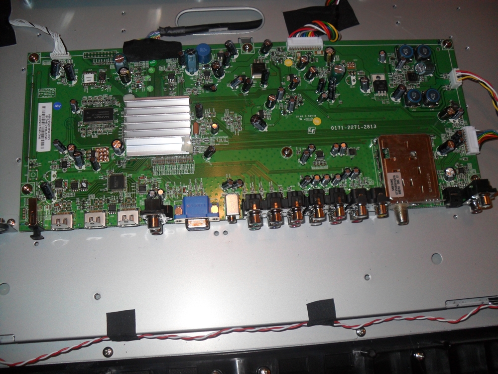

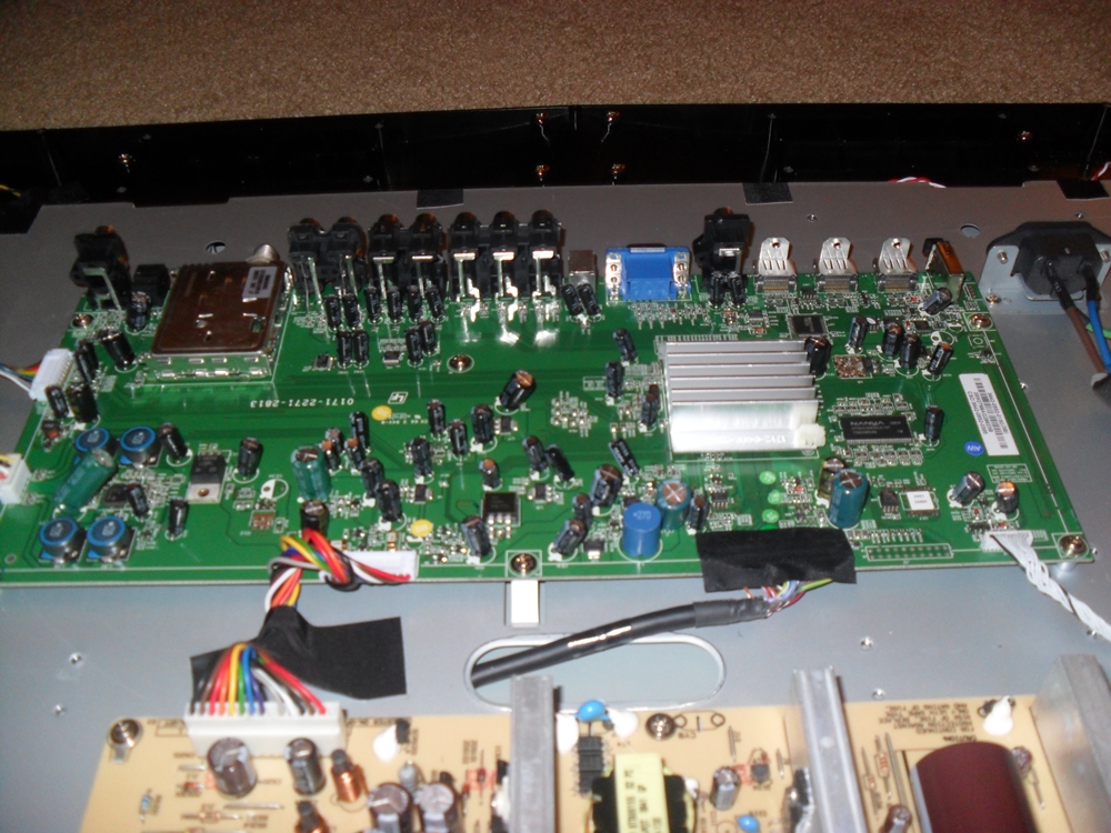

It would help to have clear focused pictures of the insides of your tv. Please post an overall picture of the boards and then a picture of each board. Use manage attachments like you did in post #1.--- begin sig file ---

For your sake, I hope it's the video processing board and not the panel itself. Your power supply should be fine.
The first thing I'd do is find out if this occurs on all video inputs. This doesnt prove or disprove one board or the other however if one imput works better than the other, you might want to live with using the working input.The strong-minded rise to the challenge of their goals,the weak-minded BECOME HATERS

OK... as before mentioned in post number 2, post clear pictures of the set opened up, then the boards in this set. Post the numbers that are marked on these boards.The strong-minded rise to the challenge of their goals,the weak-minded BECOME HATERS

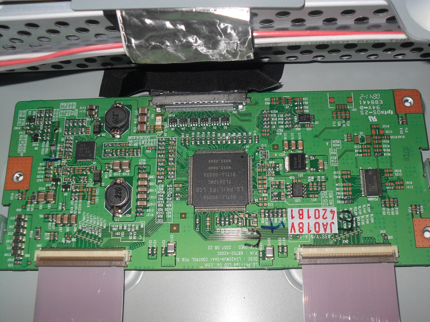

I am suspecting the board in the very last picture. I believe it's the t-conn board. I cannot tell you for sure but if you can post the numbers on this board, it can be looked into further.The strong-minded rise to the challenge of their goals,the weak-minded BECOME HATERS
Re: Vizio VS420LF1A
With this current problem, I suggest swapping this board. I can't promise you that doing so will fix the problem however there is no way that I know of to test this board.
If you search in ebay for "6870C-4200C" you will find a lot of these boards for sale varying in prices. The cheapest one I seen was $20 with cheap shipping. ShopJimmy has them for about $40. There are no guarantees with ebay so be carefull.The strong-minded rise to the challenge of their goals,the weak-minded BECOME HATERS
