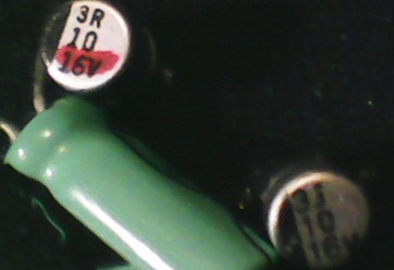

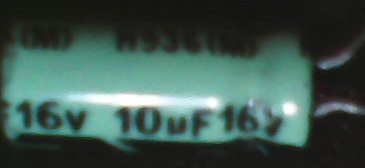

    Ok the deal is this I got a free 42" toshiba rear projection TV with the Hyper Module(scan converter) problem. Thought I could fix it and would have by now if I had'nt made the mistake of pulling a solder pad off the board. Any way I replace the 11 10uf 16v caps couldnt find the little ones that are on the board so I replaced with wire legged caps. Plugged in set look like it was going to work image fluctuated TV shut off and I noticed smoke comming from the module I quickly unpluged it heard what I thought was the TV speakers but that sound could have been a cap on power board blowing. Well looking at the board there's either what is called a transistor or a power regulator that got fried and damaged the board itself. My question is could the wrong caps have caused the surge? Tv operated before this Module work but now the power light just blinks. In addition to help with this question can anyone point me to where the power short might be? I am currently replacing legged caps with identical ones I believe are rated the same.

    Wow no ones got anything to say about this. Should I take that as there's no help for this set or that I am heading in the right direction to correct the repair. Is it possible that the sot-89 is a common device to be used any way Her's a pdf file for free viewing with Adobe. Help me so I dont screw any more poches!!! I dont like pooch click link for info on SMD components and ratings.https://sendnow.acrobat.com/?i=dctRVIk8VV2KeF2jc2uPnA if not a link copy and paste in browser. Hey if you understand it help me too!!!!!!
