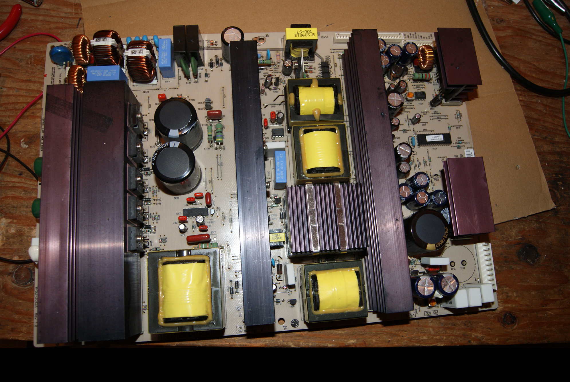

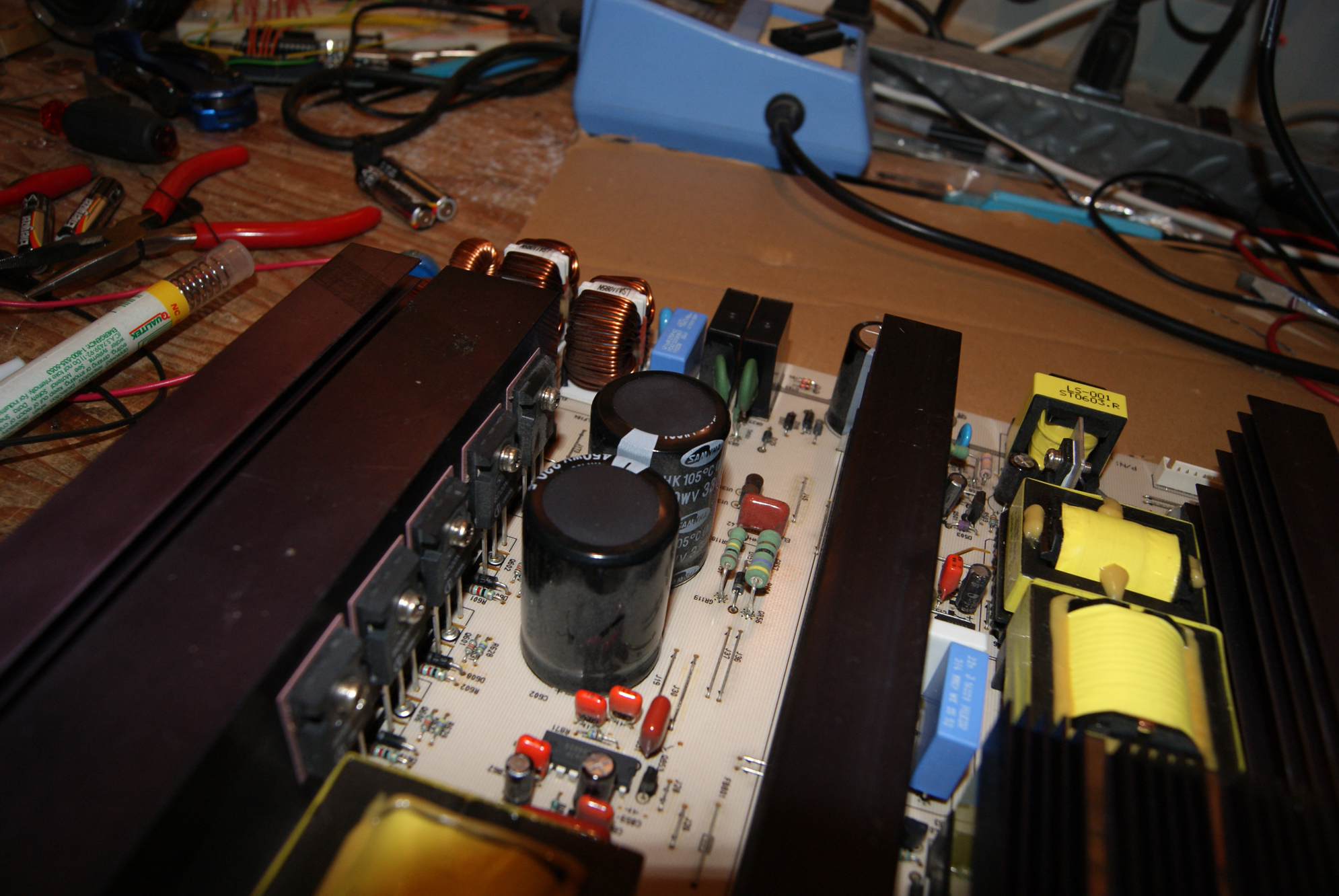

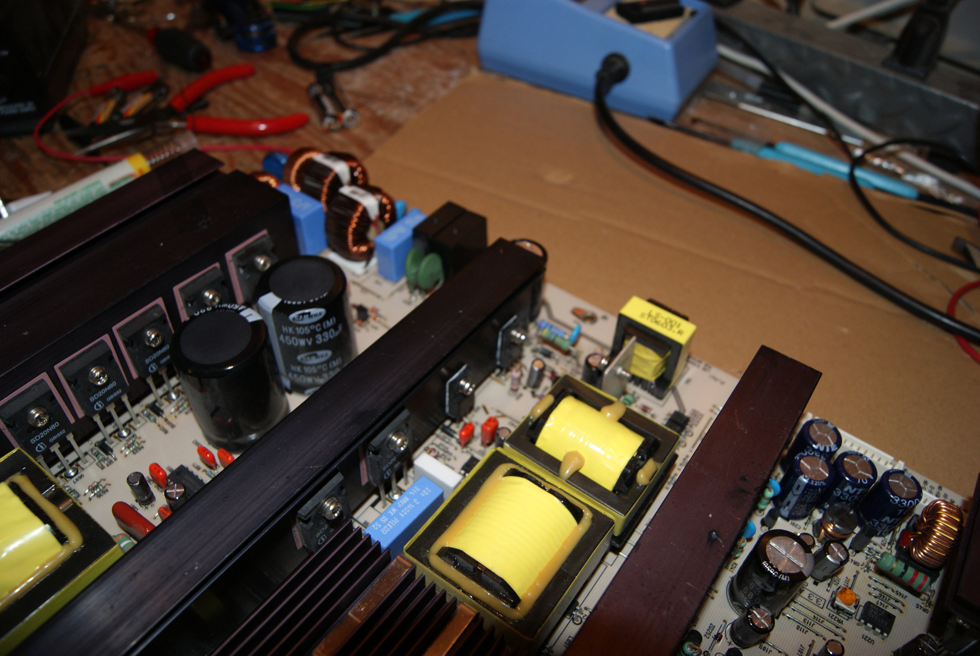

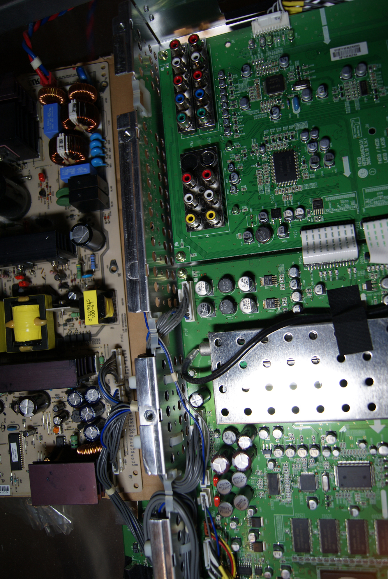

    I recently picked up a LG 50PC3D-UD to repair. When I power the TV on, I hear the relays click, the green led on the front blinks 3 times and then goes back to red. I tried searching around a bit and found that these units have issues with the 10v 3300uf caps on the power board. All the caps look fine to me, no obvious bulging or leaking, but I replaced them anyway. The TV still wont power on fully. I found some LEDs that look like they may be error codes, and I included a picture of them. I also noticed a green and red LED under the shield on the tuner. I also tested all the pins on the p801,802, and 803 connectors. All the voltages were fine, except for the 3.3v pins, there was never any power on those pins.
    Not sure if its a problem or not, but the two green thermistors next to the 2 black relays on the power board are closed at room temperature. This means that they are shorting the two load pins on one of the relays which seems like odd behavior to me, but it may serve a purpose I am not aware of.
    I found what appears to be a service manual, but I am not sure how to follow it to diagnose these problems.
    http://www.scribd.com/doc/7580885/LG...raining-Manual
    Has anyone here worked on these sets before? I'm new to the world of plasmas and I don't really know where to proceed from here.
    The pictures are too big to upload here, so I put them on google Picasa:
    http://picasaweb.google.com/joshuabu...eat=directlink
    Thanks in advance,

    Re: LG 50PC3D-UD power issue
    The 3300uF, 10V cap problem is for Philips plasmas and otehrs using a Samsung panel. LG electronics makes their own panels, so that bit of wisdom doesn't apply here.
    I'm drawing a blank on a service manual for this TV. Perhaps you can find a cross reference here.
    Either use software to reduce the size of the pictures or reduce the resolution of your camera. Remember, use 'Manage Attachments (below the text entry area), do not post pictures inline.
    Because of past problems, I refuse to load pictures stored offsite.
    On the back of the plasma panel there should be a white label that starts with PDP50. What is the full model number of that panel.

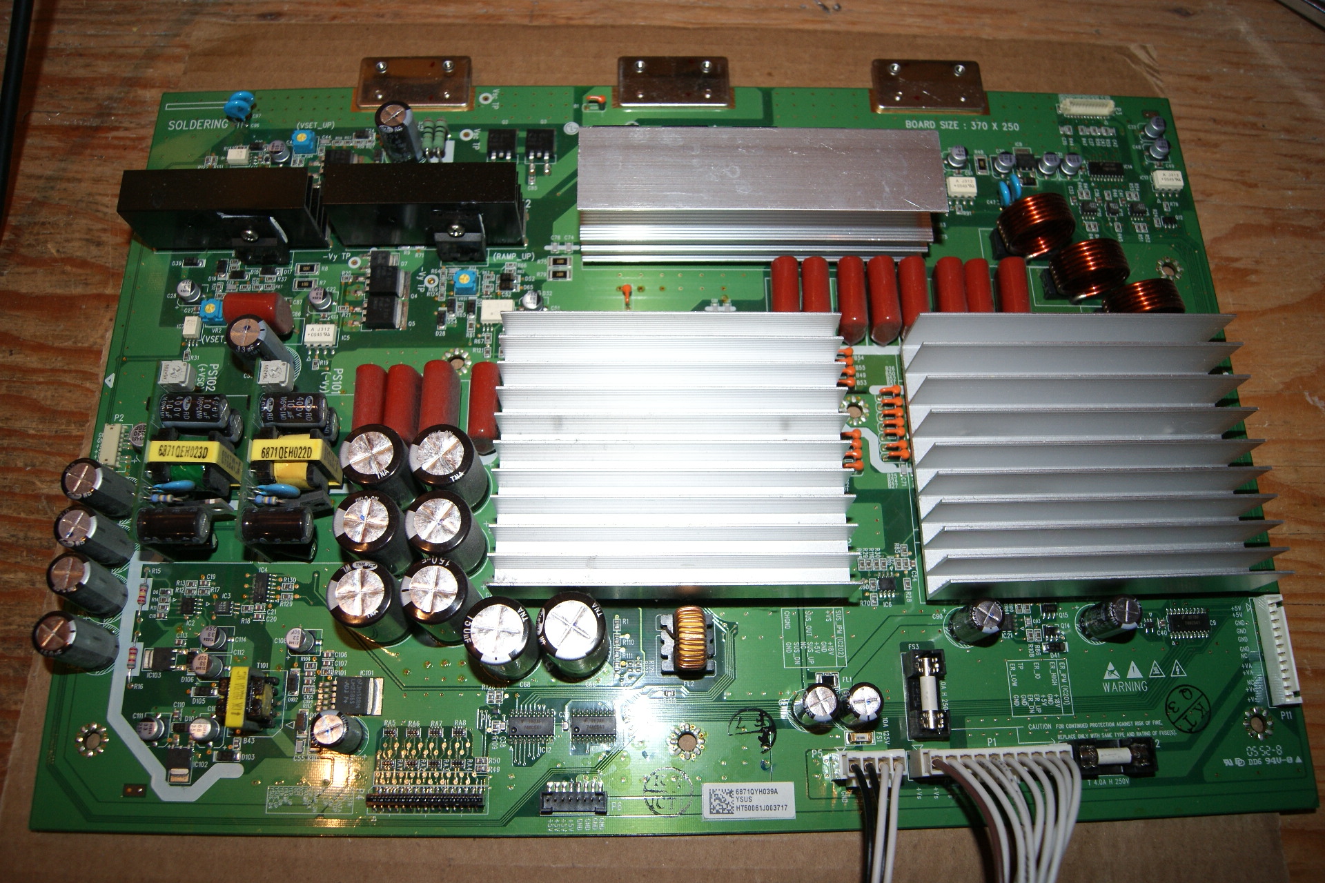

      It looks like these use ipms. You may have a bad y drive board and that would shut down the power supply. I am not sure about about this model but most of the one`s I have worked on you can unplug the y or z board and power up the tv and see if the power supply stays up and runs. Try and search old posts you might find the info you are looking for.

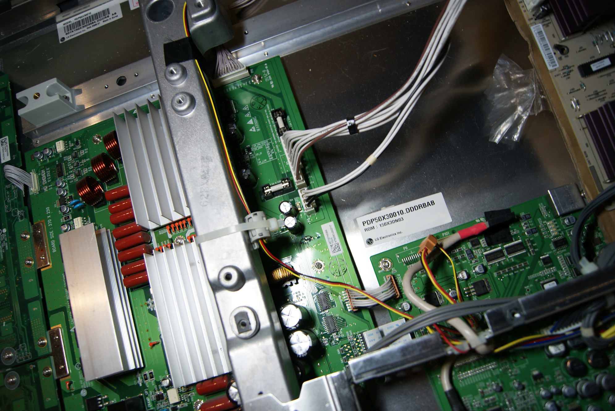

        Thanks for the replies. I understand the problem with off-site pictures, I figured Google would be fairly trustworthy. I'll try to find a way to shrink them down.

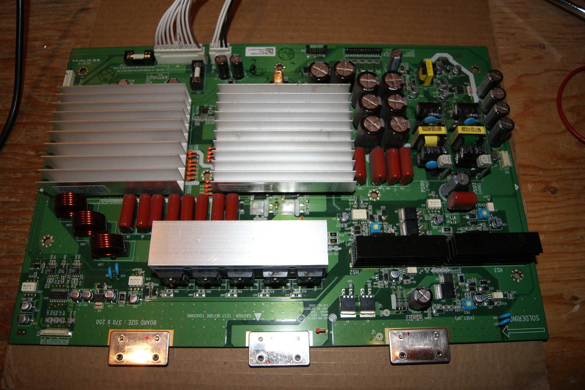

        I did hear about unplugging the y or z board, and I just tried it after posting this. I still had the same problem when unplugging all 3 cables, and when unplugging each one separately.
        The full model number is PDP50X30010.DDDRBAB
        I will edit this post and add in the attached pictures (if that is permitted on this forum) or I will post them in a few minutes.

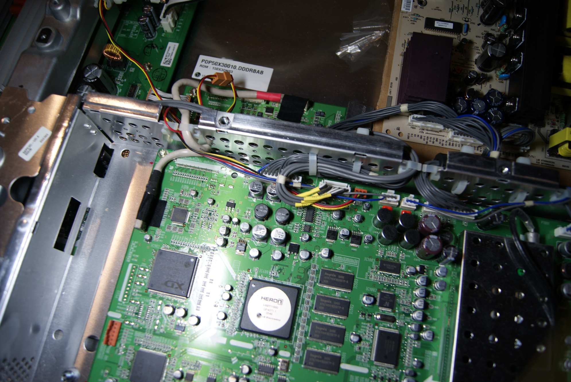

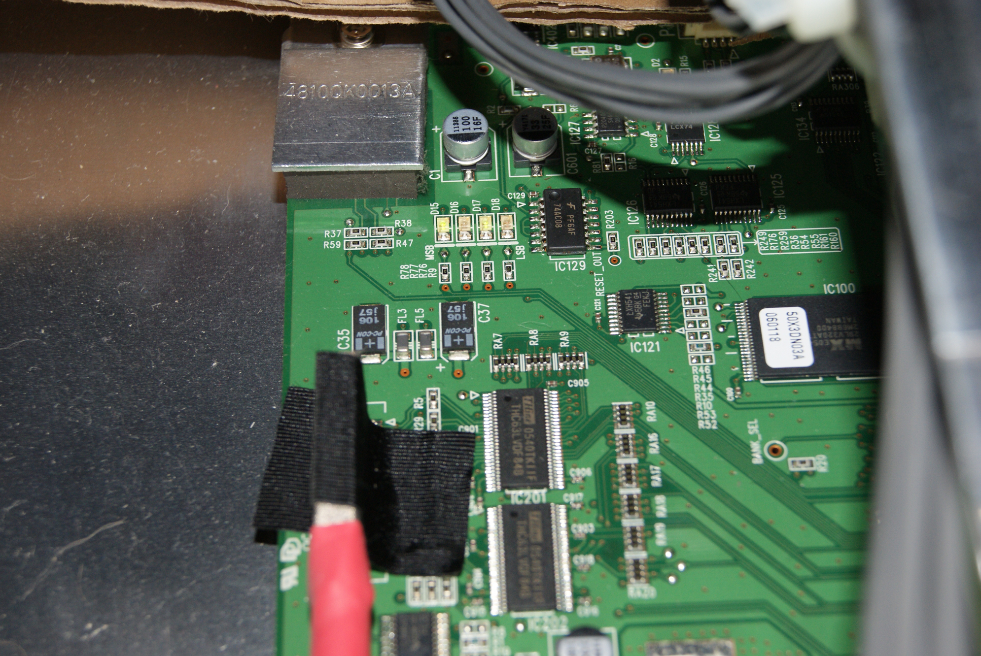

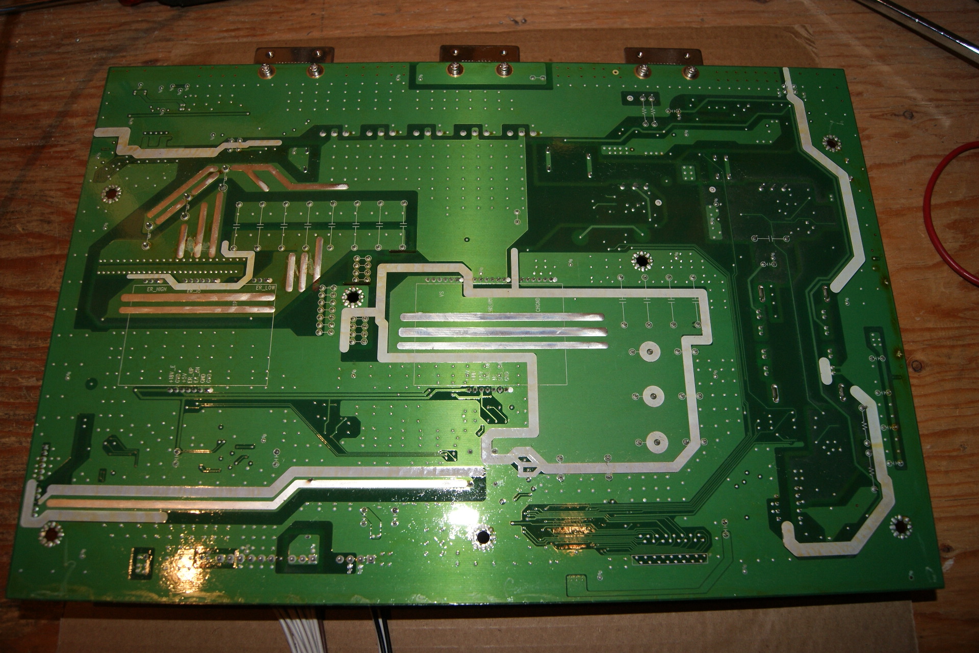

          Here's the pictures. I included some of the surrounding boards too. Where do I find the Chassis number on the panel? I get no service manuals for PDP50X30010.
            I envy you. The LG 50PC3D chassis uses the same panel as the LG 50PC1D chassis. I believe this file was obtained from Scribd; Elektrotanya's server is down this morning.
            What you want is 16077007-LG-50PC1DRTroubleshootingManual-2007-VG-Training.pdf
            This manual goes into exquisite detail on troubleshooting the entire chassis, including the panel, power supply, sustain and main control cards. It also contains information on the hard drive.

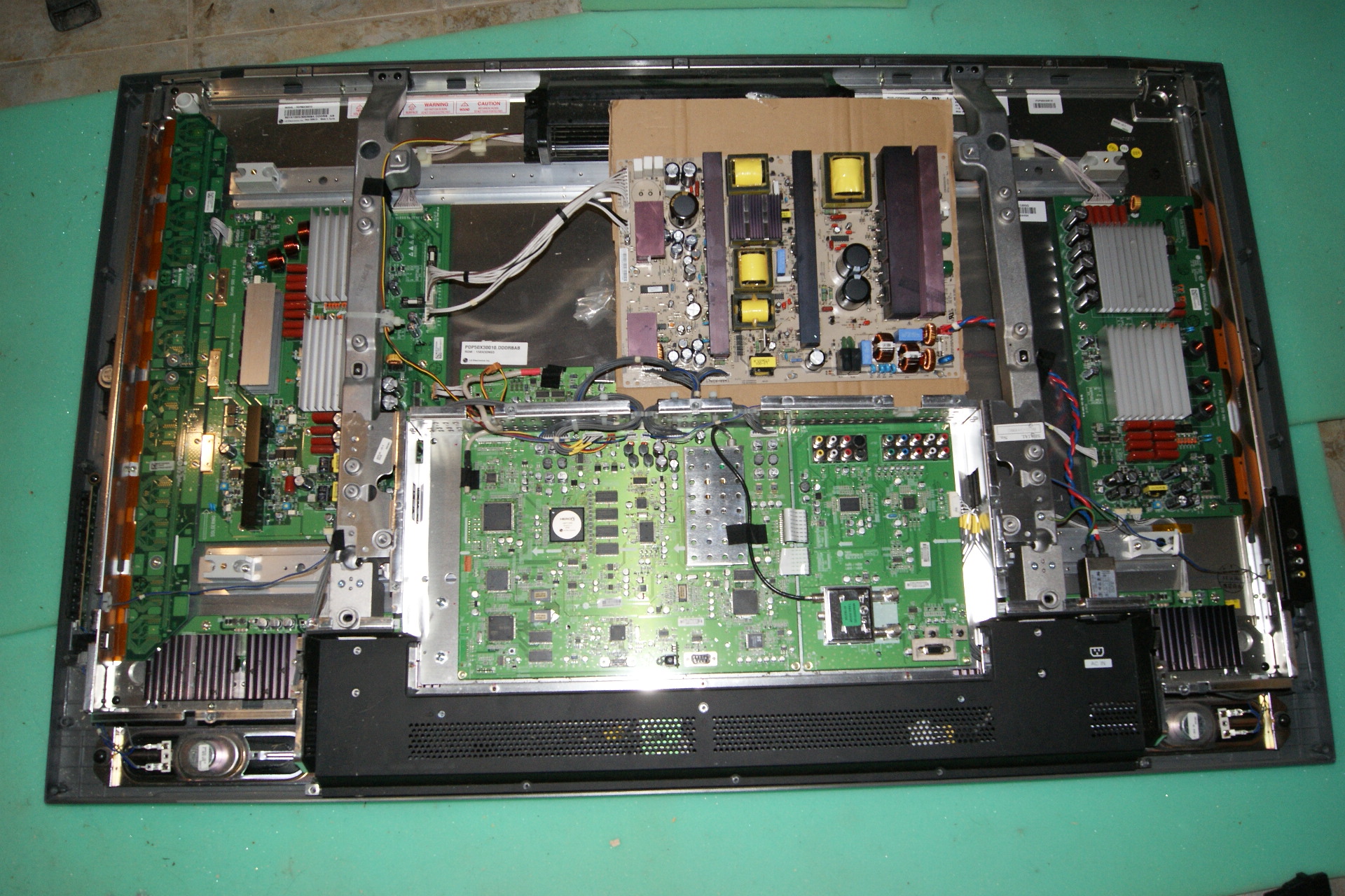

            Incidentally, I prefer to see an over-all shot of the back of the TV as one of the pictures. That puts the rest of them in perspective.

              That service manual looks like its going to be immensely useful, although my TV doesn't have a hard drive in it.
              Here's a shot of the back panel.

                        That goes back to cadiman's comments. On some LG plasma TVs you can troubleshooting by disconnecting Y and Z sustain boards. On others you will still get a failure when you disconnect the Y-Sustain board - it detects the disconnected cable as an error.
                        As I recall, the training manual has information on troubleshooting the IPMs.

                            Correct. The blown IPM overloads the power supply, which shuts down to protect itself.

                              I pulled the YSUS board and tested the IPMs as it was described in the manual, I think. I put my meter in diode test mode and tested all the pins in the order listed, there was a decent amount of resistance between all of them, no open or shorted circuits. I also checked over the caps and mosfets for any obvious signs, didn't find anything. I'm going to look around a bit more then move on to the ZSUS board.

                                        I took another look at the power board and found a component that may be the problem. It looks like a large voltage regulator or mosfet, it's labeled Q855 on the schematic (it connects directly to the transformer that generates the VS voltage). It shows less than 15ohms resistance between each pin, in both directions, which is different from the other similarly labeled components. Theres also a box capacitor next to it that is caved in on the sides.
                                        The part is labeled "SD20N60" and "GAV602" on the front. I'm going to head over to my local parts supplier tomorrow and see if he can find a replacement. The store sells mostly NTE parts, for future reference, are NTE caps generally of good quality?
