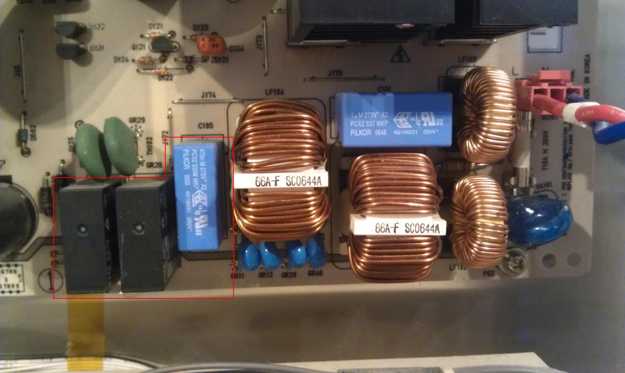

                Following this with interest because I have the exact same tv and problem. Replaced the 9 bulging 10v3300uFs on PS, but no luck. On control board D15 on the Temperature Diode stays green, D17 lights immediately after and buzzes, then shut down. Any quick help? And to OP, did you fix the thing? Thank you.
                • nswizdum
                  • Jan 2011
                  • 18
                  Re: LG 50PC3D-UD power issue
                  I did eventually get it fixed (with help from Coppell TV Repair). It was one of the MOSFETs causing my problem. I broke my rule of "no soldering after midnight". A bead of solder dripped off the MOSFET pin and shorted a connection that was hidden under the heatsink. That was what caused the sparks and blew a bunch of the MOSFETs again. Still happily using that TV now.

                    I have a similar problem with the 3 flashes of green. I replaces the caps but still nothing. I however don't have the control board LEDs lighting up at all. What would keep them from working/ getting power?

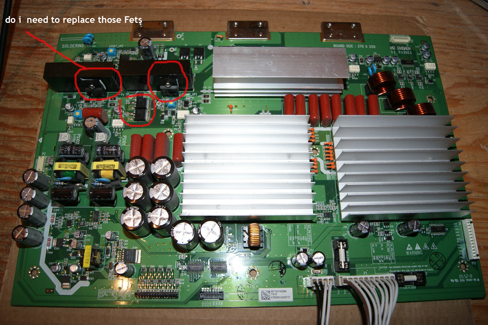

                              Can you please indicate how you test/diagnose this bad fet (on/off board?)and which one need to be changed on YSUS # 6871QYH039A, as i changed ipm and it GOT burned again and i suspect of Fet K2673 which got very hot. i want change new IPM202 on Y AND Z SUS need to know if other component such as fets need to be changed. i couldn't find online replacement Fet K2673 on YSUS # 6871QYH039A, is there any advice please.
                              see attached Y SUS include suspected Fet pic
                              • cheebster
                                • May 2008
                                • 376
                                #35
                                Anyone can correct me if im wrong, but this one :
                                http://www.digikey.com/product-searc...9497-5899-5-ND
                                Seems a good replacement. STW9NK70Z is the part number. I've seen those fets shorted on my bad ysus here and you really need to check everything around it since it usually brings a few smd resistors with it, as well as some diodes marked es1g nearby. Multimeter is a must on this one
