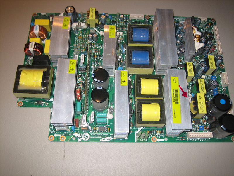

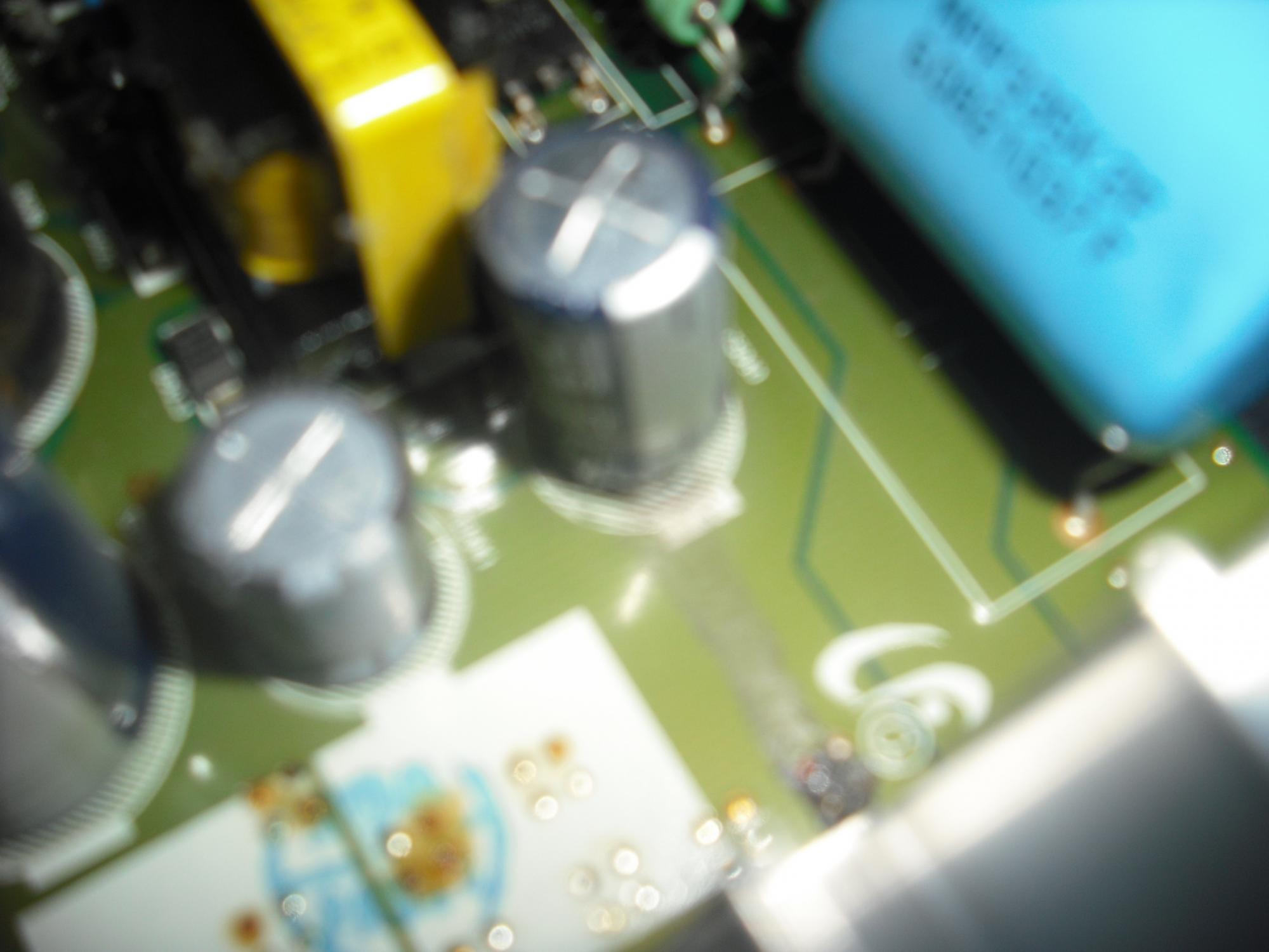

    When my Plasma TV (Magnavox 42mf231d/17) wasn't getting any power....just clicking relays. I figured replacing the bulging capacitor (1500uf 10v) on the power supply board would fix it. After replacing it, still nothing....until I came across another cap on the Y-Sustain Board. This one I noticed is bulging also but it seems to be leaking from the bottom and running down the PCB as you can see in the blurry picture, I circled the cap in question in yellow. Can someone please tell me how to take this board out? I removed the screws and cables but something is still holding it down tight. Could it be the large heatsinks? Are they attatched from the bottom side? If so how do I get those off without having to take everything apart just to get to them? Plus would a bad cap on the Y-Sustain board cause no power at all?

      Good pictures, thanks.
      Probable diagnosis: One of the chips on the Y-buffers has shorted, taking out a driver transistor on the Y-Sustain. This overloads the power supply. A simple test is to unplug the power cable to the Y-Sustain and see if the TV powers up. You won't get any picture, but you should get sound.
      The expensive fix is to replace both Y buffers and the Y sustain. Figure $80 each for the buffers and the sustain.
      The cheap fix is to replace all 12 buffer chips, the shorted transistor, and the leaky cap. The buffer ICs run about $10 each, the transistor is about $7, and the cap about $1.00.

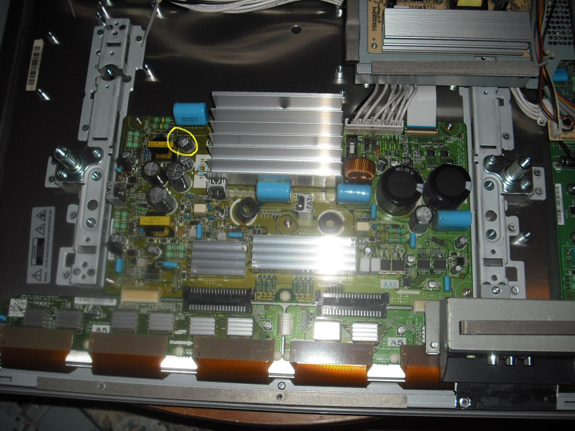

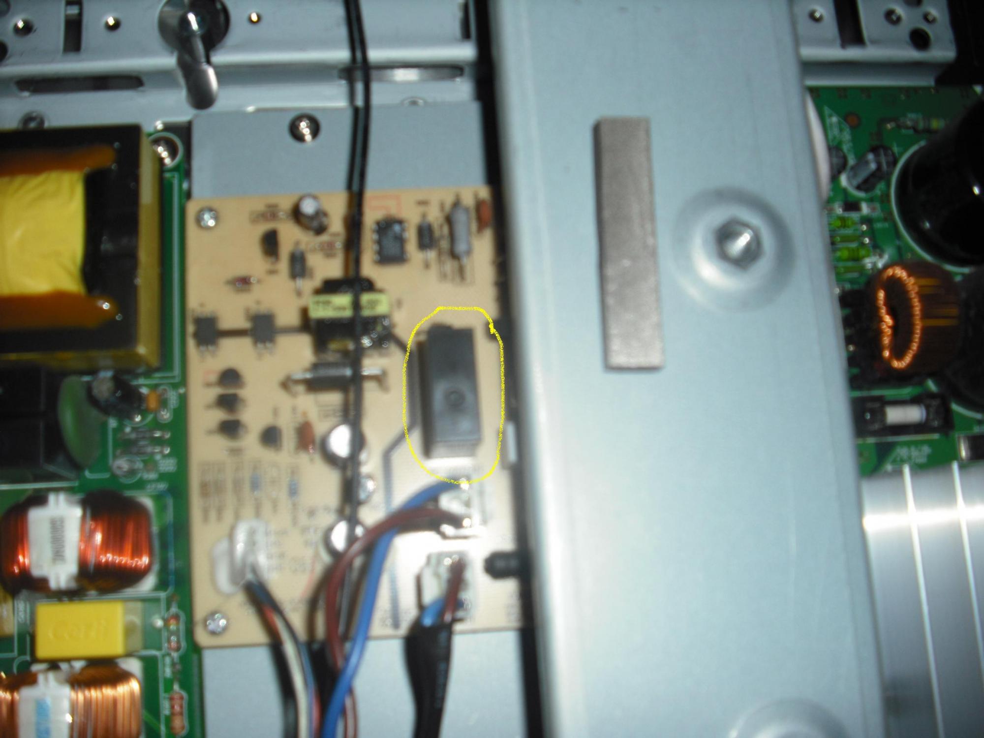

        OK PlainBill I tried disconnecting the power cable from the Y-Sustain and same thing. Won't power on....just clicking from what sounds like the relay on the OFPB (Pictured) also still no lights at all from the power button. I guess I need to invest in a good Multimeter.....preferably one that reads high microfarad caps, like 0.5 - 2000uf or higher.

          Well, it's possibly not a capacitor problem. Here's the usual start-up sequence..
          1. The TV is plugged in, the power supply is providing 5V standby. The standby processor is waiting for someone to hit the power button, either on the remote or the top of the TV.
          2. The power button is pressed. The standby processor does a few simple tests and turns on the main power supply. It then begins monitoring the voltages out of the power supply, as well as voltages generated on the main board. If any of them are out of spec, it shuts down the main supply.
          3. When the supply voltages are all stable the standby processor starts the main processor, which performs a self test, then initializes the display. If IT finds a problem it may command the standby processor to shut down the power, or it may continue operating.
          In any case, the next step would be to check if any of the power supply voltages are missing when the power supply turns on.

                    Please help. Can anybody tell me parameters of C281 capacitor which is on main power supply board and under heat sink with s/n steaker? Mine is burnt-out.

                              Here is a picture. The C281 cap is right under the red arrow next to the big white resistor and another C280 blue high voltage cap.

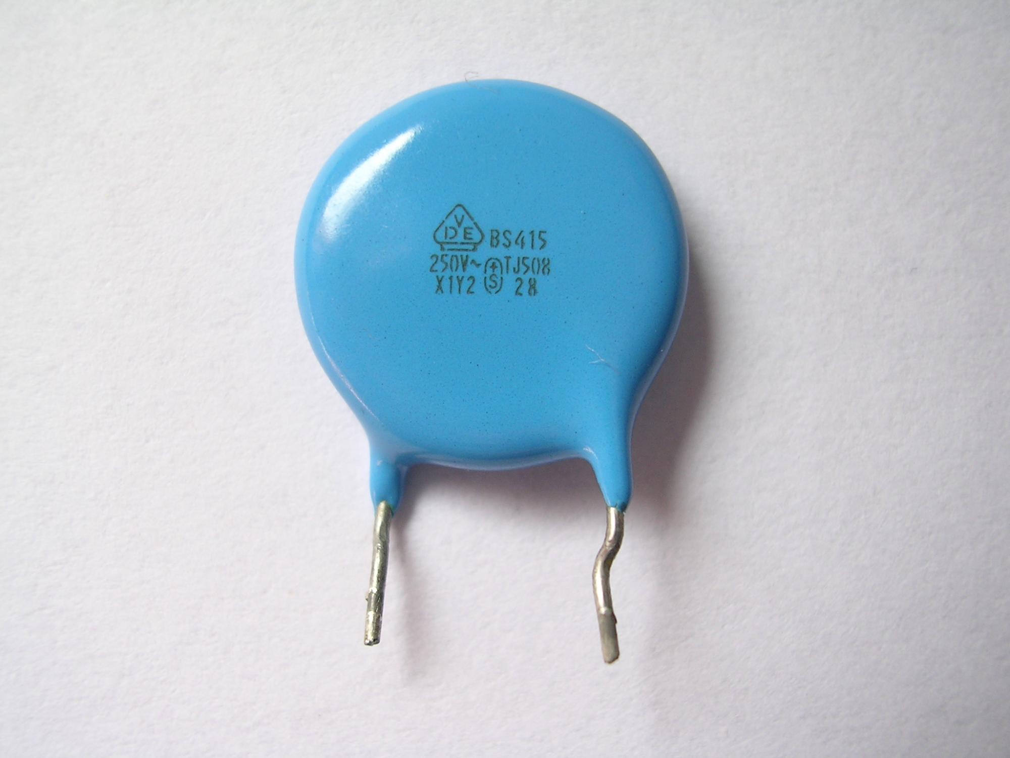

                                If you are refering to the blue ceramic cap, I believe that is a 0.22uf 25v.

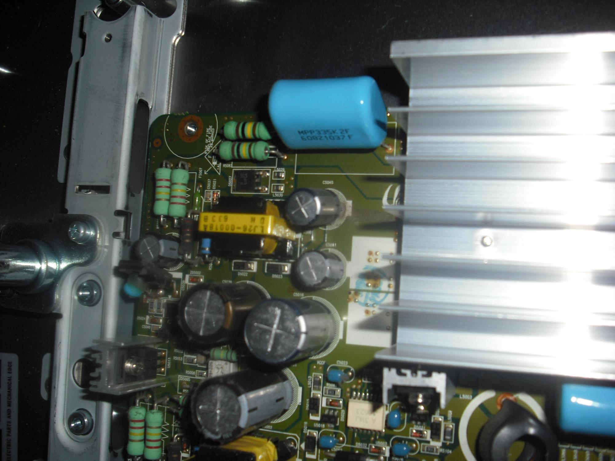

                                  The cap is not showing on the picture since it's under the aluminum heat sink, almost touching a heat sink black IC. Mine was completely burnt out so I don’t know color or even form. If this is a cap which is the closest to the heat sink and right next to C280 2200pF 1 kV one, this is the one I am looking for! Thank you very much!!! I will let you know what I will find since I have a problem with Y-sustain too.

                                    The cap is not showing on the picture since it's under the aluminum heat sink, almost touching a heat sink black IC. Mine was completely burnt out so I don't know color or even form. If this is a cap which is the closest to the heat sink and right next to C280 2200pF 1 kV one, this is the one I am looking for! Thank you very much!!! I will let you know what I will find since I have a problem with Y-sustain too.
                                    Yes that is the one i'm talking about.....it looks similar to the one pictured.

                                      Is it marked as 224 25V, 224 250V or 222 250V?

                                        Is it 25V or 250V?
