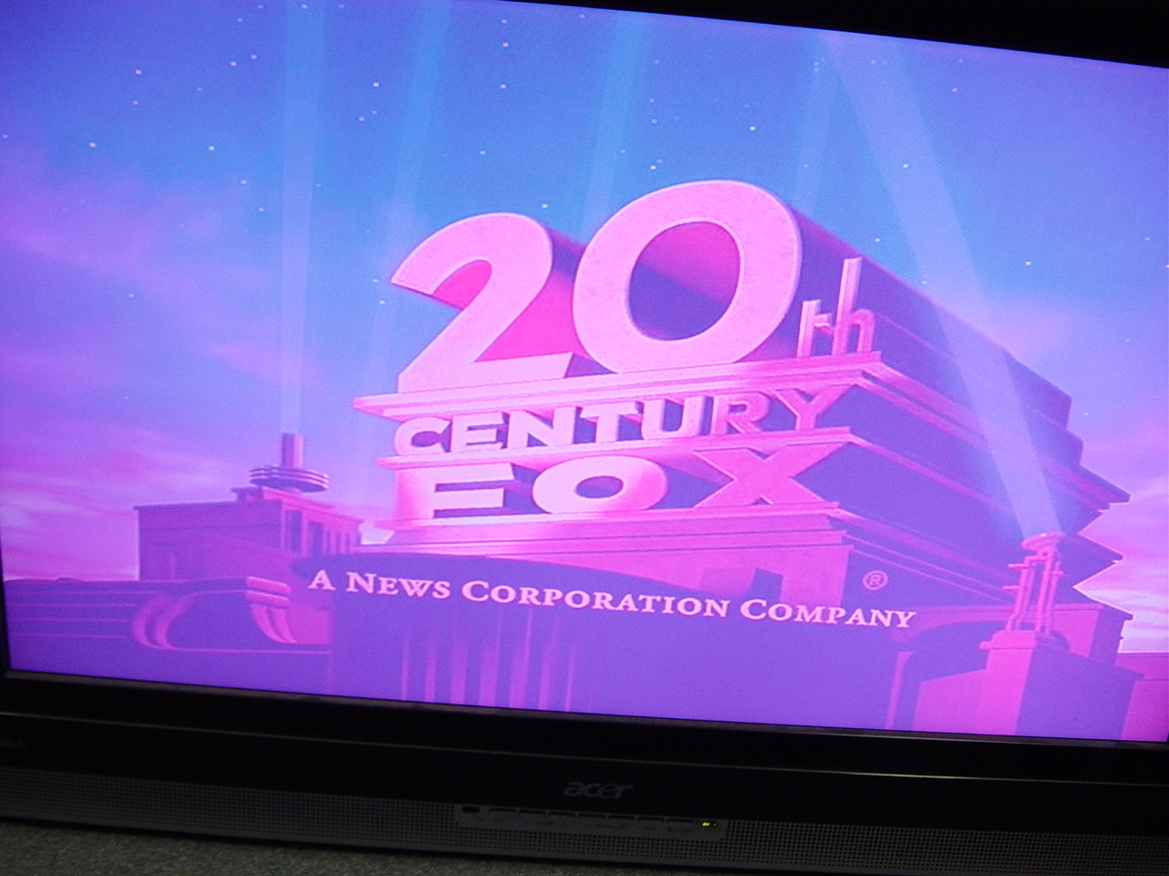

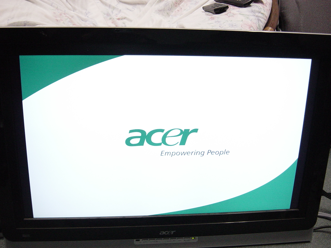

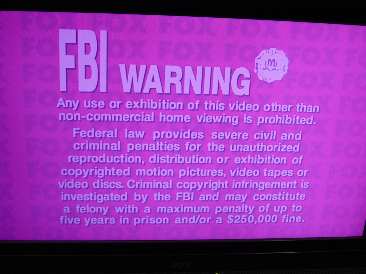

    Start up screen good.

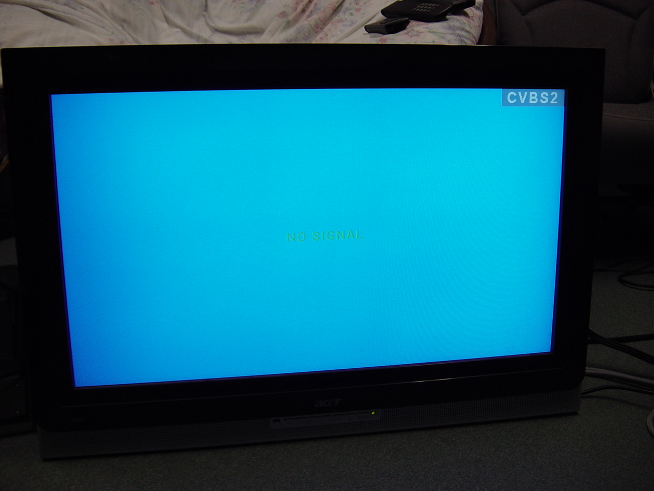

    Blue screen with no signal screen good.
    Input any video source look like a weak picture tube's image on a LCD tv.
    Power supply's cap look ok.
    What else could cause problem like this?

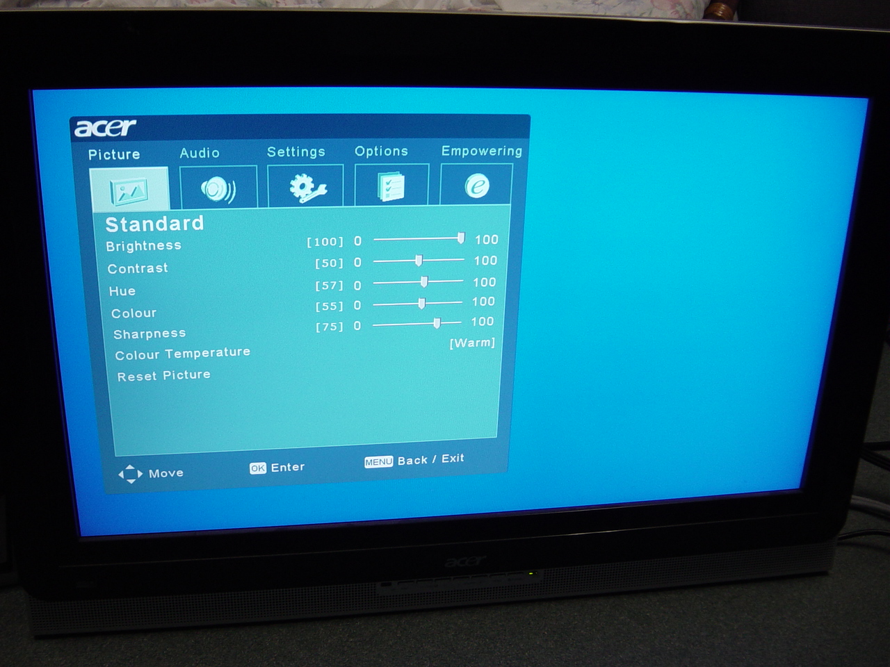

    One question, have you adjusted it from "warm" to cool? any difference? is this on all sources or just one?

        All sources, and check with different video settings, no good.

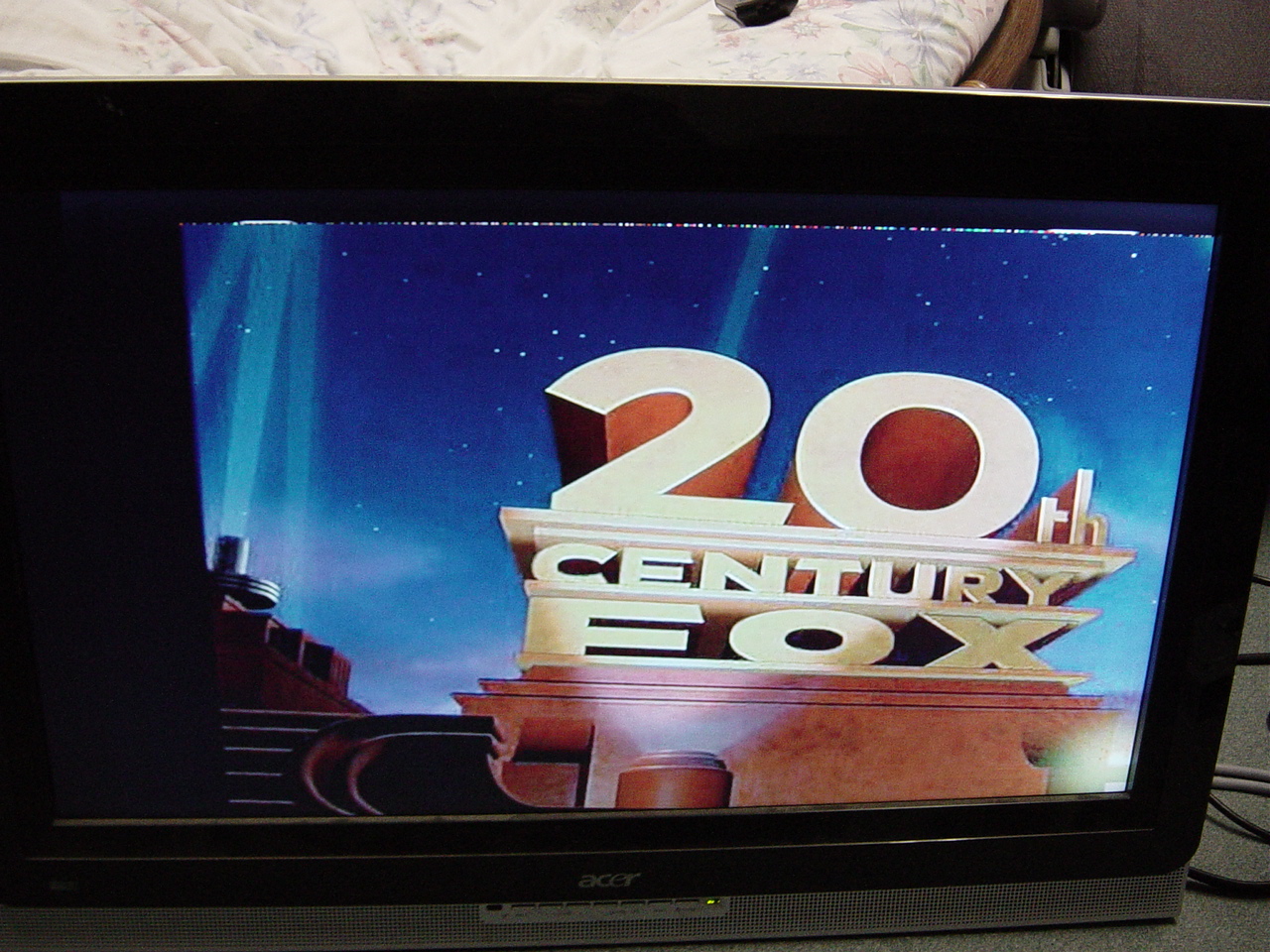

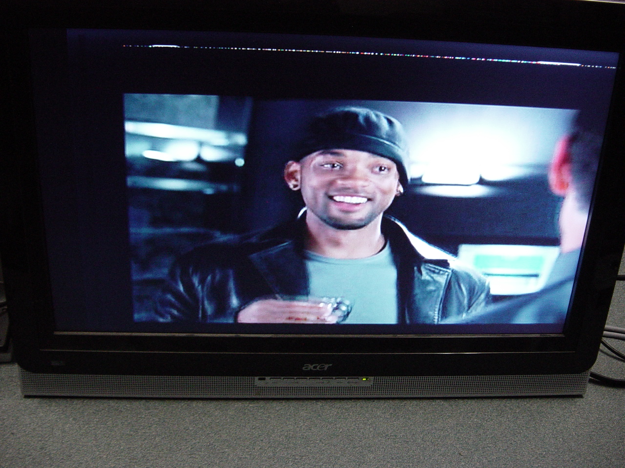

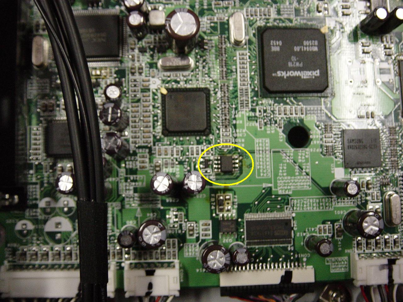

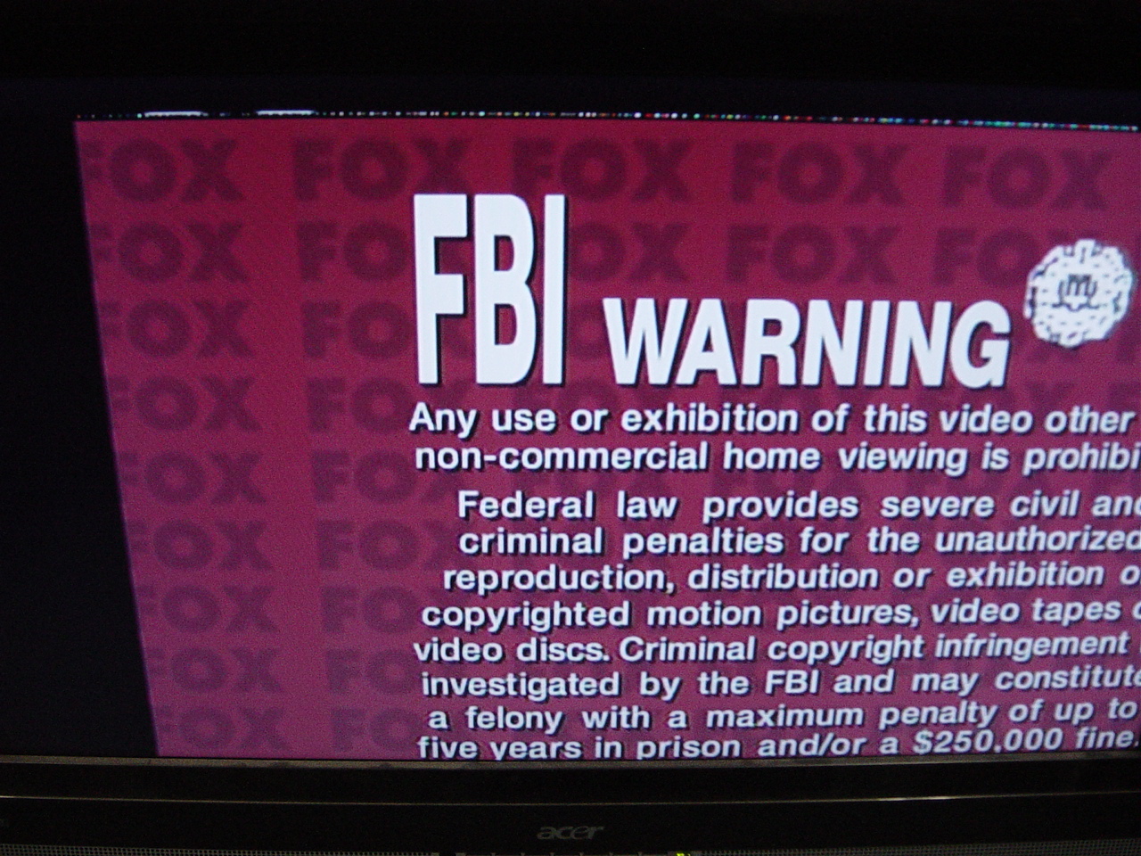

            I got a second main board, (with a different type lcd panel) put it up and the color comes back. But the image is off center.
            Swap eprom U33 24LC32A between the 2 board would got the image like the first post and the image like this post.
            Not bad capacitor in this case.
            Anyone here can send me an image of this eprom or can help to re-program this eprom?

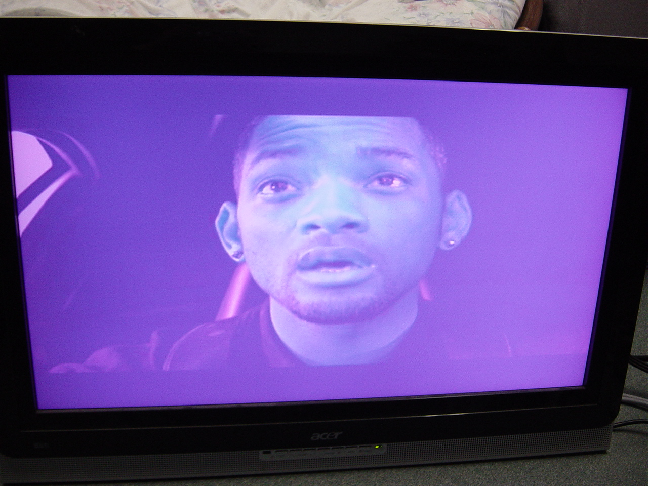

              I have this TV which CAN display a perfect picture, but it's brain is shot and can't remember the settings:
              The problem is the U33 eeprom (24LC32A) which apparently writes once per second and is guaranteed for 1 million writes - that's only 277 hours of 'on time' which is a HUGE DESIGN FLAW in the firmware. Supposedly there is an updated 'fixed' f/w, but I can't find it...
              The factory menus can be accessed by pressing the [VOL -] and [CH +] buttons simultaneously, and the colour gains and biases (see below) can be altered. But the TV does not remember them because the eeprom is toast.
              I may just replace the eeprom, it's surface mount so a very difficult and precise task. I don't know if it needs to be programmed? In hacking around with the factory menus I noticed a 'ghosted' menu that had an 'update' selection. This ghost menu was displayed as a random bug and didn't function properly - and I'm not even sure how it came to be displayed. I was just pressing buttons randomly trying to see what was up. The s/w and f/w in this TV is crudely written crap.
