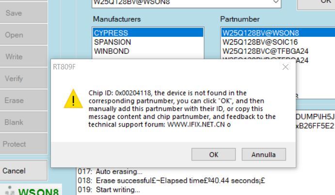

Acer A315-24p-r2km Acer N23C3 snid: 32400005934 s/n NXKDEET00B3240003B3400 Main: IH5JM LA-M611P Rev: 1A
As per the title, the screen remains black. When the power button is pressed, the blue LED lights up, but the screen is black.
With an external monitor and HDMI output, there is no image. I loaded the following bins, same situation: ACER_A315_24P_IH5JM_LA_M611P_REV_1A_2022_08_22_WORKING_BIOS_100% IH5JM120.bin from this address https://www.badcaps.net/forum/troubl...a-m611p-rev-1a With the RT 809F programmer, I can't read the contents of the original XMC 25QU128CH1Q SPI, I get the following error:
