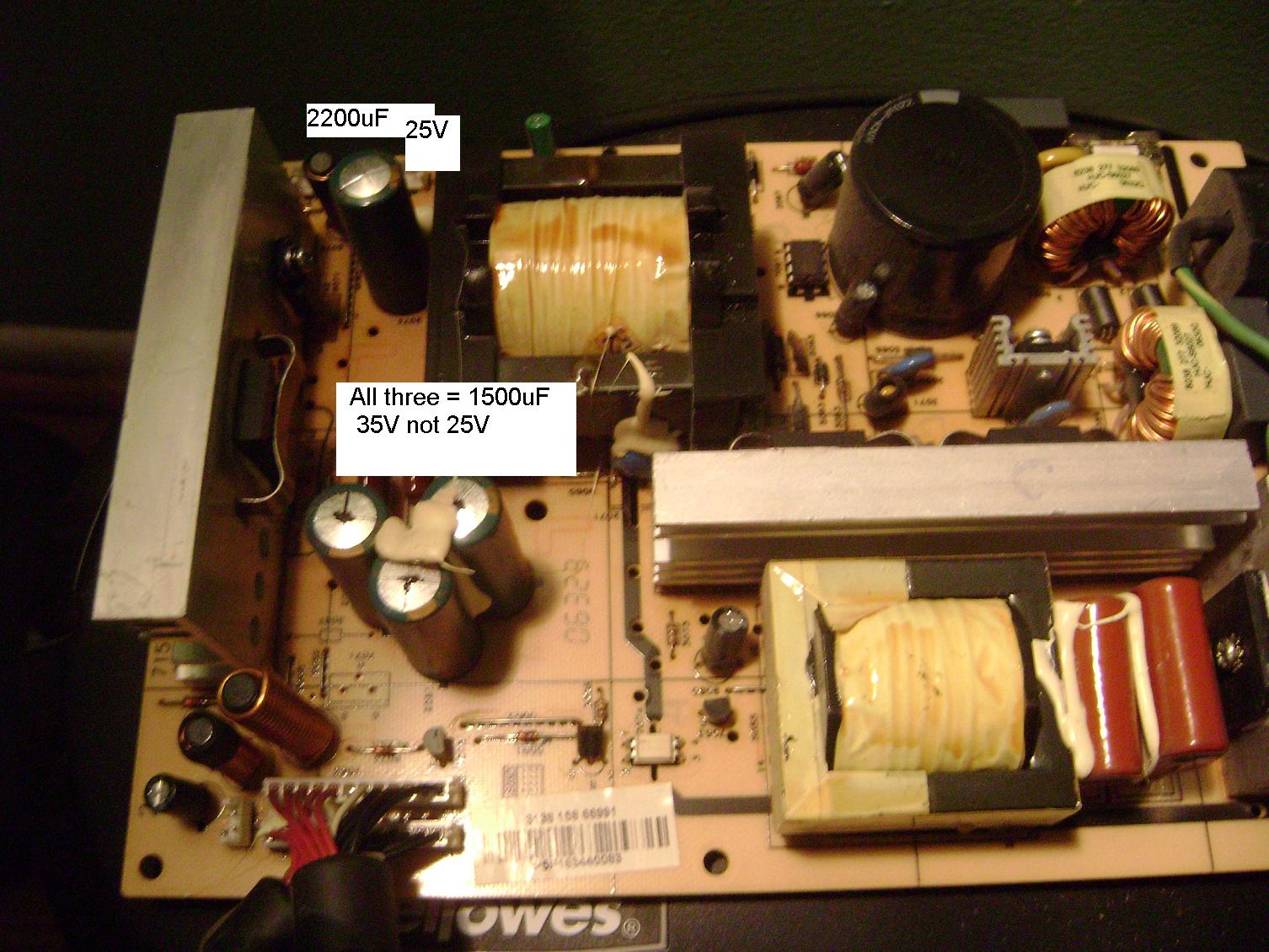

Re: Magnavox 42" LCD no Power

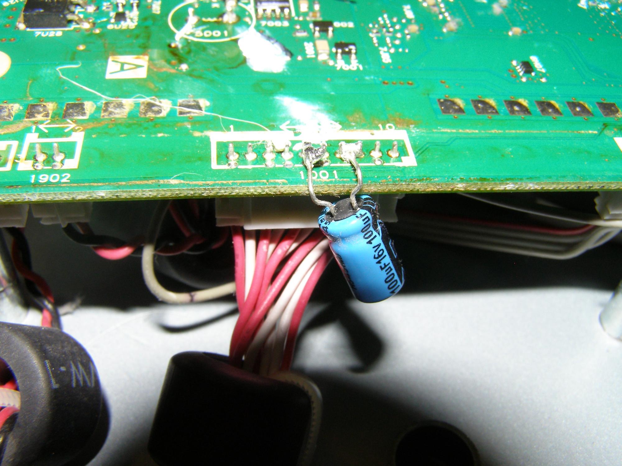

Since I now have the same board with the original caps in it, I'd recheck the values on the 4 blown caps that you replaced as I have found only one of them to be a 1500uF 25V cap. On the picture below I will notate which of these are which values.
