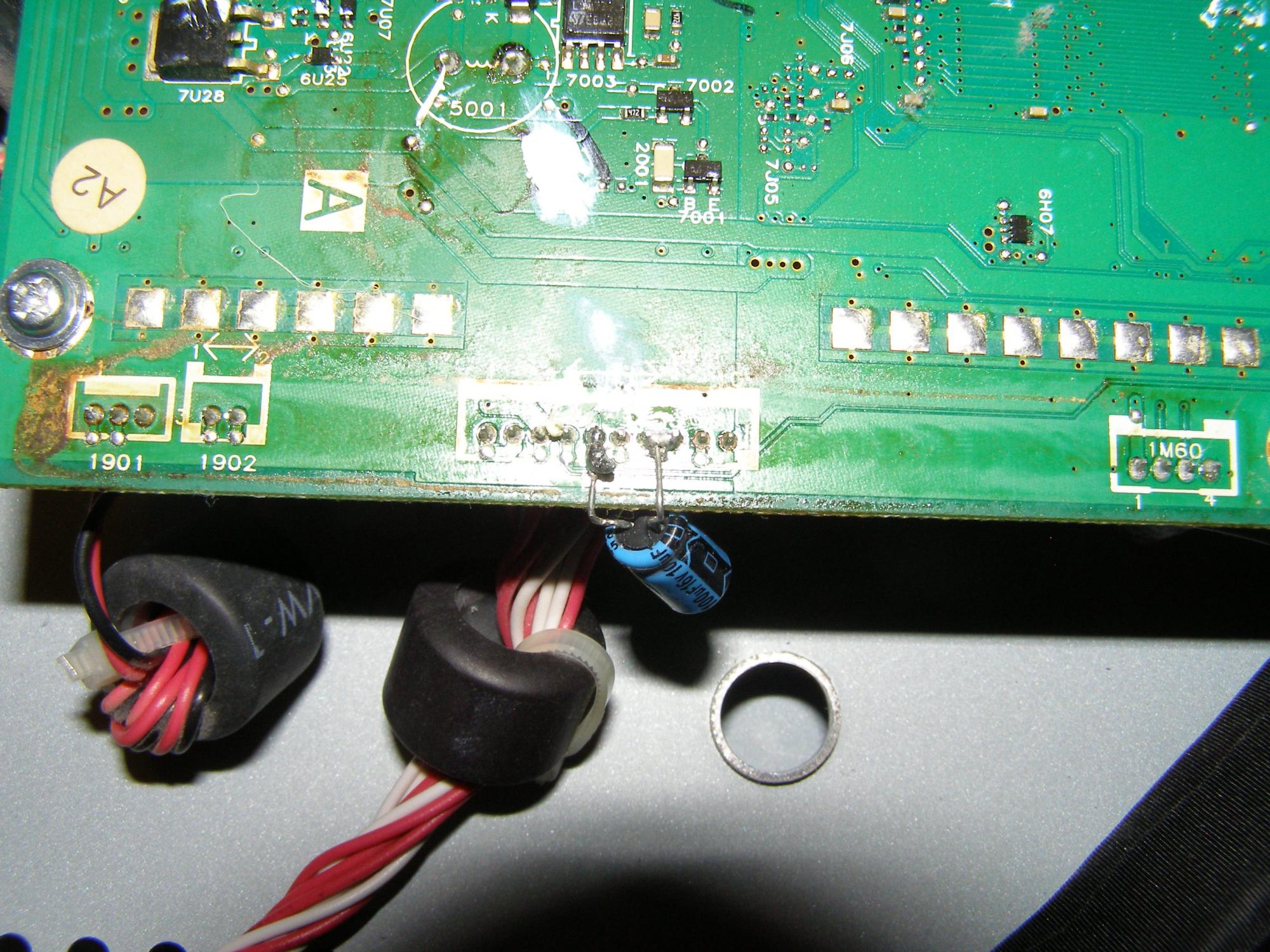

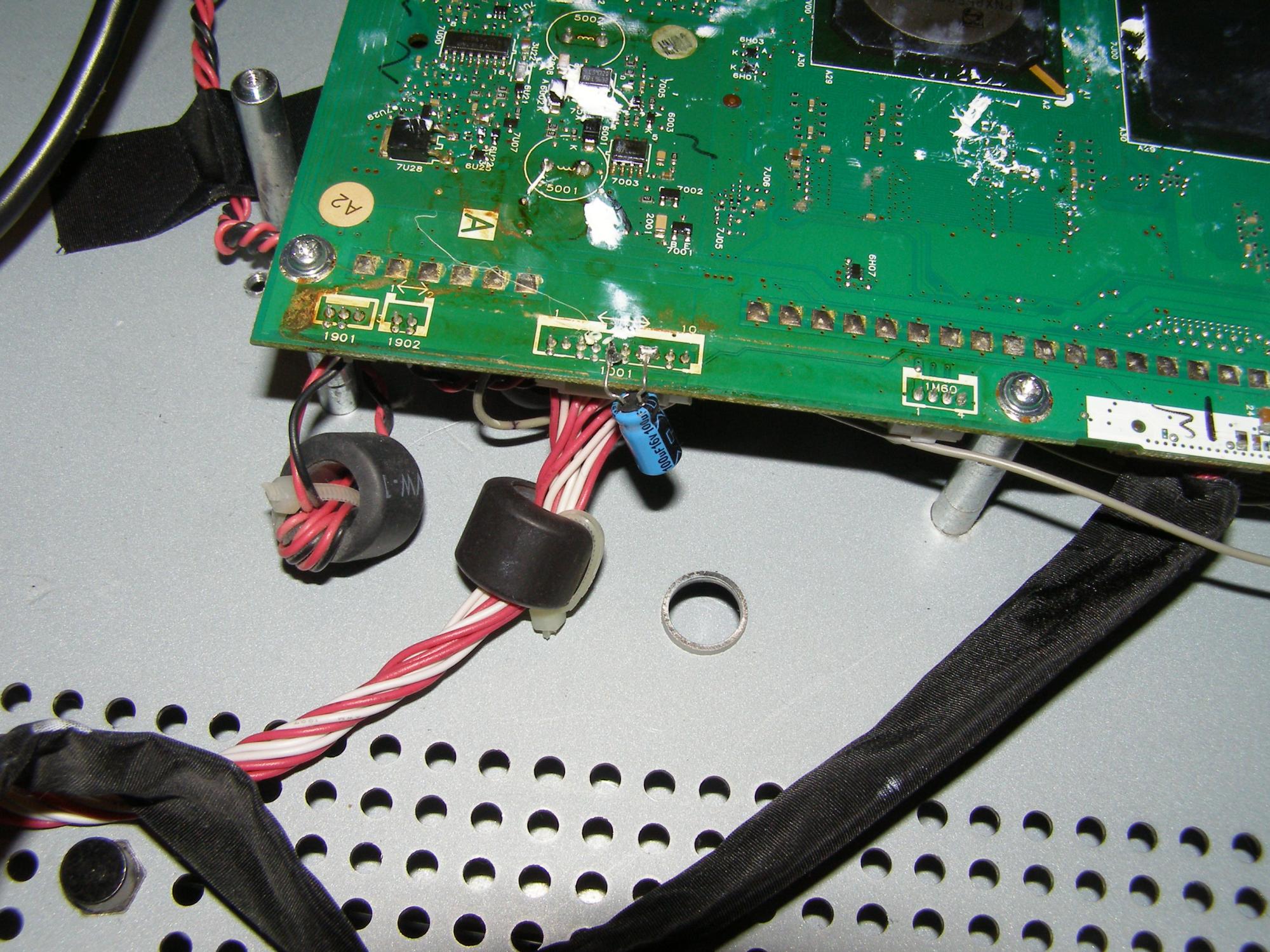

                            I'll get the inverter pictures hopeful later today but first when I removed the glue this cap was disconnected. I tried to reconnect it where I thought it goes but I'm not sure I put it to the right pin. These are the pics of the cap and the schematic for the position. It was still connected to pins 7and 8 I reconnected it to pin 5 but it could have been pin 6. I can't tellClick image for larger version

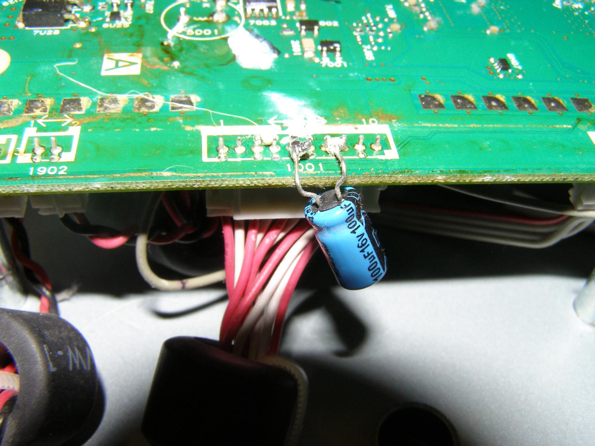

                                More pics of the cap on the scaler board.
                                Again this cap was loose and I put it back but it could be the wrong pin not sure. 7 and 8 are correct but not sure about 5 or should it have been 6.
