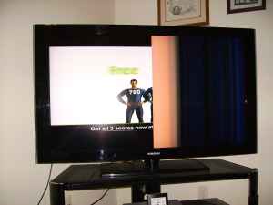

    I had 52 inch Samsung LCD tv Model LN52A530
    One day Picture shows only on half screen sometimes shows on the whole screen

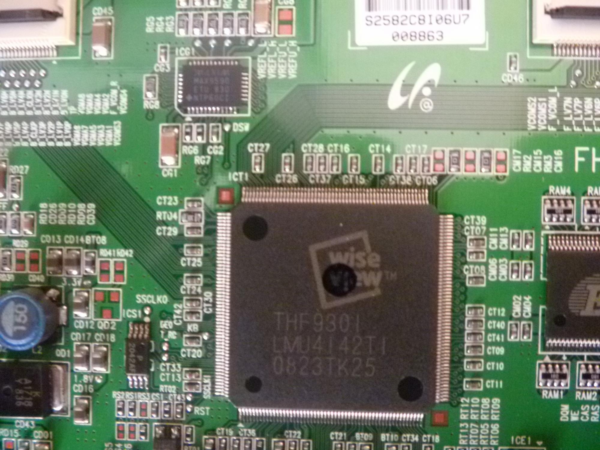

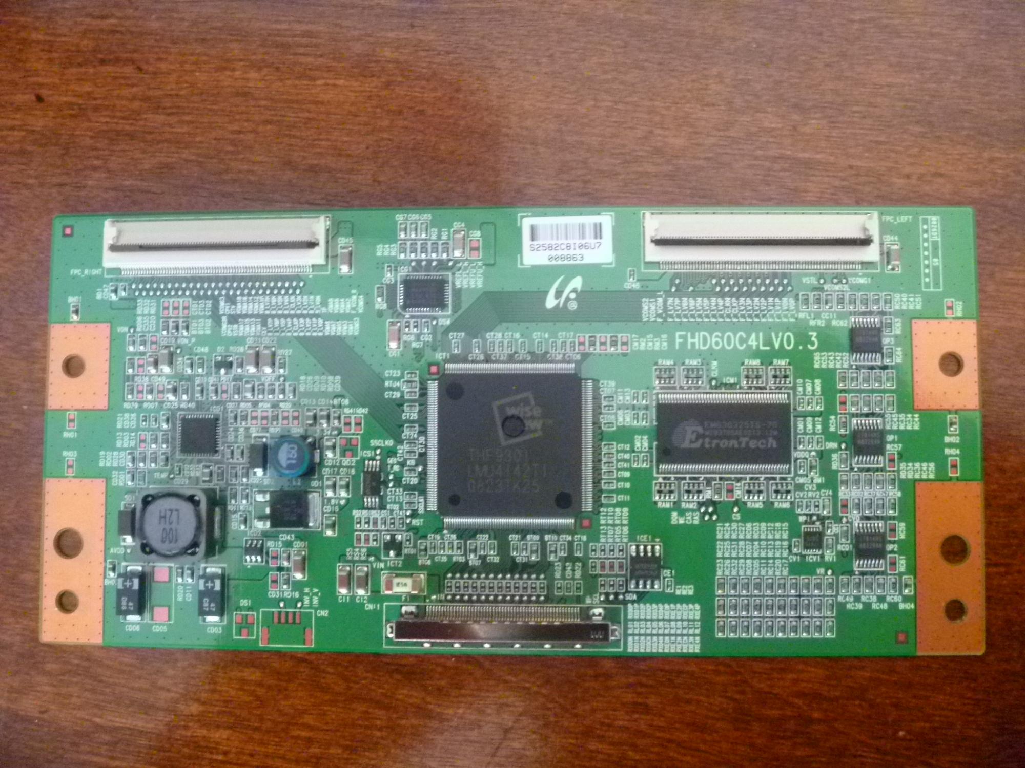

    maybe FHD60C4LV0.3, SAMSUNG T-CON go bad?
    any one know what wrong my TV

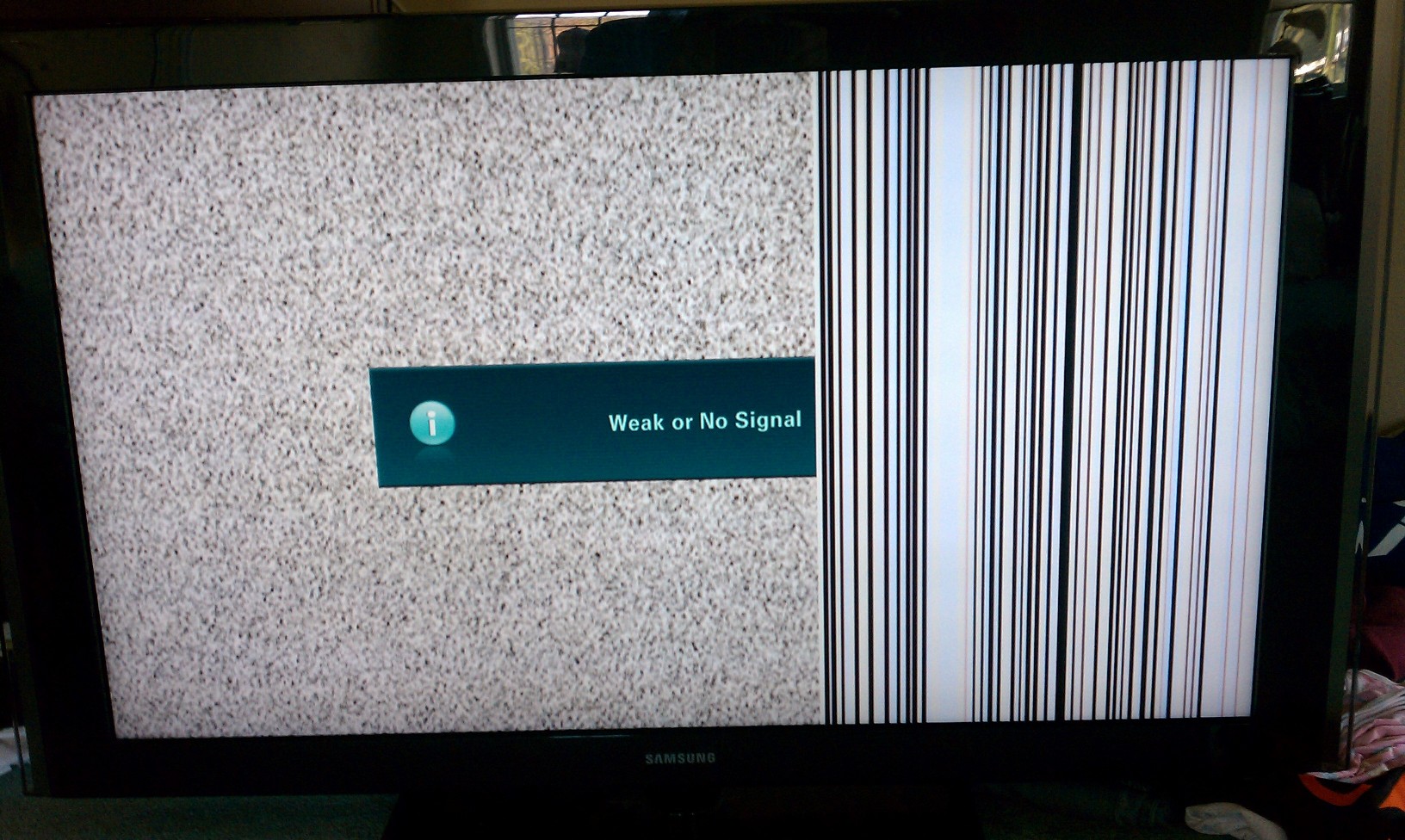

          Has anyone fixed this problem yet by replacing the T-con board? I will be helping someone fix a LN52A580 with similar issues. See pic below.
          I have to travel to get to this person so I want a clear understanding of the direct cause before I get there. Although I hate to be a board swapper, in this case, it works best for me.

            Re: Samsung LN52A530
            Oh and yes, it does do this same thing with a signal applied.

              Hoadle, Replace T-CON.
              Dgtech, iffy, try a T-CON, reason is Hoadle's is more clear-cut is it is split exact down the middle.

                  For me, the person never got back to me to fix the TV before I moved from Baltimore. I have fixed others with the same symptoms by changing TConn.

                    oh, well I had the exact some problem as the guy with the first post. the same side of the screen and everything. I replaced the tcon card and it was still having the same issue.
