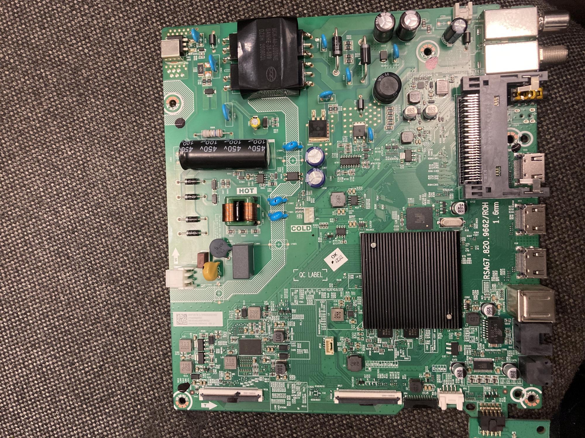

    Hi again all.
    Have got this set and trying to trouble shoot the above issue. I'm not sure if it's giving 2 or 3 standby blinks as one of them appears to be a very quick double blink.

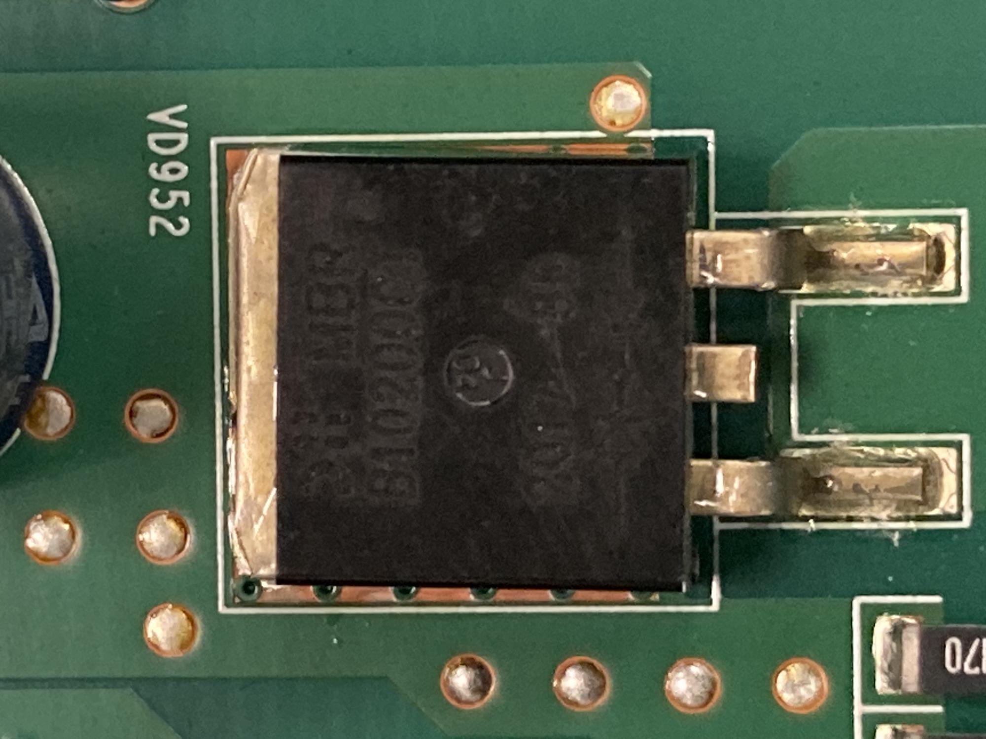

    The screen remains dead at all time. My fault finding so far has led me to what I believe is the barrier diode marked MBR B102 00CT. Which has two opposing diodes marked on it. And my meter is reading a dead short both ways when connected onto the board.

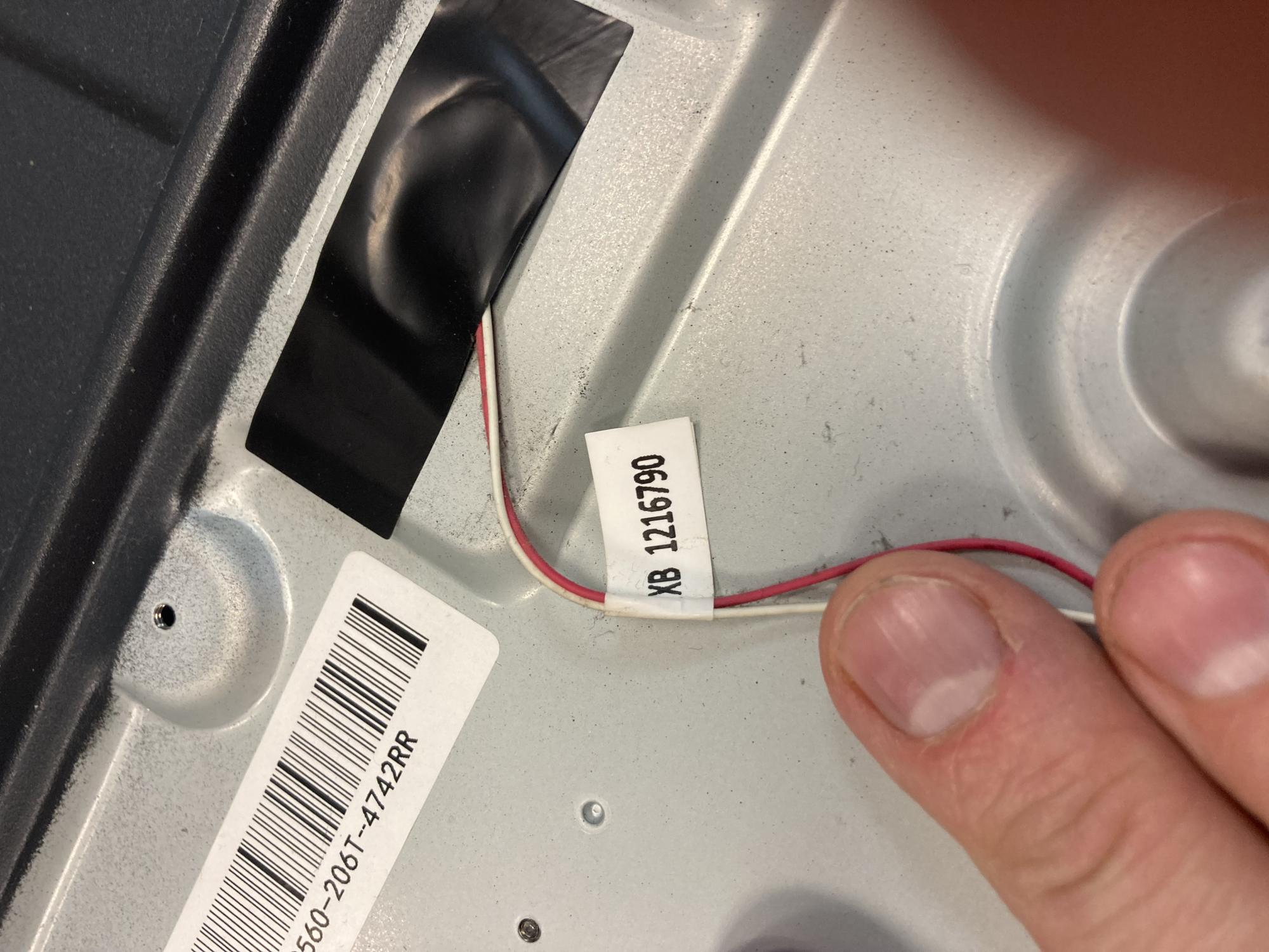

    The reason I'm thinking this could be at fault is that everything up to there on the hot side tests and measures ok. I'm also getting a fluctuating voltage of between 140-170vDC on the connector pins marked LP & LN which supply's a connector marked XB 1216790 which goes up round the back of the telly and could be for the backlight??
    Pictures below.

    Ok when the barrier diode is lifted from the board I get a diode junction on both diodes when my black lead is on the common cathode and red onto both anodes. So I’m comfortable that’s ok.

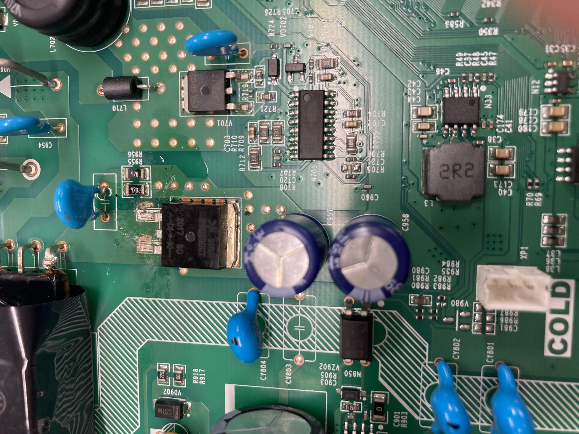

      I also have 15v Dc stable across caps c957 and c958

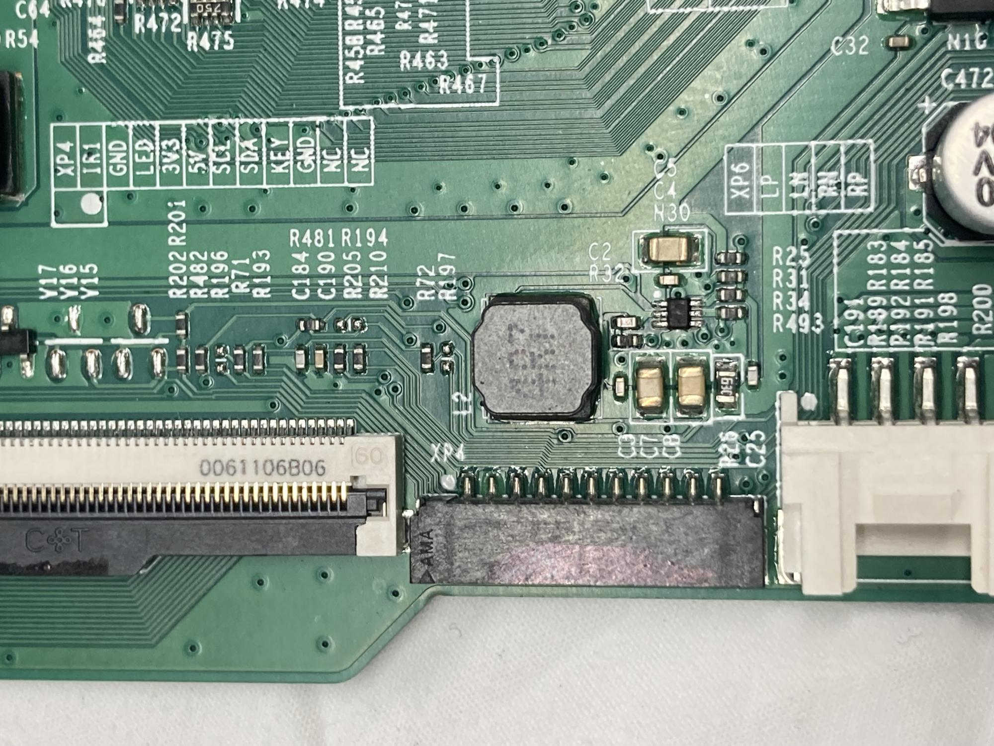

          Ok so I've found terminal rail XP4. Is this where my standby 3v and 5v should be??

              The reason I believe the issue is on the MB is that when the cable to panel backlight is disconnected I get the voltage fluctuation.
              I have found one Cap which is 1uf 400v reading around 920 nano farad but is discharging when read with multimeter in capacitance test mode. This capacitor is very close to backlight cable connection.
              I will buy one of these soon and see what happens.
              I have looked at other Hisense threads as well Diah and they are of some help but I couldn’t find one with my exact issue.
              I should add that I currently have the MB disconnected entirely from all other connectors. Backlight, lvds ribbon cables, speaker cable. And fluctuation of voltage still present on backlight connector.
