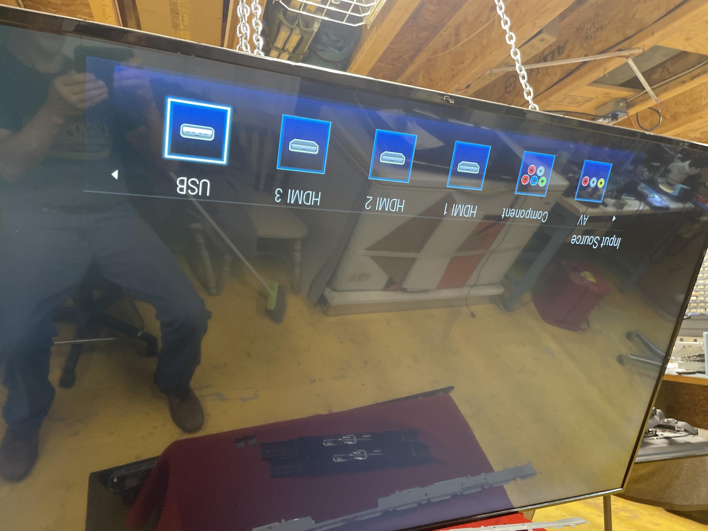

    Hi: I have this Roku rnsmu7536 that has menu all messed up as in short video .Have a suspicion that it's the motherboard.The screen comes on and on screen display keeps going from tv to component to hdmi1 etc keeps cycling.

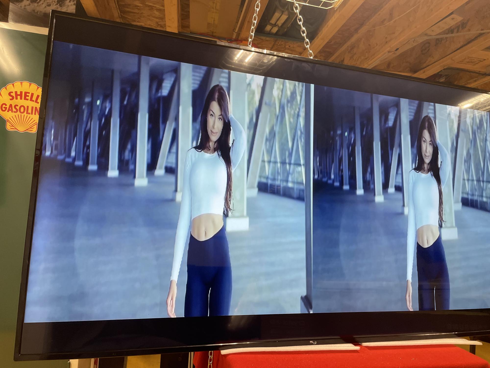

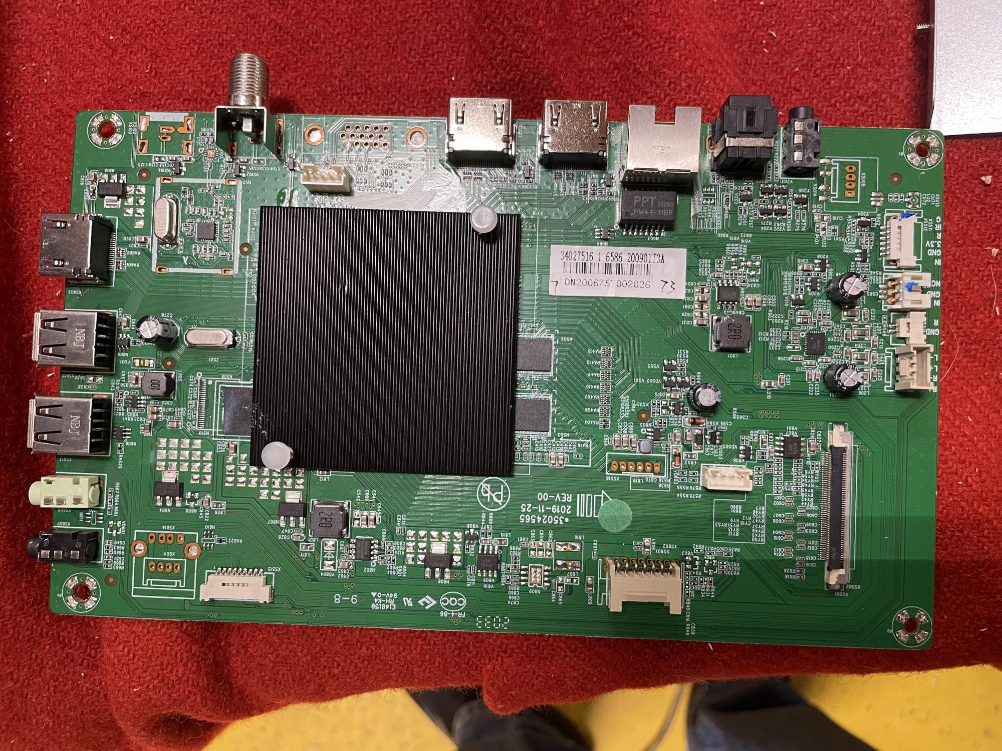

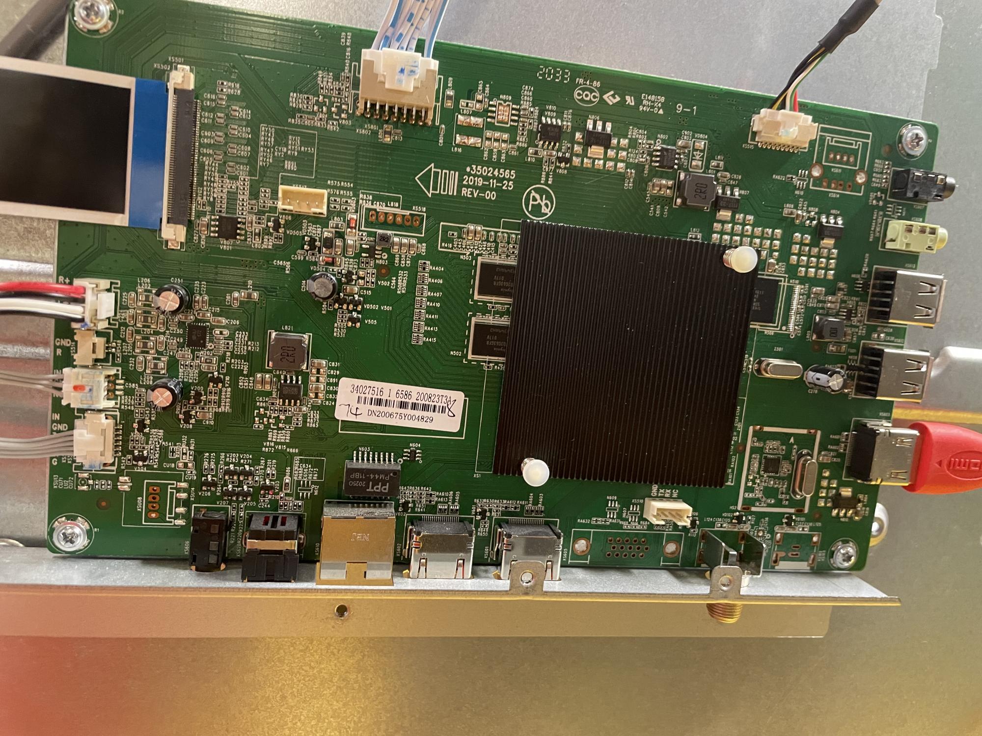

    I received the new board for this tv however it now has menu flashing or scrolling issues fixed but now screen is a split screen. This is right board . Anyone know a remedy to this?
    • lotas
      • Jan 2016
      • 4843
      • Russia
      Re: Roku Rnsmu7536 menu issues
      The firmware in the new board was for a different panel (diagonal, brand...).
      This can be fixed by updating the firmware exactly to your model (lot, serial number) or by changing the settings in the service menu.
