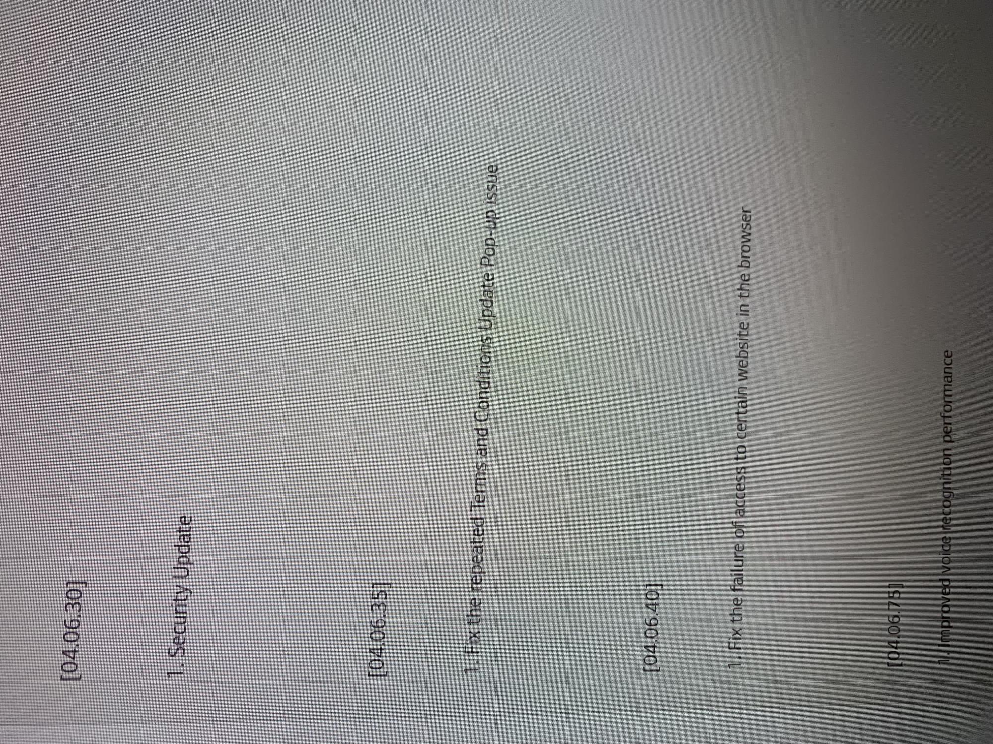

      I did the in-stop reset but after going through the setup process I'm still on 04.06.75.
      I'm not familiar with LG service menu etc. so maybe I did something wrong.

          first of all downgrade .. after downgrade send IN_STOP again... and if it upgrade via Internet... let it and after it finish send IN_Stop again

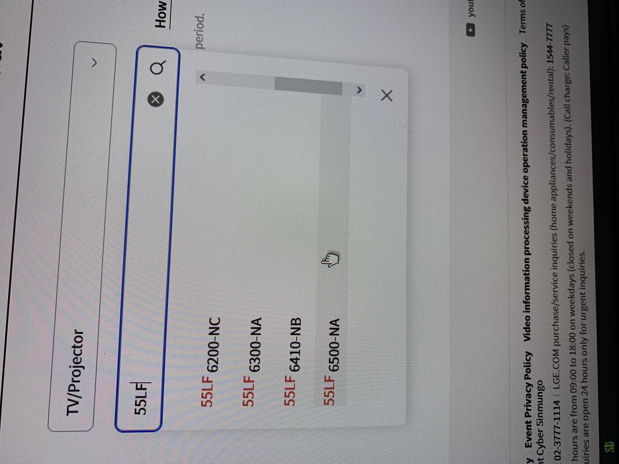

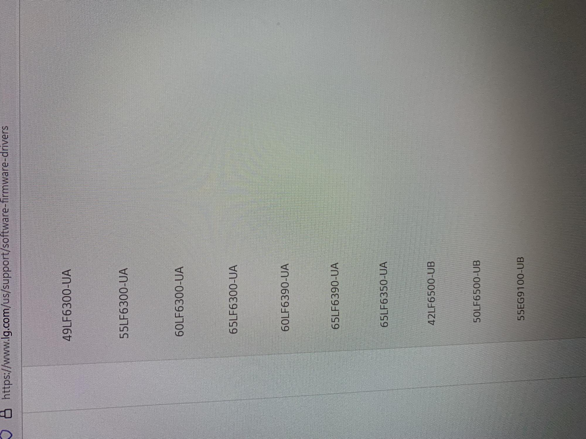

            Ok, I understand but I need firmware to downgrade. I went to the Korean lg site but can’t find my model or any referenced models. I couldn’t locate it on the Russian site you provided either. The closest I found was 55LF6300-NA but my reference list says I need 55LF6300-UA.
            I’m in the US and I believe that’s what the difference is

              Man i gave you links at my post #21 thru the years LG TV production you will find many region firmware belong to yours TV serial to download
              in yours case year 2015
              to know which you need to download... go to setting and try to change countries.... any country listed at the TV you can download from the 4 option

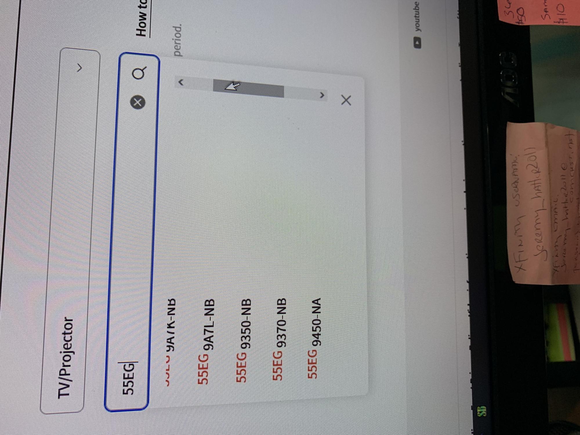

                Ok, my bad. Thanks for clarifying. I didn’t know I could download different country firmware. I didn’t see US listed so I didn’t want to mess anything up.
