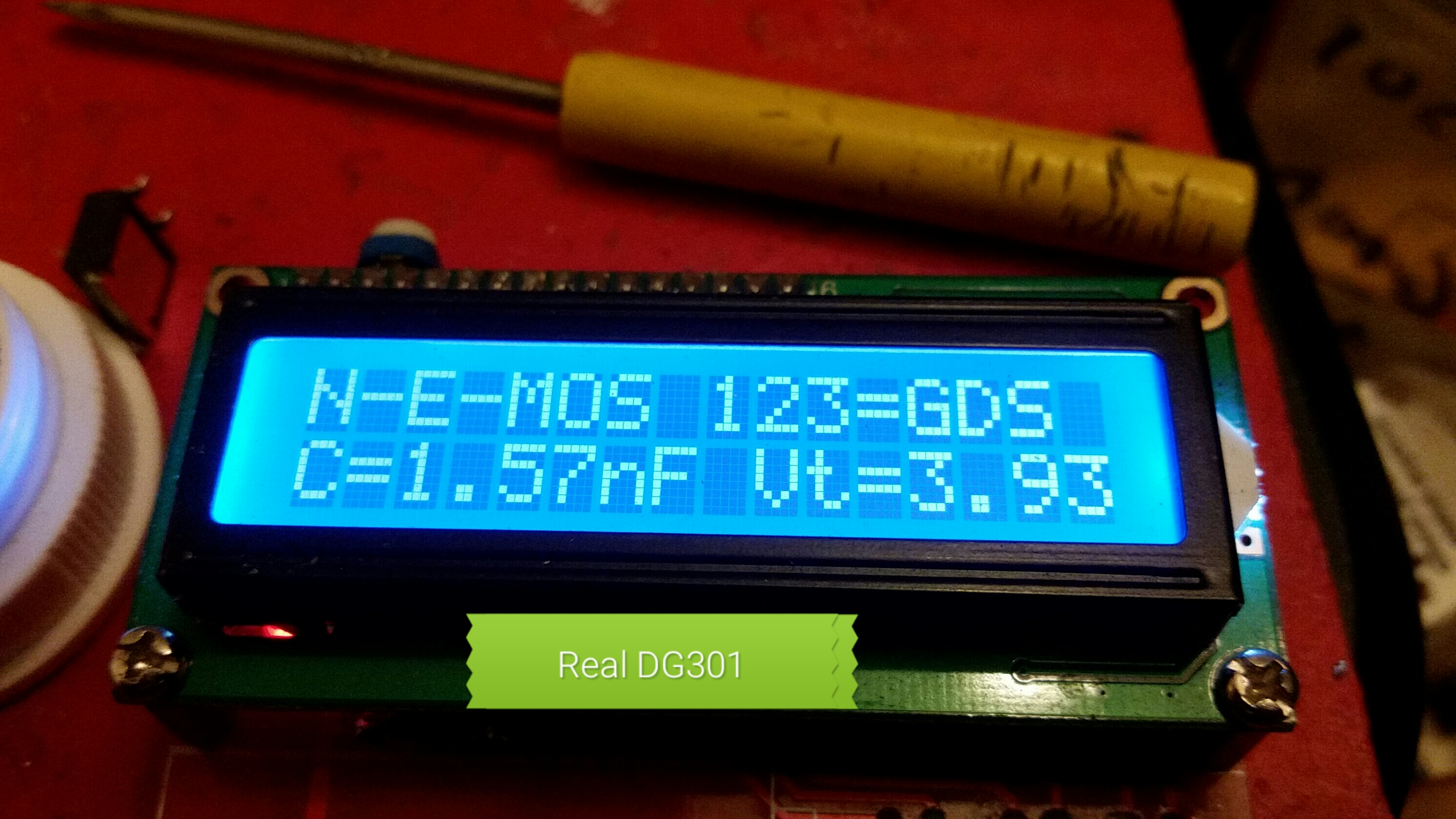

    You may have some fake ones, not sure but they are surely faulty, some testing of IGBT there: https://www.youtube.com/watch?v=vYZW6BFD7ak

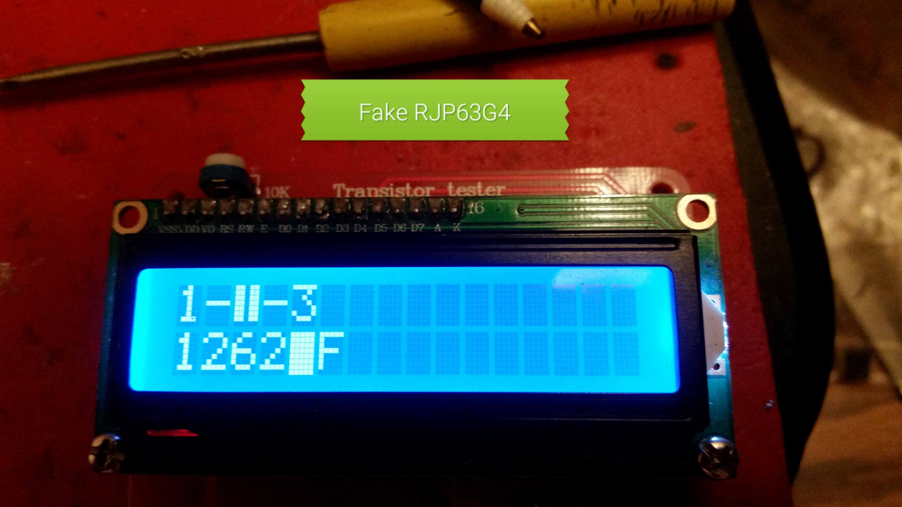

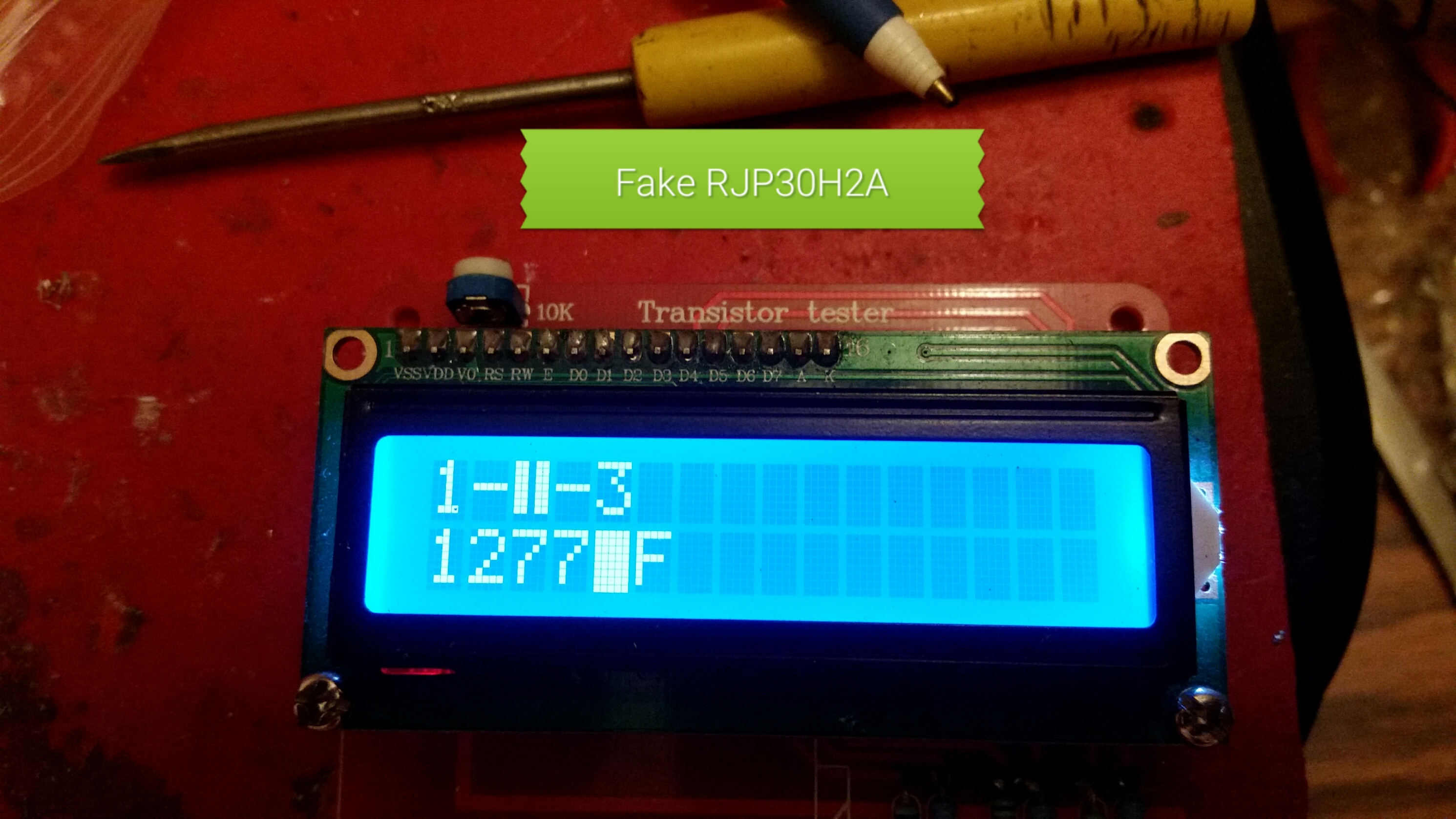

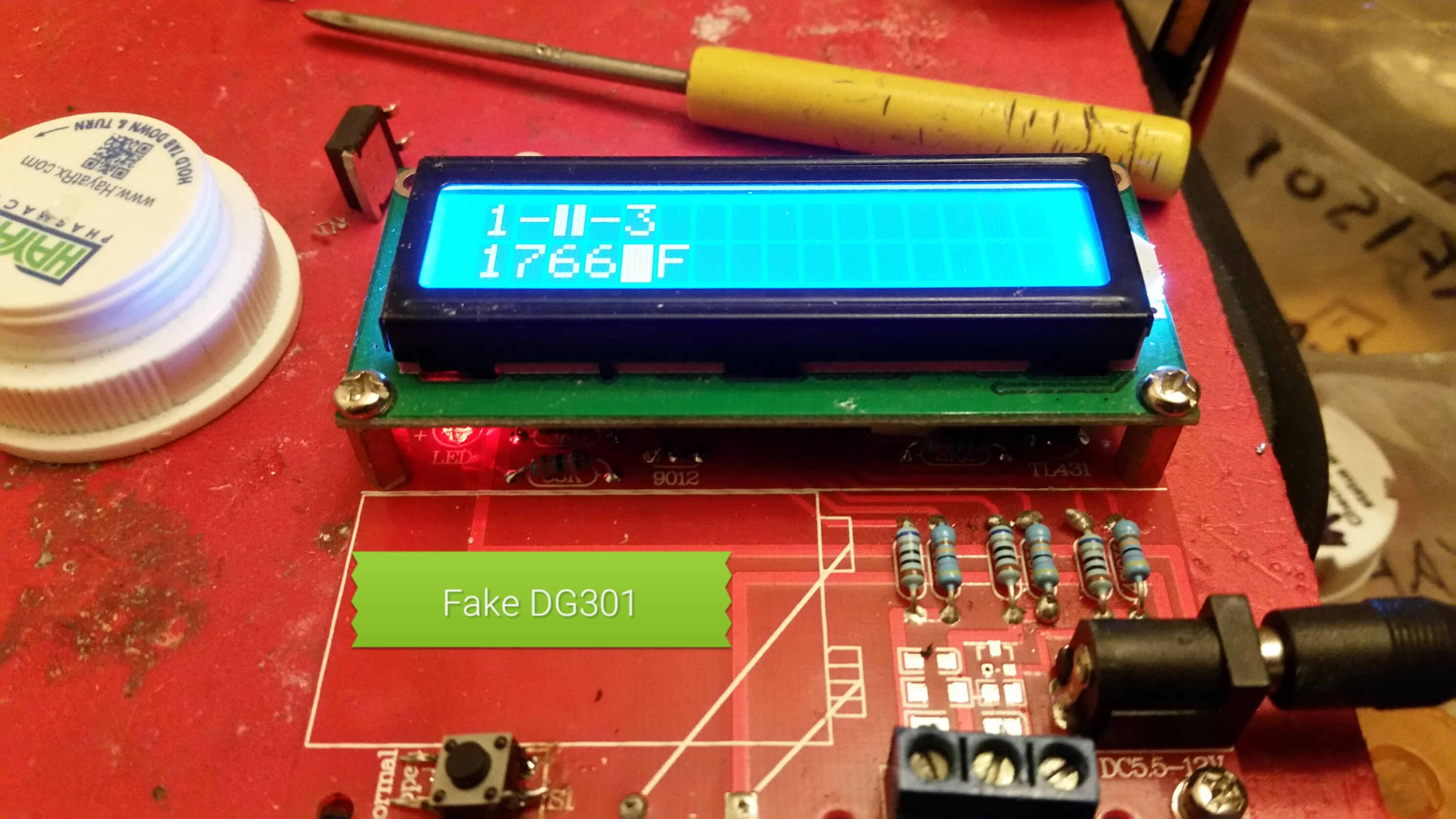

      You definitely have fakes! Do not use them or you may do more damage.

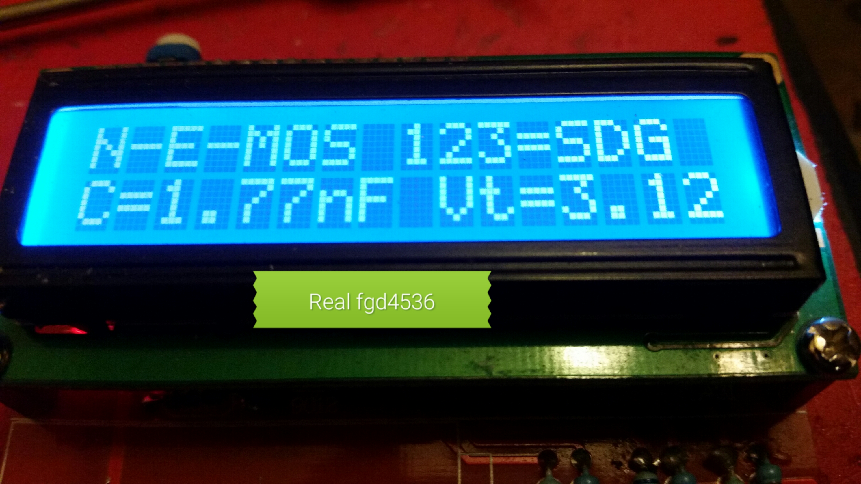

            Here is my transistor tester in action.
