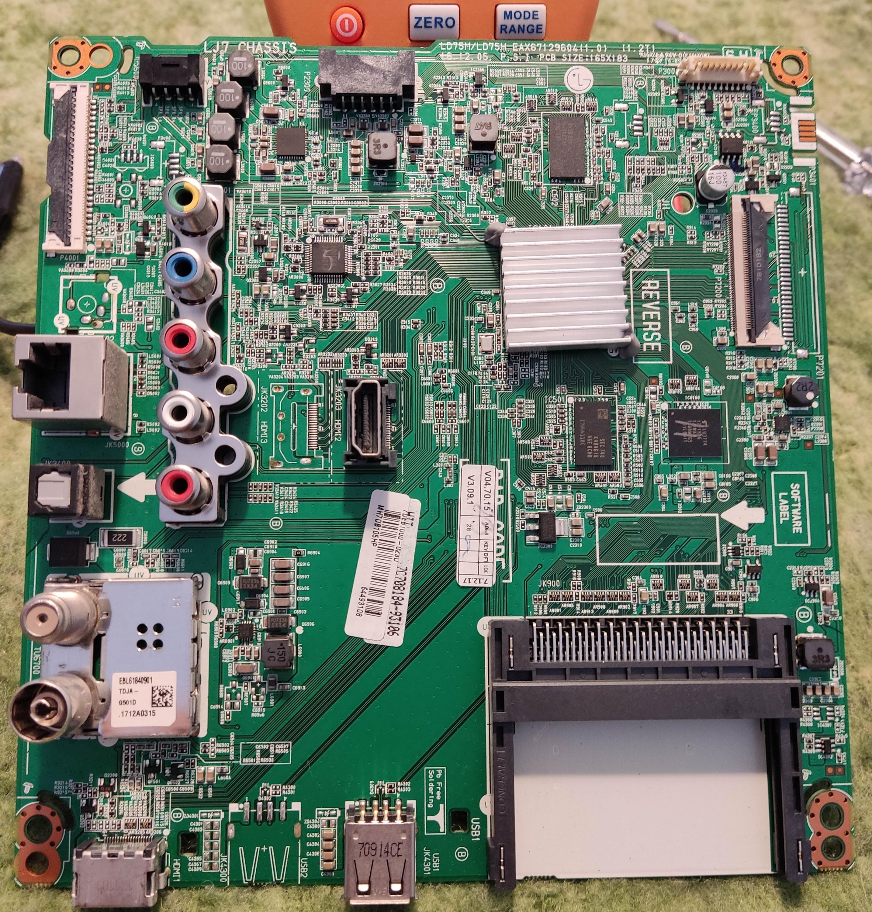

    I there!
    I have this TV set that doesn't even light up the st by led. I fully checked the PS board and this one is fine, it provides 8.9V when Stdby and 13V when ON (forces by DRV_ON pin according to service document)
    So I checked the main board and it is not able to even light up the stdby led and of course it won't obbey to ON button or remote signals
    I checked all caps on board, none of them is shorted. I took some voltages at those caps, some of them have 8.9v on one side, some don't have any voltage. I see some coils and smalls IC's near banks of SMD capacitors that look like DC-DC converters, there got to be at least one source for 5V and probably some others too (3.3v...), but I can't find any other voltage other than 8,7 across the whole board. My guess is that some DC-DC is not working, but I don't know which one.
    I also tested all cap banks with a ESR tester but the results were inconsistent, probably because some of them need to be tested out of the circuit.
    I checked all diodes and Q's for shortcircuits and they were all good. All DC-DC coils show ~0 Ohms too
    Also the issue is not in another board (TCON...) because I've tried all this with no other cable other than PS and IR board attached.
    I'm attaching a close up view of this main board to see if anyone can suggest any idea on where to look at now
    Thank in advance!

    Also let me add that the 8.9V has a little "noise", it jumps up&down just a little bit, not 100% stable, probably 0.1 or 0.2v but to me this leads me to think there's some short in the main board? Does this make sense?

      I checked the coils. They all test infinite to gnd but the one on the top (L2310) shows 100 ohm to ground...

        TV has been fixed, there was a fried choke very close to the socket from PS board, in the +13V line, that was feeding a shorted to GND capacitor.
        All good now, thanks everyone
