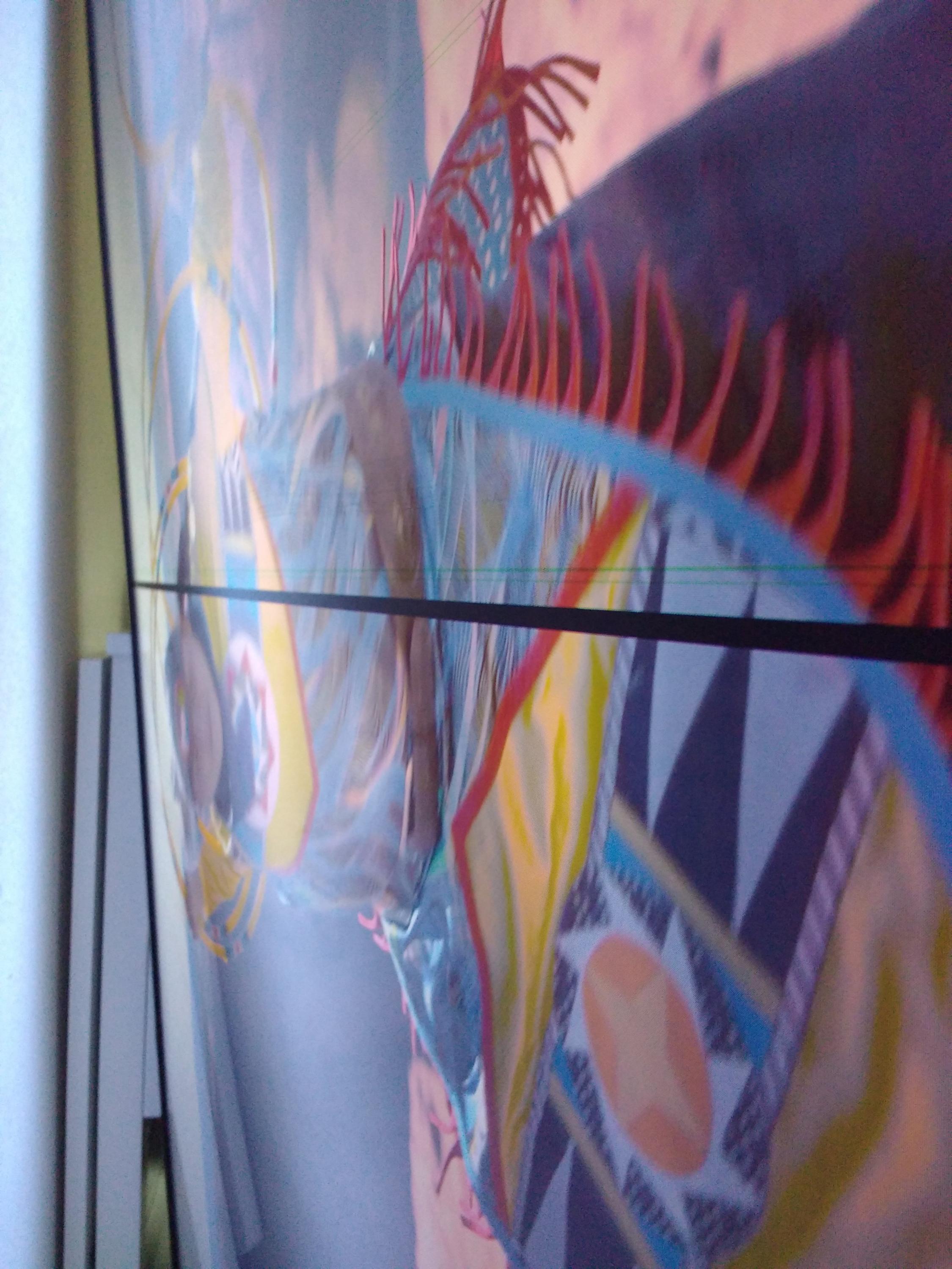

      Thanks! Have disassembled the TV and have found 3 LED strips with burnt LEDs on them.....1 per strip....
      Will try to get some new strips for this model....
      • croupier36
        • May 2023
        • 20
        • SI
        Re: Philips 70PUS6504 without picture

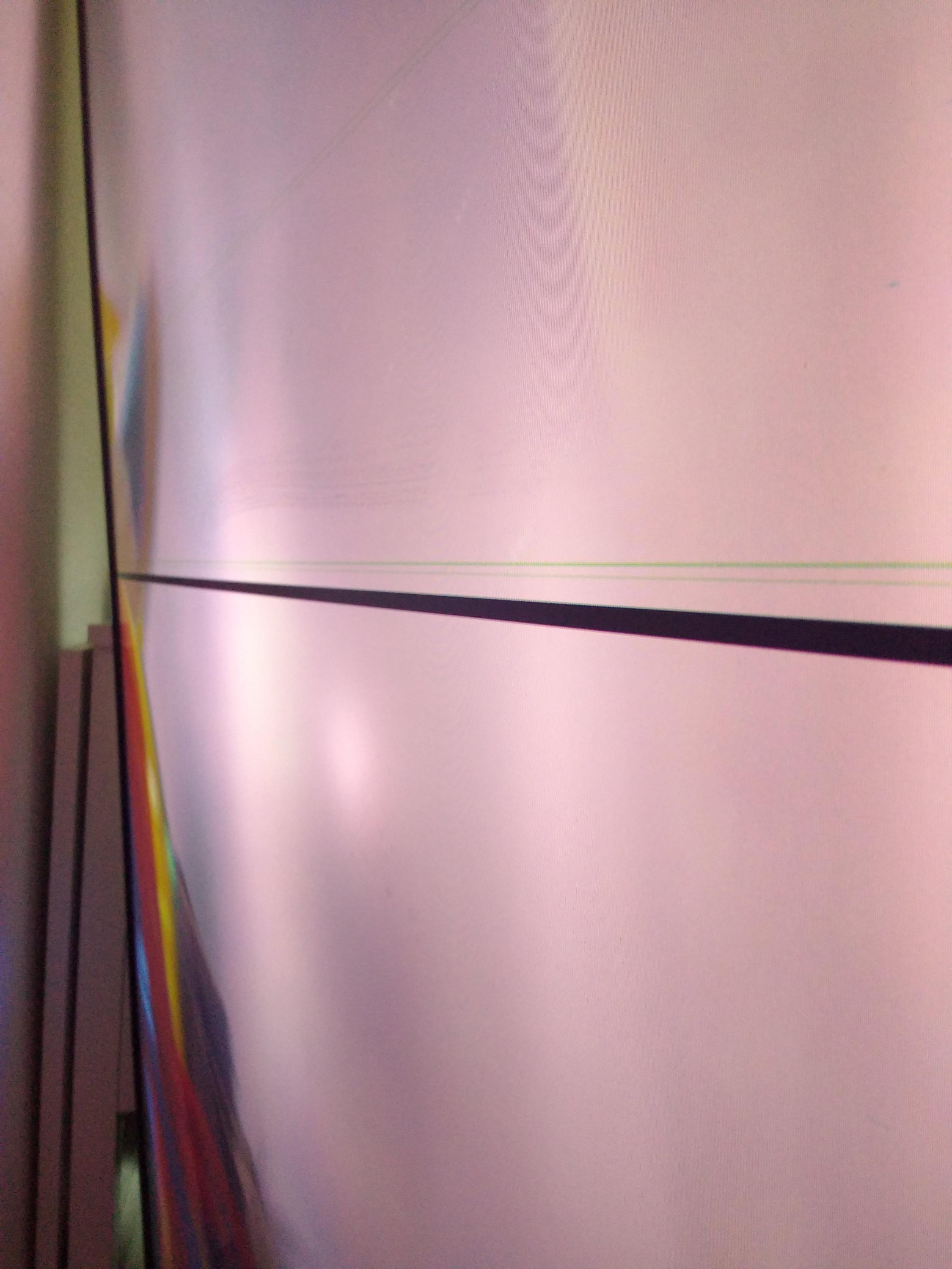

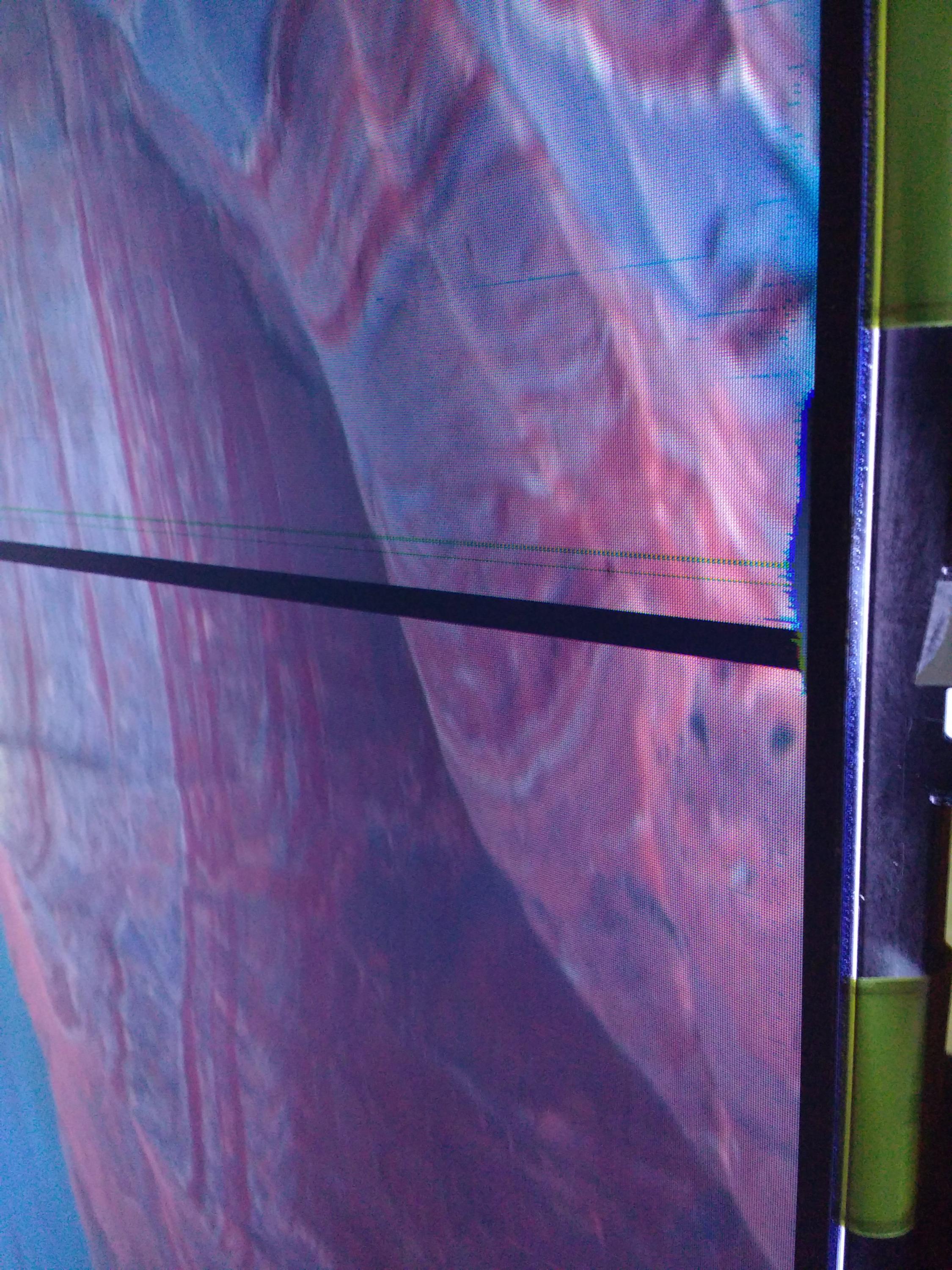

        OK, managed to replace the burned LEDs and got the BL working...
        But...with the BL working I was able to finally test the picture quality (panel)....and noticed a thick black vertical strip in the middle of the screen and a couple of vertical green lines......not to mention a portion of the panel at the bottom (beside the black strip) that looks like pixels are not working in this area...Is the panel gone or an issue that can be repaired (T-con board, etc....)?
        • R_J
          • Jun 2012
          • 9535
          It looks like the panel is damaged, looking at picture three, it almost looks like liquid damage that started to wick up between the lcd.
          • mateuszdg
            • Dec 2022
            • 16
            • United Kingdom
            Thank you for reply. Indeed that is what i taught but these dots are seem to be different places. On one screen they are solid, change picture they move to other place. And lined that show up as well sometimes there is more sometimes less. I think its a panel myself but just wanted to confirm before i scrap it.
