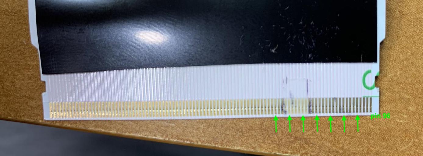

    how many pins you masked now LOL.. could you count on which pin masked right now.. seem you have one of gamma under mask.

        Re: Samsung QN55Q80R Bad Panel Help
        Pins 19 or 20-26. It's hard to count those tiny pins.
              if this count correct and the pin chart of lotas correct then you have just masked half of the SPI... in this case i will remove the mask and just remove the spi carefully

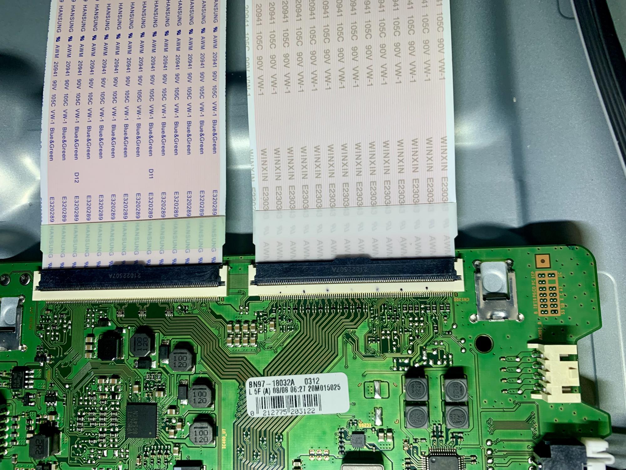

                Lots of transposed pictures and easily confusing. Judging from the pics in post #9 and #13, OP masked
                CN1301 (I'm assuming pic is CN1301 since thats the half thats not working) pin 74-82 (can't tell from pic if mask was continuous across this range). Service manual ( closely related, likely correct CN1301 pin out. link p112 for main board pic, p129 for CN_1301 )
                This is LC_VGP1_GOA, STVP1_GOA, CKVB1-4_GOA, CKV2-4_GOA
                Maybe should just try to mask out the 8 gate driver pins on the bad side (CKVB1-4 and CKV1-4) per post #14 (but I think post had wrong pinout diagram : CN1300 rather than CN1301) Probably can skip CKV1_GOA for total of 7 pins since short isn't there from current test. If that works, then gradually tried fewer CKVB1-4 CKV2-4..
                BTW, for precise experimental masking. I do it this way. Mark off 12 pin steps (service manual pin listing is in rows of 4) on the connector. Cut thin white paper precisely. Paper don't move when inserting the flex into the connector.
