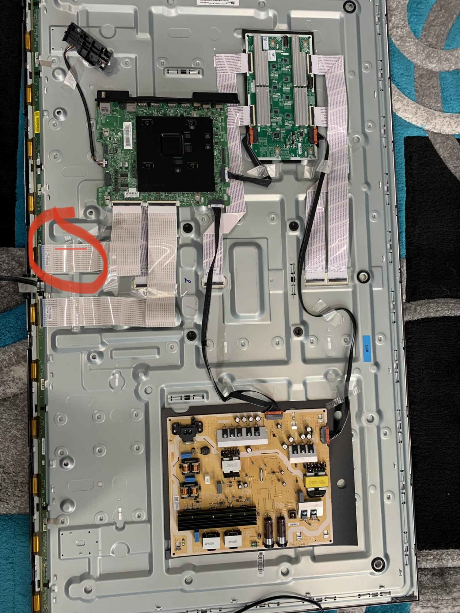

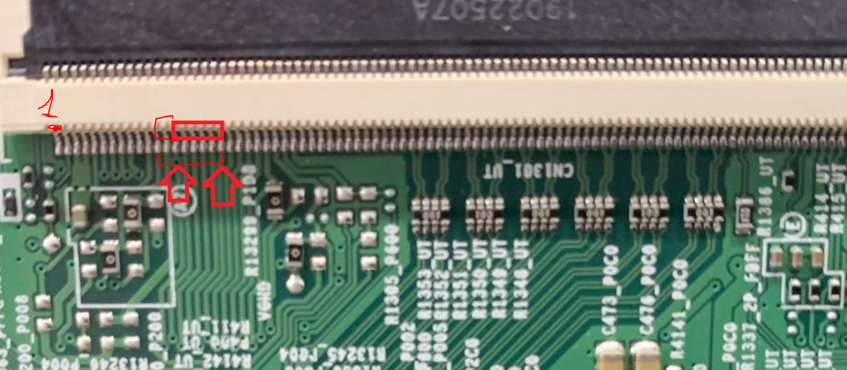

    Got this tv and it would reboot with no picture when I got it.
    Unplugged mainboard from power supply and all leds light up and stay on.

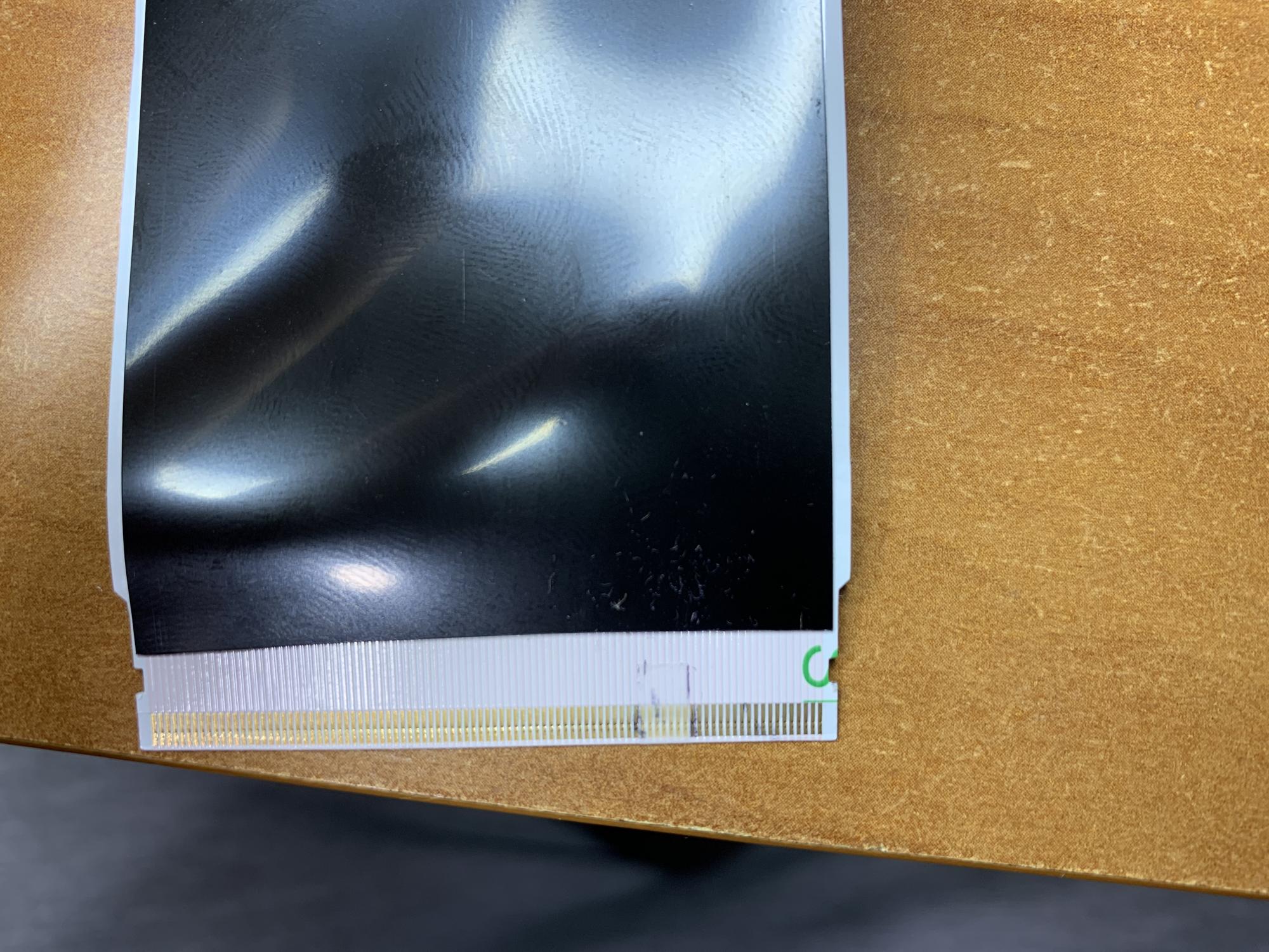

    So I try tape method and got the tv to stay on and not rebooot but no picture.
    If I cover just the 1st pin on lvds cable the tv and backlight stay on just no picture.
    I've tried every combination of pins to cover and can't get a picture for nothing.
    Just curious if anyone else has this problem with this model and found a solution?
    Any suggestions or help would be appreciated.
    I circled the lvds cable that I taped and marked the side of the cable that I covered with tape on the first pin to get it to stay on.

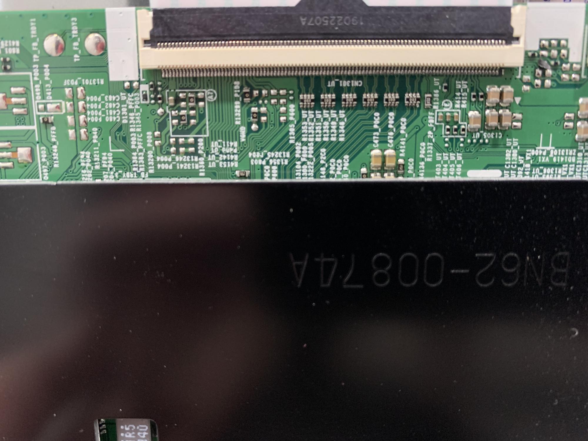

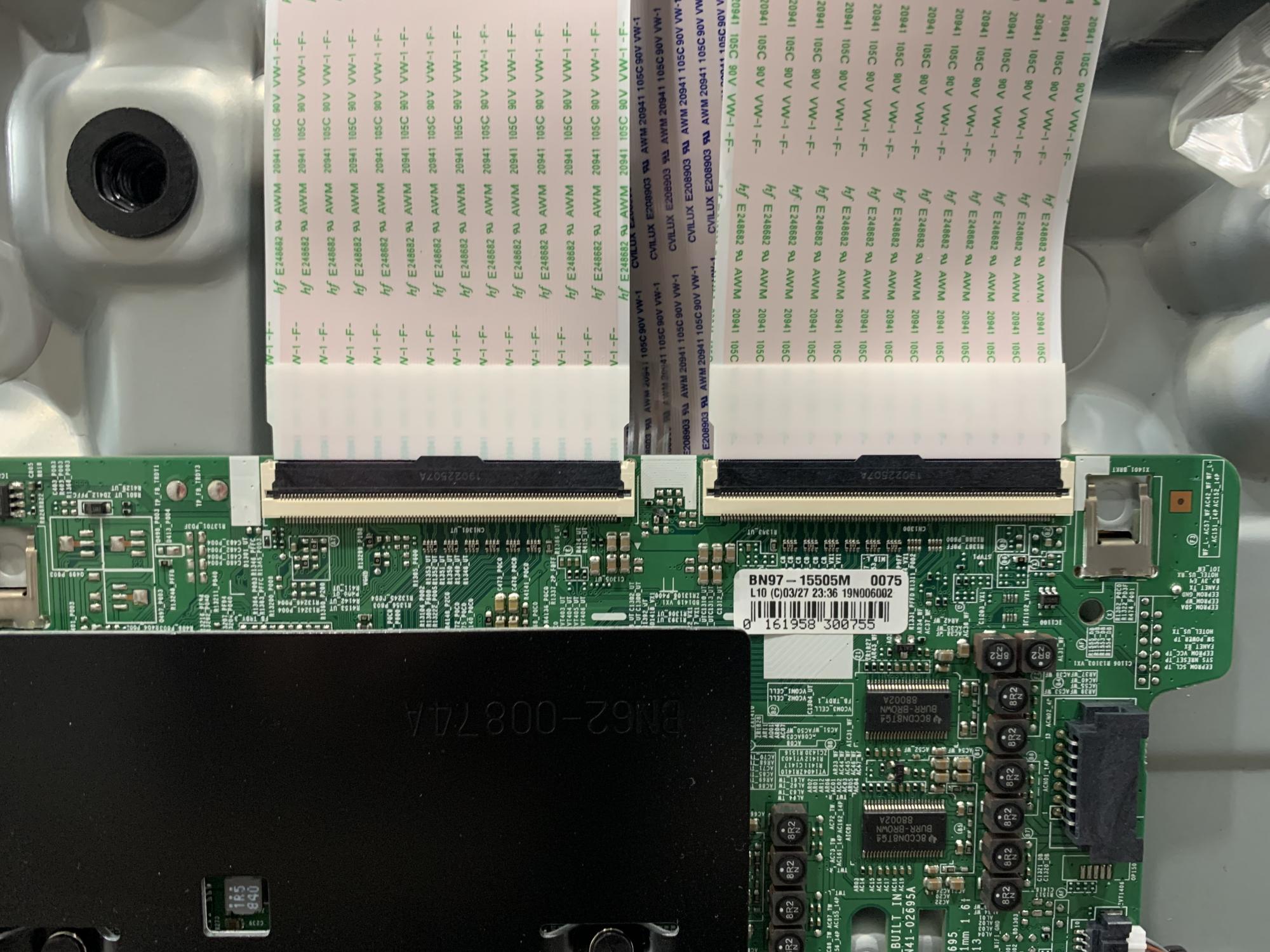

    could you upload close focused photo on the other LVDS socket ( the top one ) at main board

      Re: Samsung QN55Q80R Bad Panel Help

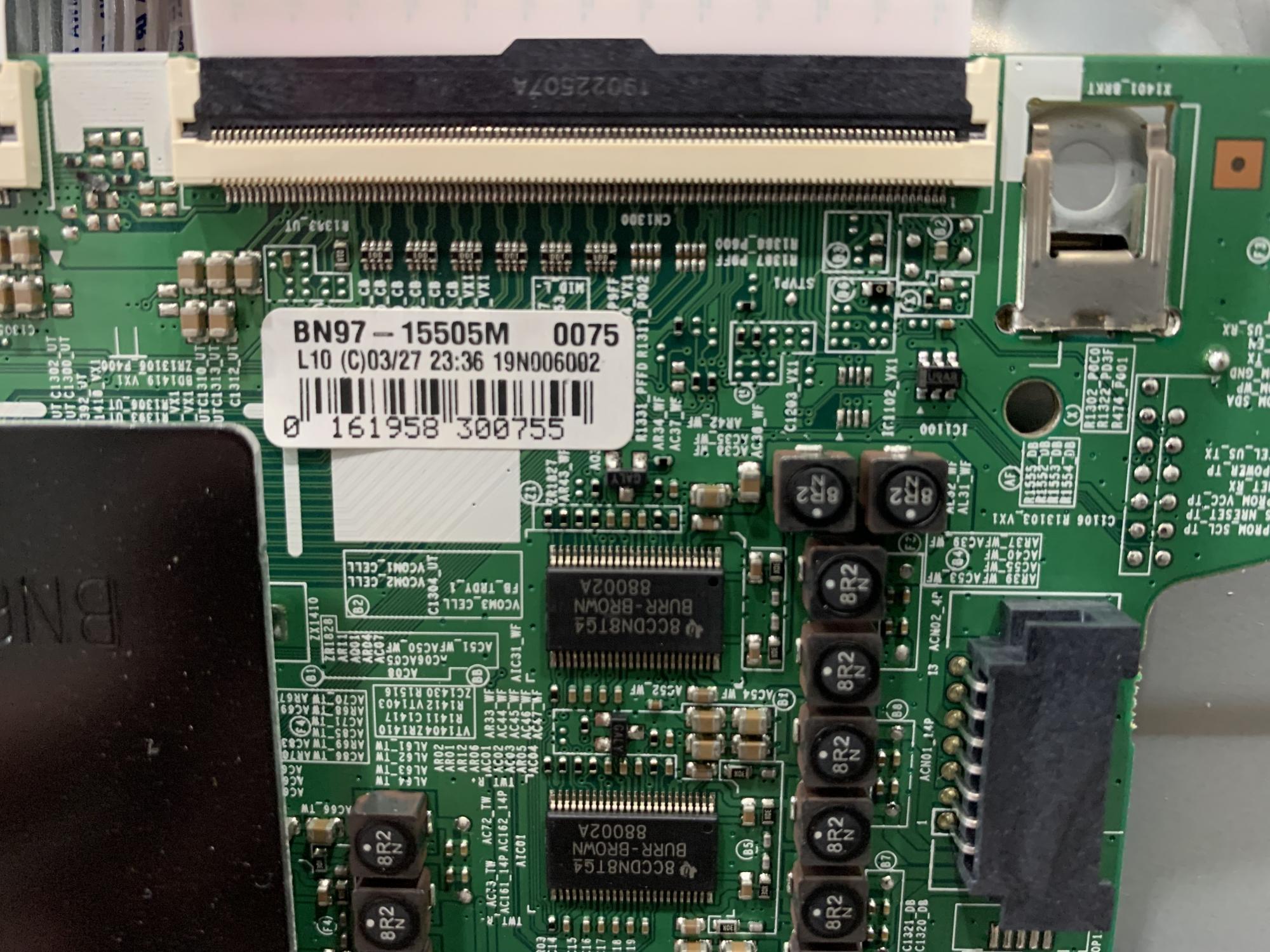

      Here you go. Let me know if you need me to remove heatsink.
        remove yours masking on other LVDS which you did... and try this exact pins masking at MB side...

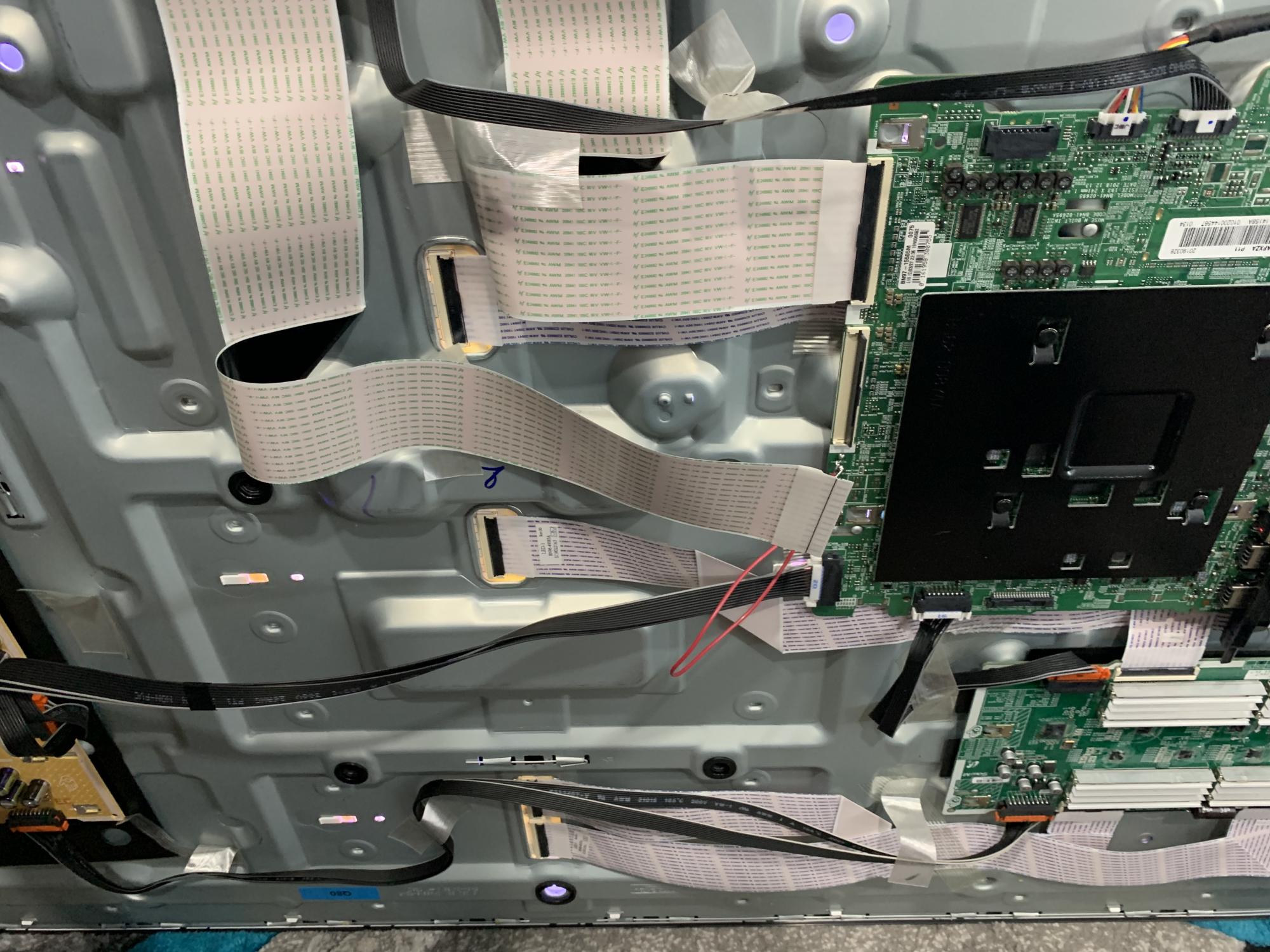

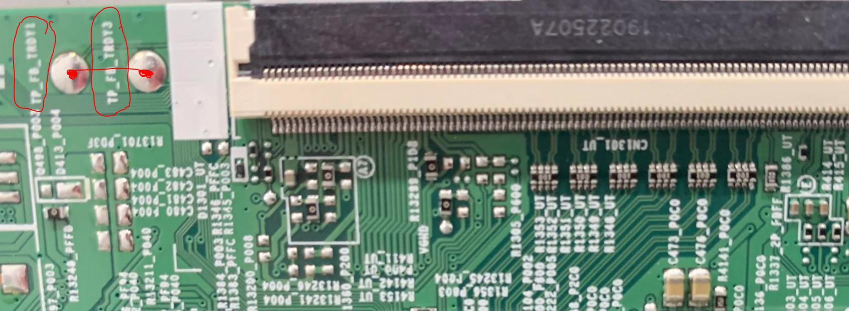

          Install the jumper, and now you can experiment - disconnect the left and right bars in turn.
            Ok tried those pins and the tv just reboots again with no image
            Also tried with the 1 pin I had covered and the pins you asked me to cover and tv stays on but no image
              I will try this now but can you explain what this does by jumpering them. Just trying to understand what I'm doing.

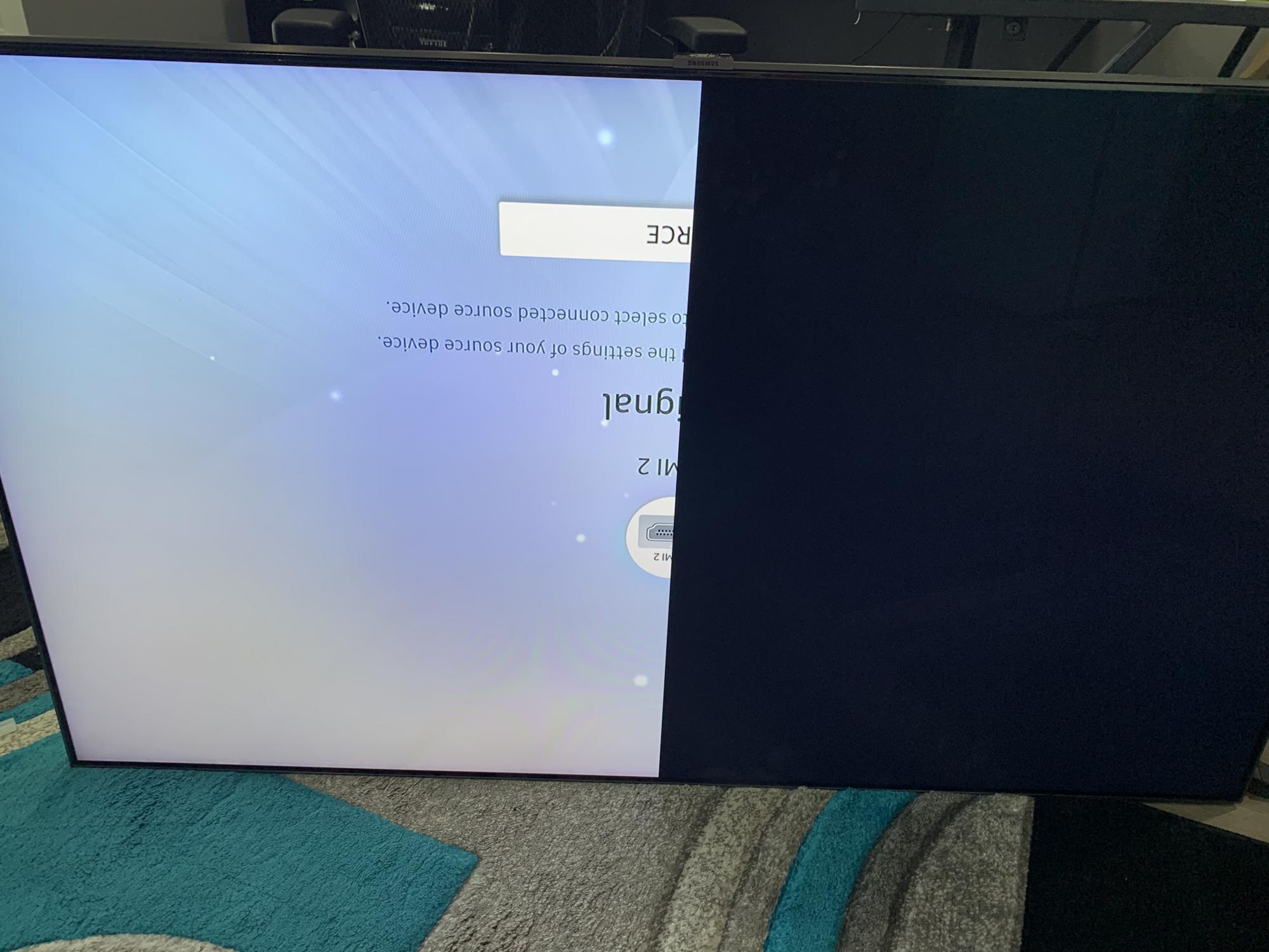

                  Lotas, with that jumper and 1 of the lvds cables unplugged I got image on half the screen.
                    Yes, it should, now you know which half is not working.

                      • Russia
                      With this jumper, T-CON thinks that you have two cables connected, and gives signals to the panel, if you disconnect any cable without a jumper, nothing will happen.

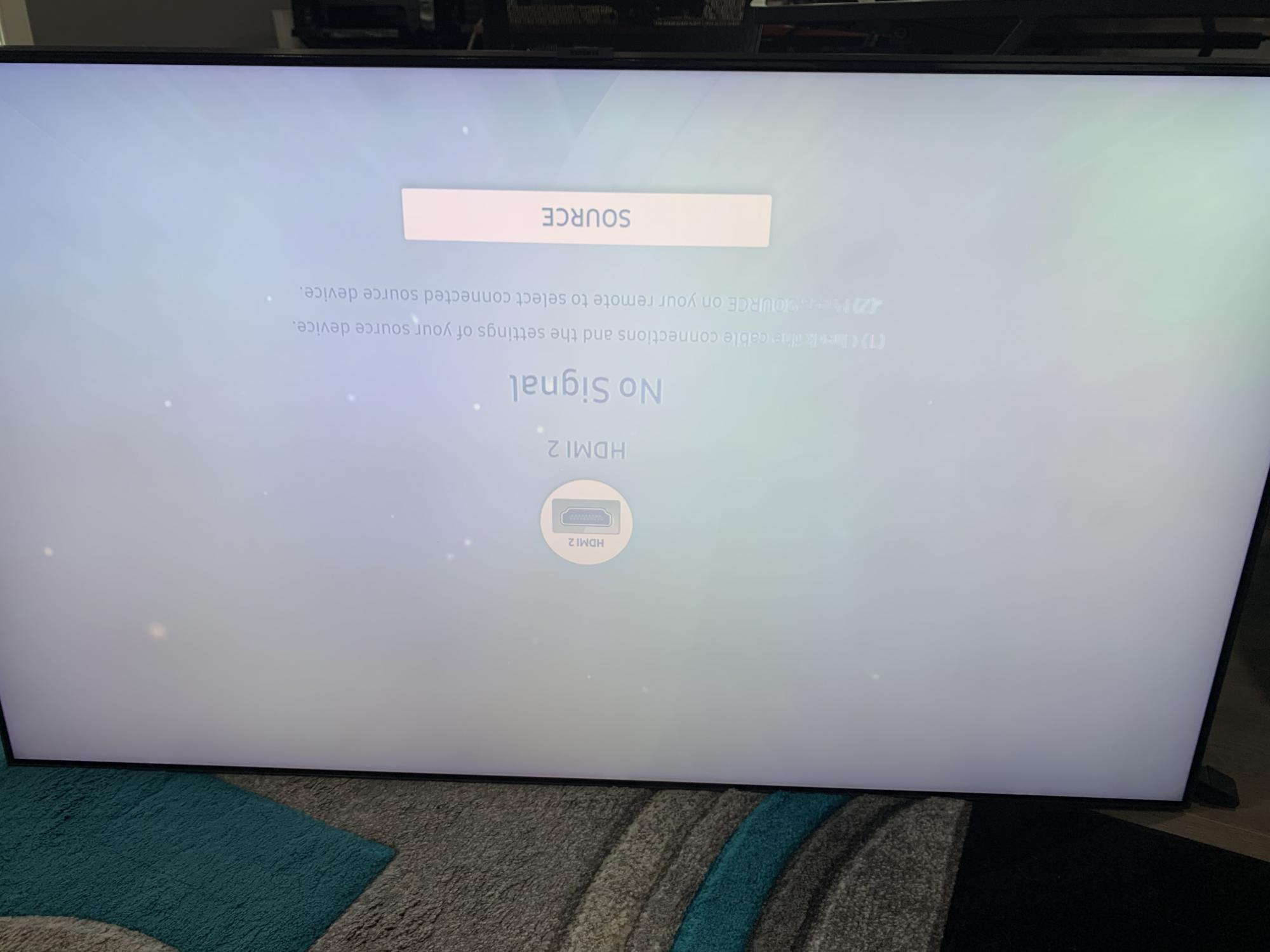

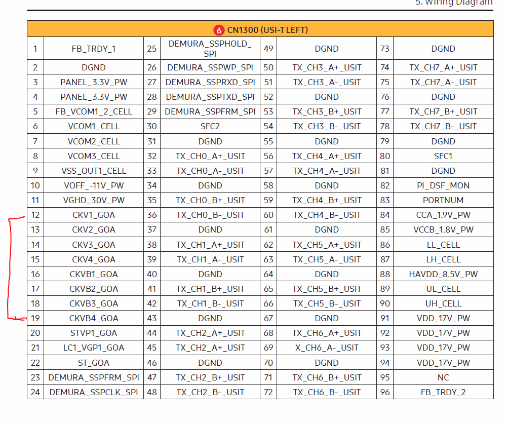

                          Ok, I got a full image but the picture is washed out and not really acceptable.
                          Diah- you weren't far off as the pins I covered were right where you pointed me. Just a few off I believe.

                            Try another + 2 pin.

                              Then check SPI Flash is not shorted.

                                      Update, I tried covering those 2 pins as well but no luck. Same washed out image.
                                      Also checked both winbond chips and neither are shorted and I measured 3.3v on vcc.
