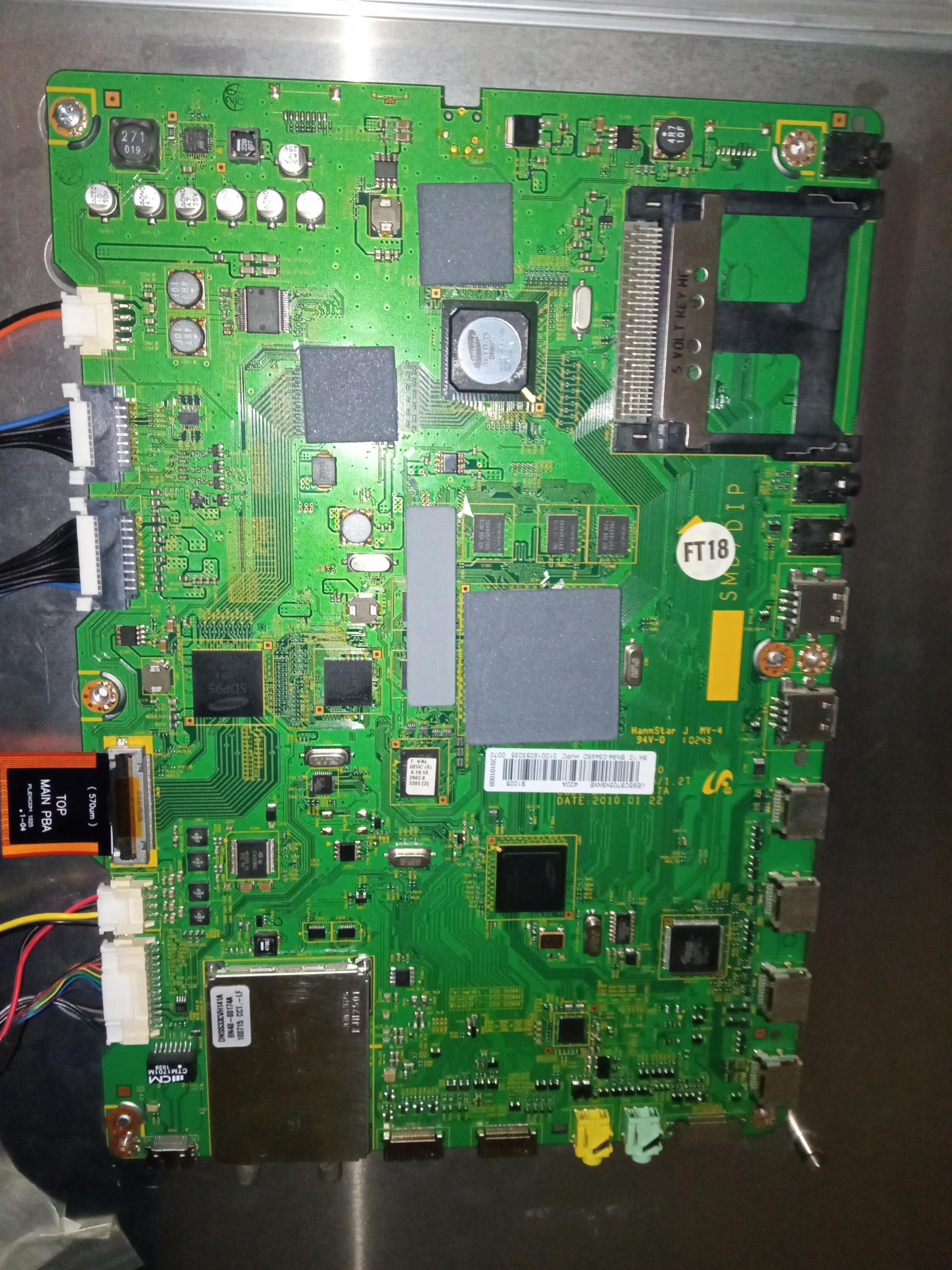

    Mainboard is BN94-03469D (on the same label it says UE65C8705XSXXE)

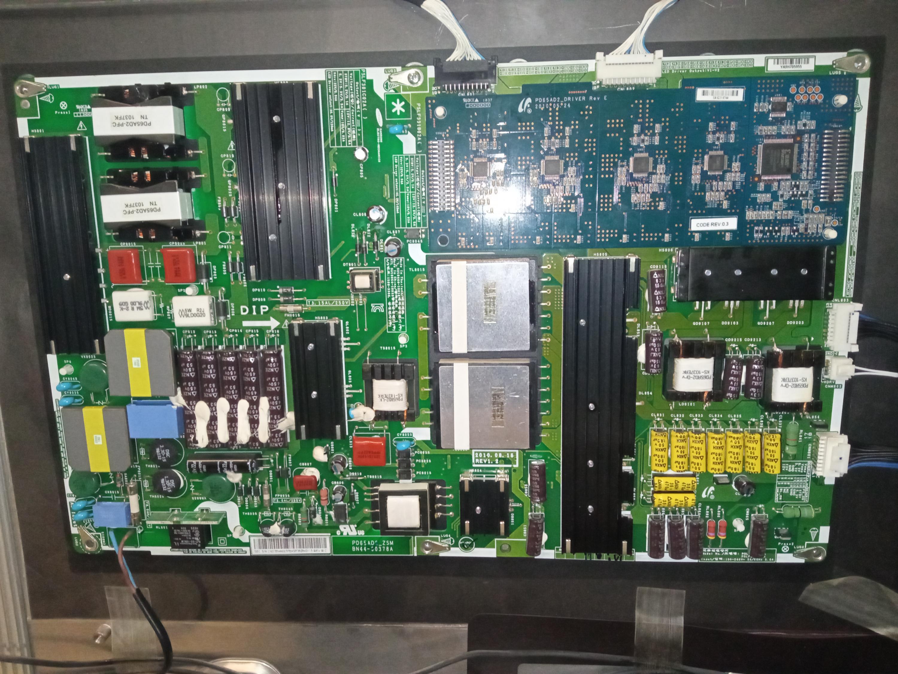

    Power supply is BN44-00378A

    I ordered a used (but working according to the seller) power supply and will put it in this week to rule out the power supply.

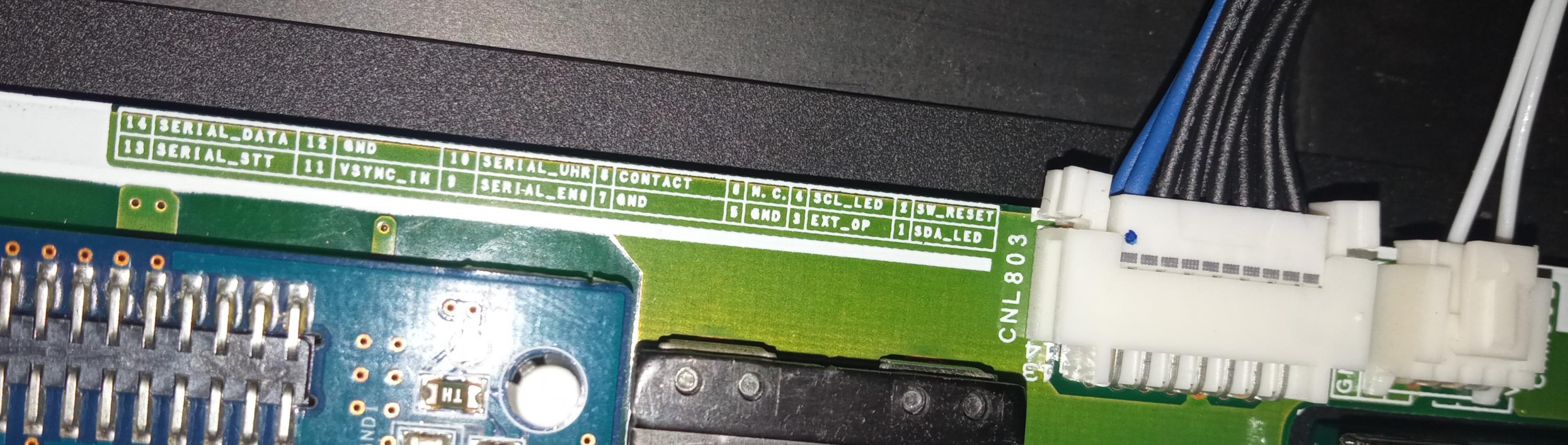

      There seems to be no communication from the mainboard to the LED driver board.
      At the connector of the power supply I measured the SCL and SDA lines and it is 3,3V (measured with multimeter).
      With the oscilloscope I expected to see the clock at least on SCL but there is nothing oscillating.
      Even with the smallest possible setting on the oscilloscope (10ns division). I can't see anything oscillating.

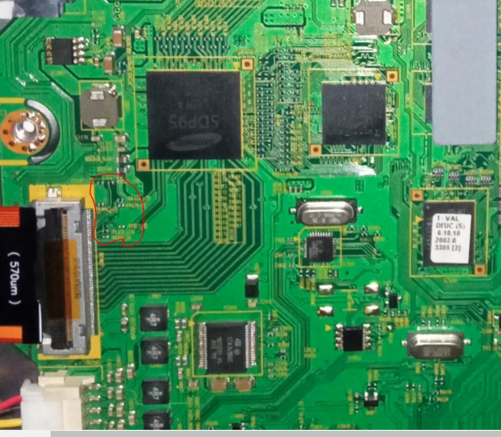

      The traces on the mainboard of the connector go over a resistor with 0 Ohm each under the IC8001.

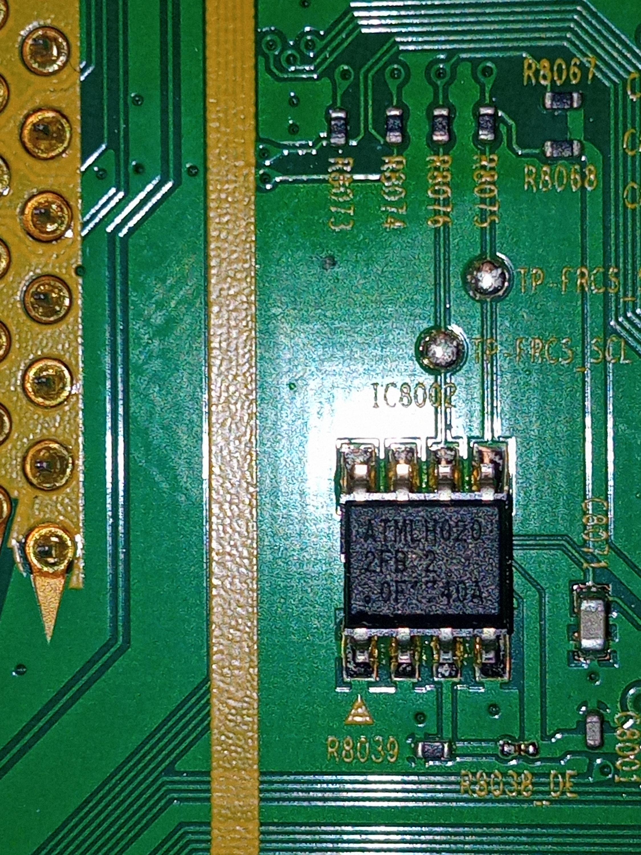

      While following the traces I "accidentally" found the eeprom (IC8002).
      With multimeter its also 3,3V but here I could detect an oscillation at the SCL and SDA at each "restart" for about 2-3 seconds. The traces also go through a resistor with 0 Ohm each under the IC8001. So i assume the IC8001 is up and running.
      Pins (14,13,11,10,9) named Serial are all near zero V. Nothing to see on oscilloskope.

        The PSU was not the solution.
        So a guy from a German forum told me I could use the mainboard from a UE40S870 and it's visually the same mainboard.
        I bought one and installed it. I hear a startup sound when I turn it on and the backlight comes on (and stays on).
        Unfortunately, I still don't see a picture.
        Can someone guide me blindly through the menu so I can do Panel Auto setting? Or is there another way to force the board to do a panel scan?
