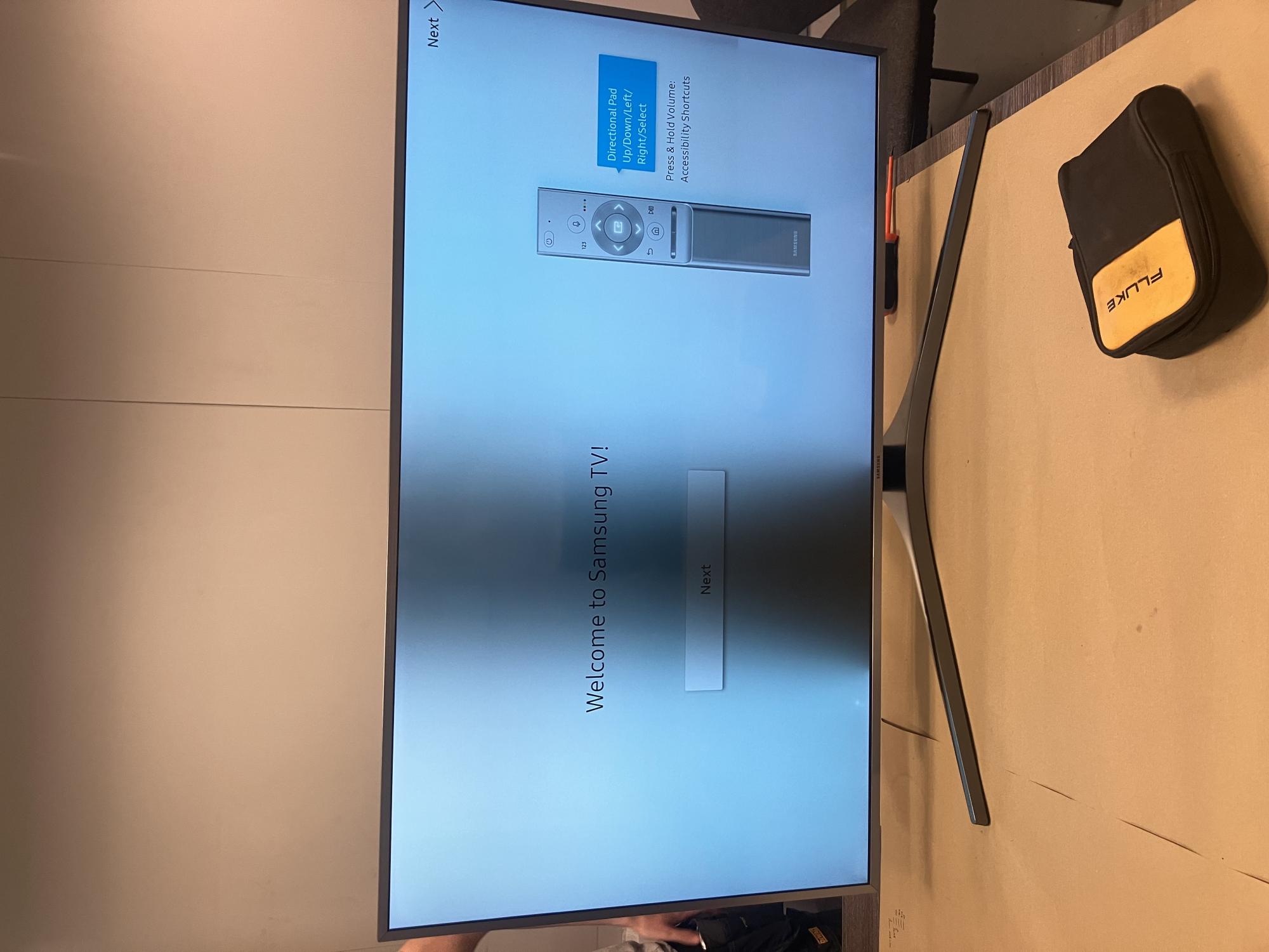

    Hi all. So from the knowledge I've picked up so far I believe the issue maybe caused by a failed strip of LED's? Looking at the photos would that be plausible?
    Secondly. How in gods name do you get access to the backlight panel? Mother of god

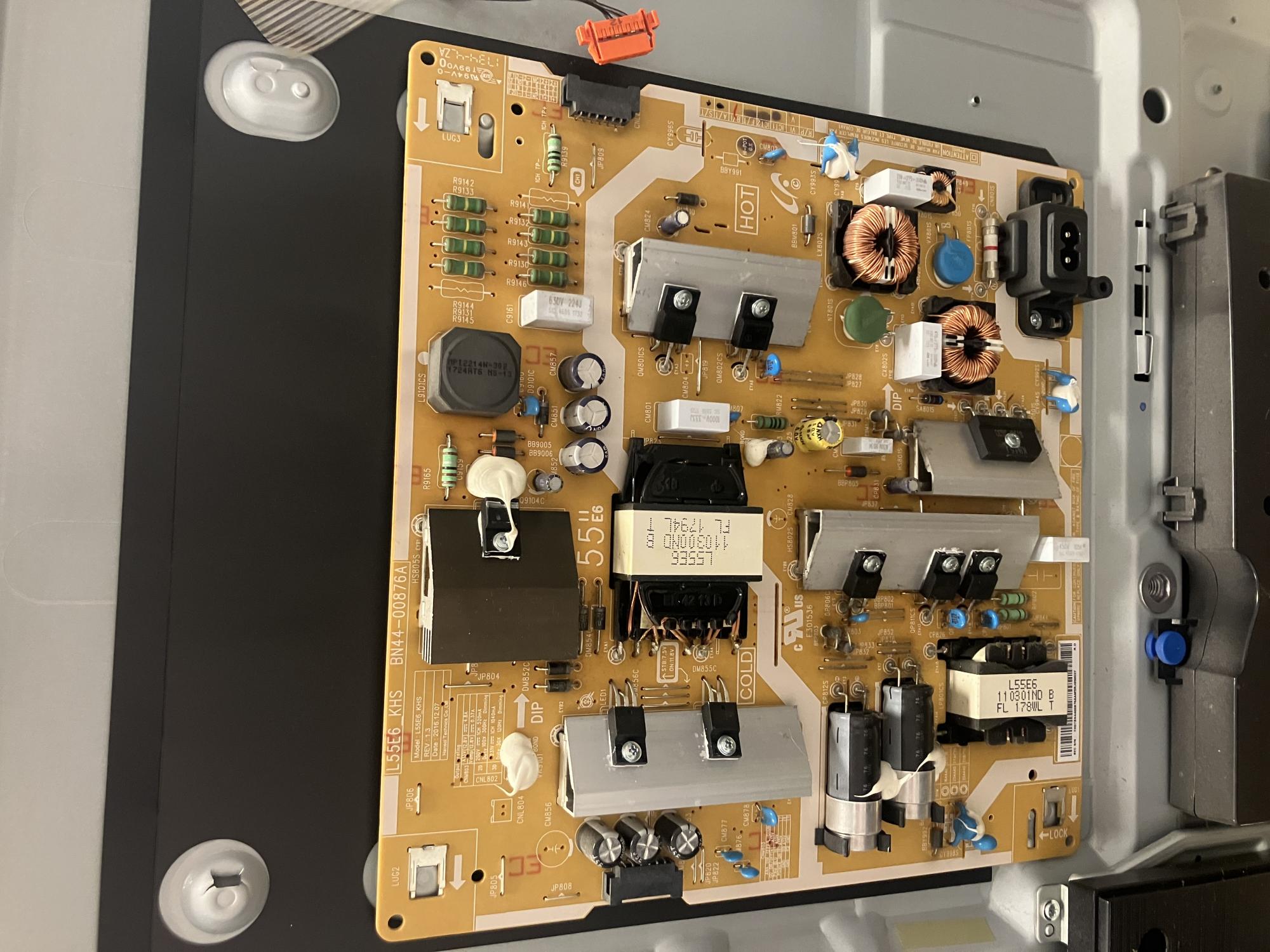

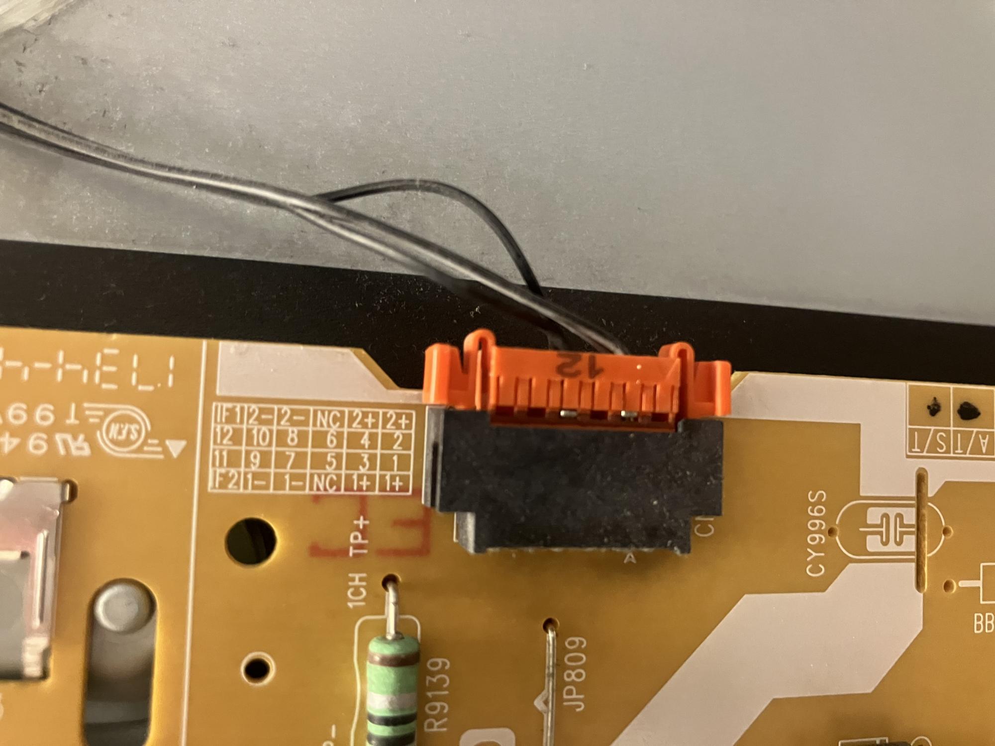

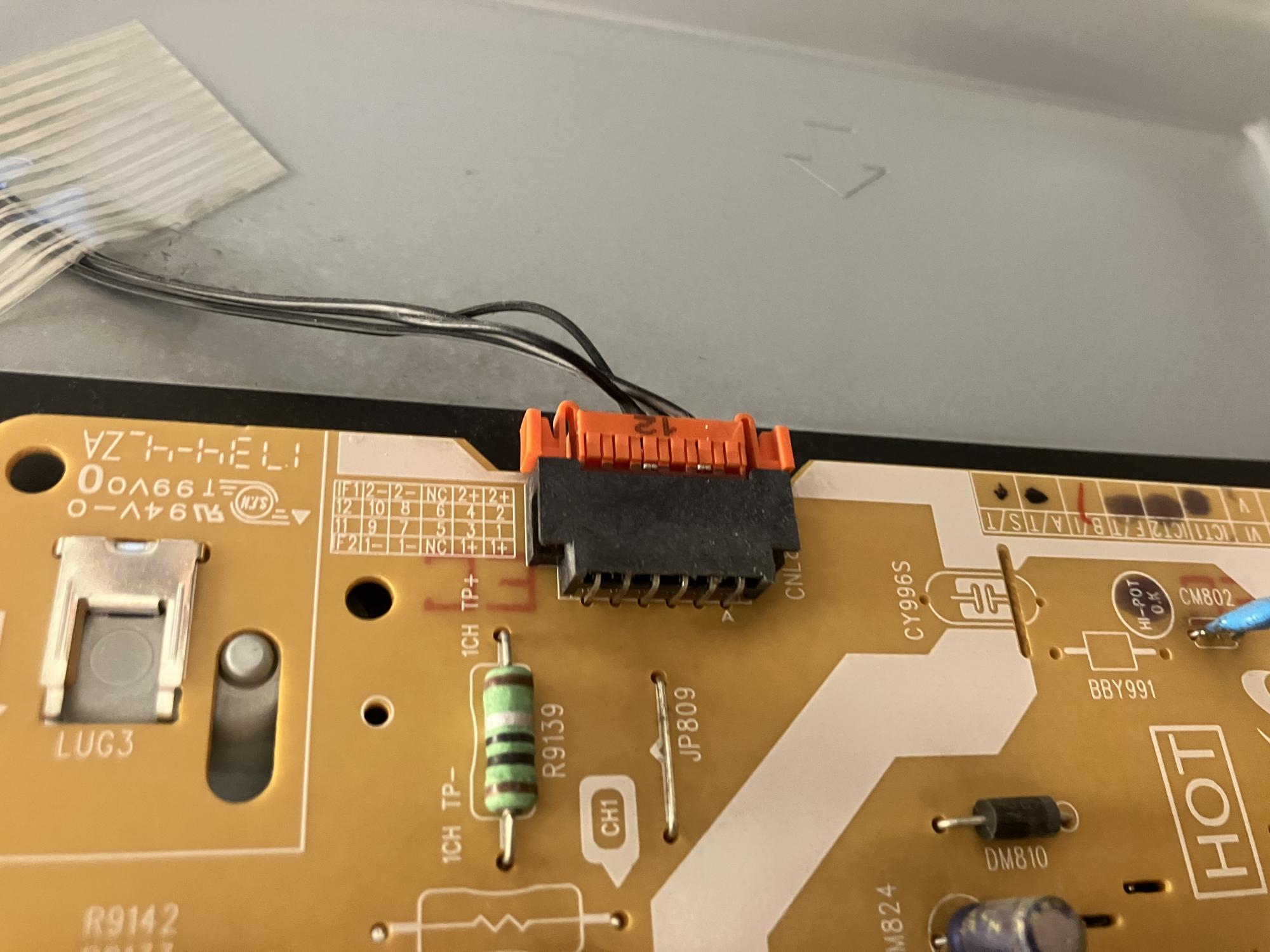

    I've tested the voltages with the tv powered up on the terminal rail marked CNL 802 and they're as follows reading from pin marked (A) upwards. Pin to ground.
    Pin A 298v DC
    298v DC
    0v DC
    216v DC
    216v DC
    0v Dc

    yes its LED back light issue at the left side... few LED burned, but not only this..because the LED are edge strips .. mean the first reflection plate surface burned too because dummy Korean put it so close to touch LED surface
    you need to take out the panel.. and all filter sheet under it to have access to this LEDs... look on youtube there are so many video

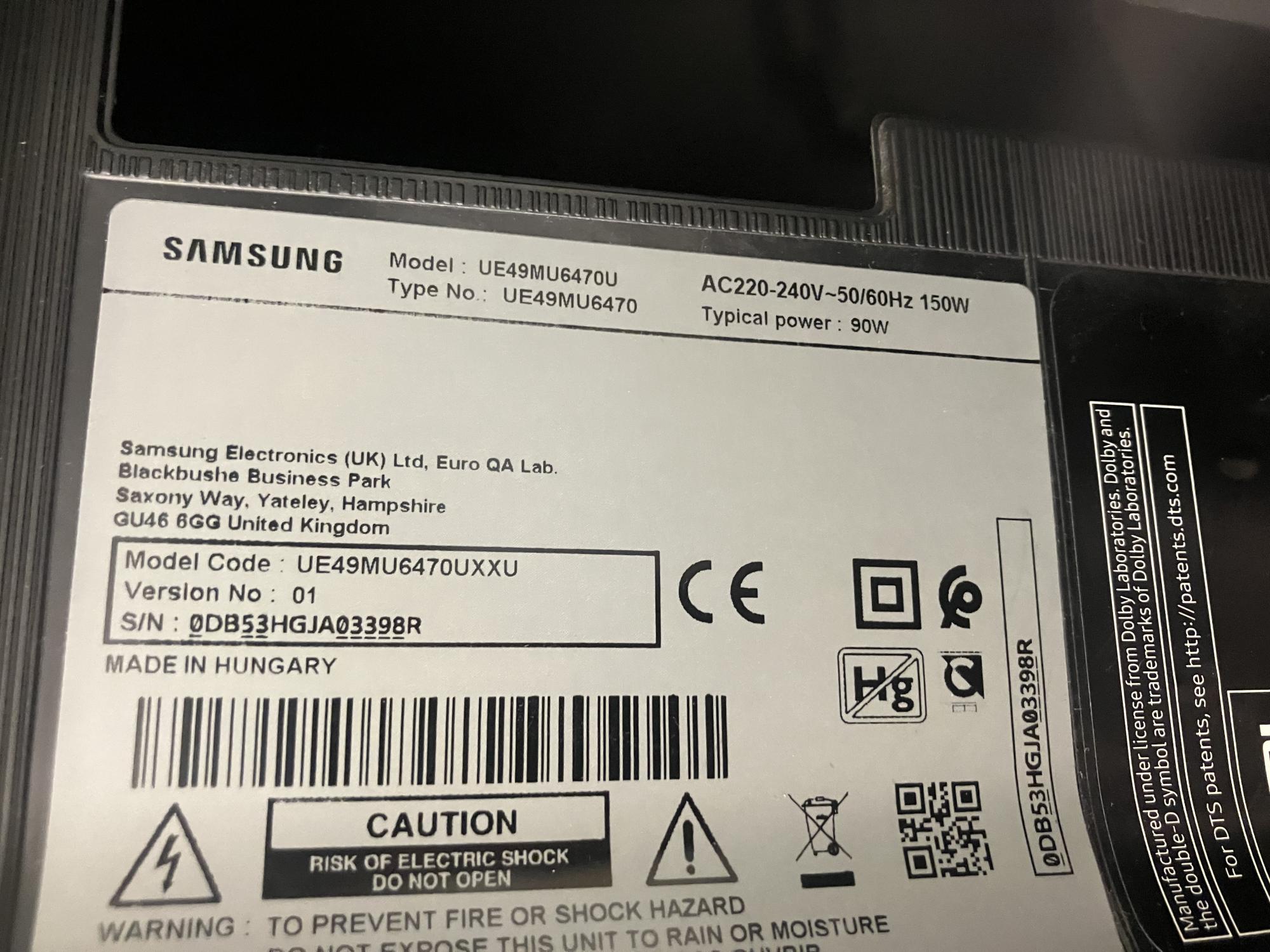

                    Maybe all the same your model is not ue49Mu7470u, but ue49Mu6470u, then your backlight with the number is BN96-39674A.

                        Yes, I saw the 6470U but not exactly 7470U, not sure if there's a difference or not, the 6470U is there on ali: https://www.aliexpress.us/item/32568...andl_shipto=US
