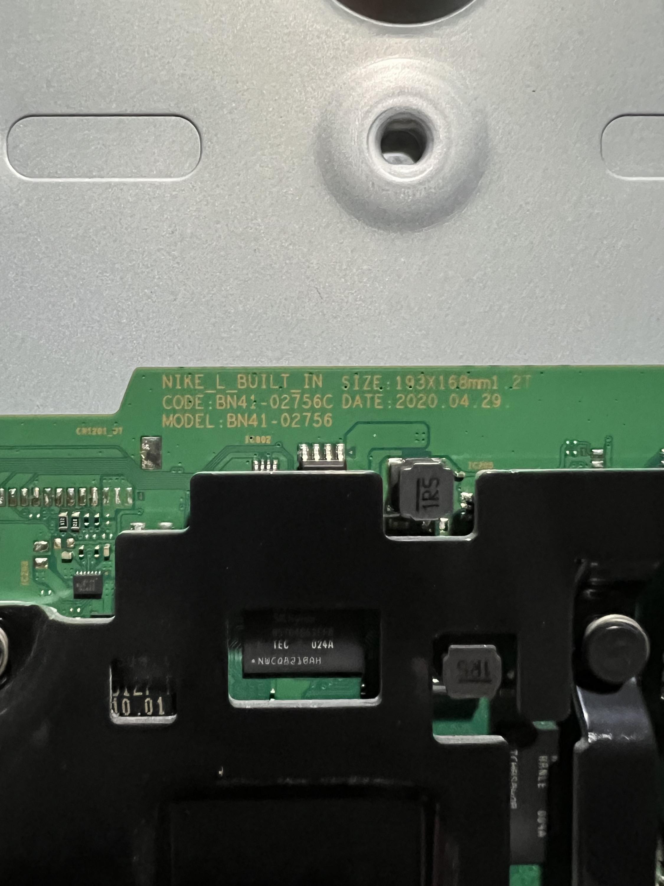

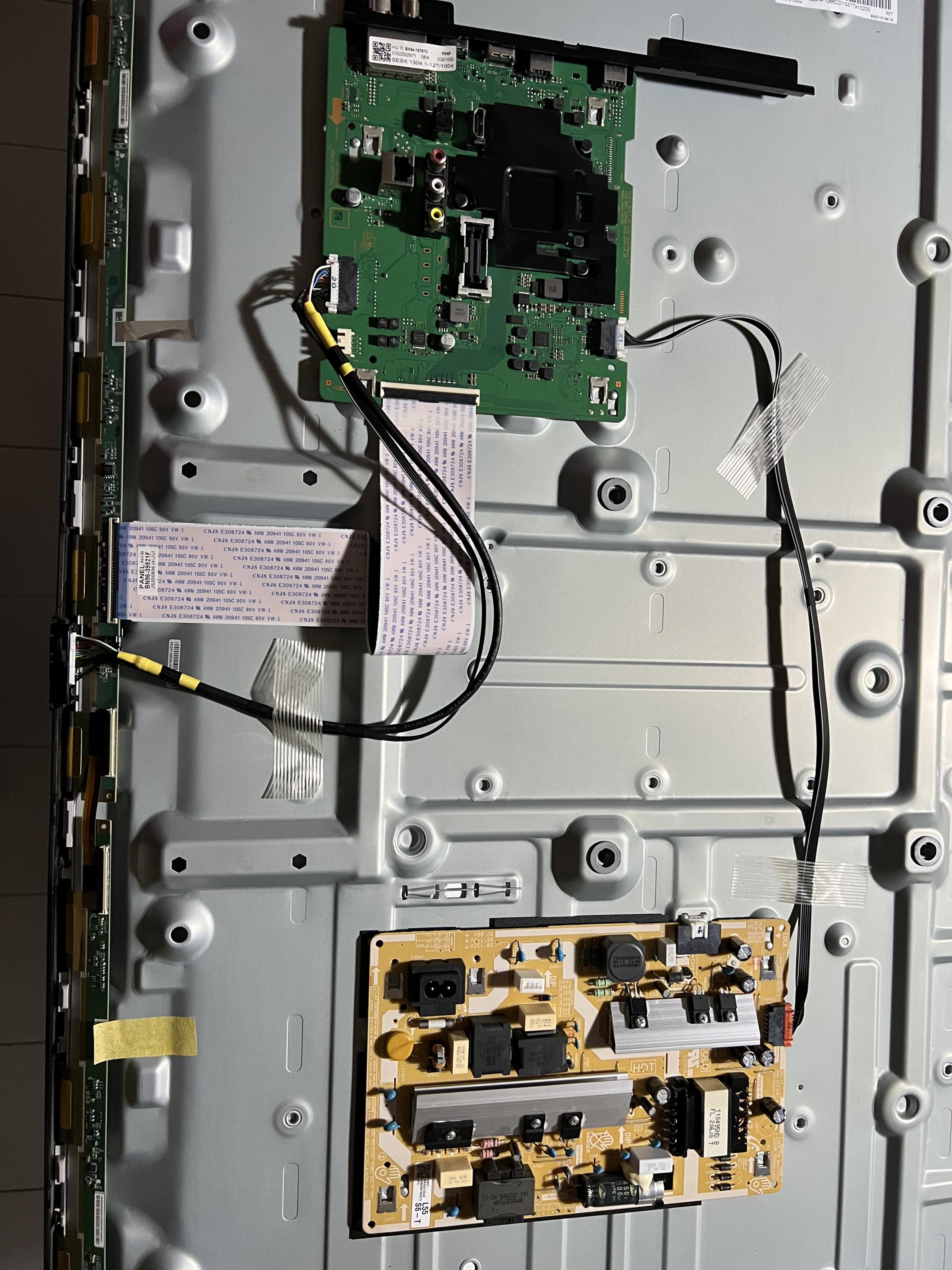

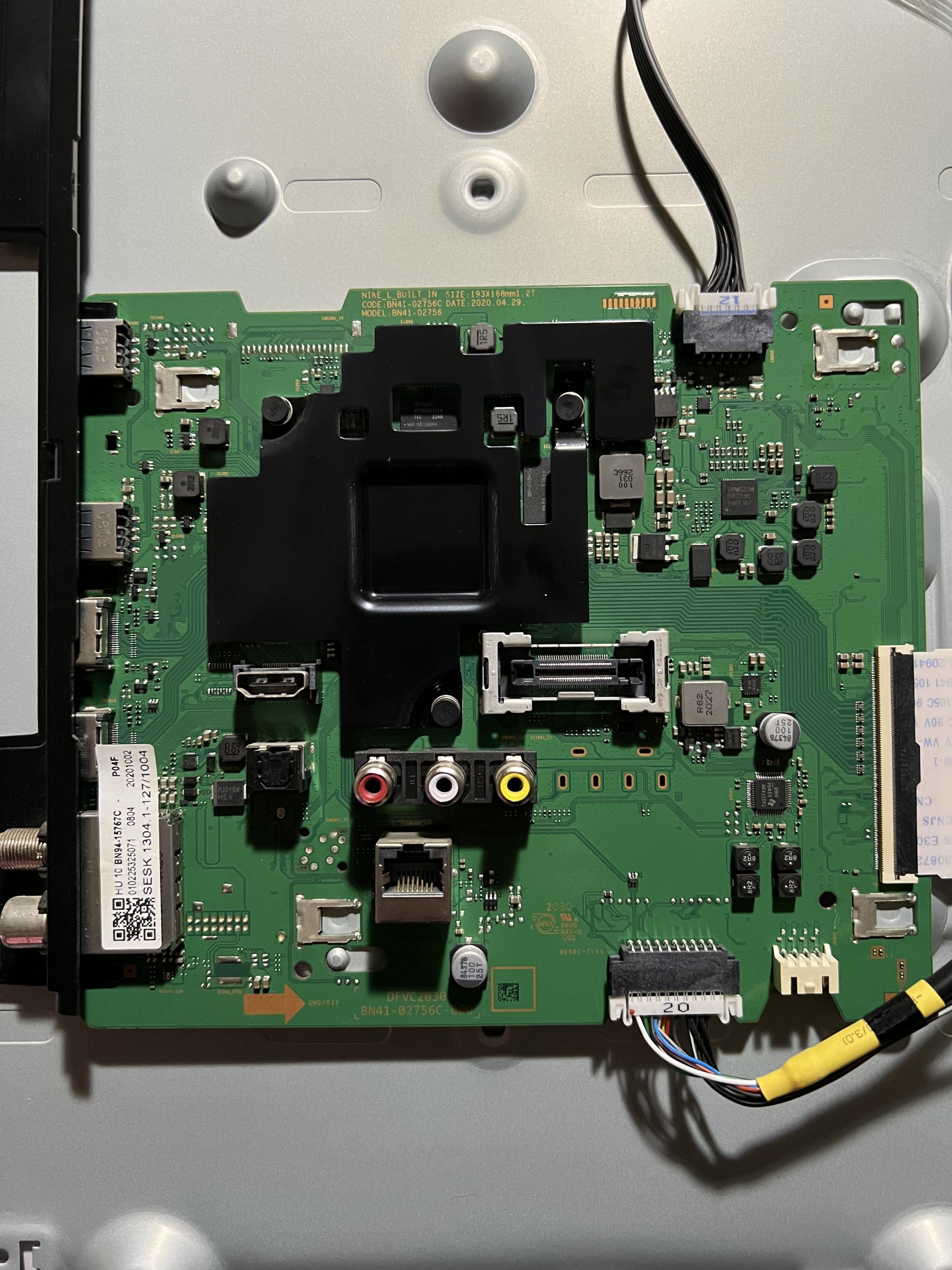

    Hi guys I have a problem with this TV, once it is turned on it restarts continuously (only the backlight is present, no image), by disconnecting the flat of the display it remains on regularly, can I solve it with scotch tape? What slopes of the flat can I cover?

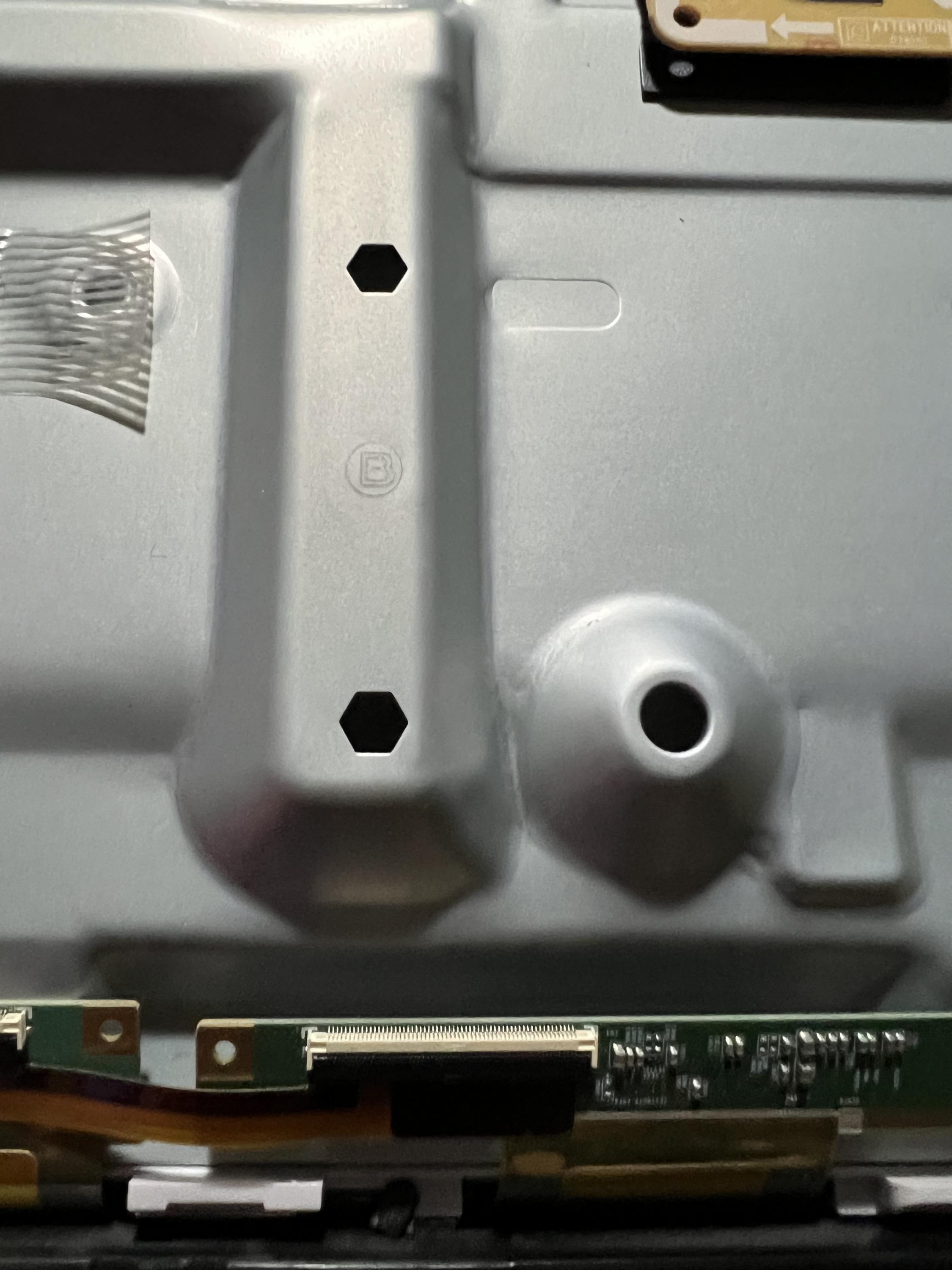

          the problem is only on the right cof, isolating 1 ckv signal you get an image but not acceptable, unfortunately the panel has to be thrown away, samsung rubbish

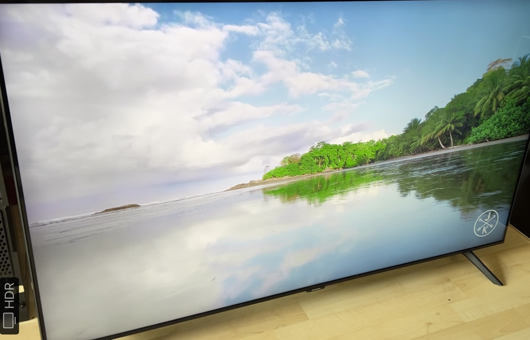

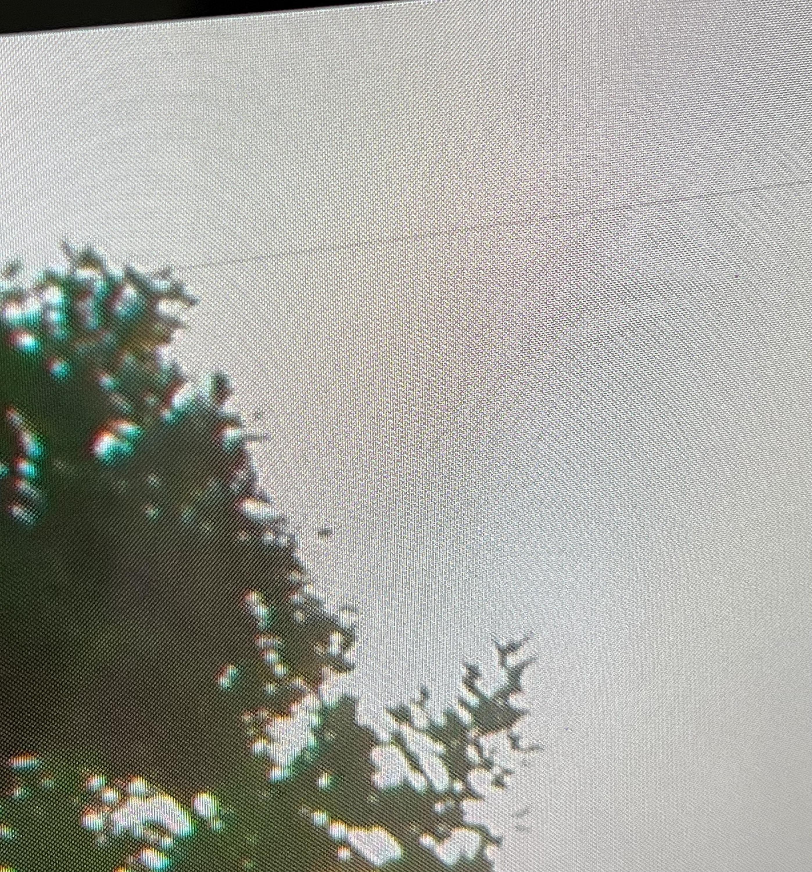

            With scotch tape, I think the lines next to it didn't make contact, I cut the pcb directly on the ckv signals of the right cof and I got an excellent result, there is only a thin line that comes out intermittently every 10 seconds
