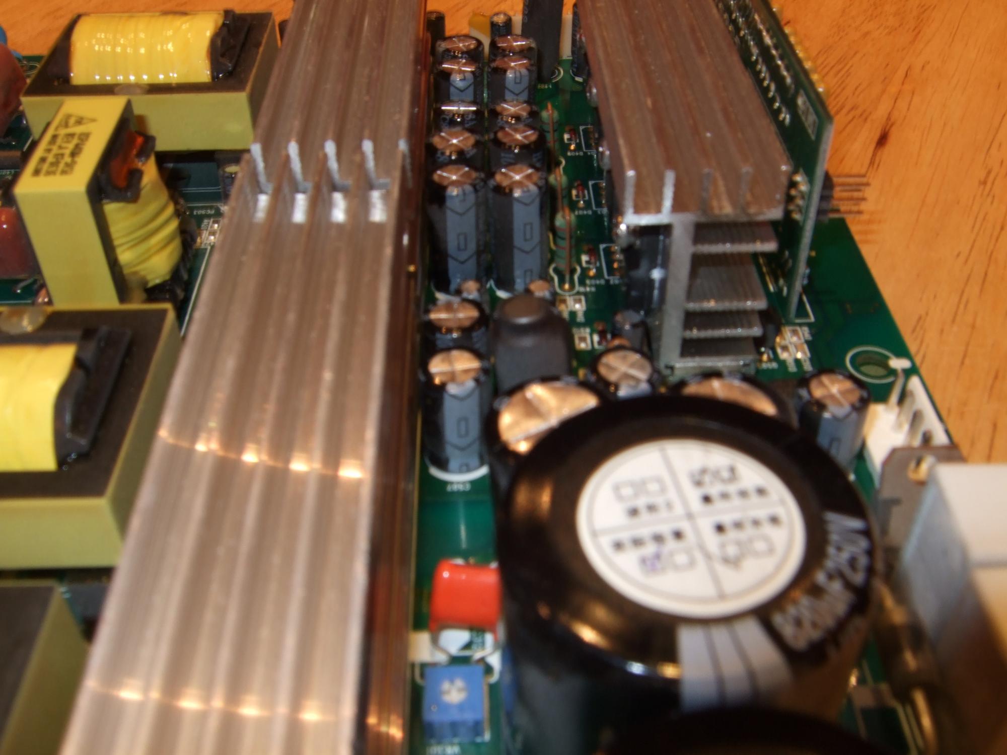

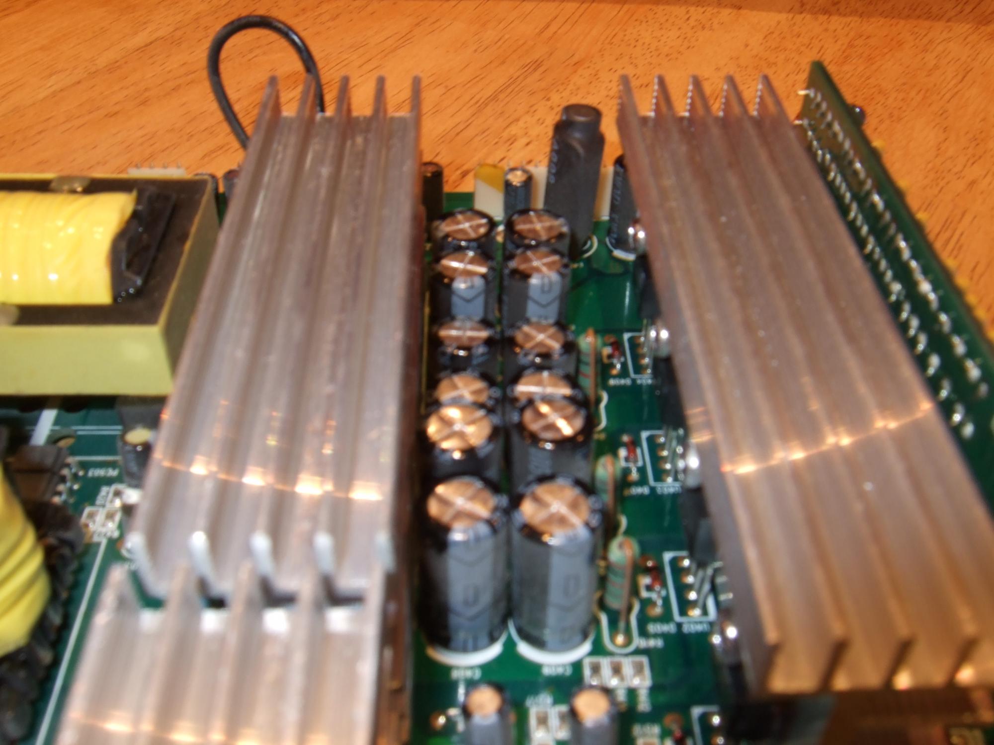

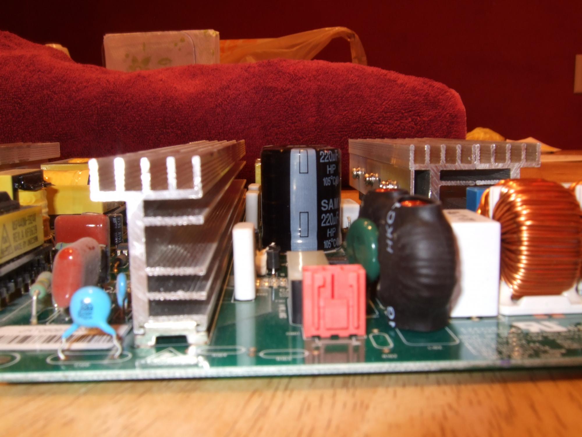

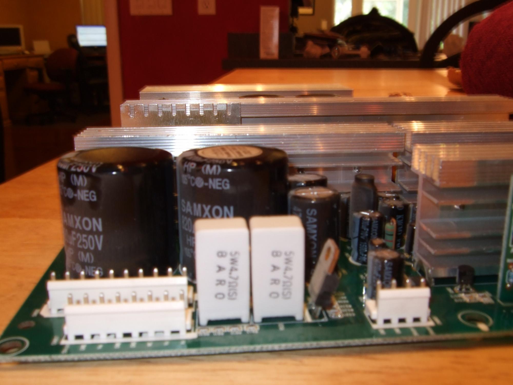

    I have a 42" Viore Plasma (PDP42V18HA), 4 years old. When I hit the power switch, I hear the power supply clicks, the screen gets slightly brighter but it does not turn on, the LED goes green. Then it either turns off immediately or After about 4 minutes it turns off (LED out). I unplug it and try again. After a 2-3 cycles of this, and waiting the 4 minutes, it will power on and work perfectly fine. I took the back off and looked at the power supply, didn't see anything obvious. I looked at all the other visible boards, nothing obvious. I was tempted to replace the power supply but wasn't sure if a control board could create the same problem. Based on my symptoms, can anyone say if the power supply is my likely source?? Bulging caps: When caps bulge, is it significant and obvious or subtle for the trained eye??

    It depends on your definition of 'obvious'. Some months back a gentleman was having problems with a monitor. 'The caps look perfect' according to him. After several posts that produced stranger and stranger information I suggested he attach a picture of the board in question. It wasn't a very good picture, but I quickly identified nearly a half-dozen caps with bulging tops. Replacing them solved his problem.
    While I would NEVER suggest you are as undiscerning as that gentleman, read the links in my signature and attach a picture of the power supply.

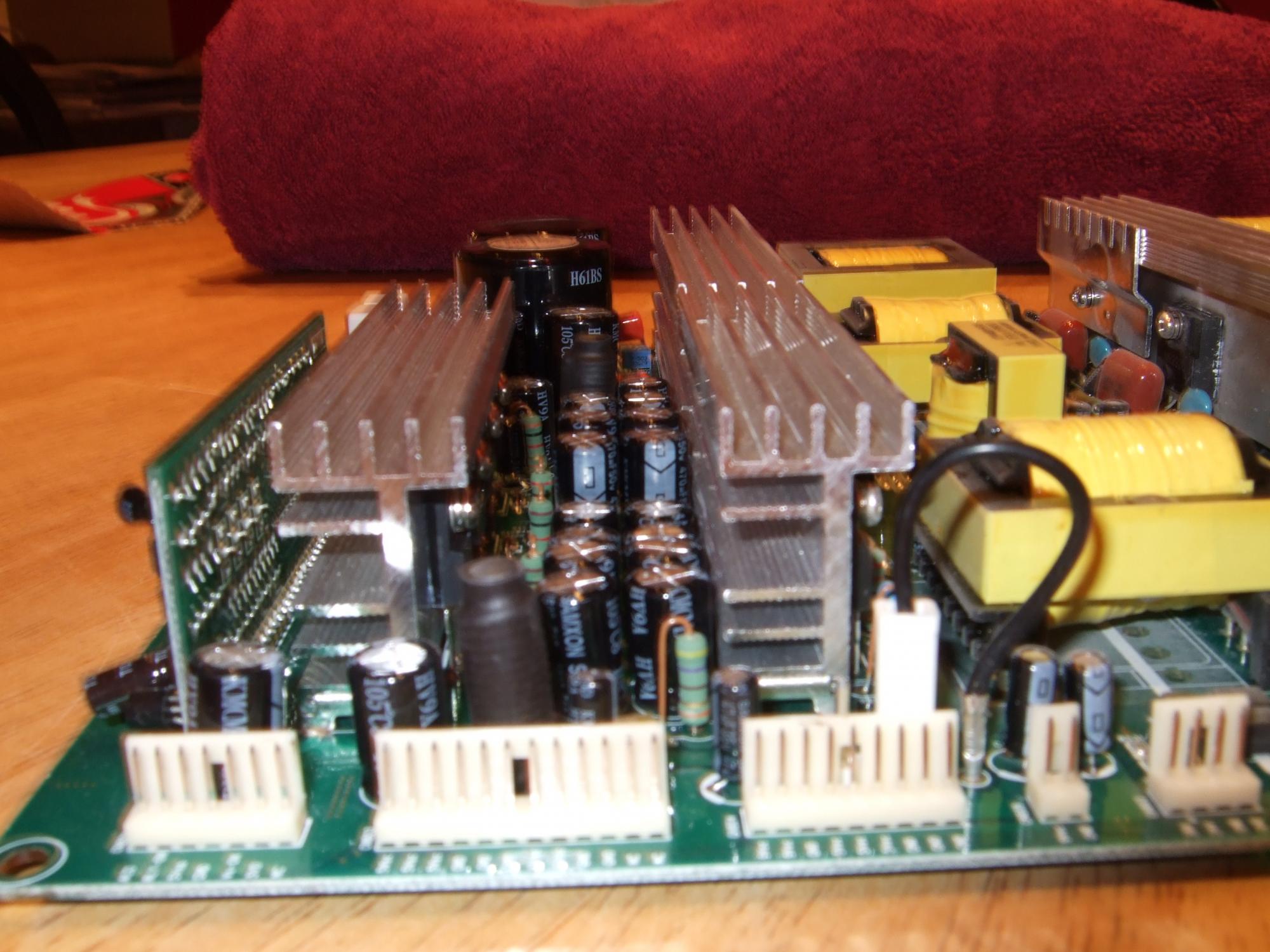

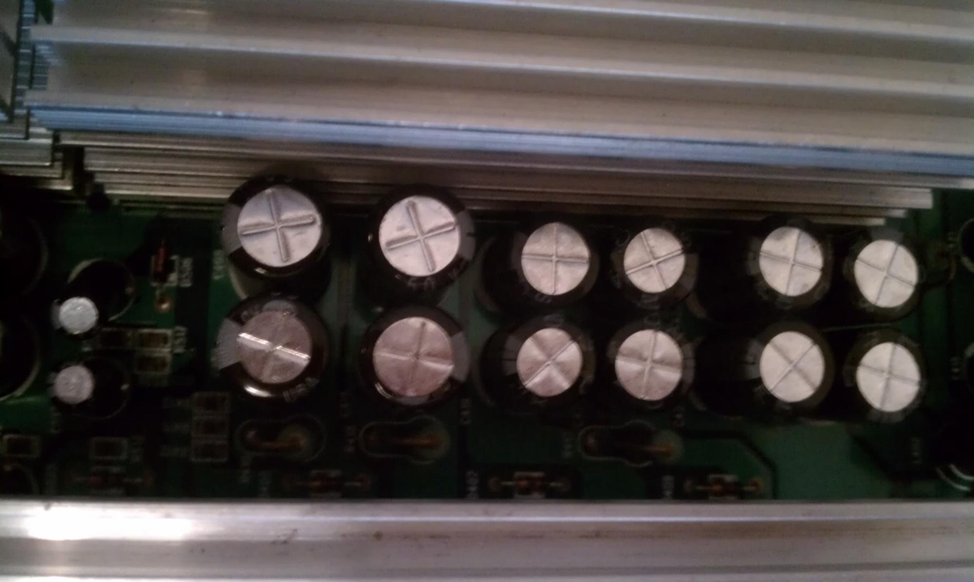

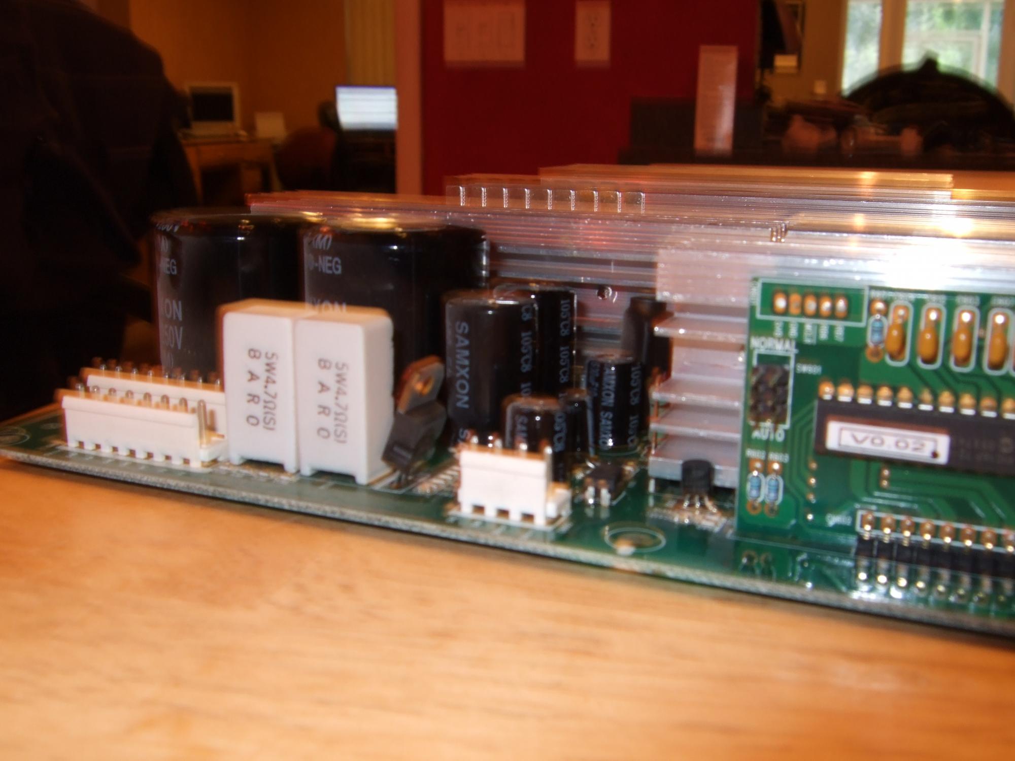

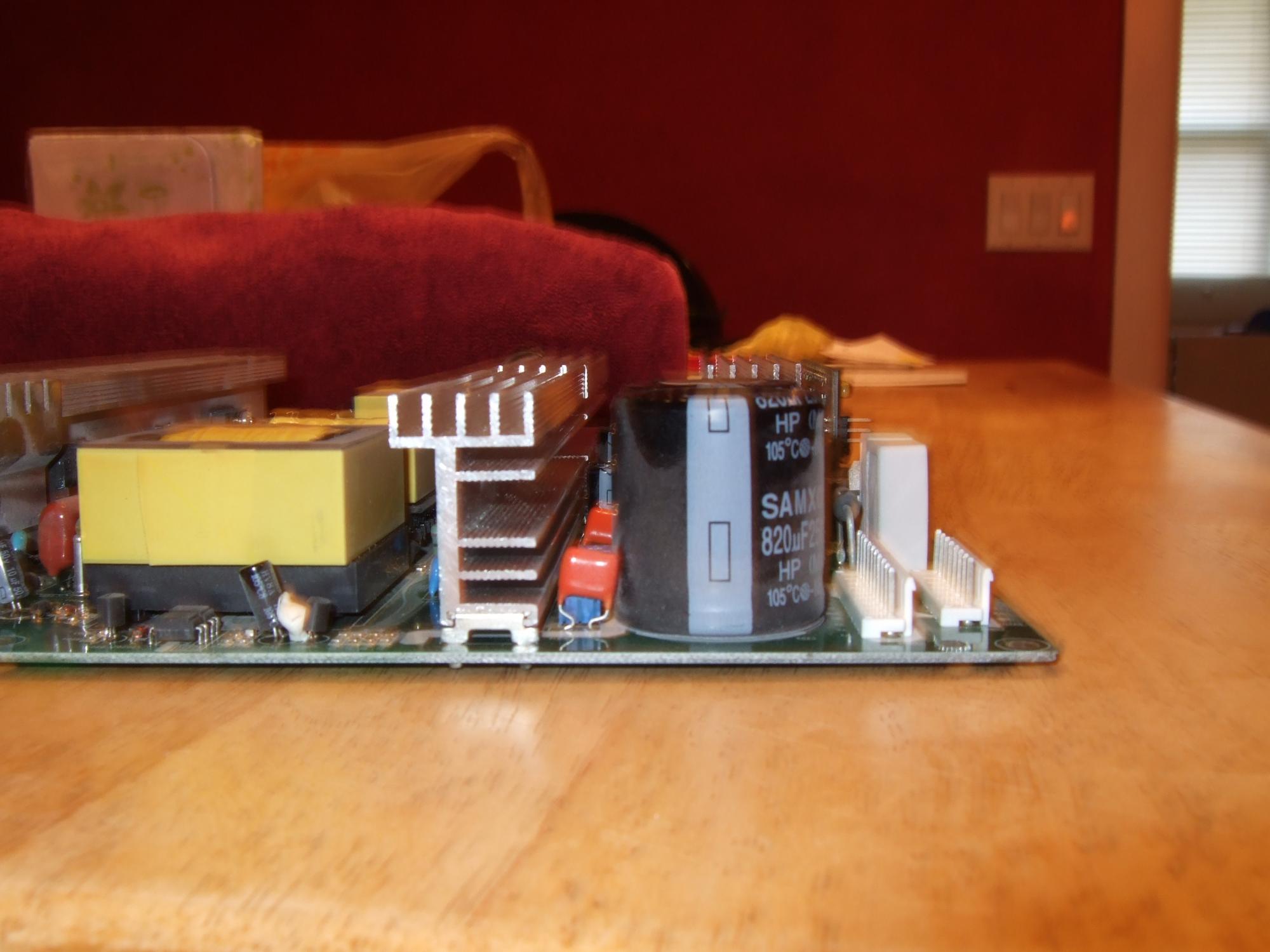

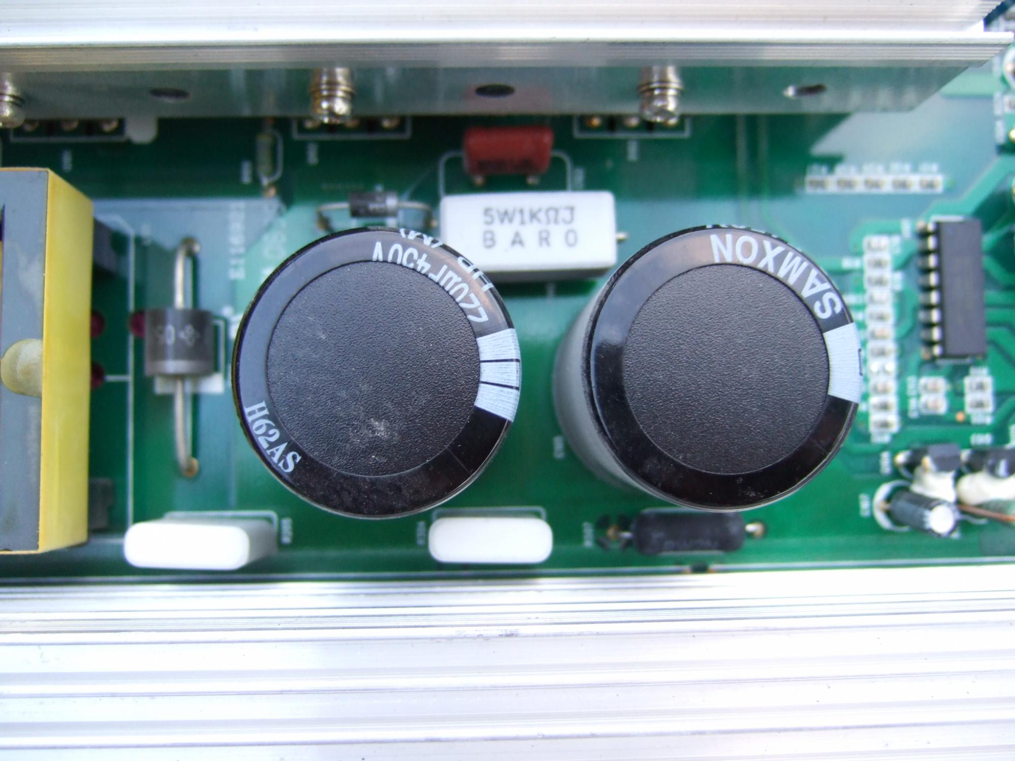

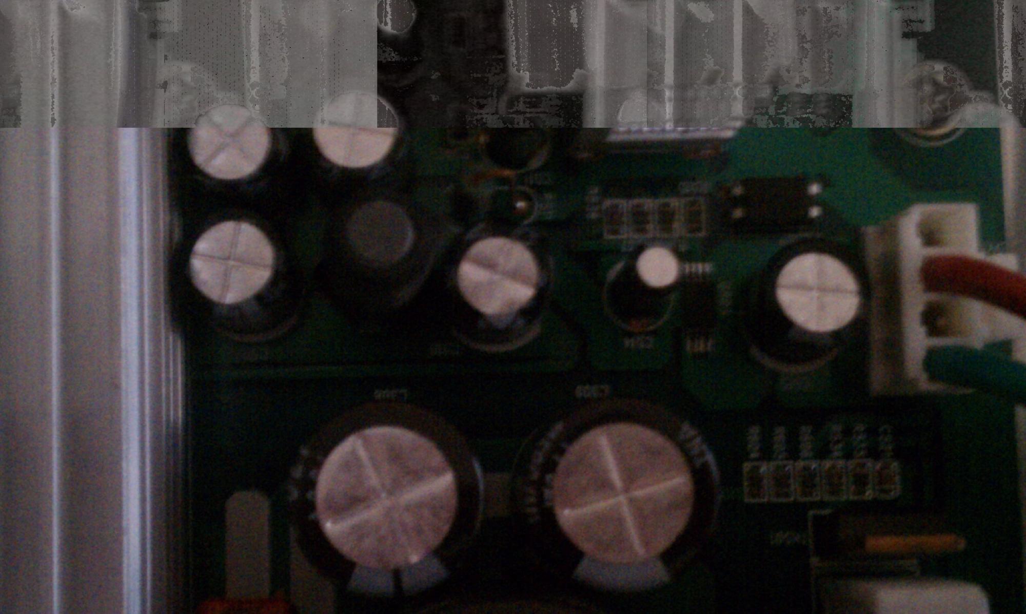

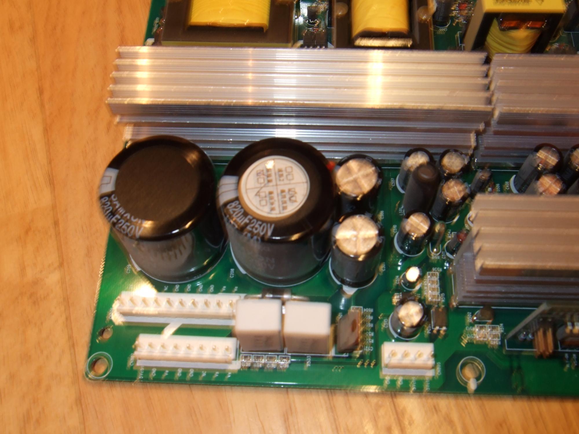

      Re: Intermittant power on - 42" Viore plasma
      Pictures of power supply
      • Stevedak
        • Sep 2010
        • 5

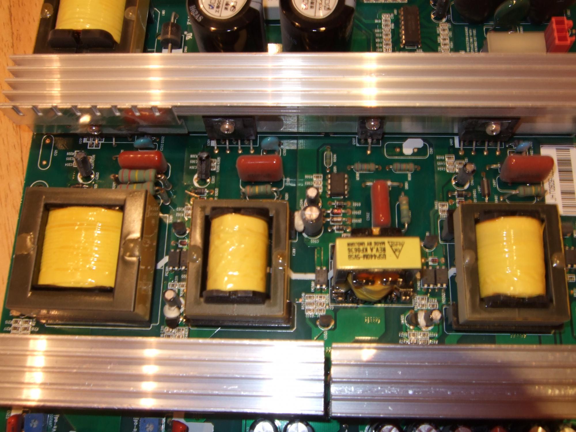

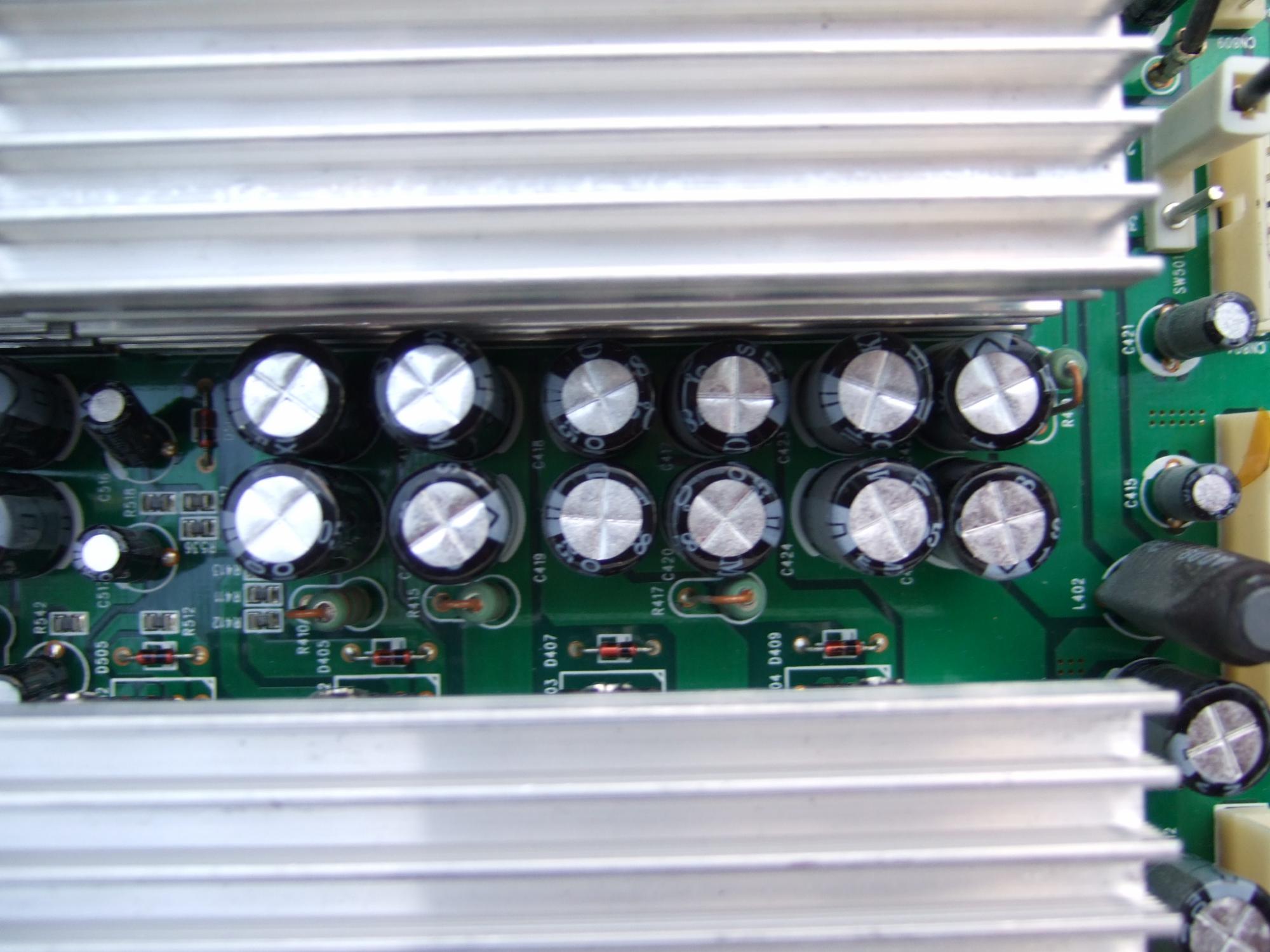

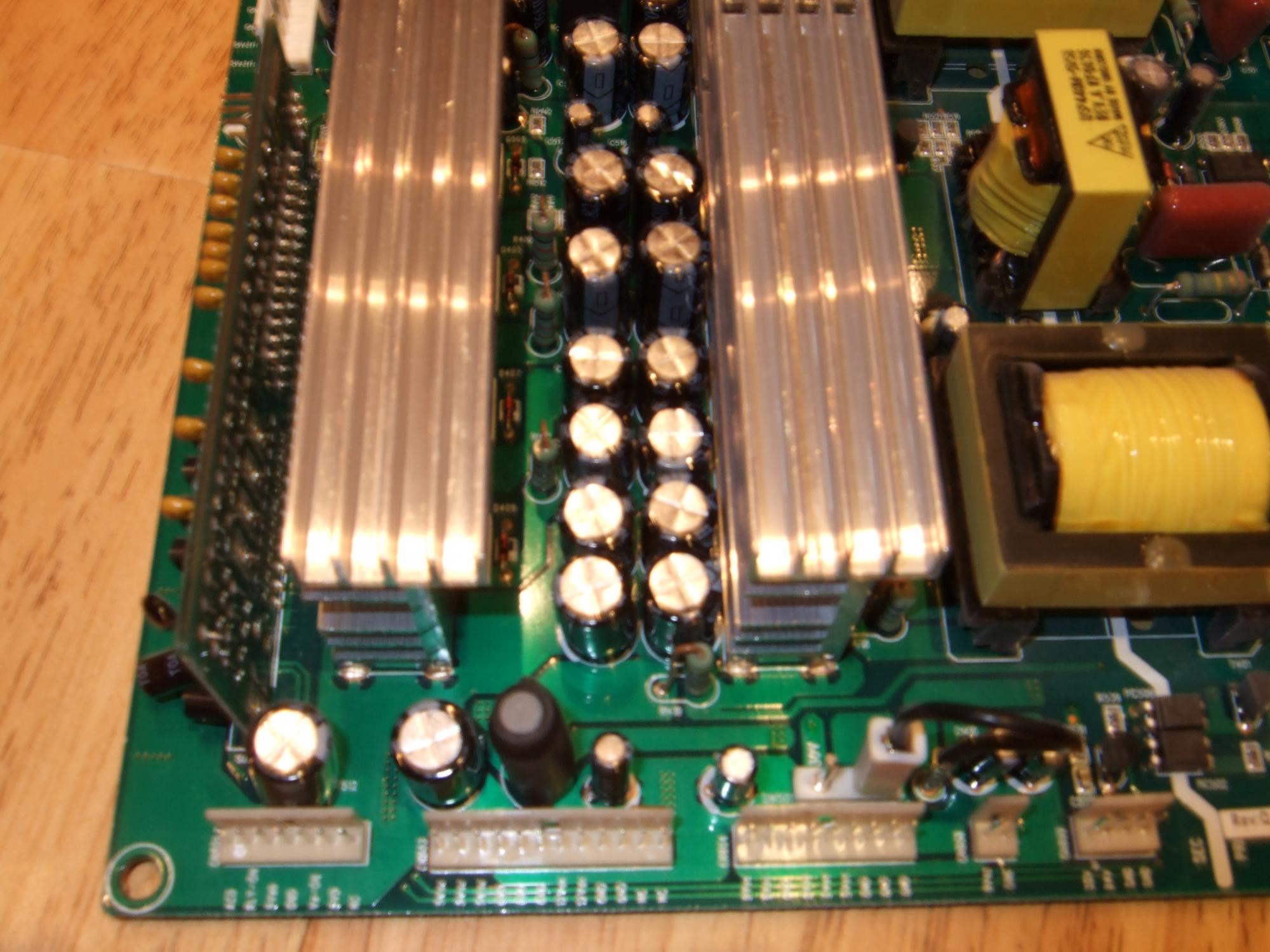

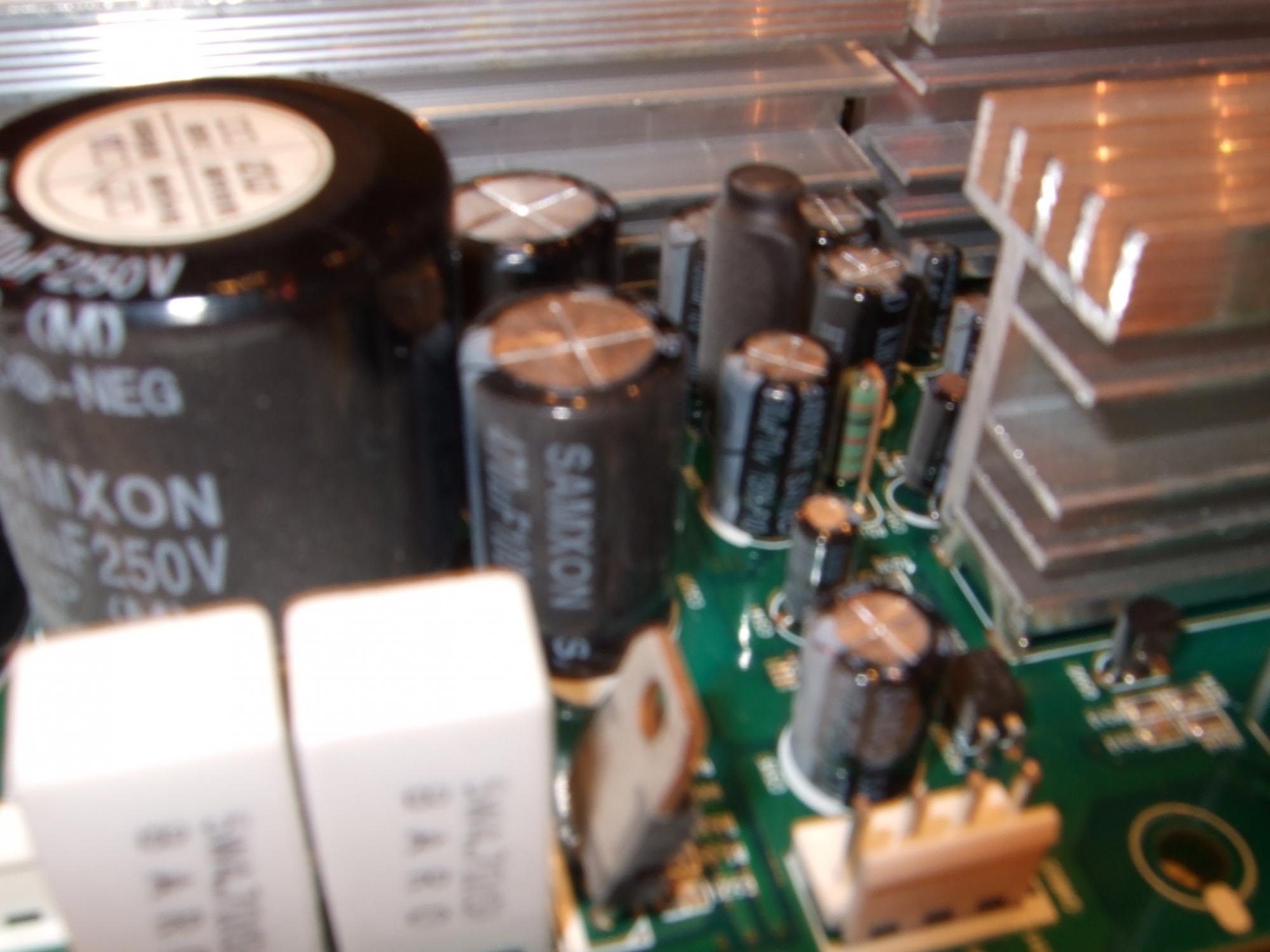

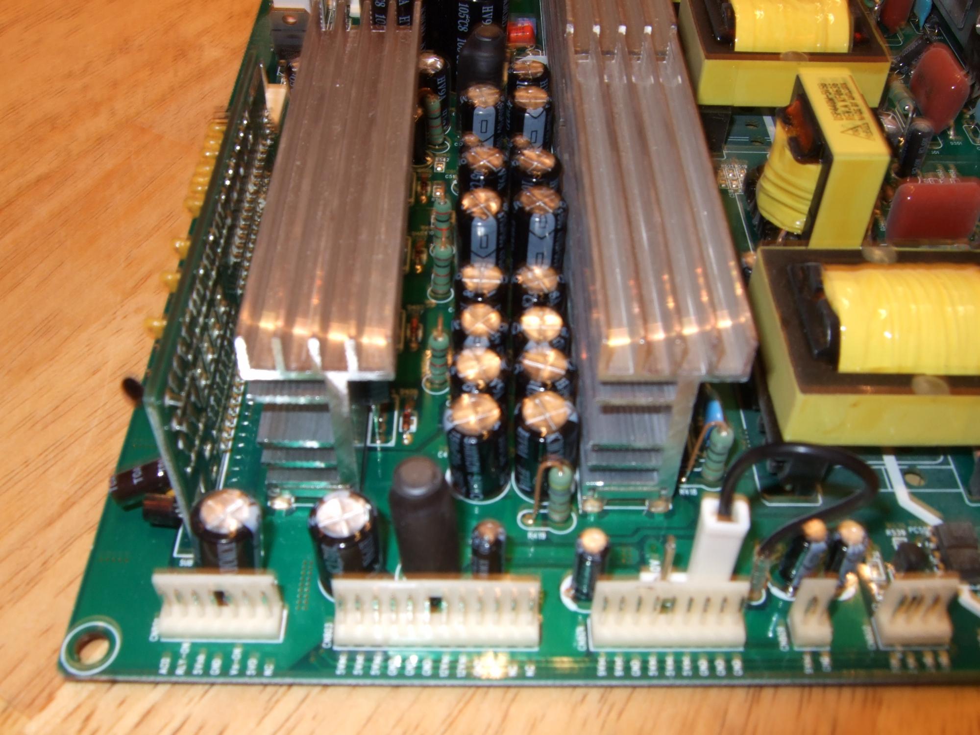

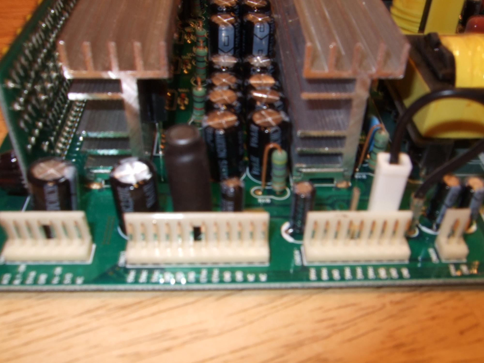

        More power supply pics.

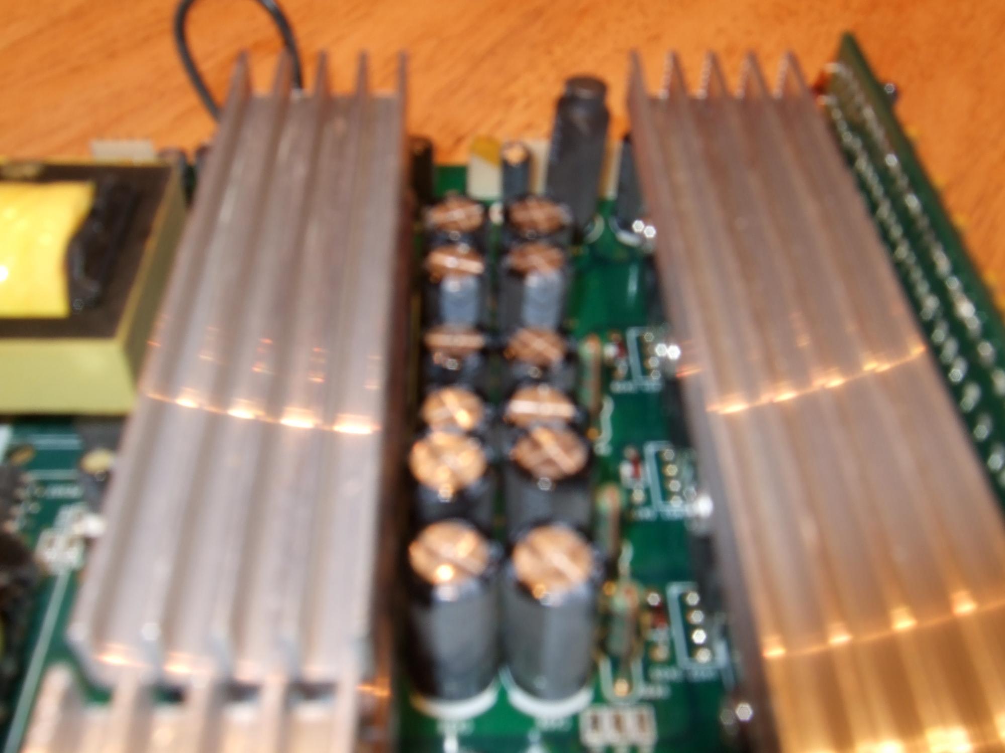

          Most of your pics are blurry, but from what I can tell the caps look okay. That doesn't mean anything though.
          If PlainBill asks for more photos, for best picture quality and clarity take your boards to a window on a sunny day, turn flash off, and use macro mode. Take a top down view of all your boards (front and back). Make sure the photo is legible so that we can read the PCB printing clearly. A shutter speed of 1/125 or faster will produce nice clear focused pictures. Try to get a photo that is 2000x2000 resolution or as close as possible.
            Usually I prefer one good clear picture over many blurry ones. From what I can tell, there are no obvious bulging caps. The one on the corner of the first picture in the second group looks like there might be a slight bulge.
            As retiredcaps suggested, I'd like a single picture from directly overhead with resolution of as close to 2000 x 2000 as possible. Under those conditions any bulging is very obvious.
            One problem is some manufacturers have mastered the technique of building caps that fail without visible evidence. Another problem is there are additional supplies on some of the other boards which can also cause problems.

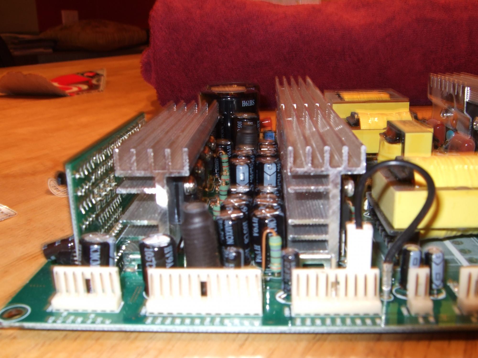

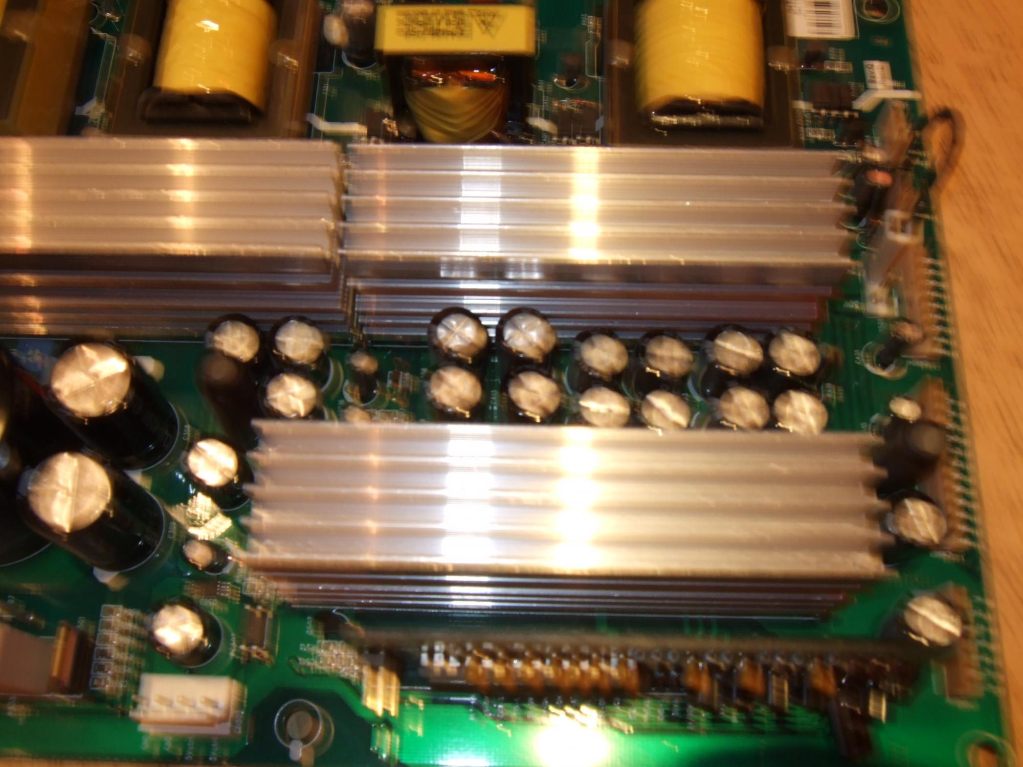

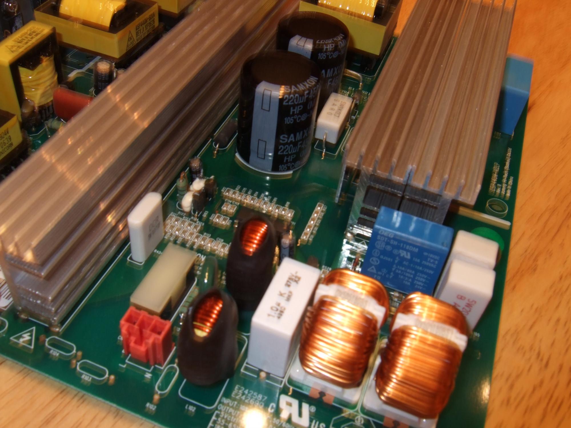

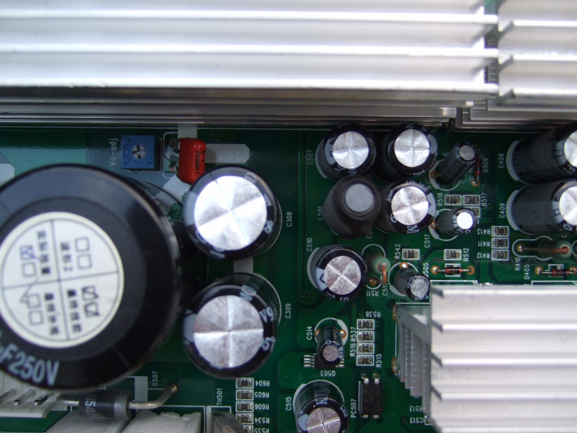

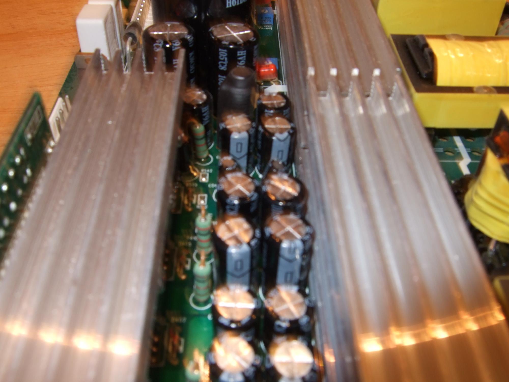

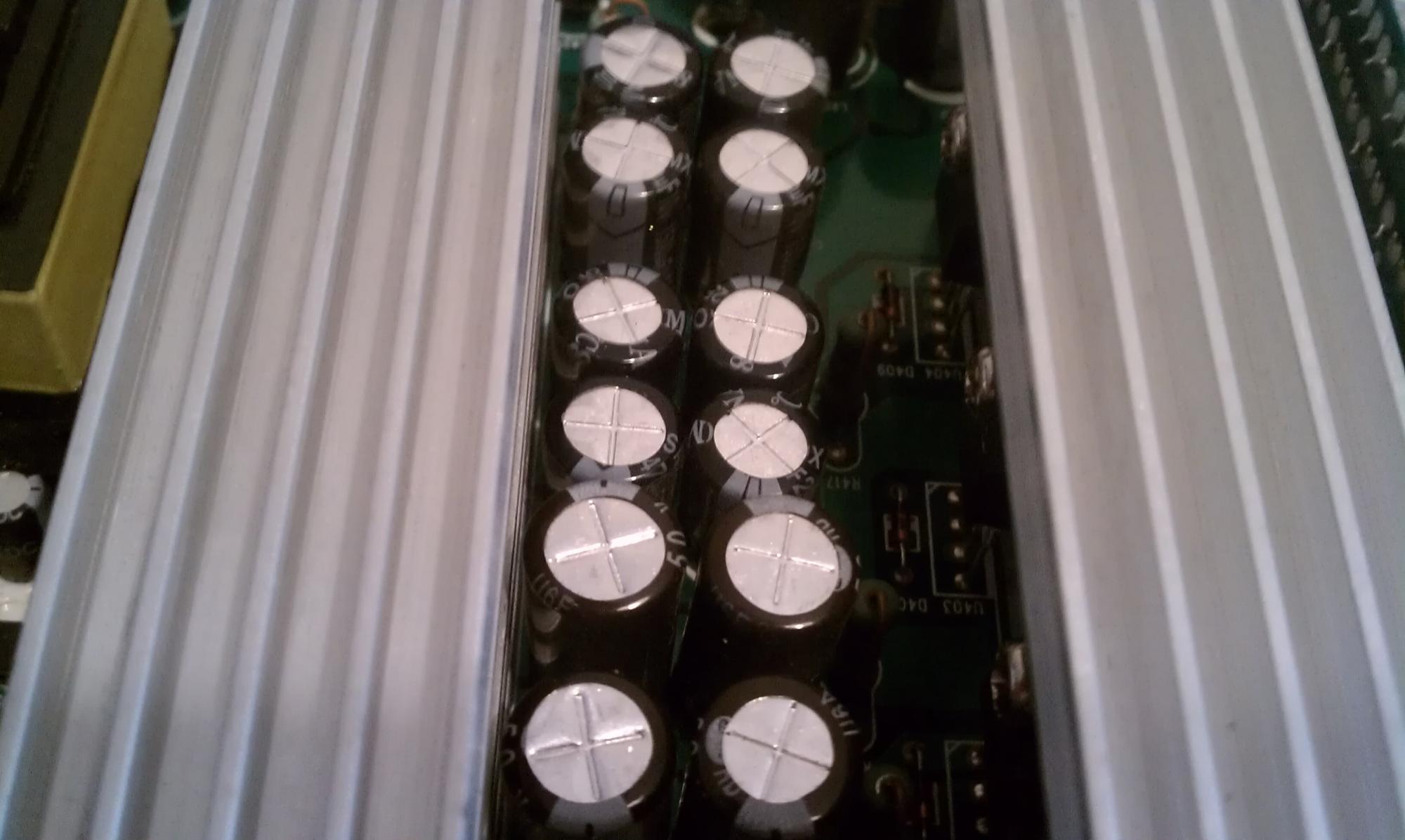

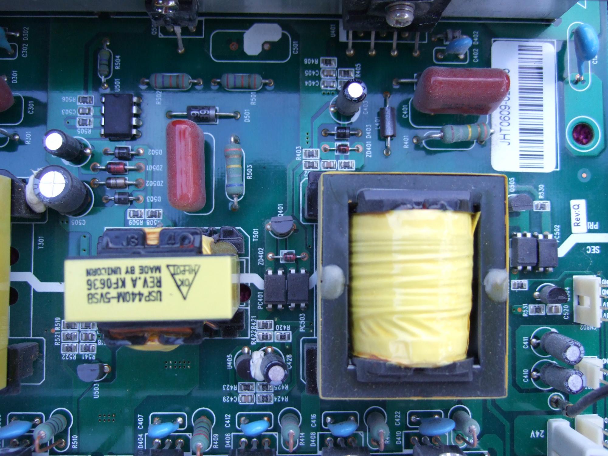

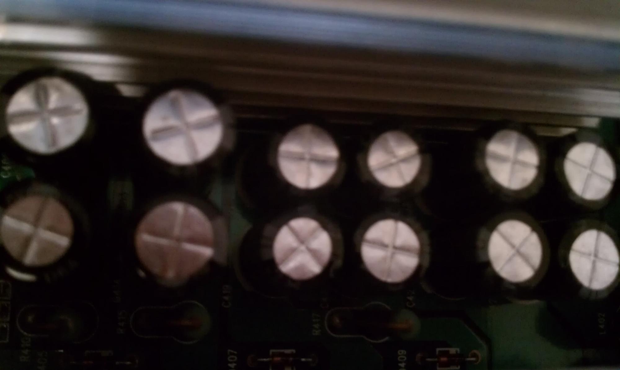

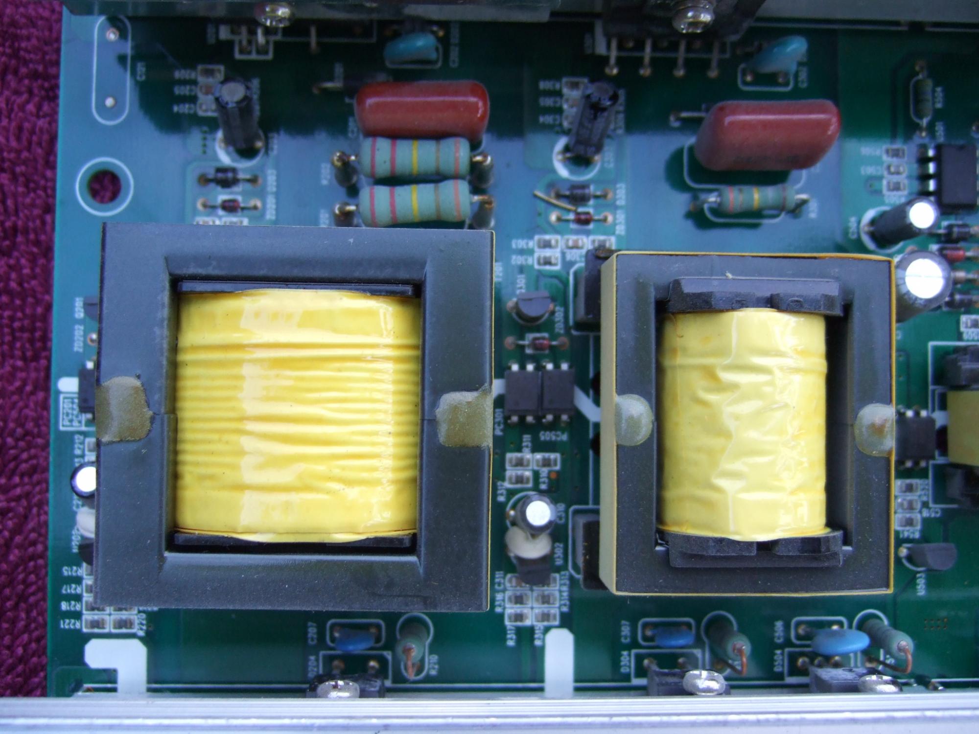

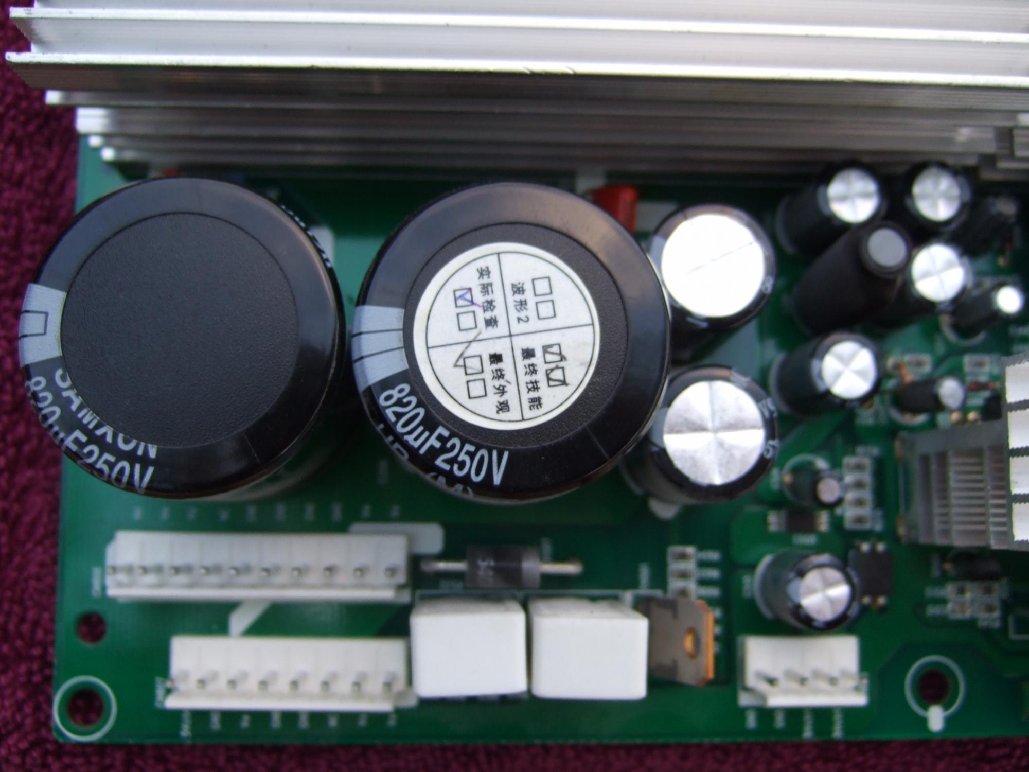

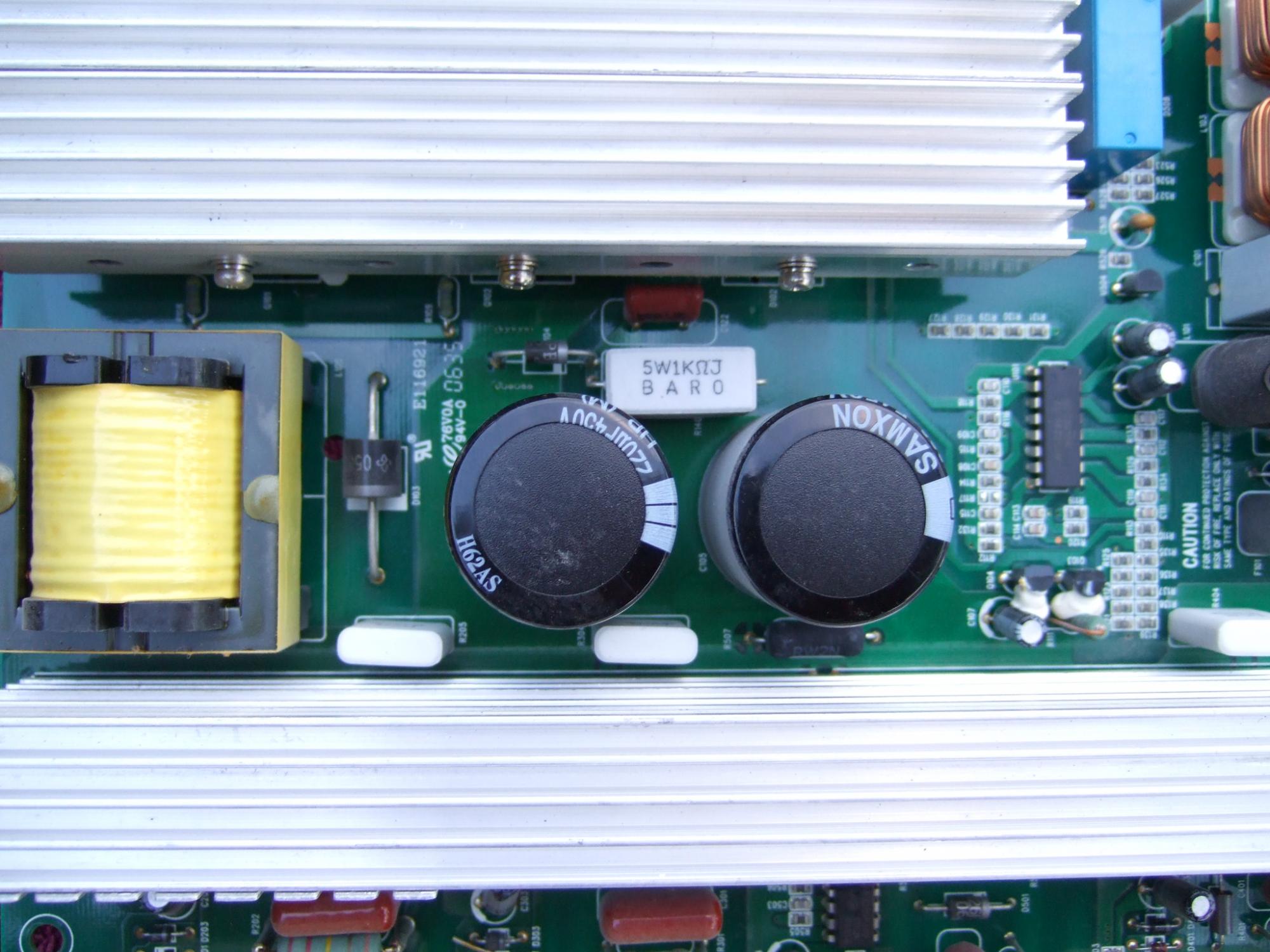

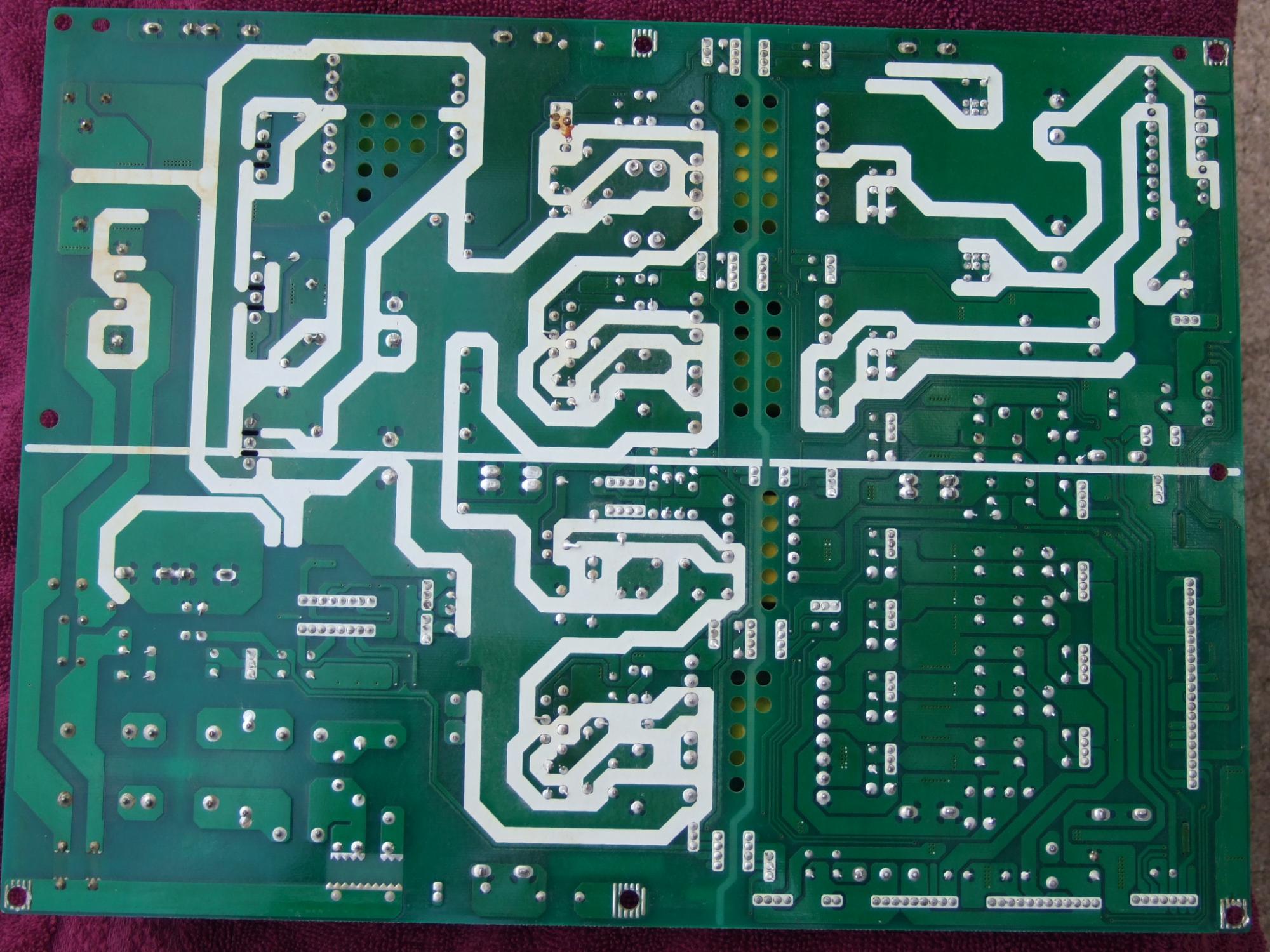

              These pictures should be clearer. On the back side of the board, there is a dark spot at a solder joint. The component is an amp, mounted to a heat sink. can't see the part number of the amp. THe power supply number is USP440M-42LP
              • Stevedak
                • Sep 2010
                • 5
                THe picture of the back of the board shows a dark spot at some solder joints. The soldered component isn't an amp, it is a MR5060.
