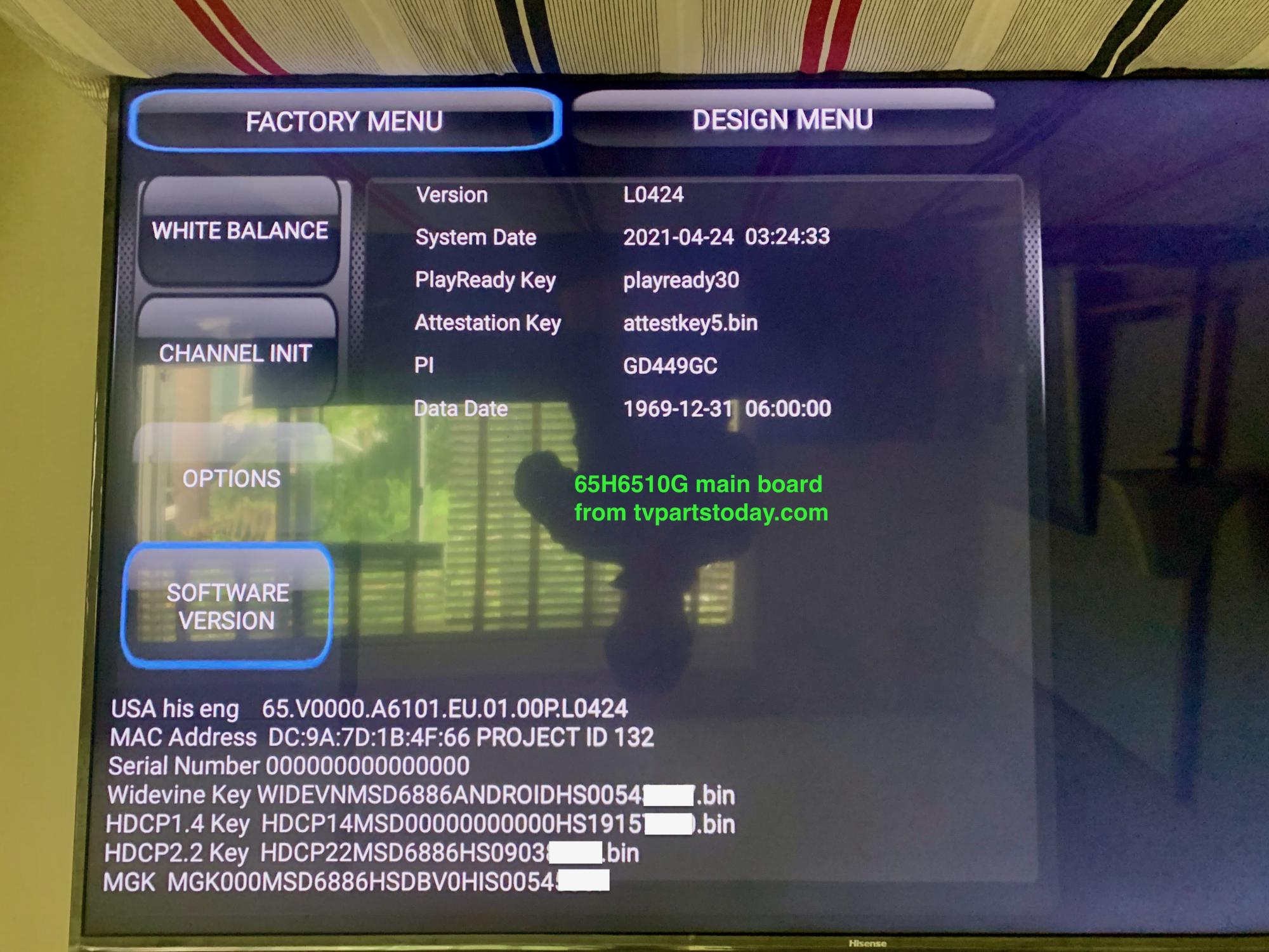

                          Resurrecting this tread on a dead eMMC...
                          TV fixed with replacement board
                          Bought a main board from TVPartsToday for $52+$17 ship and TV booted up working. These boards are rare (Seems most Android TV boards are rare and expensive). Probably something about these Android (version 9) TVs thats killing the eMMC.
                          The purchased TV board may have eMMC replaced? (SN = 000000000000000) see pic
                          Comparing KEYs
                          Just repaired a HiSense 75H6570G with failed backlight. Both TVs are the same MSD6886 SOC/Chassis and generally similar main board design. Compared the KEYs between the 75 and the repaired 65 with replaced main board.
                          - Widevine, HDCP1.4, HDCP2.2, Attestation keys are all *.bin (Is this the key or actual key in a bin file in firmware?)
                          - What is MGK?
                          - Widevine, HDCP1.4, HDCP2.2, Attestation, MGK, and Netflix are all different between the 2 TVs
                          - Only key that is same is playstore key ( playready30 )
                          - Are there other keys I should retrieve/compare?
                          - Firmware version (listed in USA his eng) are identical to hisense support website firmware downloads file names (after entering SN) for both TVs
                          Like to Repair the eMMC of the failed board
                          Since I have working replacement main board. Like to repair the failed eMMC board if possible. Are these the basic steps?
                          - Freeze failed eMMC (or ISP) to recovery keys if possible
                          - Extract mboot from good board and program failed board with new eMMC (ISP with sufficient 3.3v current after soldering okay?)?
                          - Service manual does have a section on TV board without mboot (p38) but doesn't tell what to do other than remove UART connection. I doubt can install USB firmware without mboot.
                          - USB update firmware after mboot installed
                          - Reinstall keys
                          Is this understanding correct? Since my replacement board has no SN, it might be repaired so it seems repair process is possible if know the recipe.
                          Pics
                          Blocked out a few digits on the keys for security. But everything except Playstore key is different. I don't know if just because different TVs. Maybe the same models are the same keys? Can anyone confirm?
                          65H6510G Replacement Main Board
                          75H6570G Original Main Board
                          • Diah
                            • Feb 2013
                            • 6375
                            #113
                            Re: HiSense 65H6510G no boot
                            i mixed by my answer on other plat forum... both are Android.. the keys are not as i wrote before... they are .bin file burned and placed at the keys section at first of bootloader...
                            you just check if the replacement MB since no SN. if it had fixed LAN MAC address. or it change the MAC at each boot
