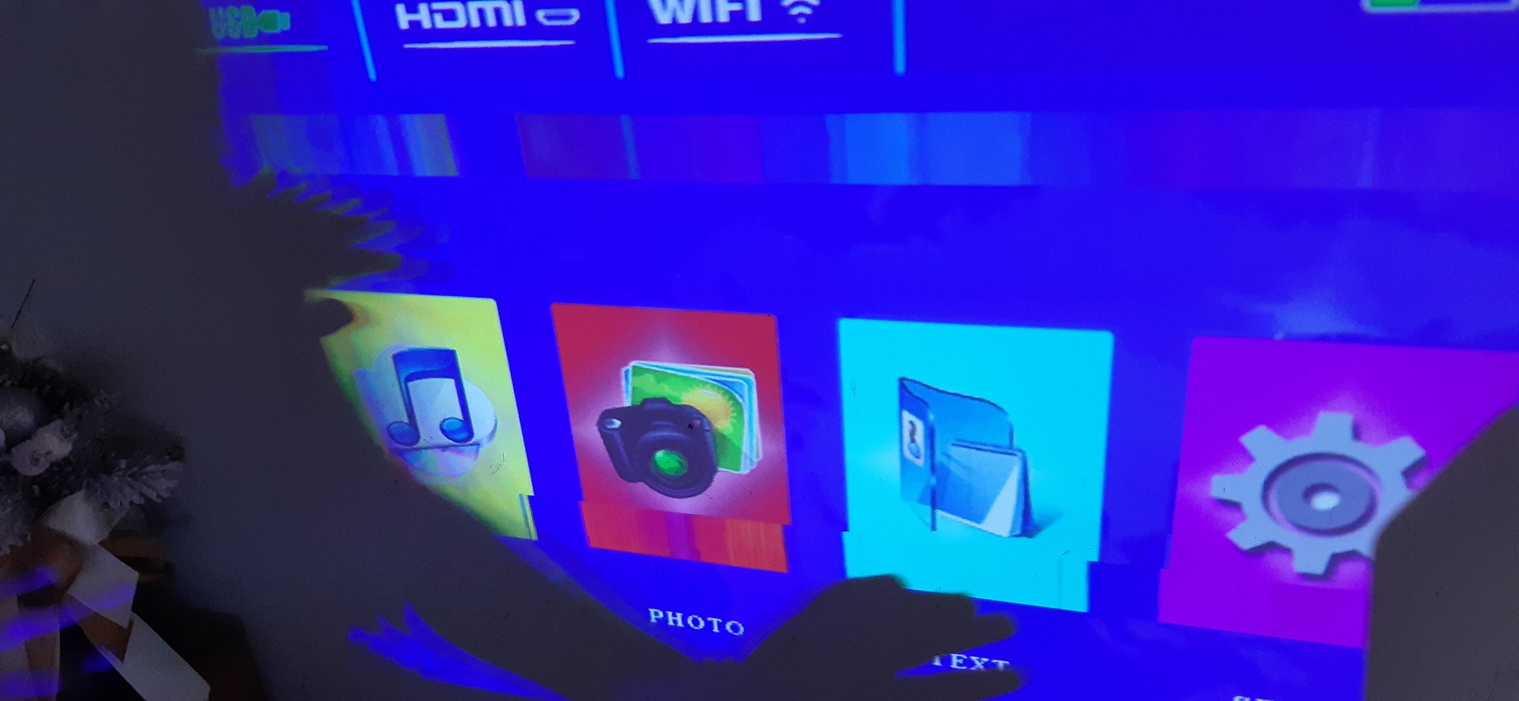

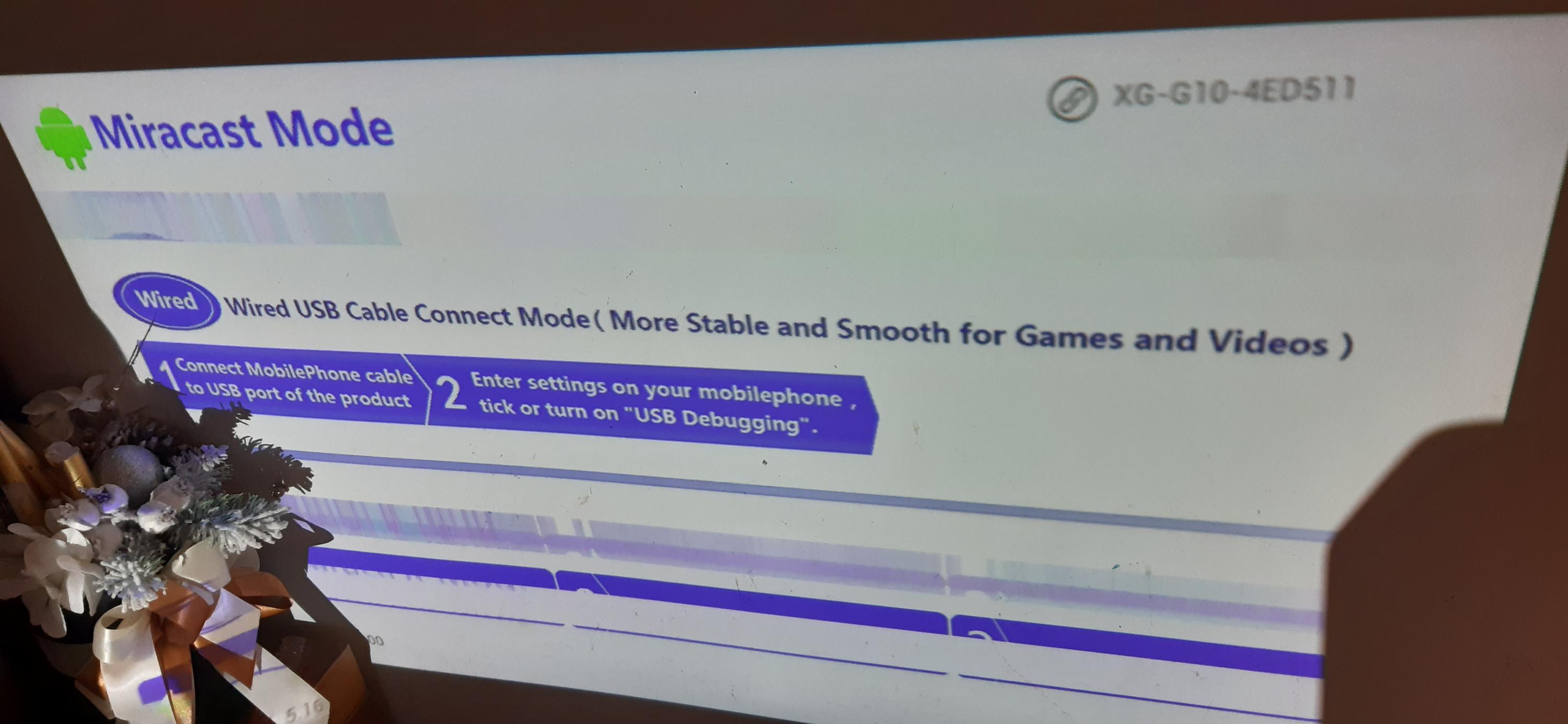

    P1 Mini pocket projector horizontal lines
    I found P1 Mini Pocket Projector in original box without remote on the street.
    Charged the battery and when powered on noticed 1, 2 or 3 distorted horizontal lines.
    I havent opened it yet, the warranty sticker in unbroken.
    I was wondering if anyone knows what the source of the problem could be, maybe a known issue. Take a look at the attachments.
    Thanks.
  • krsta
    • Nov 2020
    • 33
    • Croatia
    If anyone is interested the problem was in flat cable connector (it was loose) on the mother board.
