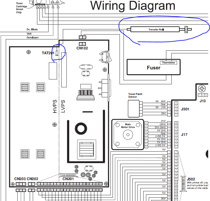

    Hi having issue with this printer when i turn it on i get
    Primary Error : Service Error ALL lights are blinking
    Secondary Error : 91x: DC motor or transfer roll ✷ ✷
    Service tertiary error codes: 917: Transfer roll circuity
    The Manual say to check the Continuity from the High Voltage Power Supply to the right side of the Transfer roll, which I've done and its good.
    beside that it doesn't tell me what else to do. I've check the voltage on the power supply at its really low like .4V does this appear to be a power supply issue? I've checked the transfer roll an it appears to be good moving freely
    The Power supply is a Delta edps-69ap

          Re: Lexmark E260DN Error
          that the funny thing is i don't think there is a motor according to the schematic for the wiring diagram it goes straight from TAT201 to the transfer roll
          i did get a reading on TAT201 and 0.4V
              So, the gear shown on the other end of the transfer roll indicates it is being driven by a motor.

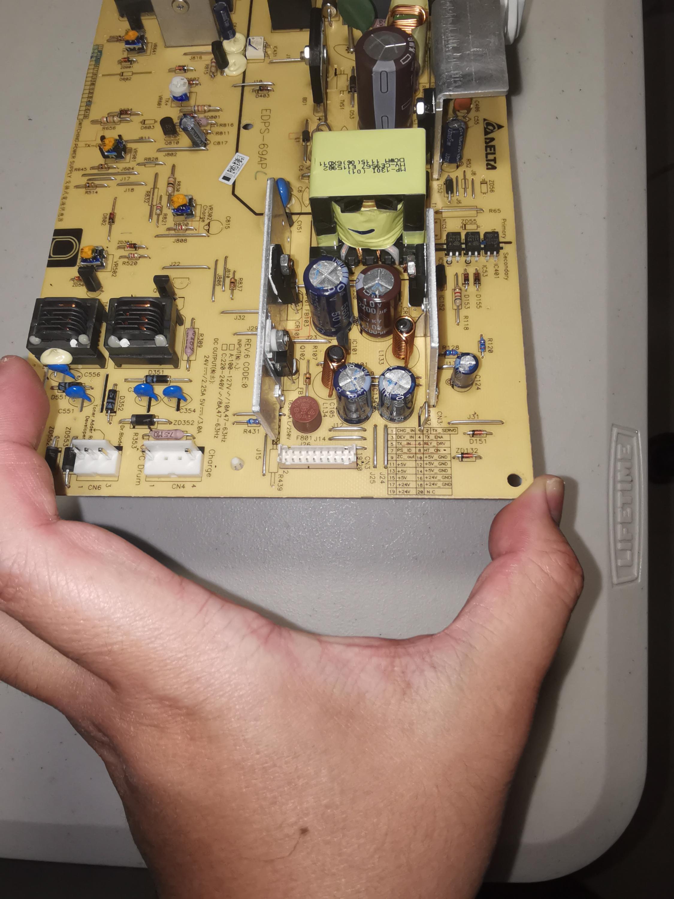

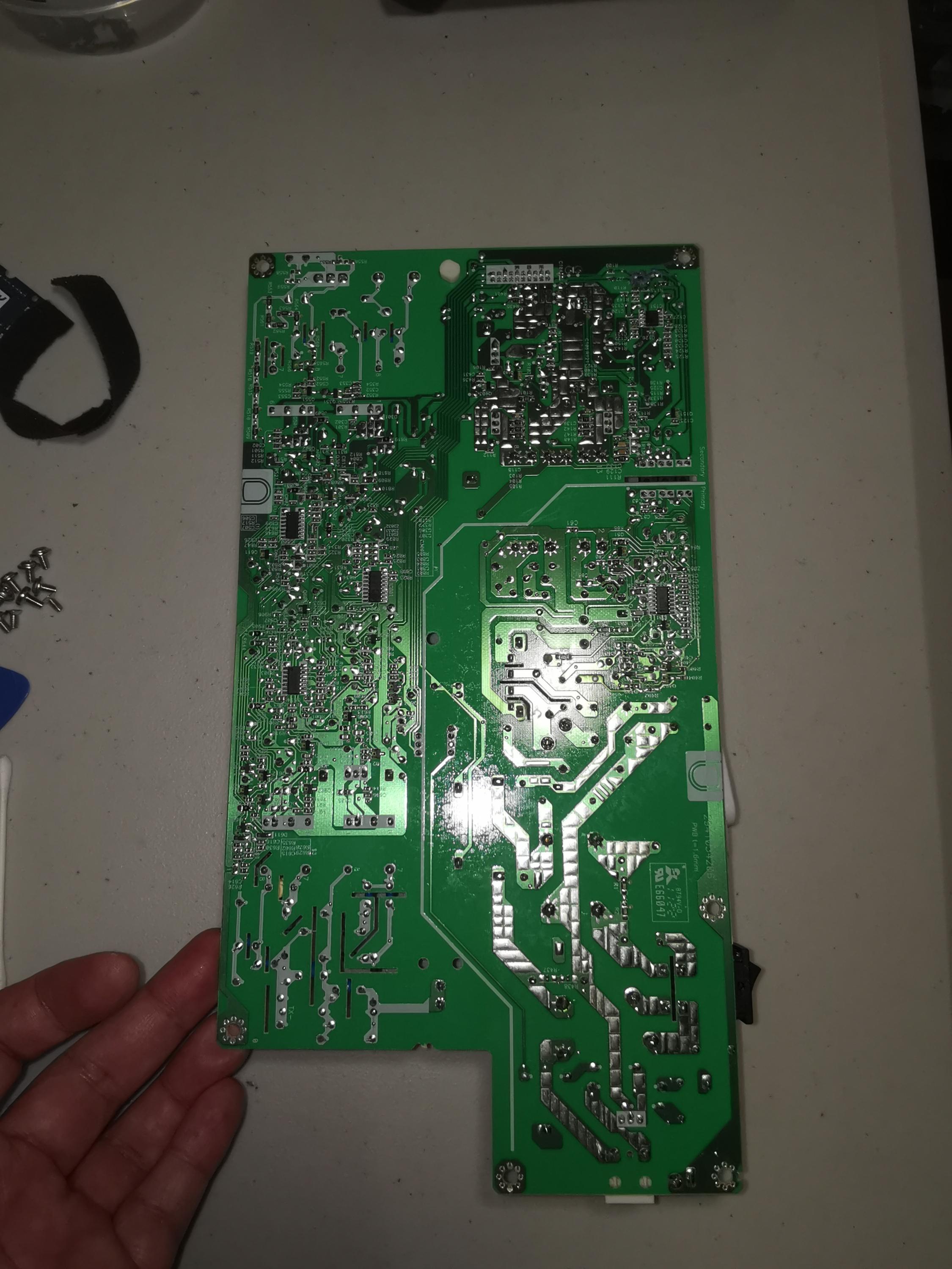

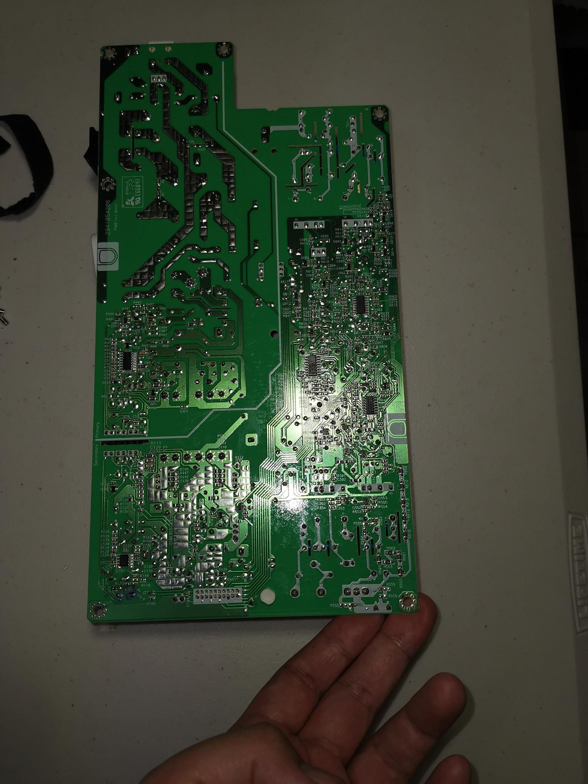

                    ok so i did the controller board service check and when it got to checking the lvps/hvps pin 4 is the only one that failed with a voltage of .6V I also did a dead machine service check which is test on the LVPS/HVPS side and Pin 2 voltage was in the mV range and Pin 4 was .6V so i think we might of found the problem.
                    Also Please see enclosed Pictures of the Power Supply.

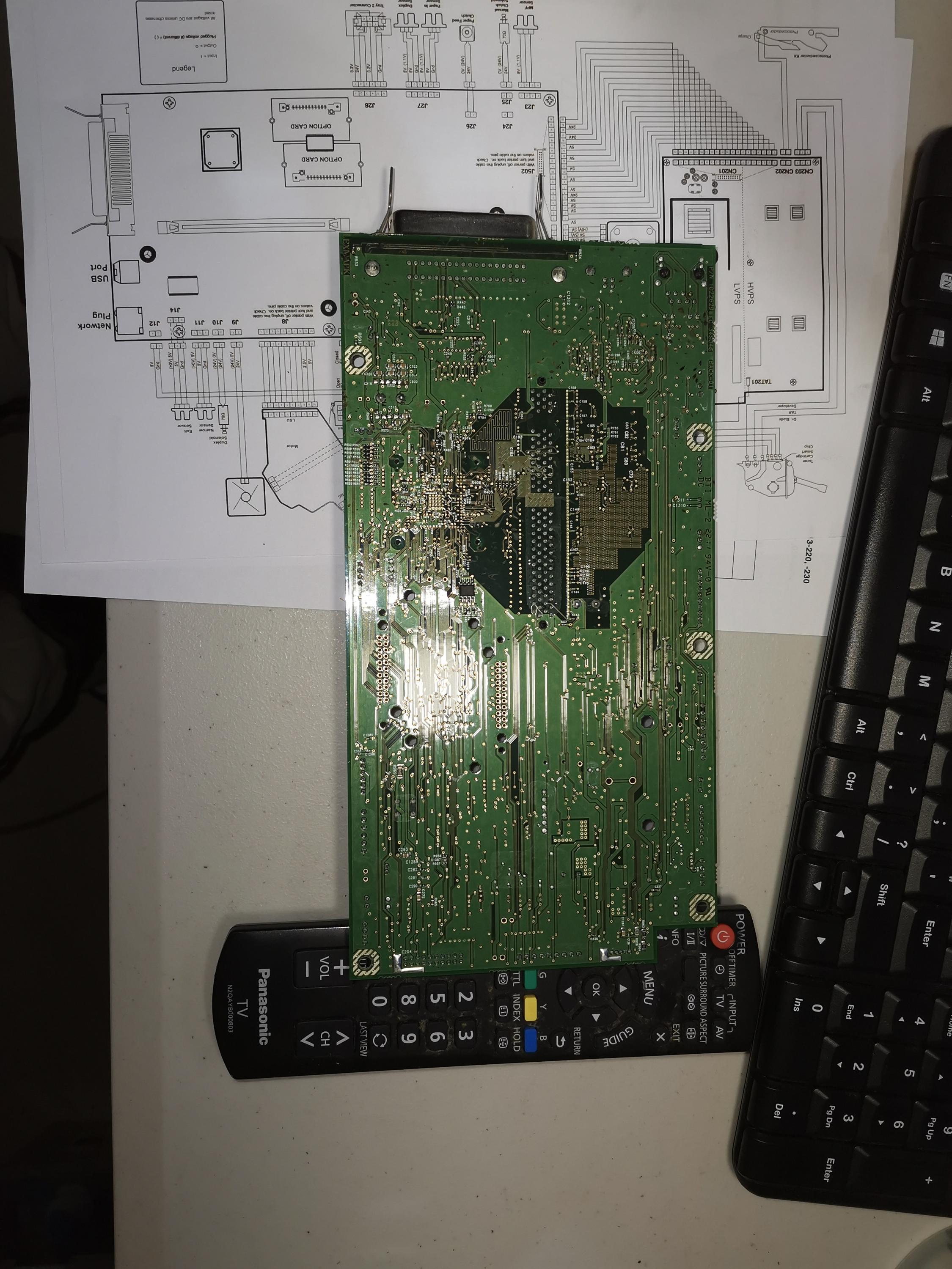

                        removed the controller board and what do i find cockroach dropping all on the back side.
                        so what you think? should i just trash this printer and not bother to try to repair?
                          Want to make sure your controller board looks the same as page 156 of the manual?
                            Are you able to trace pin 2 and pin 4 back on the board to what they are connected to. You what to unplug machine first. Verify trace with ohm meter. For some reason your power supply is producing the 5 volts DC however it is not showing up at those pins.
                            I would stick with the controller service board check before thinking about the main motor. I believe this my work first. Kind of hard to troubleshoot a power supply without a schematic.
